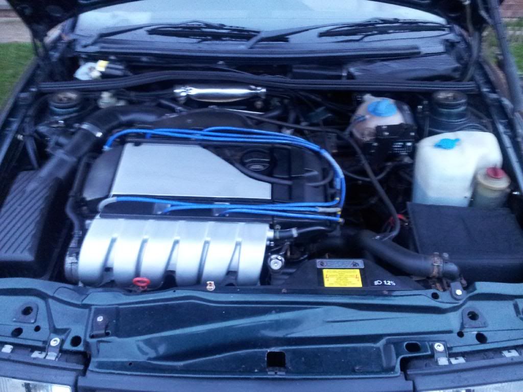

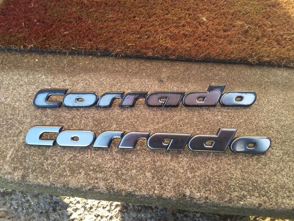

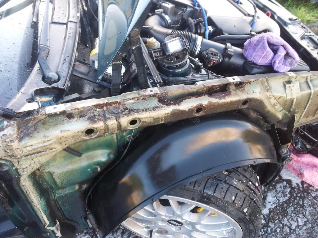

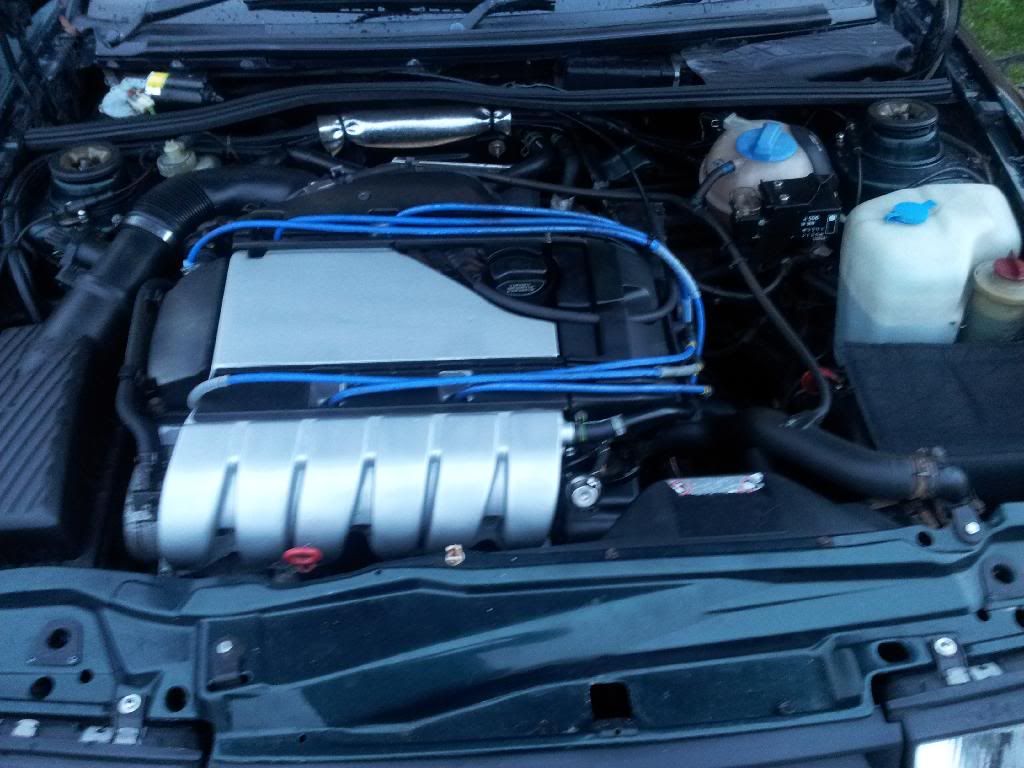

seanl82 23 Posted December 26, 2013 (edited) Done a few little things over the last few days. Mostly just simple bits, but makes it look a little better I think. First off was the roof aerial. Wasn't all that keen on the shark fin that was on when I bought the car, and to tie in with the OE with a few choice enhancements I'm going for, I put an original back on. Radio reception is much better now too! Before. After. Next up as the rear Corrado badge. Original was a bit tired, so swapped it out for one that's a bit better. Before. Side by side. After Just need a new VR6 badge now! Next up was a few little bit for the bay. Before. After. So as previously mentioned, I bought a pair of wings and a bonnet in classic green from Monkey last week, and had to swap the bonnet straight out. I had a few hours spare today whilst the missus took the kids in town for some boxing day bargains, so set about getting the wings swapped over. I did a wing swap a while ago, but I'd forgotten how much of a ballache it was! After fighting with the cavity wax I finally got the drivers side off, to be confronted with this. Not good! It's certainly unexpected as everything else on the body and underside is really really solid. Needless to say it's gonna have to come off pretty soon to cut it out and weld in New. I'll speak to a mate at work who's handy with a mig and get him to sort me out I think. Other side has a bit of surface rust, so I'll get it treated and stone chip it I think. I need to align them better anyway, and it was showing signs of rain and getting on a bit so I'll take it in work to sort out in a few days. It's much tidied now though, no lacquer peel and much less rust. There is a slight bit of rust on both, bit it's right near the bottom so easily sorted and sprayed by hand without it being noticeable. Front end really needs a good mop now though which I'll do at the same time. Other bits to do when my LEDs and resistors arrive is the rear light. Getting there! Edited January 1, 2014 by seanl82 Quote Share this post Link to post Share on other sites

seanl82 23 Posted December 26, 2013 Thanks James, I may well take you up on that if you can cut a section out before you scrap the shell. Better to have a proper section as its obviously the crumple zone, so better to get the correct piece than weld in some metal that's not designed for it. I should have thought Rog, thanks for the offer. It was a pain in the arse as the in-laws is on a slight hill and didn't trust my standard widow maker car Jack, so had to use the kerb to get underneath! Quote Share this post Link to post Share on other sites

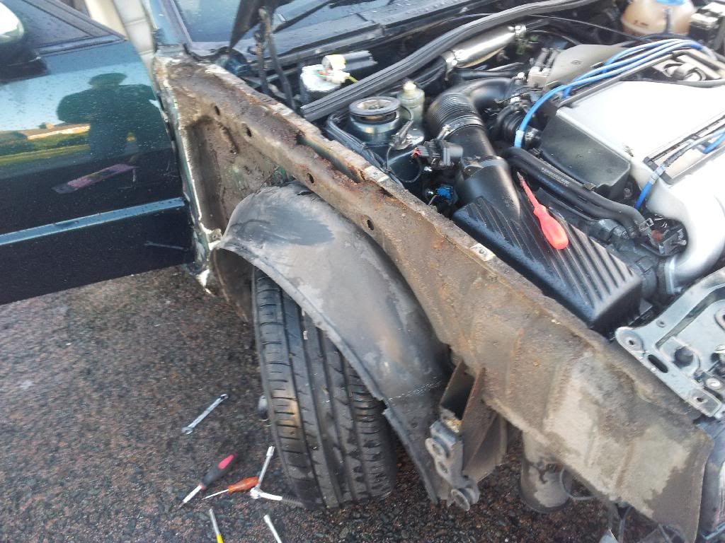

seanl82 23 Posted January 4, 2014 (edited) Quick update though no pics sorry! Managed to spend the day on the Corrado today after the bloody Saab decided to throw another wobbly! Spent the last two days swapping out the alternator and thermostat on that piece of crap! Pain in the arris trying to get a quick 10 minutes here and there between downpours and looking after kids. Missus had to use the Corrado for work, which I was really reluctant about. I'm not sure if it's a good or bad thing though, she came in after the first day and said she loves it! It's the first time anyone but me has driven it in my ownership, but she got two waves and a race proposal off the lights. She says she now "gets it". Anyway, alternator was ordered for next day delivery so she had it a second day. Cue more grins! Saab now fixed and she was off work today so I went in work for some dry workspace. Managed to get the wings off, cavity wax stripped off, primered and stonechipped any bear areas and put back on. Still not perfect, so I'm gonna have to do it again ffs! Drivers side needs to come off anyway to repair the skin which Clumpy has cut out of his breaker for me. I think where they were pulled off the original car, they were bent out of shape slightly. Just need to persuade them back again. Gave the front end a machine polish which has made it better although not great, and not up to the rest of the car. They've all seen paint obviously as there are sanding marks under the basecoat and areas of orange peel. I'll have to re-visit them too with a wet sand and a bit more time and effort. I also got the tank straps off, ground back, primered and stonechipped too. Another job ticked off the never really ending list! Edited January 4, 2014 by seanl82 Quote Share this post Link to post Share on other sites

Hofmiester 10 Posted January 7, 2014 Oh mate, unlucky with that corrosion. I wonder what caused that as normally it is dry up at that top under the wings. Maybe someone ran the car without an arch liner for a while? Quote Share this post Link to post Share on other sites

seanl82 23 Posted January 7, 2014 (edited) Hoff, not sure tbh mate. It's a weird one, and even the sills under the wings are rock solid and never been touched. Rob, thanks mate! The missus has only been in the job 6 weeks since returning from maternity, and she needs a car for work. Couldn't really let her call in and cancel tbh, so had to bite my fist on that one! Edited January 7, 2014 by seanl82 Quote Share this post Link to post Share on other sites
