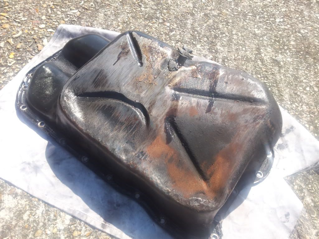

I found out that actually I don't have a crank seal/lower chain cover leak after all! It is infact the sump is not securing properly, as the three bolts just inside the bellhousing (as well as two others) have obviously been cross threaded in the past and the threads are shagged!. I've ordered some helicoils to fix it, but thats just the beginning of the problems! The sump is proper battered!
Note to all; DONT RUN DI(KHEAD LOWS!, as this is what happens!
This is the state of my sump. Its been welded in the past right by the plug. It was a PROPER bodge job, as the weld was sitting proud of where the actual plug sits flush with the washer. This was causing a slight leak, but the fact that a random bolt had been fudged in to try and make it tight, didn't help matters. The sump thread for the plug had also been chewed up, so wasn't sitting tight enough. All of the above culminated in this.......
Yes, thats a crack in my pickup!.
I don't have the funds to replace everything until the 15th, and as I'm uber busy with work next week, I've had to just fudge it myself until then and hope I can make it to National Day and back before commencing work to rectify all this. I'll put a wanted ad up for sump, and pickup as soon as my rental income clears. I've had to put a nut on the other side of the sump plug to ensure a tight seal, and prey is doesn't work itself loose with vibration over the next 400 or so miles to and from Castle Combe.

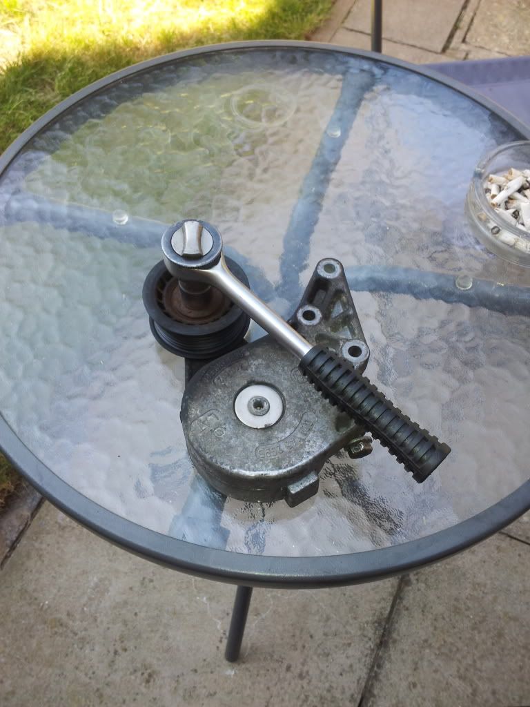

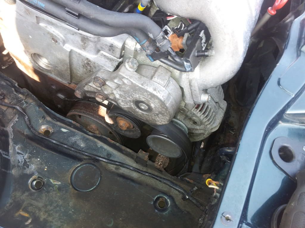

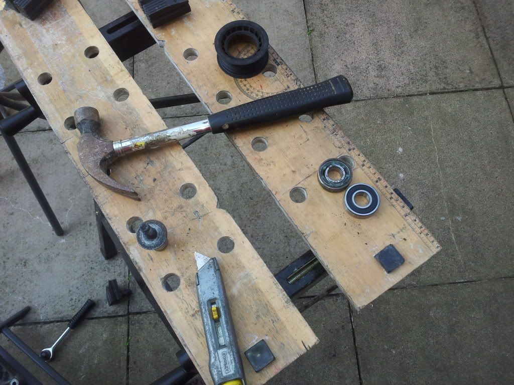

Anyway, the only thing that went well today was the serpentine belt tensioner pulley bearing. I started hearing a bit of wining on startup only for about 20 seconds last week. Its progressively got worse the more miles I put on the car, and by putting my hand on the tensioner, I could feel the vibration.
I ordered a new bearing Monday and it arrived today so fitted that thanks to the guide in the wiki.
Took less than an hour, and most of that was trying to cut around the old bearing to get it out! Very easy and cheap fix!
As you can see, I smoked lots of tabs today to calm myself after such a debacle with the whole thing!

New sump gasket and oil (again), will be ordered soon and a good used sump and pickup will be sought next week. It's obviously been knackered for a while, so a few more miles won't do any more damage hopefully. :shrug:
Ebay searching suggests VR6 / 4mo / R32 / V5s all have the same pump / pick up? If anyone can confirm this and Sean can make use of a 20V V5 AQN pump I'm sure I have one somewhere................
I know the 4mo and r32 pumps are different. The R32 sump is shallower than the others and has a shorter pickup as a result. The pickup is only available from vag with the pump.
Dox, thank you very much for the offer mate. I think its as Sean_Jaymo has said and too shallow though unfortunately. I've had a look online for the part numbers on your pickup and they all suggest what its come from, but the VR6 pump complete is a different part number, and I can't find any evidence of the pickup being available separately at all unfortunately. They are different part numbers on Vagcat too. On the pics again yours looks a little too shallow. There is a triangular casting just below and to the left of the part number on yours, and on all the pics I've seen for the VR its more rectangular apart from the first angle.
I'll have to get a new pump if all else fails, so I'll give it a week before putting it out again.
Thanks again for the offer though mate, very much appreciated! :thumbleft:

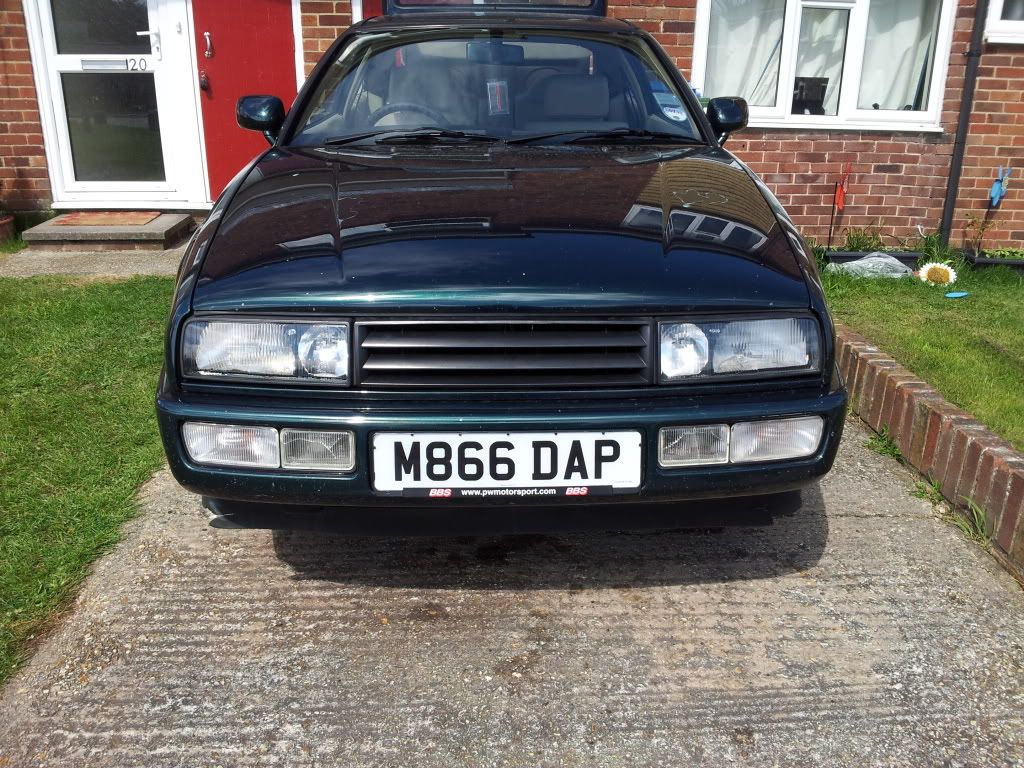

Didn't really like the badgeless grille, and I'd picked up a standard one for nothing a while back but the taps were all broken. I had to buy a new badge, and fabricate some clips with the help of an SMA formula milk tin, a glue gun, and some amalgamating tape. Fits well and much happier with the front end now.
Before
After

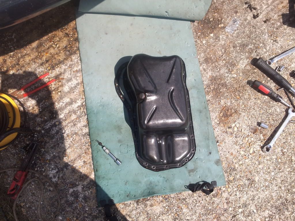

I fitted the new sump, but unfortunately I couldn't sort the stripped threads out so need to go back to it. I couldn't get the taps up near the bellhousing properly, and lying under the car on the drive was proving a bit difficult. I'll have to do it on the ramps at work another time. At least I can now change the oil without dropping the whole sump again!
New sump painted up in Hammered Black.

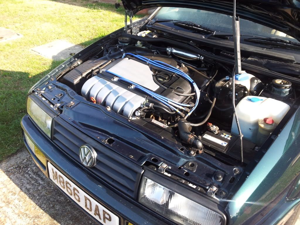

Finally, decided I didn't want a polished inlet manifold anymore as I couldn't be bothered to actually polish it! It hadn't been polished up all that well anyway, and there were a few pitted areas where it needed to be cut back a little more. A tin of Hammered silver and I'm really happy with it!
Scuffed a bit putting it back on though on the dipstick guide tube. :censored:
