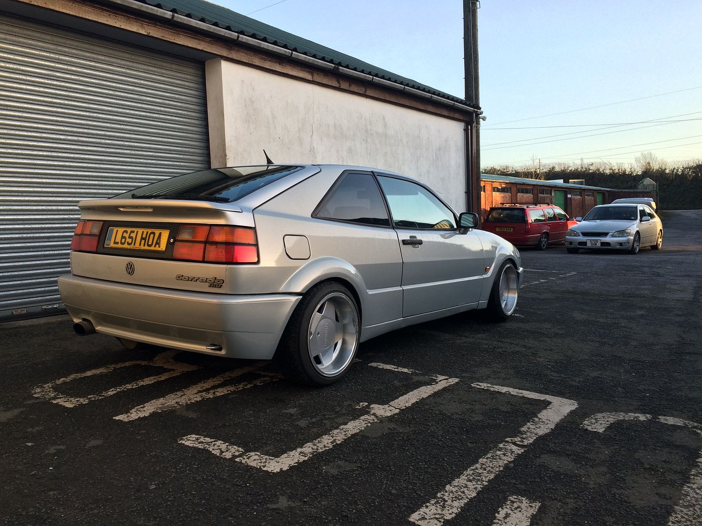

daveb142

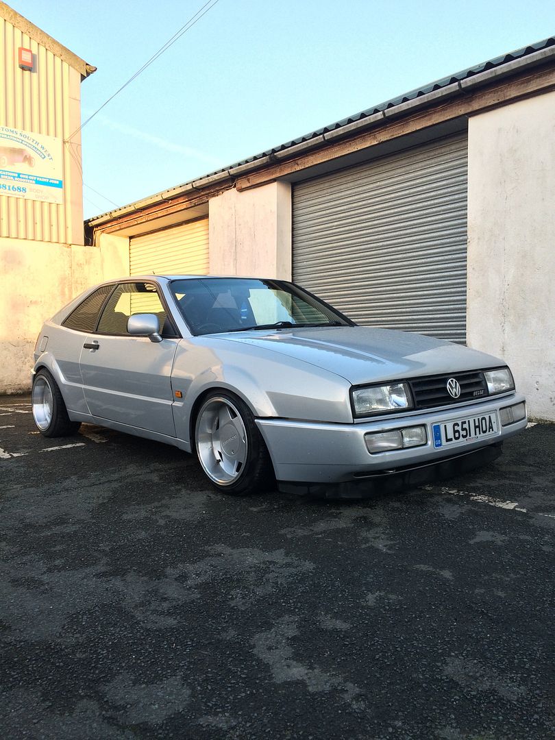

Dave's 1994 1.8 20vt
Cool, getting rare these days. Cant beat a silver Corrado IMO but then Im slightly biased.
Thanks man. Silver has grown on me, but it just feels a bit "meh" when I look at it haha.
Great plans for the Rado Dave . Rocco looks nice too . Hopefully the mini meet will come off .
Cheers Rob! And yeah it's a good little Rocco! Yeah let me know when it is!
Looks great Dave! How is the paint? If its just a bit flat, save your money and just get a good detail done. It'll bring the paintwork up amazingly! Thats the thing with the Silver, if its full of swirls it just looks flat and dull. With a good machine polish and wax/sealant, they look immense! Hopefully be down in mine just after Xmas now, so a mini meet would be great! Think I'm coming down on the 27th for a few days but I'll have to find out when she's working before I know for sure.

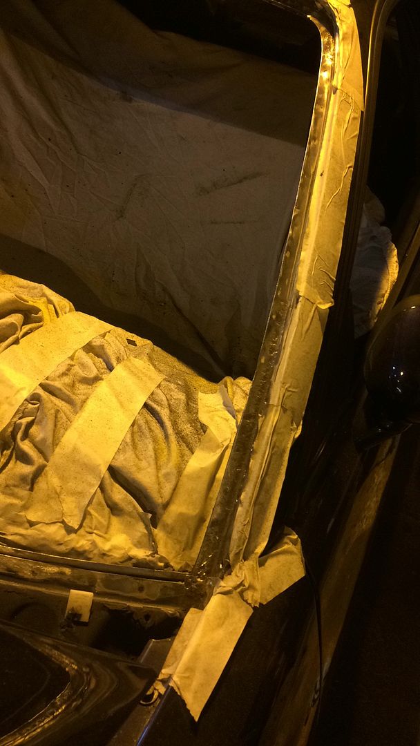

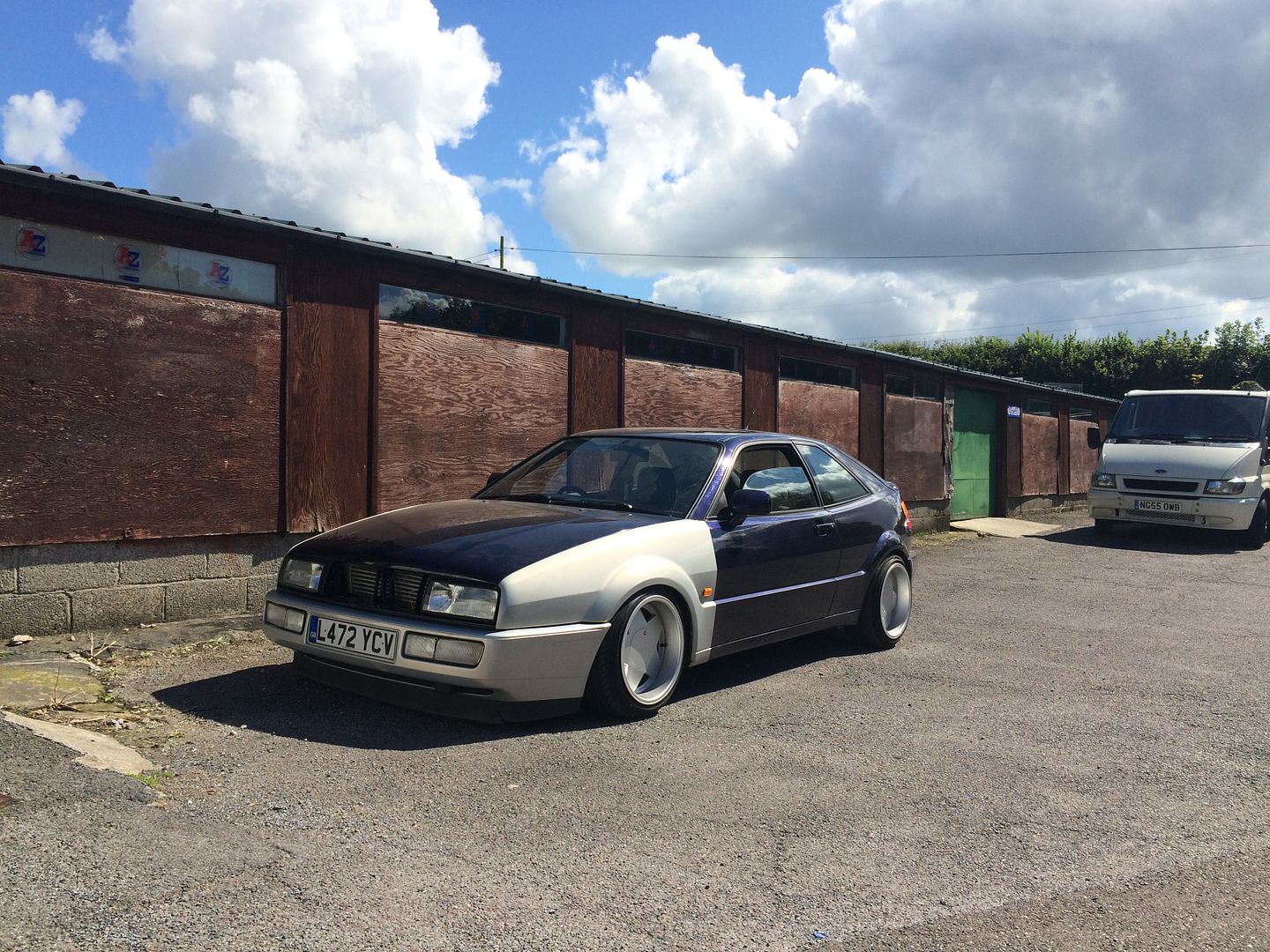

Cheers Sean! It looks good from afar, but has been badly resprayed.... the roof and tailgate are the original colour. The rest has been poor done. With many runs, scratches and tape marks in it. You can even see where they sprayed it with the side trims on, then taken them off and sprayed over the top of it....
Also you can see the tape marks on the top of the pillars where the colour changes and around the windows where they were badly taped up. Filler and dents in the sill and filler in the rear arch!
So will be a full respray and colour change I think haha!
Yeah definitely man. Let me know when you come down!

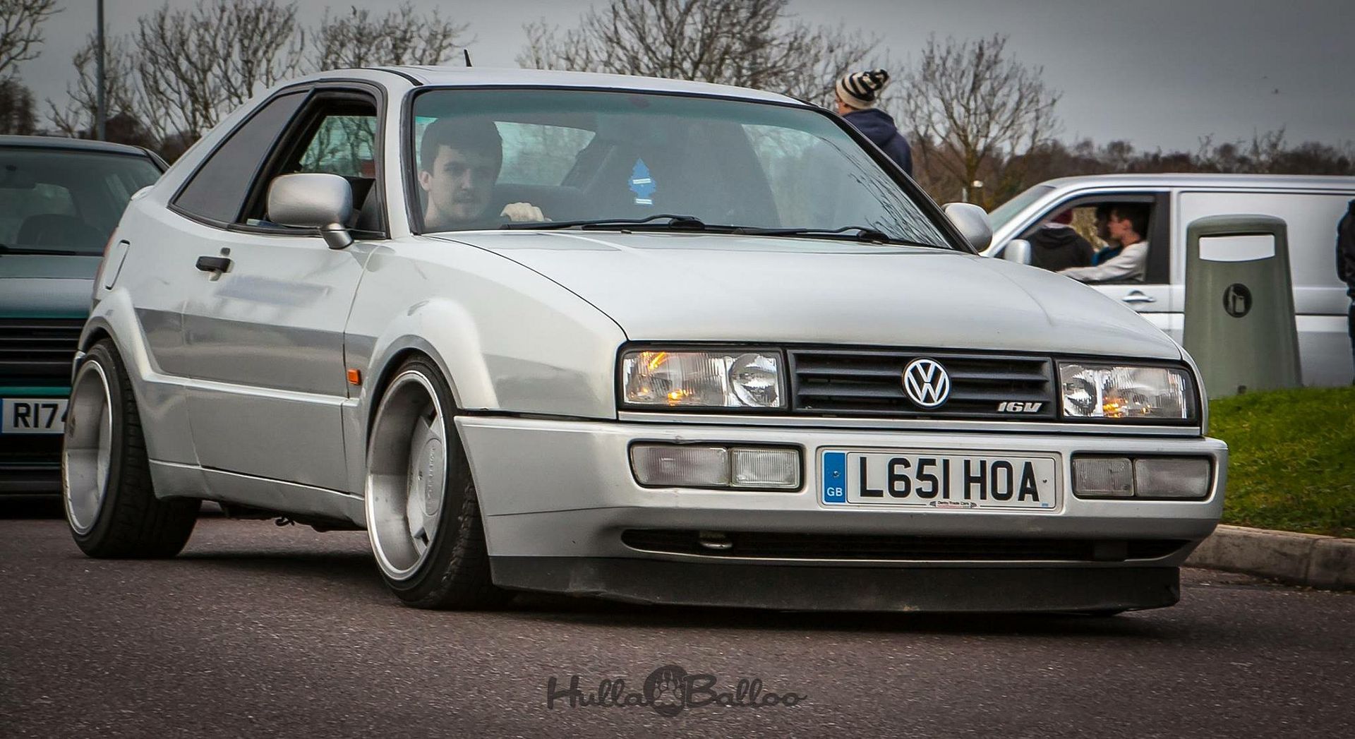

Went along to a charity drive upto Devon Dubshack yesterday, ending with a BBQ.
Here's a photo someone took of a mate's Caddy and the Corrado on the way

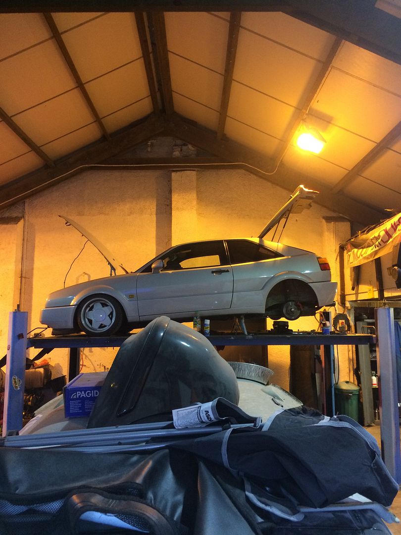

So since the last update, i've replaced the other inner cv joint, got the center caps fitted and I have now taken her off of the road!
Time for bodywork to be done, small fixes, upgrades and some changes :)

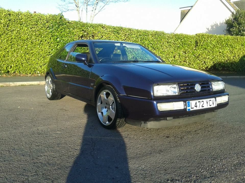

And with the current daily:
Miss driving it already, however will be worth it when finished!

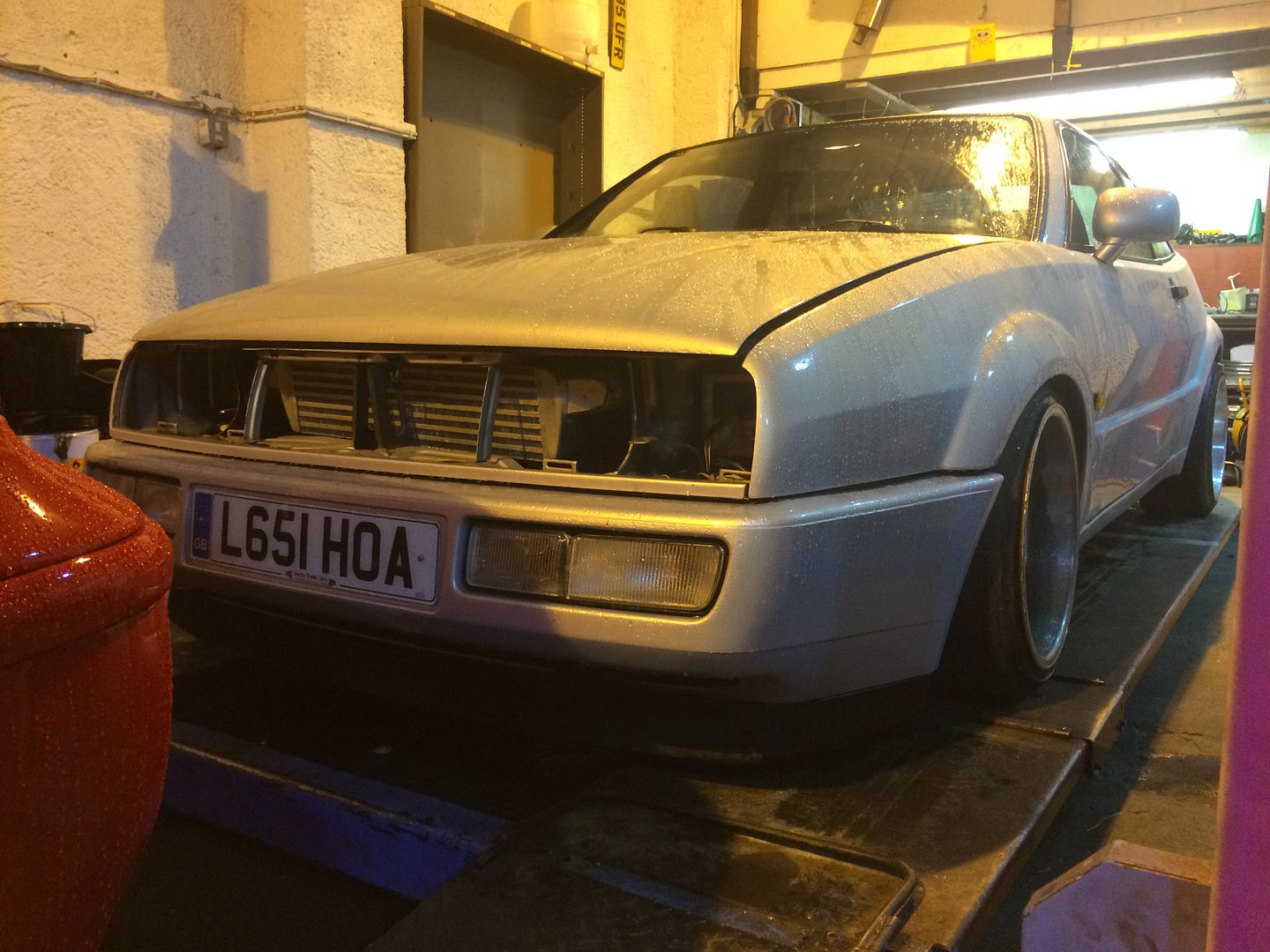

Corrado is now back in a space in the unit. I'm in the process of buying new bits for it and a fair few parts have already turned up :) and ofcourse saving for the respray!

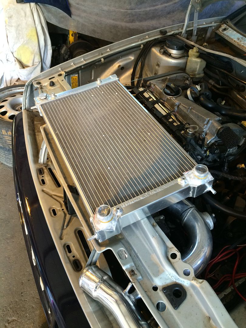

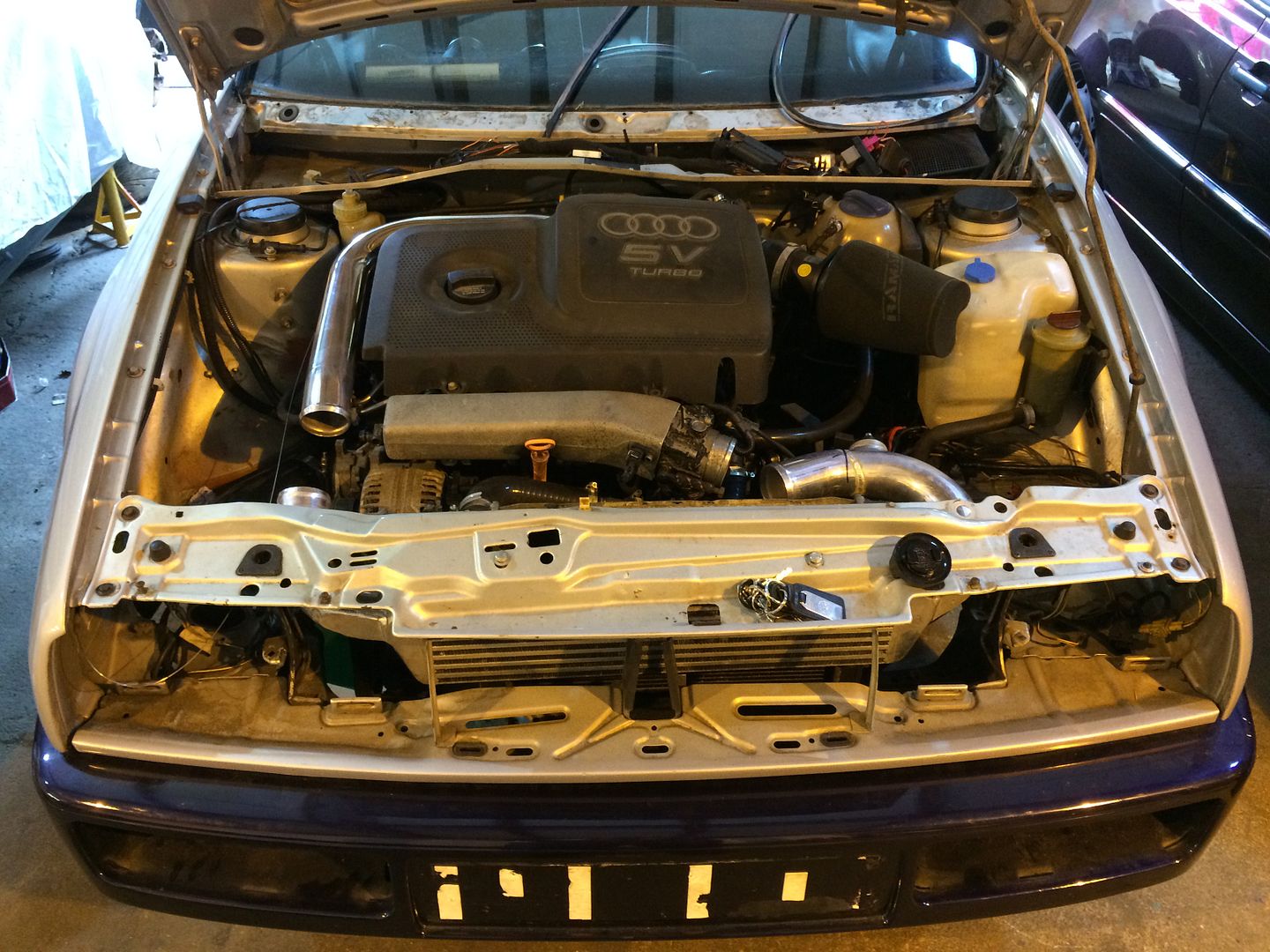

Decided to upgrade the radiator to a Direnza high flow rad. Also tempted to get an oil cooler as was seeing pretty high tempteratures before......
Anyway, will update as I go along

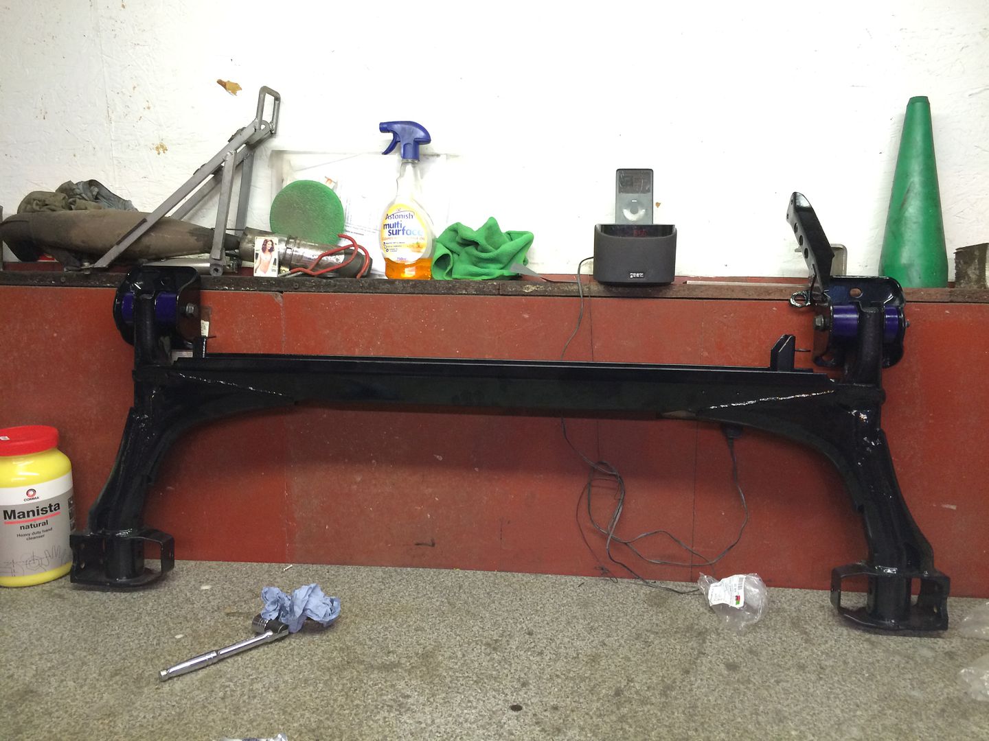

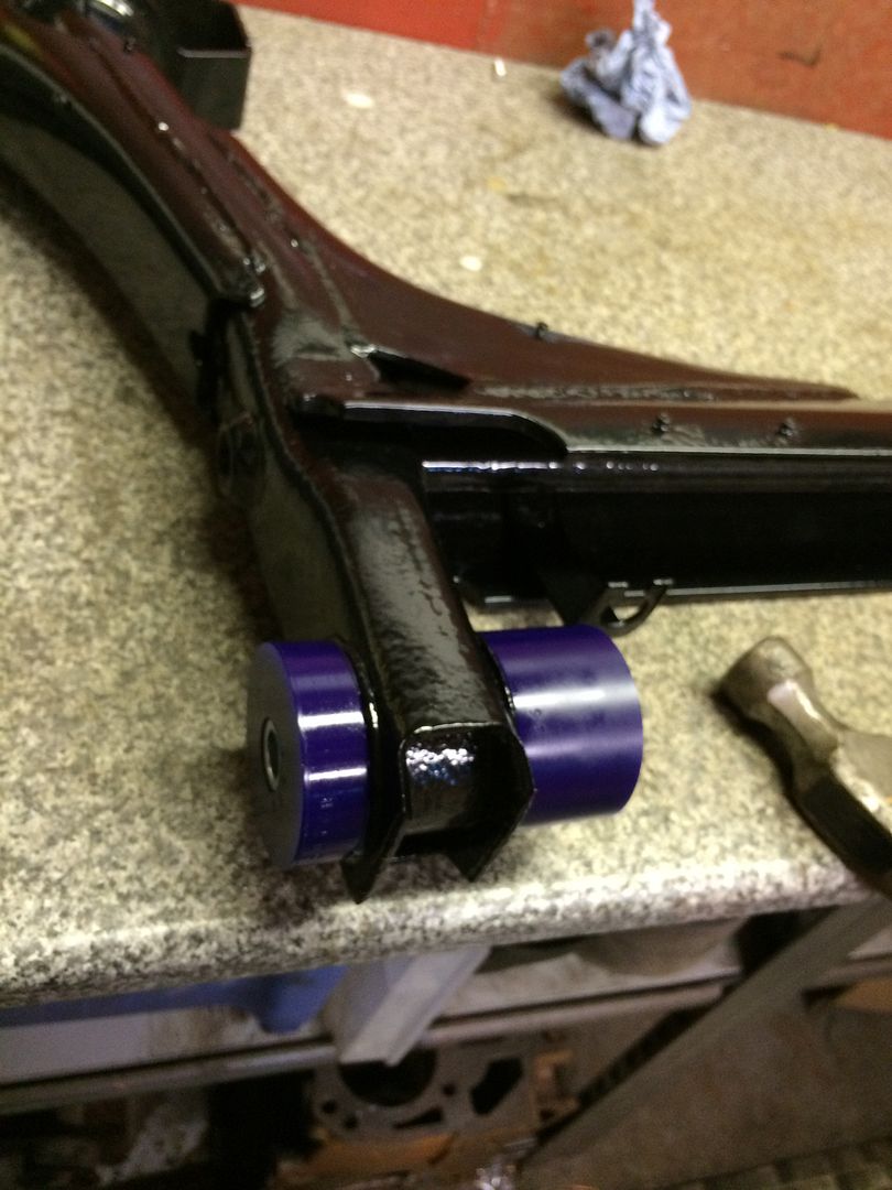

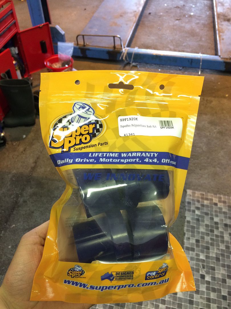

So i've been buying new bits and bobs lately and getting some parts powdercoated. Anyway, I decided to go for the superpro rear beam bushes after hearing good things about them.
06022562-C171-45FD-9A99-2ADADC57E163_zpsrwbbxoll.jpgE9121187-9A1C-447B-B3D1-1737DC7D749A_zpsznbrc4yc.jpg
Thanks to my mate at Exeter Engineering for doing the powdercoating and what not! They also offer vapour blasting and such there, well worth a check out!
I've also had a number of brackets and the front cross member powdercoated, however I don't have any pictures of them yet....I really don't want to put them on the car, they look so good hahaha.
The bushes were stupidly easy to fit, took me ten minutes!

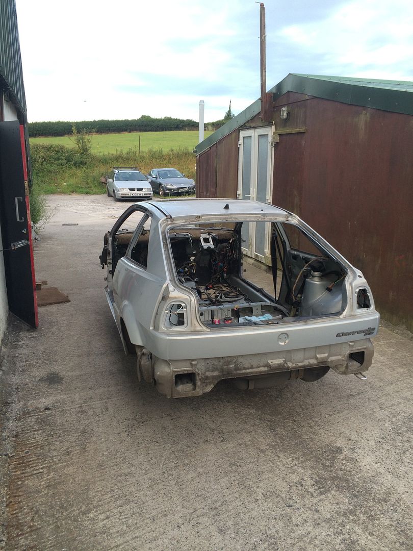

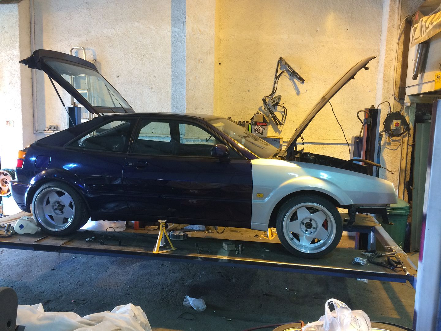

My intentions were to fully respray the Corrado this year and uprate some parts at the same time. However plans changed around July!

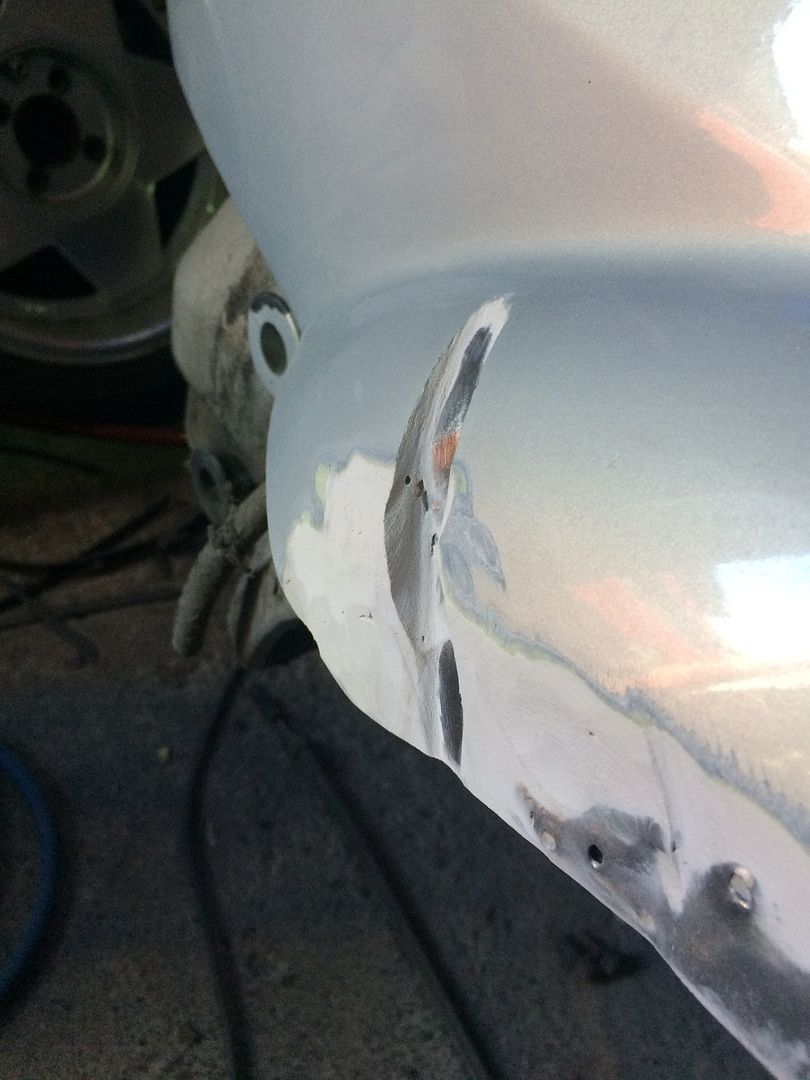

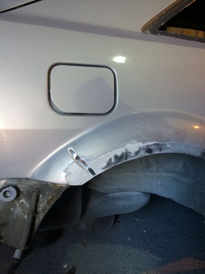

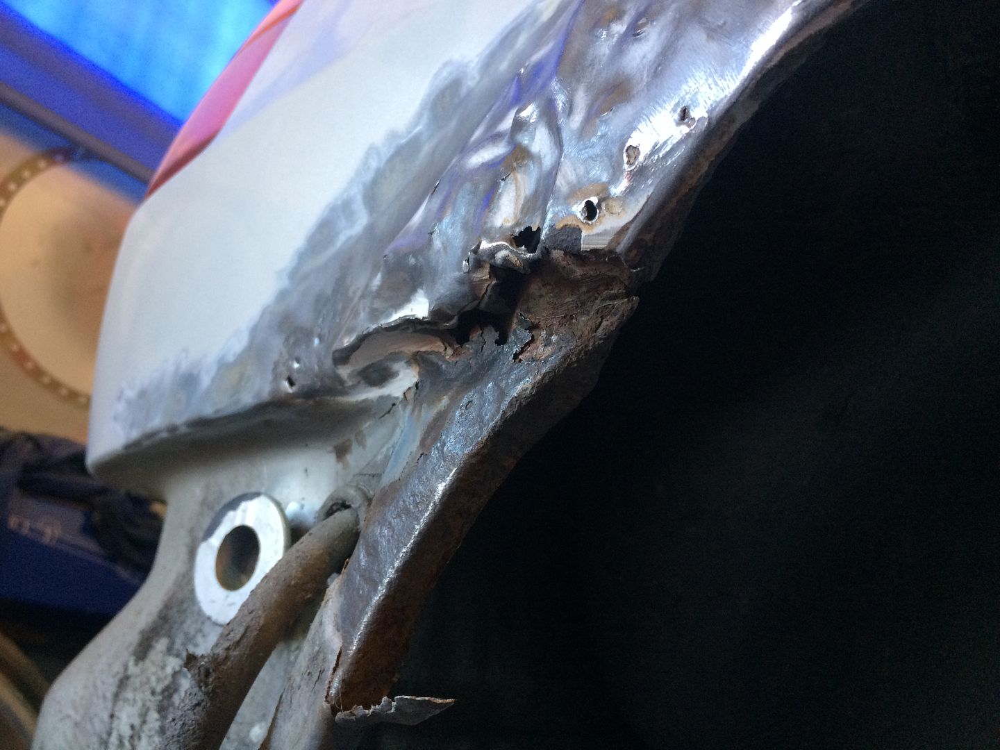

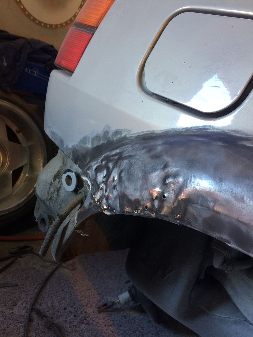

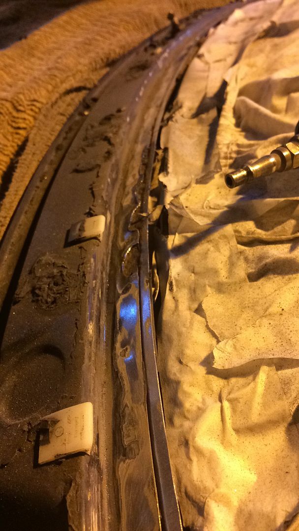

I always knew my arch had some filler in, so began taking it back to bare metal.
Lovely.

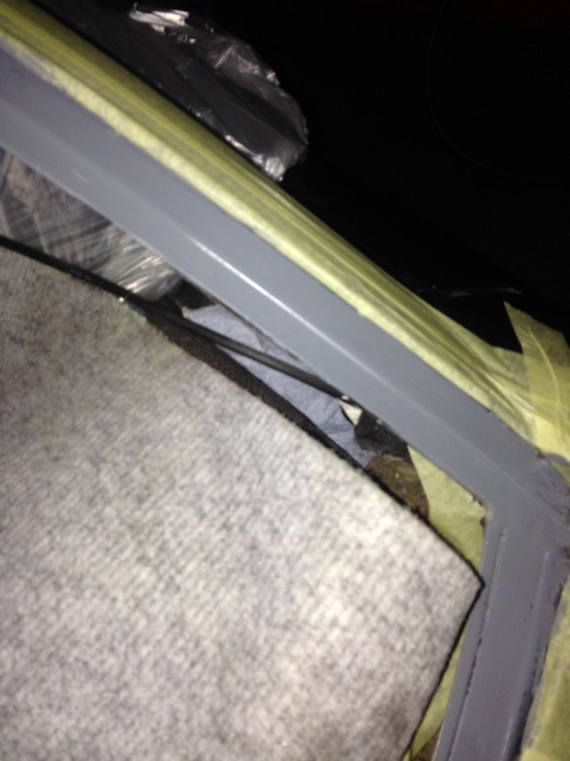

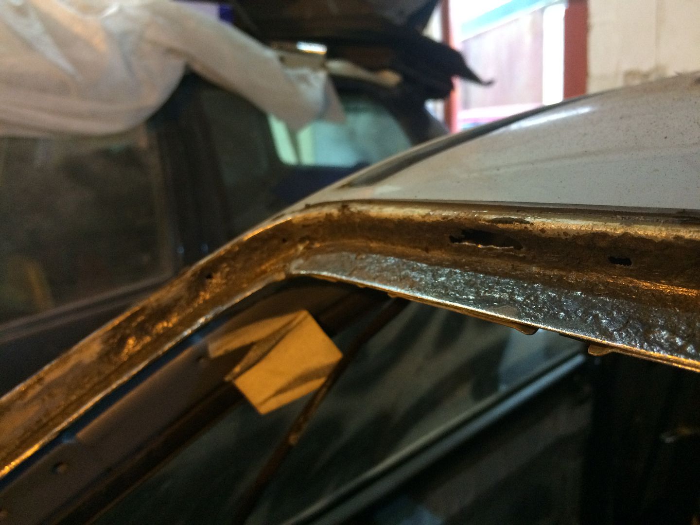

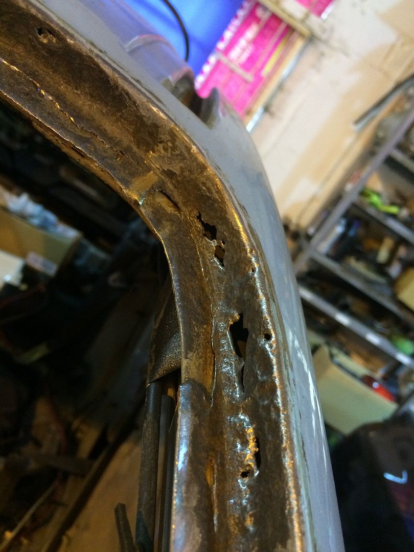

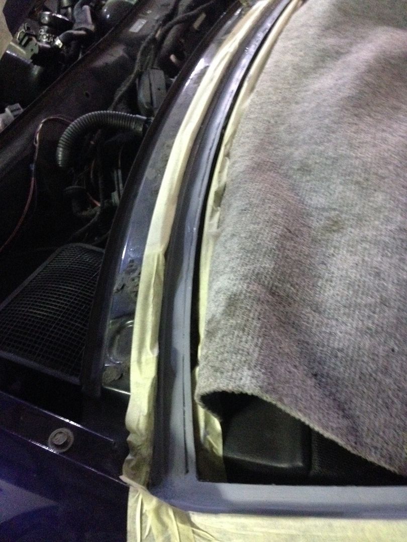

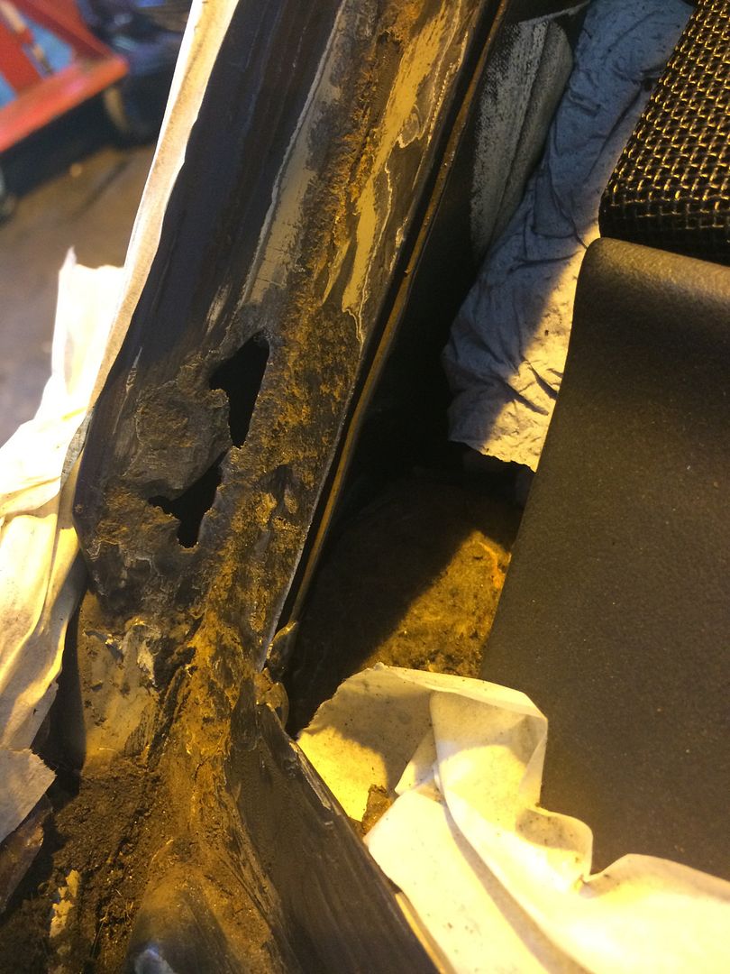

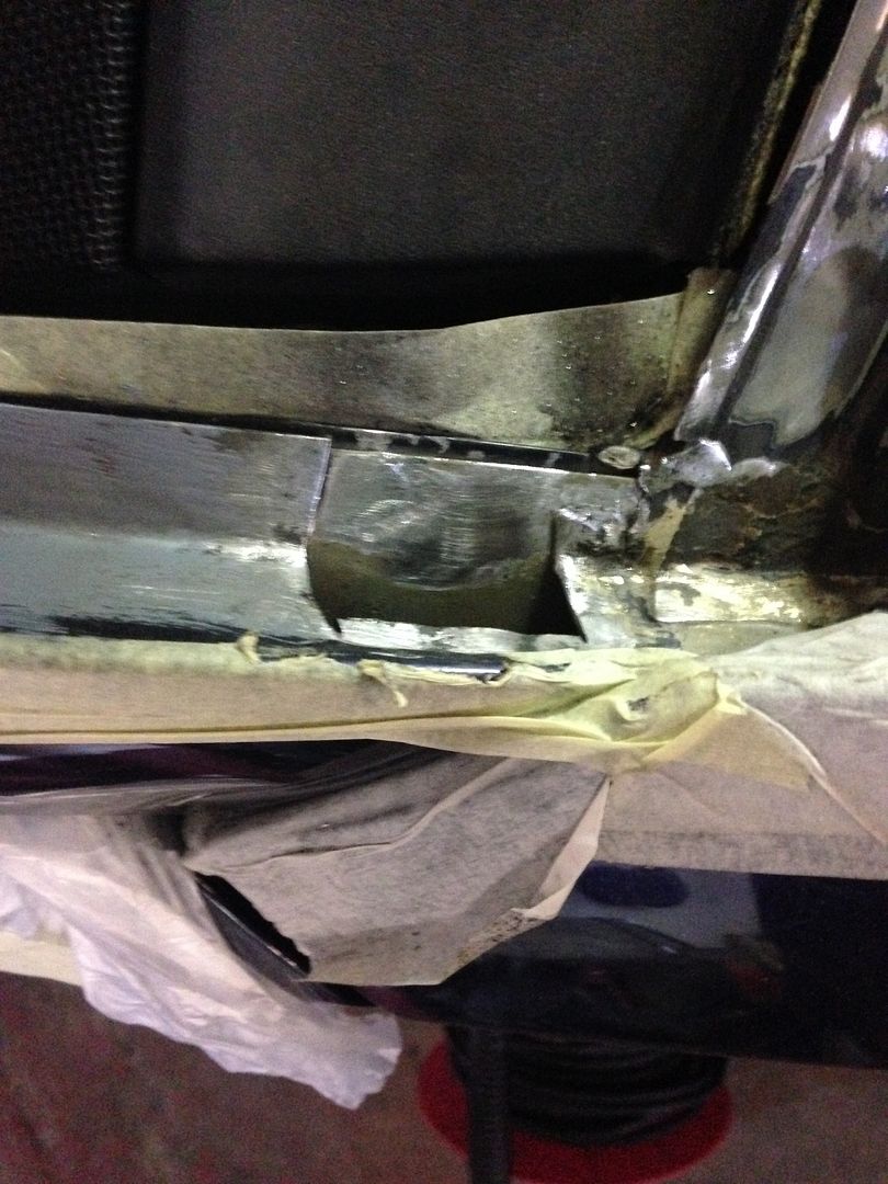

So a new arch was needed, not to bad. Then the windscreen came out. The entire surround was like this...
It got worse in the bottom corner and I hadn't even dug into the driver side sill yet, which was also dented and full of filler.
After some talks with my painter and a few friends and my respray budget looking to be doubled, the car ended up like this.

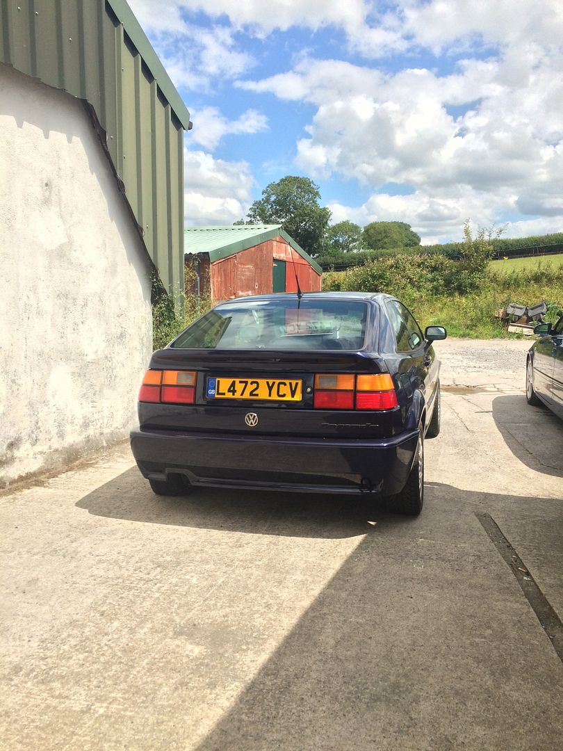

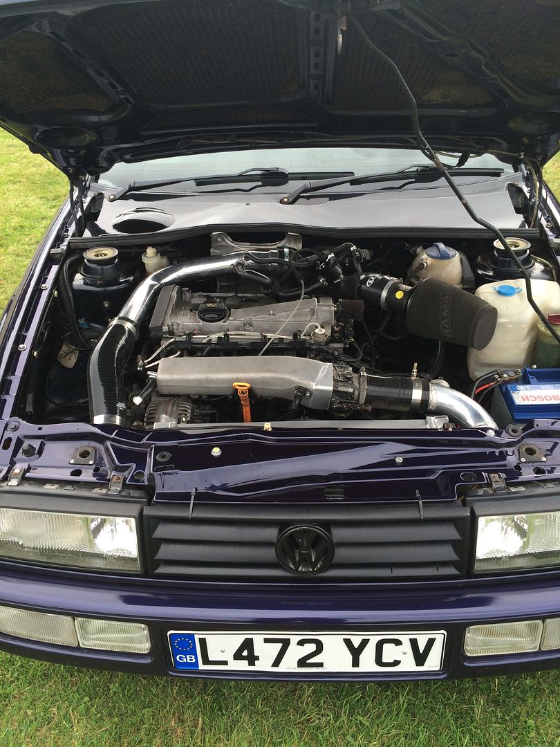

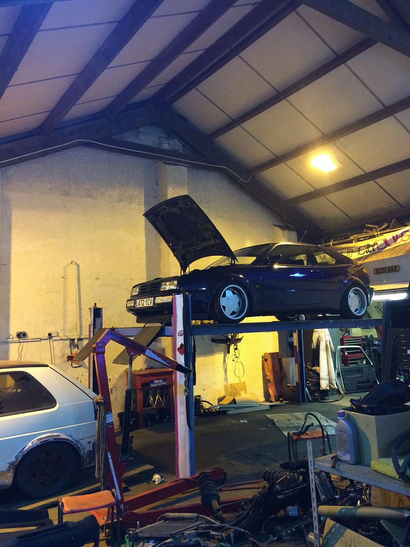

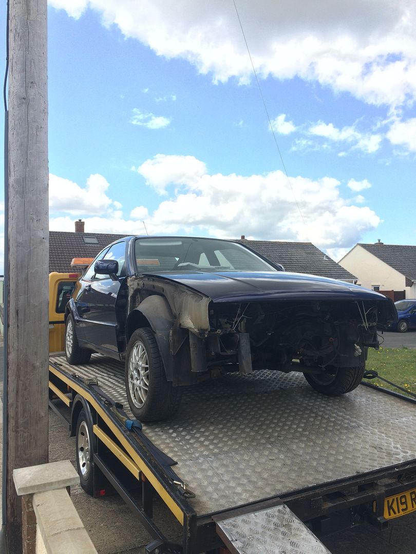

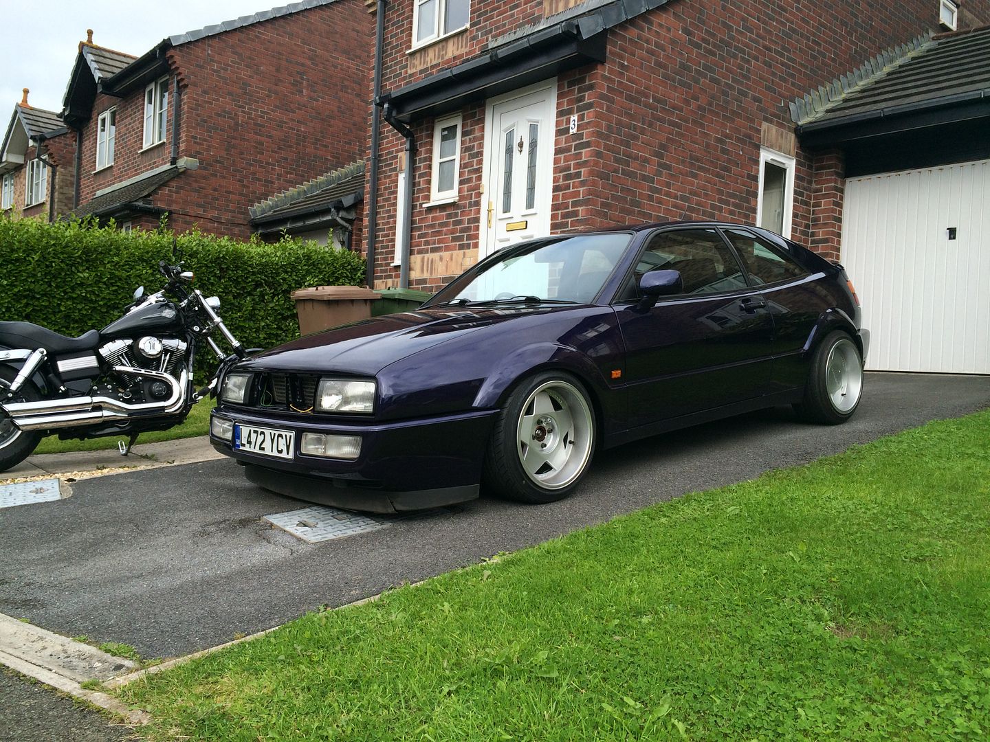

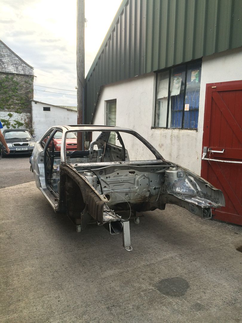

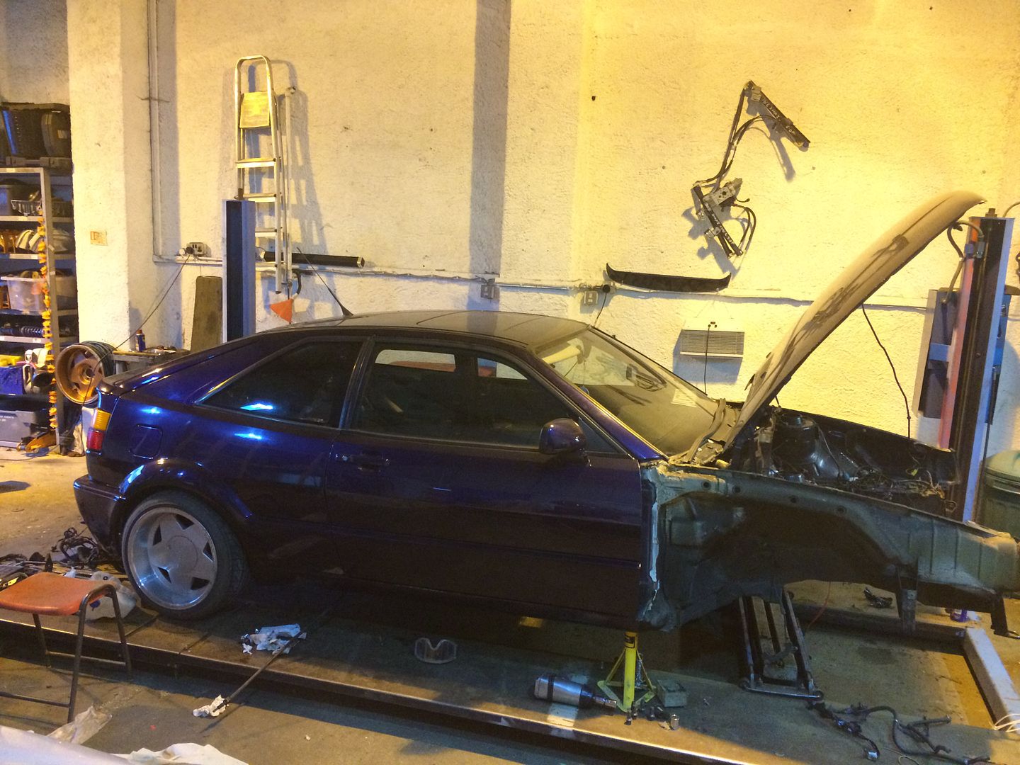

Now all I needed was a new shell. A quick phone call to Mr Mann meant a drive up the road to Paignton, where I bought his old VR6 shell! A 1994 VR6 resprayed in Mystic Blue
It came with the VR6 running gear, no wings, interior, brakes, engine etc were all gone. Perfect for what I needed it for! I got it back and began transferring things straight away :)
Converted to 4 stud with my freshly powdercoated rear beam and such

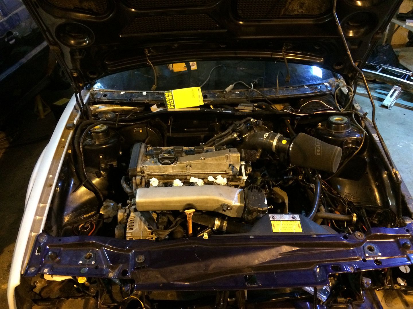

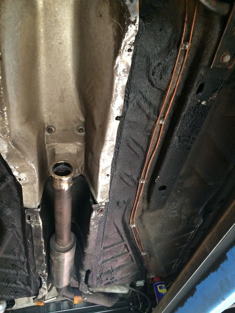

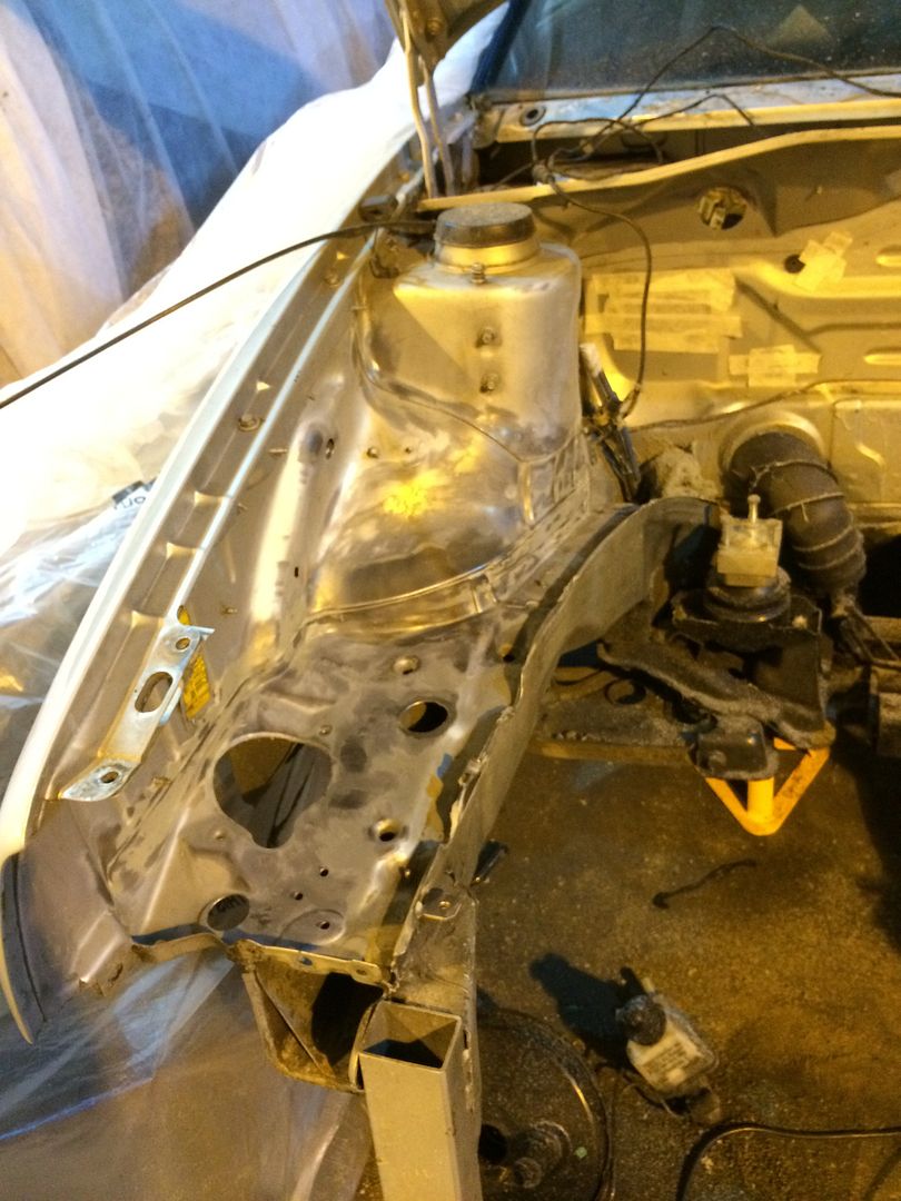

I then stripped the bay and got it ready for the 20vt. I also decided to bin off the ABS. Both pumps I had were dead and I didn't have the parts for the upgraded ABS system, therefore complete removal of the ABS system went ahead. I also put on my 16v exhaust with a new v-band welded onto the joints
Whilst doing my brakes, I upgraded my master cylinder to a 23mm stubby one from a seat ibiza, using a MK3 golf brake servo adapted to fit the corrado pedal box.
A bit of work and cleaning later resulted to this:

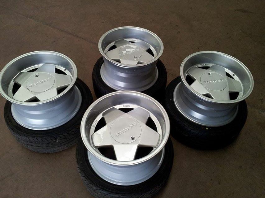

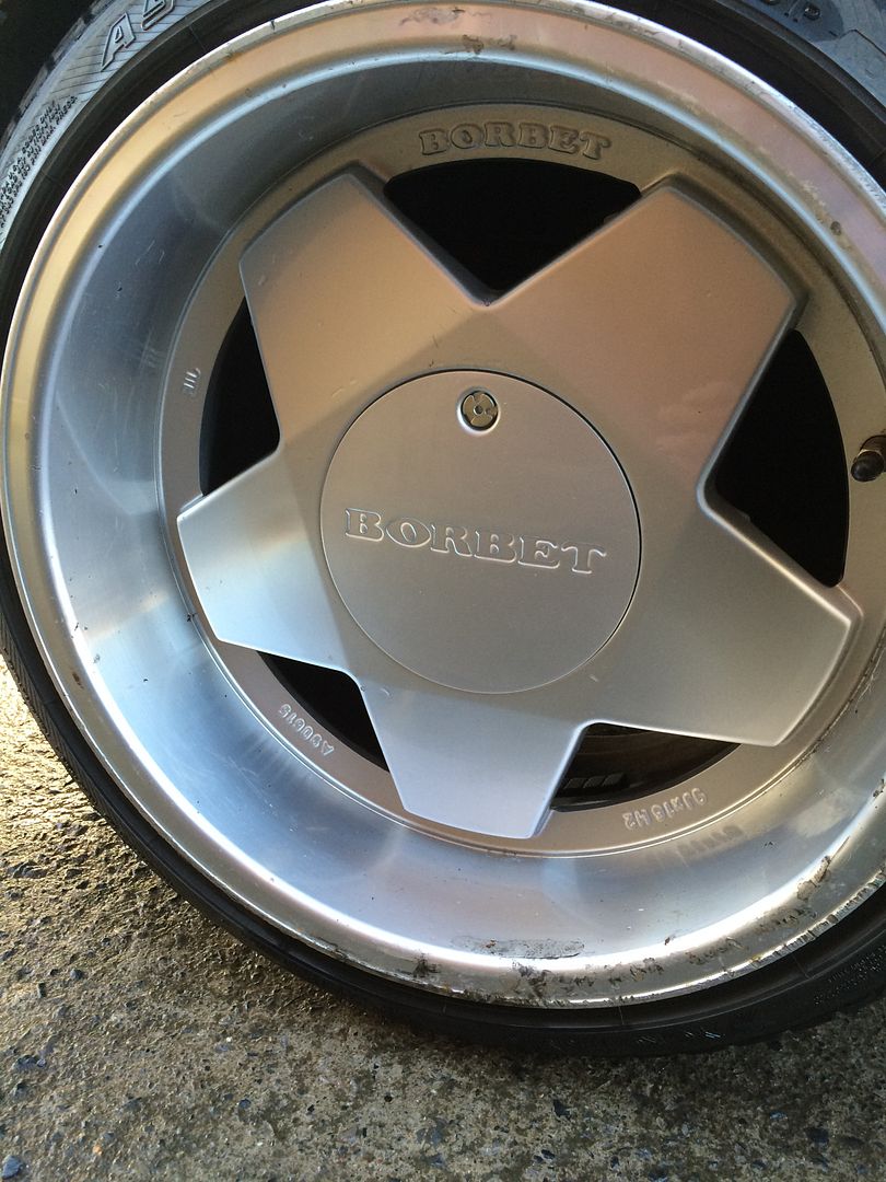

Unfortunately as you may have noticed, the shell did not come with any wings. Therefore I had 2 spare ones painted along with the front bumper. Whilst waiting for paint and having saved money from not respraying the whole car, I had my Borbets refurbed by South West Wheel Repair in Marsh Barton, Devon.
I had them all powdercoated silver and very happy with the outcome! For a very good price too.

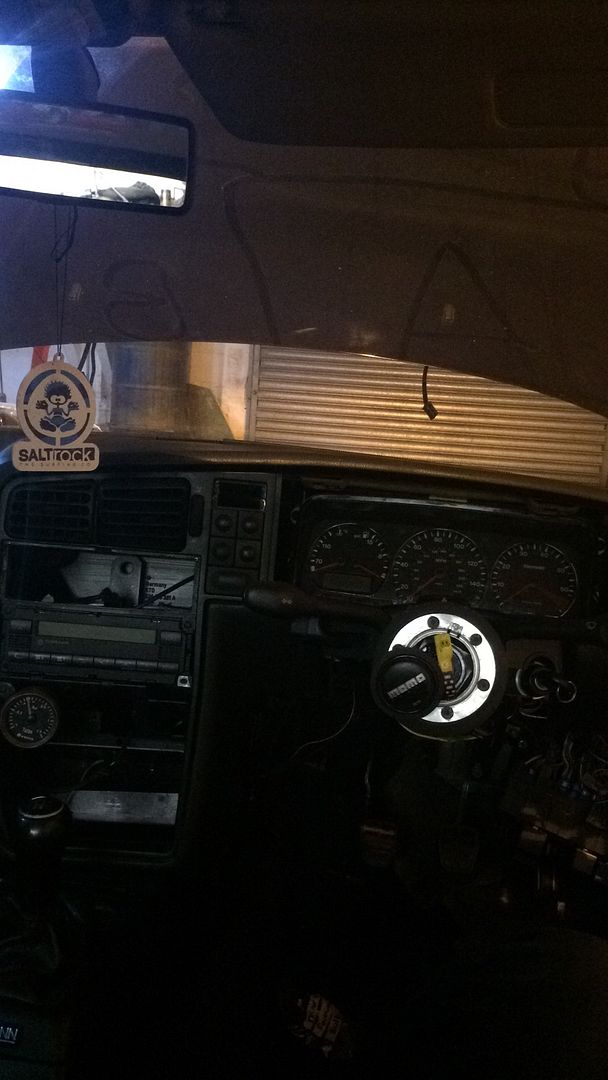

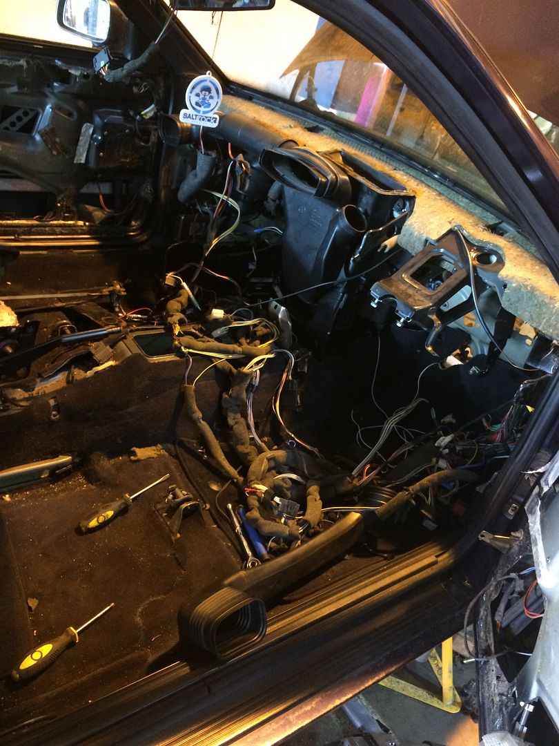

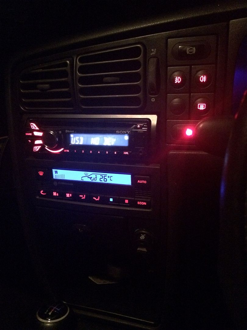

With the deadline of Edition 38 looming, I started putting my dash back together, not before completing my Polo GTi climatronic install! I haven't used the aircon for this, however wanted it to replace the dials. Very happy with the outcome and works really well!

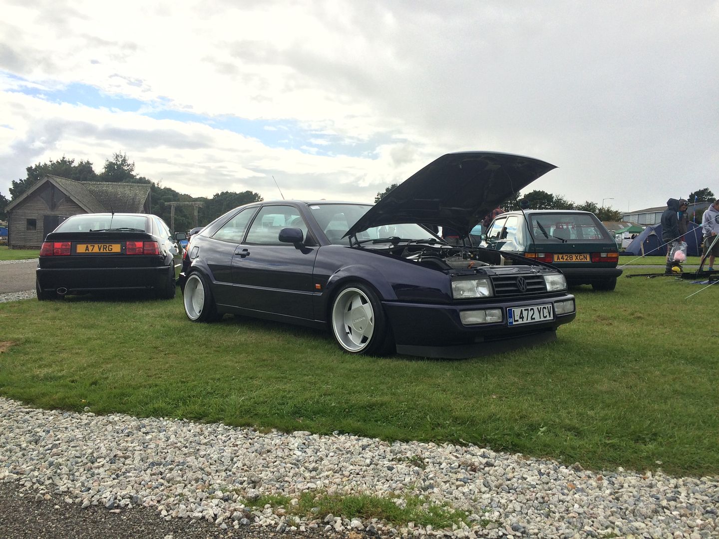

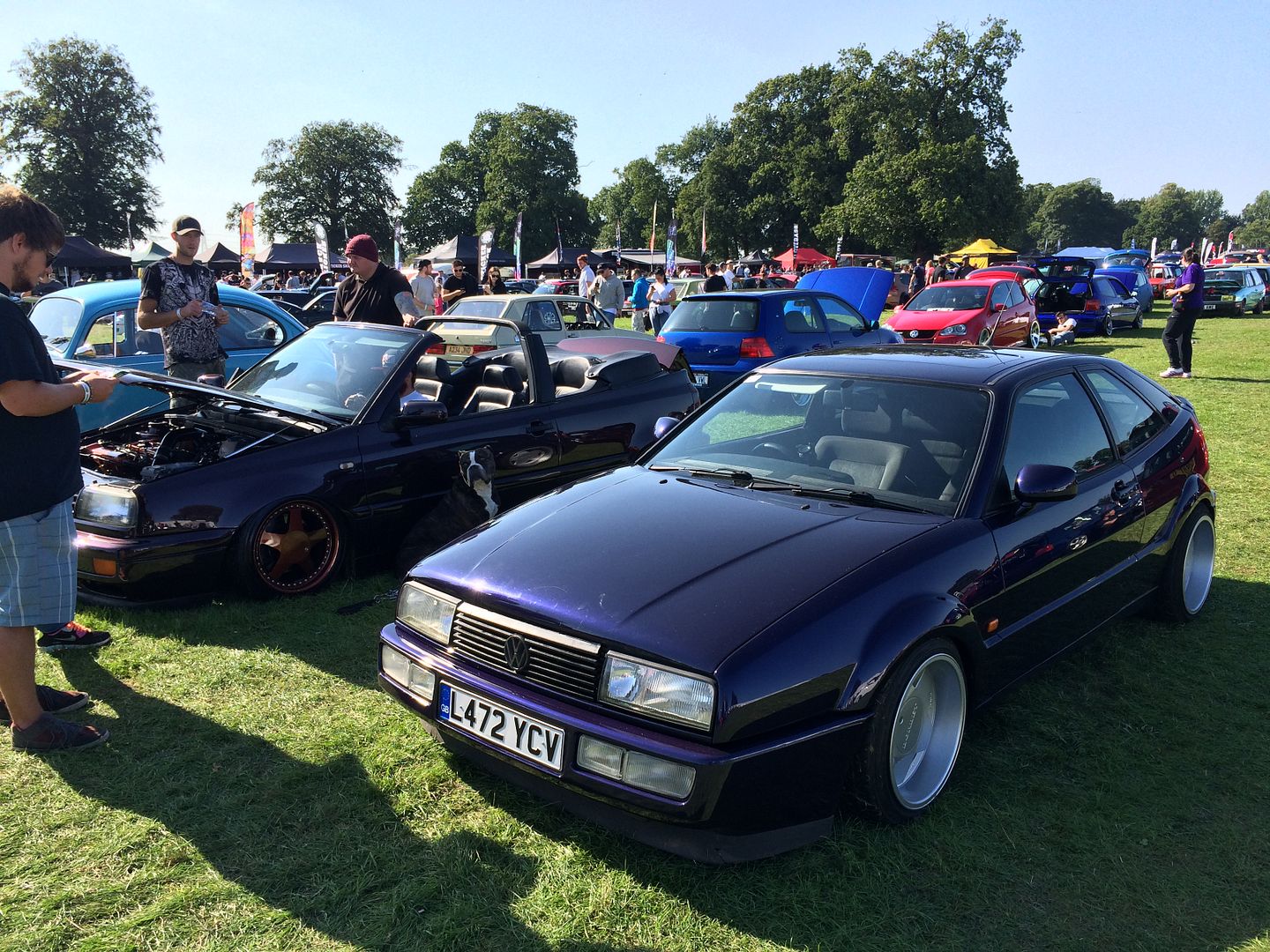

Anyway, a few pictures from the show field, parked next to my mate's mk3 cab 20vt and another mates VR6 - along with his dog VDubDaisy

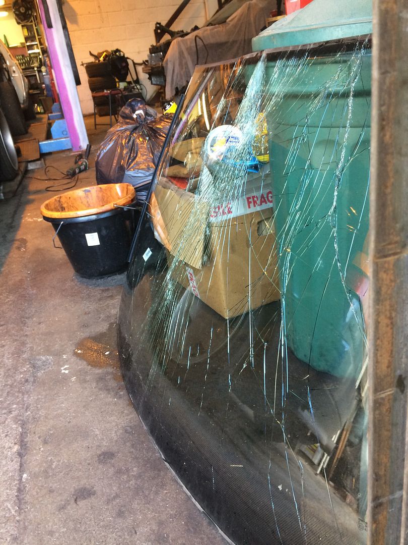

Also the windscreen cracked whilst on the show field in the sun, so gotta get that changed over this week :( but gives me time to sort everything out.

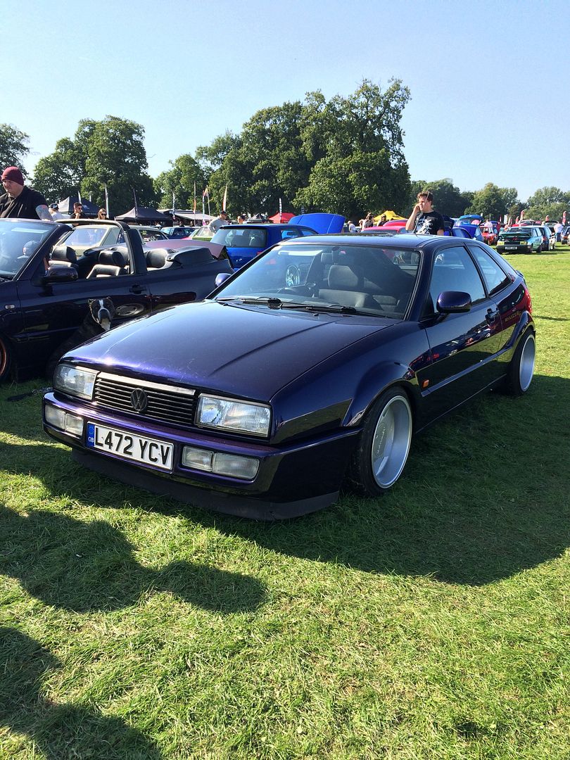

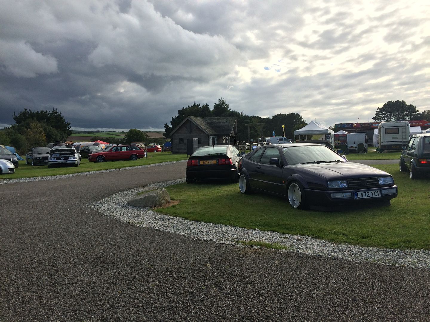

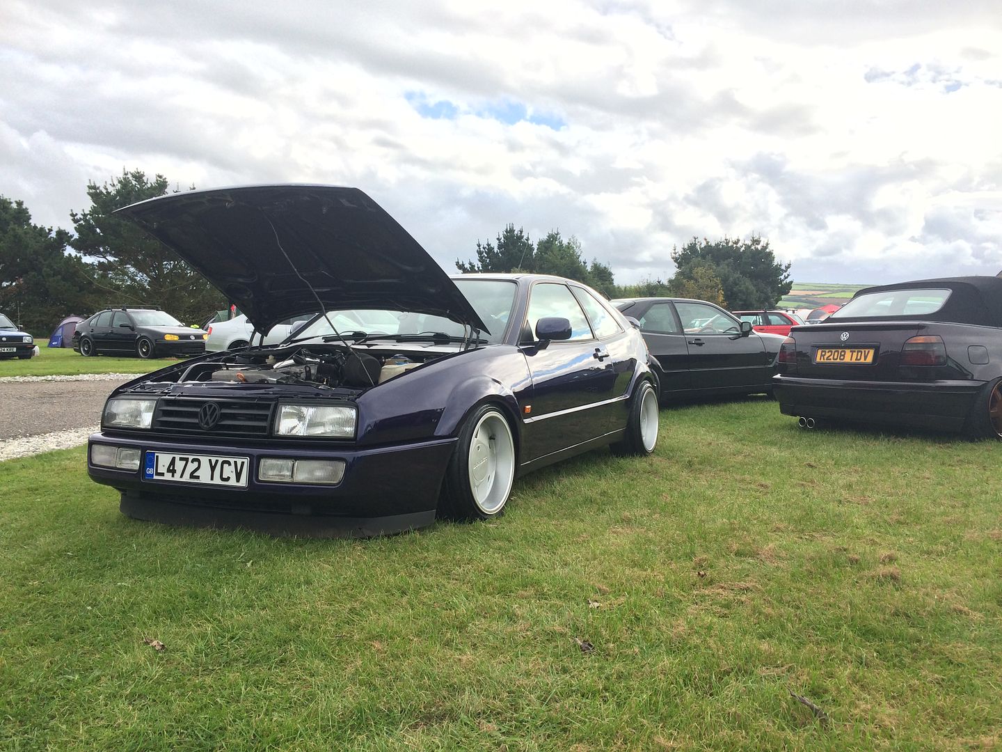

Popped down to the "Totally VAG" show at Royal Cornwall Showground today, only a hour away from me. Some nice cars there but a bit boring, no show and shine and not much going on during the day (more family orientated). Was good to see everyone none the less!
Parked up on Devon Dubshack Stand with Matt's (VDubDaisy's Owner) Corrado, Alex's 20vt Cab and Steve's gorgeous MK1 G60.
I actually had the bonnet open and all. And a "**** clipless grille" was also sourced especially for the day :lol:

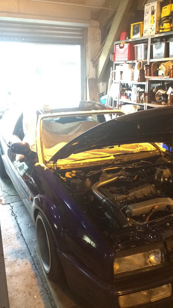

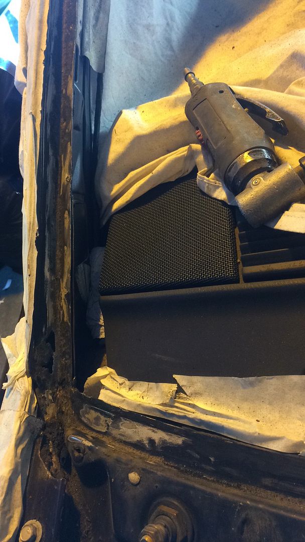

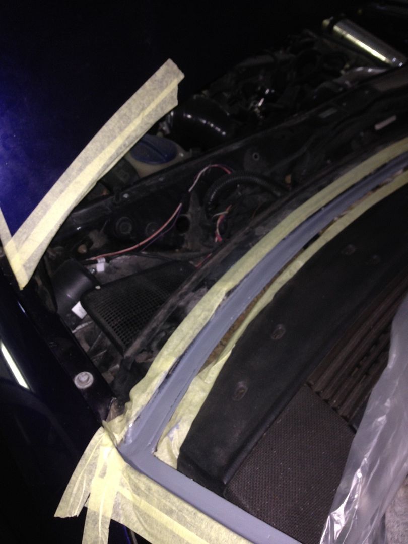

Had the windscreen replaced the other weekend. Inevitably there was some rust behind the screen, so Neil at Classics and Customs near us sorted it out for me whilst I had uni during the week!
All primered and treated before my old 16v windscreen went in.

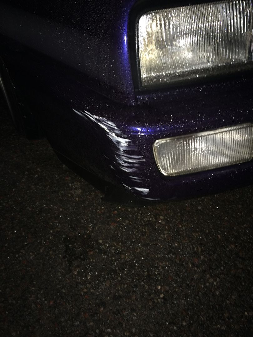

I then had a moment of forgetting how to drive out of my unit. Resulting in this. :lol:
Woops :| First time i've actually dinged any car i've owned......
Anyway, luckily Neil buffed most of it out and touched it up, which will do until I get the bumper resprayed next year!
