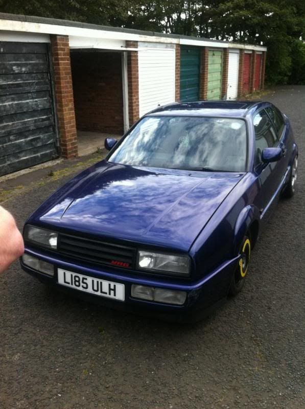

I was unsure about the colour as its had a respray in a purple/blue at some point but its pretty solid so decided to just get it!
Drove it home on the spacesaver and got a bit carried away hitting speeds you probably shouldn't do with a 4inch wide front tyre!

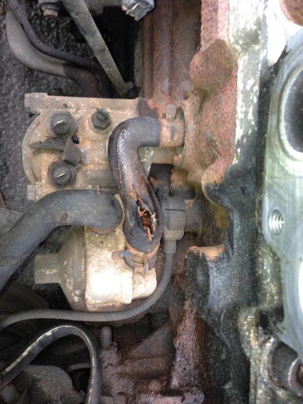

After not doing much to it for a few months and just enjoying driving it, I had a bit of a major coolant loss, top rad neck decided to snap!
Luckily I had a spare from a VR rad I had that was intended for the mk2 project, unluckily the old one wasn't so keen to be removed, the captive nuts had come uncaptive as the plastic surrounding them had cracked,
I didn't know how good the spare rad was so didn't want to risk fitting it for it to **** out coolant everywhere, so instead I just cut the bolts in the hope I could knock the nuts out and rig something up to hold
it all together!

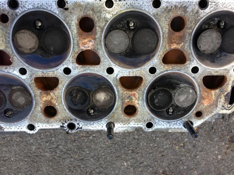

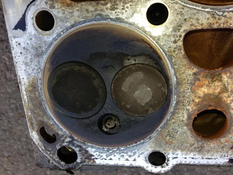

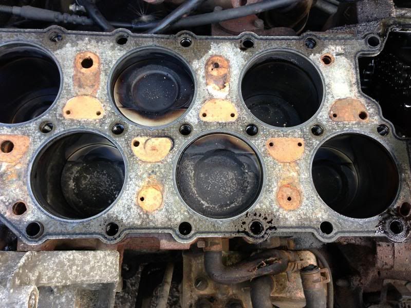

Fast forward a couple of months and disaster struck, After driving for less than 5 mins I noticed a dent in the bonnet, an outward dent! The temp gauge had dropped to zero and smoke started to appear from the bay, pulled over and popped the bonnet, no coolant and oil coming from between the head and block on the drivers side, I just got back in and drove it home firing on a couple of cylinders less than it should :(
Its been sat there for a couple of months until last weekend when I finally got my finger out and started stripping bits out ready to put a 3.2 24v lump in!
Then this weekend I took the head off, next week i'll be taking the block and box out, along with the main engine bay loom for a few modifications ;)

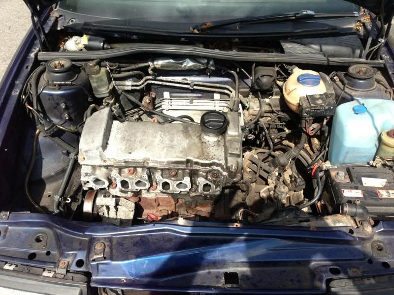

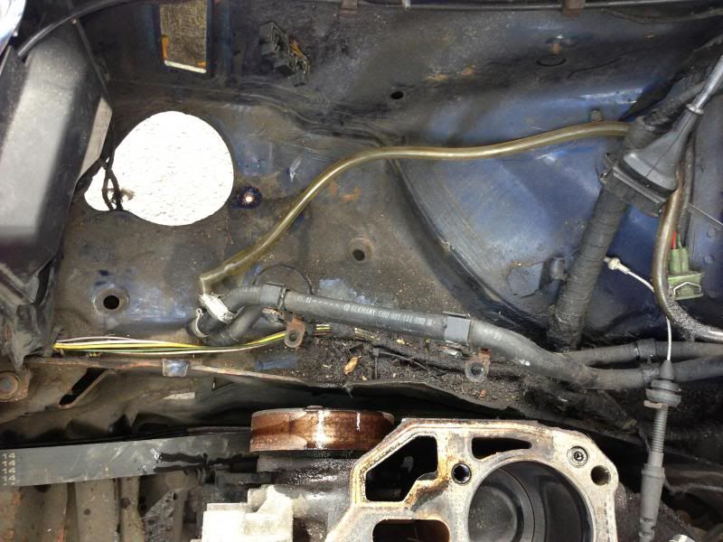

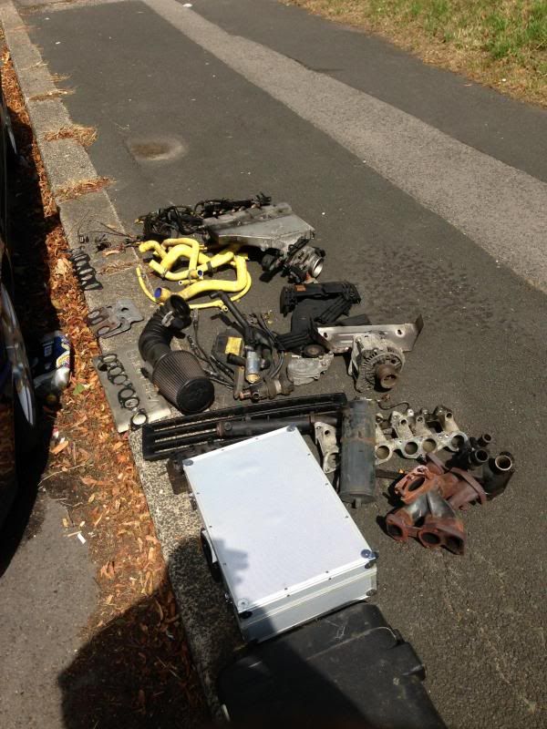

Random pics of the not so healthy looking 12v

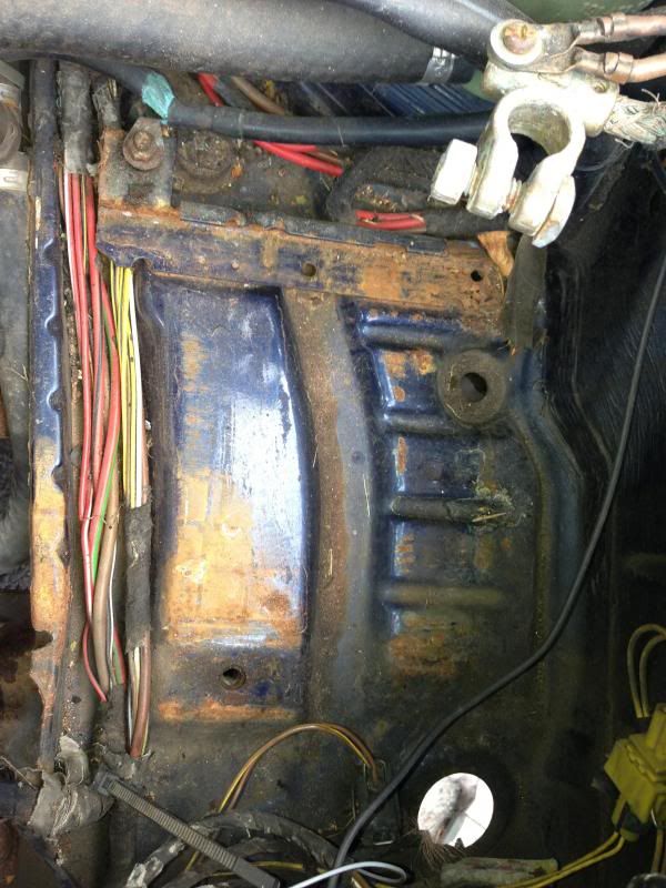

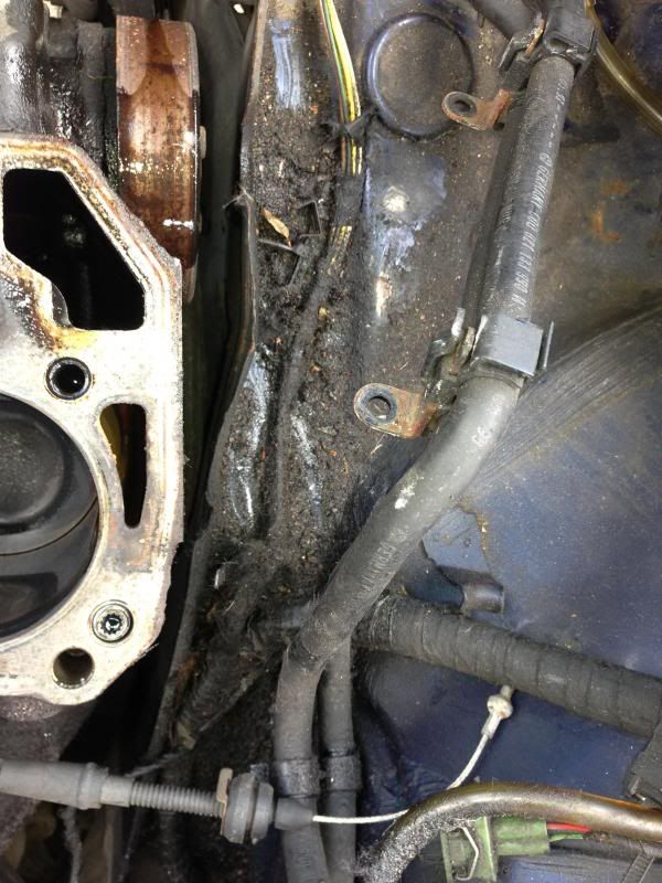

Chassis legs don't look to bad, drivers side is filthy because the ccv was venting straight into the bay via a little breather filter

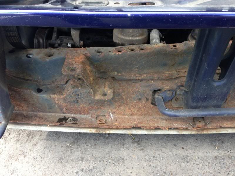

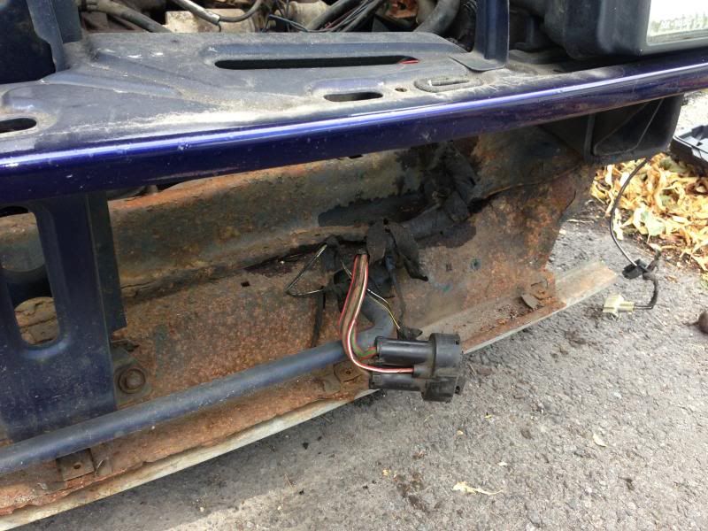

However the front is another story, rad support is pretty shot, looks like its been parked in the sea at some point!
Not too sure what to do with that, either a second hand replacement or get something made to hold the rad in place

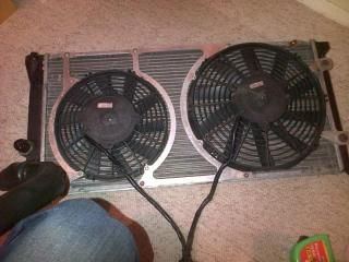

Rad and slimline fans as the standard ones are too big to fit with the 24valve lump

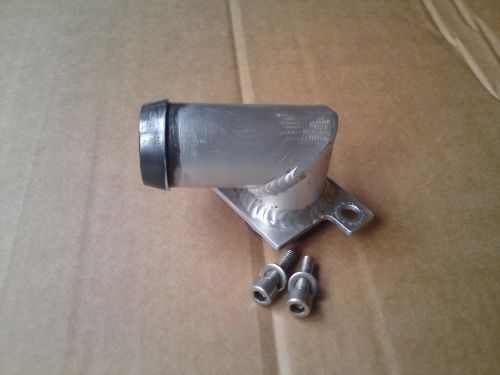

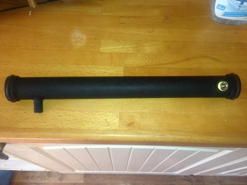

Gruven rad neck to avoid any future brittle plastic issues!

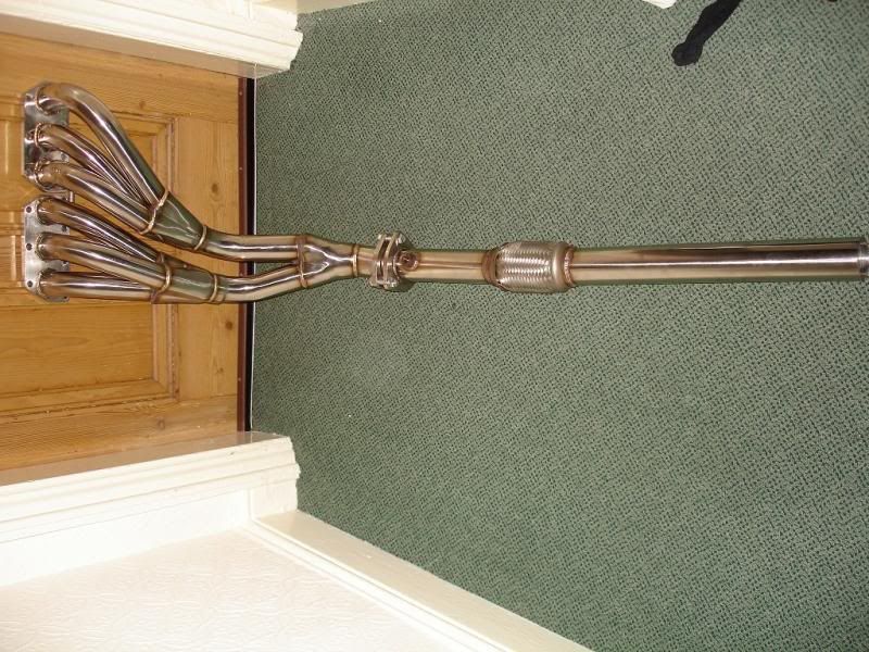

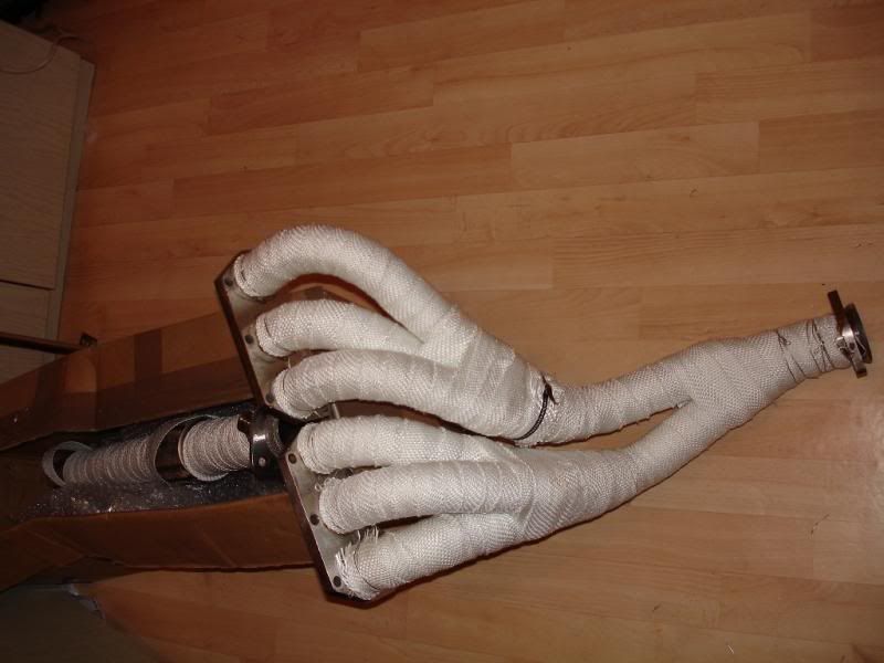

And a dubpower R32 conversion manifold and decat

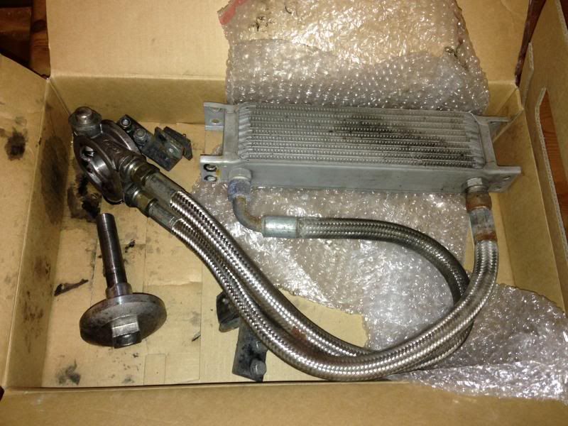

Another part left from the mk2 project, not sure if i'm going to use this or one of the coolers off one of the 6 cylinders, need to have a think about it
Thats it for now, will have some more parts arriving soon and the engine should be here within the next 2 weeks!!

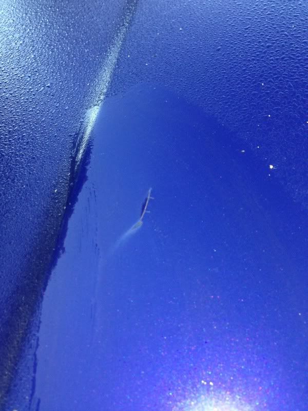

Maybe a dumb question but what caused the dent?
As you look at t from the front, the right hand side corner of the intake manifold!
I can only assume it was caused by a combination of really rough running when it started firing on less cylinders than it should and worn engine mounts :/
Cracked the paint :(

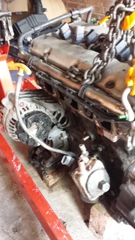

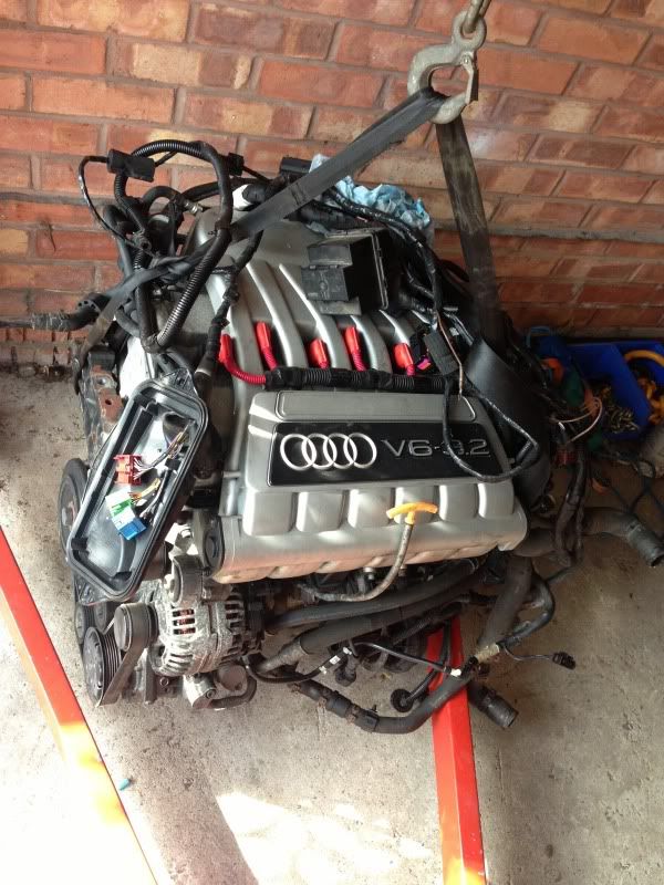

Well today was the day the engine arrived, the guys from SRS automotive in Barnsley did a great job of removing everything without any damage, they did go a bit overboard and sent the ENTIRE car loom but I won't complain lol
Can't wait for the weekend!

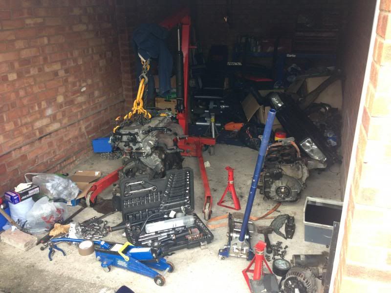

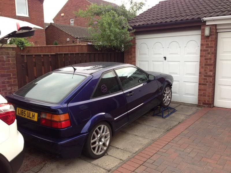

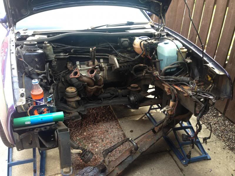

Few more pics and a bit of progress, My mate Ian has kindly let me use his drive and garage as a base, he's also been around to give me a hand with the conversion, big thanks to him :cheers:
Me and another mate towed the Rado to Ian's and abandoned it as I had to go to work, Ian stuck it up on ramps to make access a bit easier

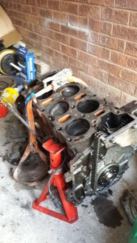

We removed the old 12v bottom end and dumped it out of the way in the garage

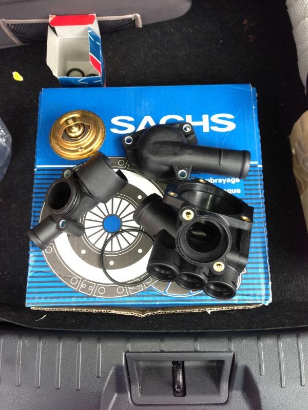

Sachs VR6 clutch kit

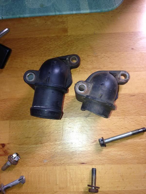

New thermostat housing parts
Fitted the flywheel and clutch kit with new bolts then fitted the VR box onto the 24v engine, we had a good laugh whilst doing it!

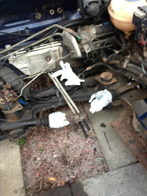

Gloved up the CV's to keep the muck out!

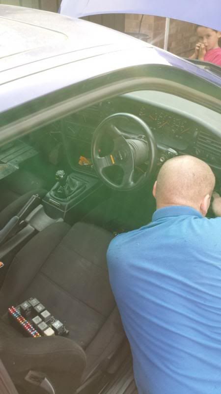

Whilst I was laid upside down inside the drivers footwell unbolting the servo and clutch mc Ian fitted the 4mo aux bracket with the 24v alternator and rado PS pump with 4mo pulley

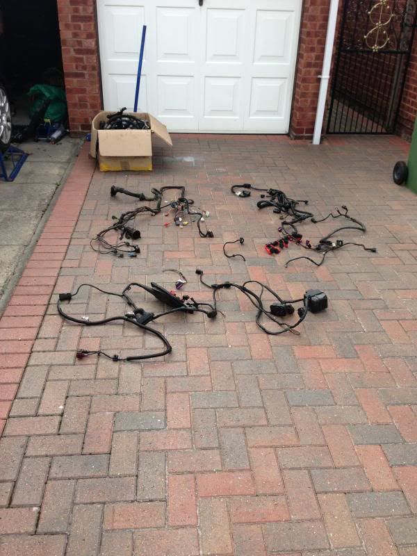

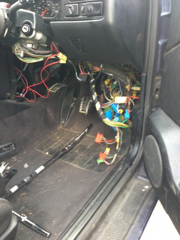

I ended up just pulling the whole fusebox out as its such a tangled mess I couldn't see what needed to come out with the engine side loom
All of the looms ready to be boxed up with the ECU and sent off to Mark at SWICT to work his magic
They were posted out on Wednesday and Mark is hopeful he will have time to sort them out and back to me by the end of next week!!

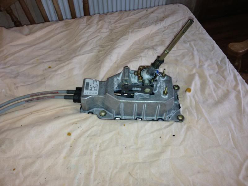

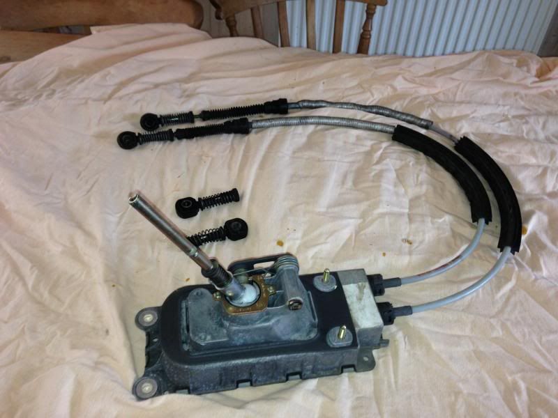

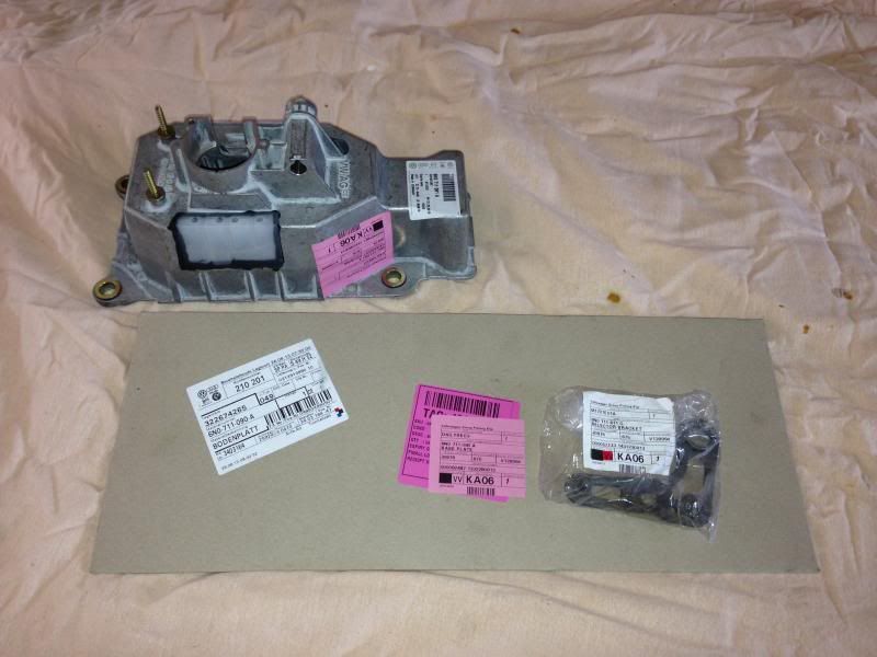

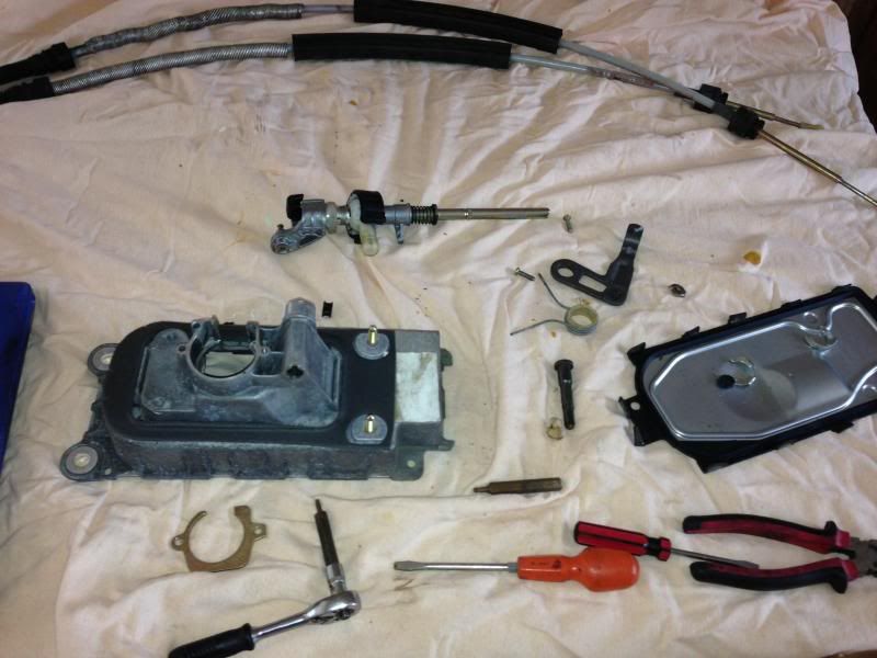

Bought a few new parts to hopefully tighten up the gear change a little, Polo shifter housing parts.
And a 2nd hand mk4 golf shifter tower
Disassembled the mk4 tower, nothing complicated and all came apart easily
All of the mk4 bits reassembled into the polo housing
I've already fitted the 02J selector to the VR gearbox and swapped the ends on the cables from the ball type to the pins to match the selector, should be ready to go once its all fitted!

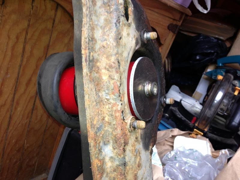

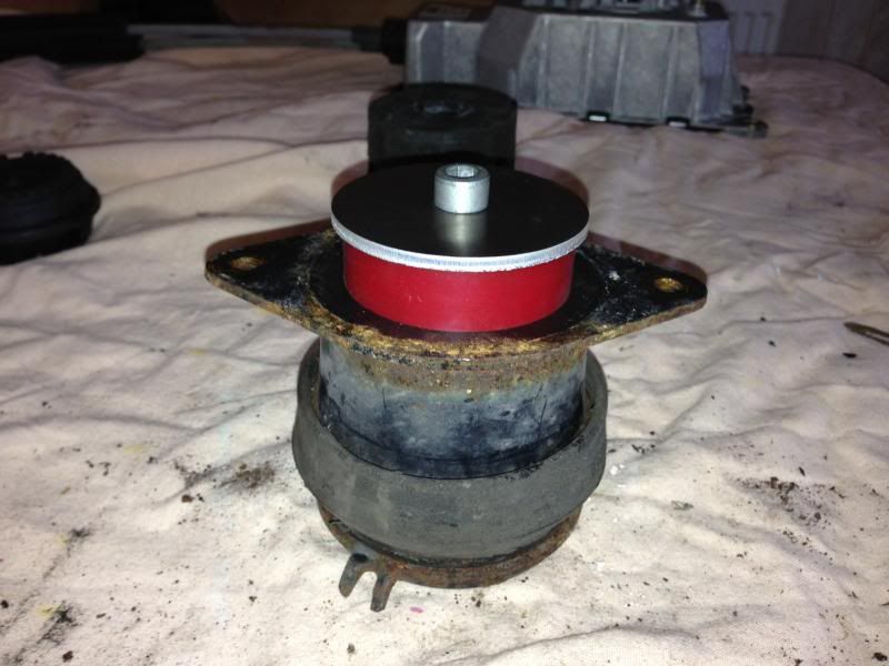

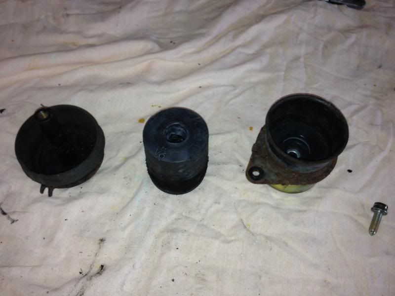

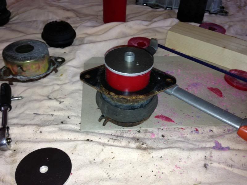

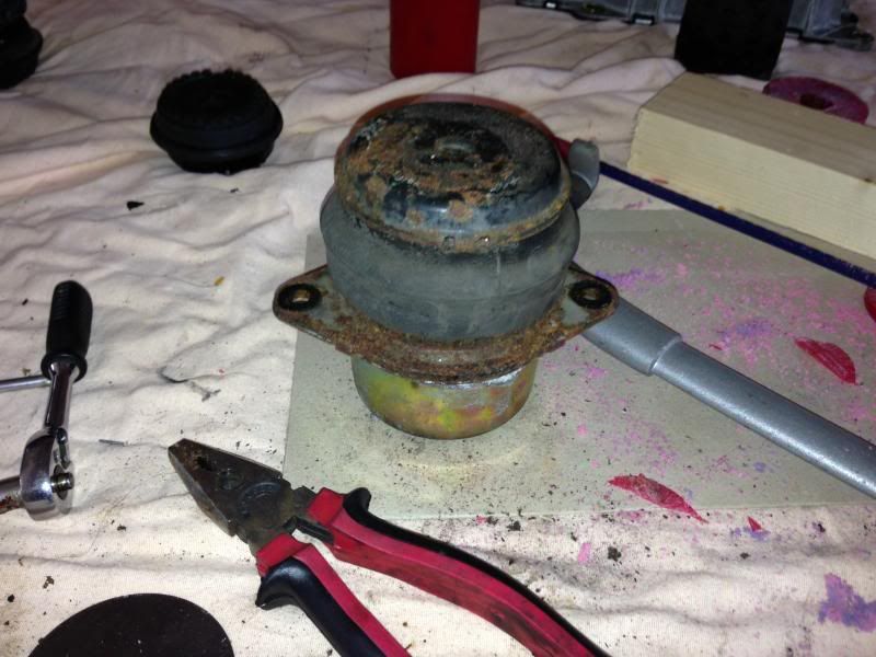

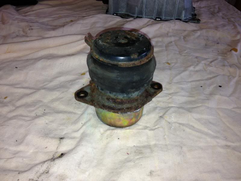

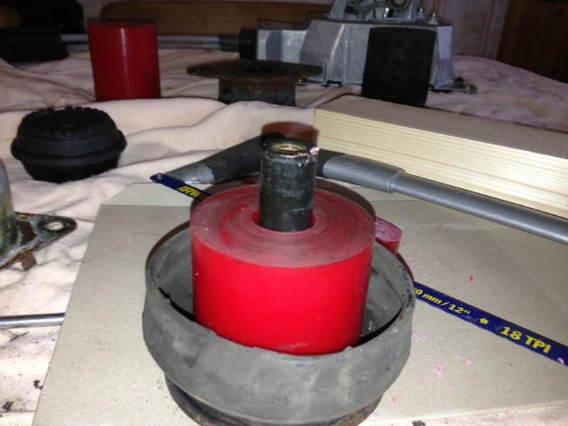

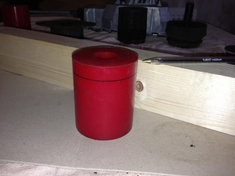

Also I bought some poly mounts from Jay Renshaw, so i've took the old mounts apart, had to get a replacement for the rear one as the bolt snapped in the top, cheers to fuzz for sorting me out along with a front mount bracket to replace another broken bit off mine lol
Rear mount before

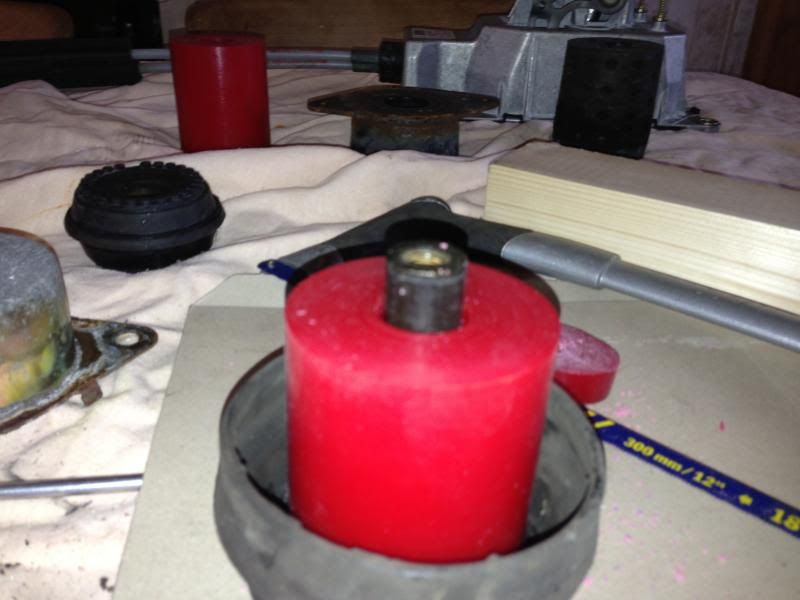

Now due to the dubpower manifold a couple of people have suggested cutting down the mount to give more clearance in the tunnel for the manifold, so i've cut 15mm off the top half of the mount
Before cutting
My very precision bit of wood for marking the poly, wood is 70mm, mount was 85mm

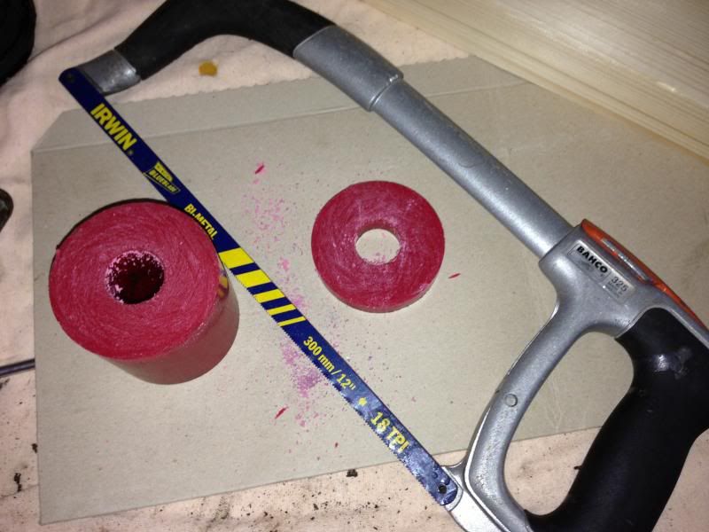

Pikey method for cutting poly but I had 3 options, steak knife, hacksaw or grinder, as you can see the hacksaw won!
After
As i've cut the upper poly the centre of the mount ideally needed shortening, drilling and re-tapping, with limited tools at home I decided on another solution. Due to an issue with the PO that Jay had to rectify for me, I ended up with a spare upper poly piece, so I simply cut a piece that was 15mm longer than the lower piece Jay supplied and used that, this means that i didn't need to shorten the centre and the bolt still has the same depth of thread to tighten into. I can't see an issue with doing it this way but if anyone thinks it'll cause me a problem please let me know why :)
Mount with original size poly then with the new longer piece and finally reassembled
Trial fitted the poly front mount too, going to attack the front crossmember with the grinder and wire brush then paint it, more for protection than looks ;)
Thats all for now!
Hey mate, by cutting the rear poly bush down, is that essentially lowering the engine position in the bay? I ask as I want to make a little more clearance between the charger I've just installed and the bonnet. Would this do the job?
Cheers
Ron
Cheers
Ron
Hi Ron,
Yes mate, obviously a 15 mm drop at the rear mount is going to decrease the closer you get to the front mount, so taking 15mm off the rear might only get you an extra 5mm at the charger, if that makes sense?
