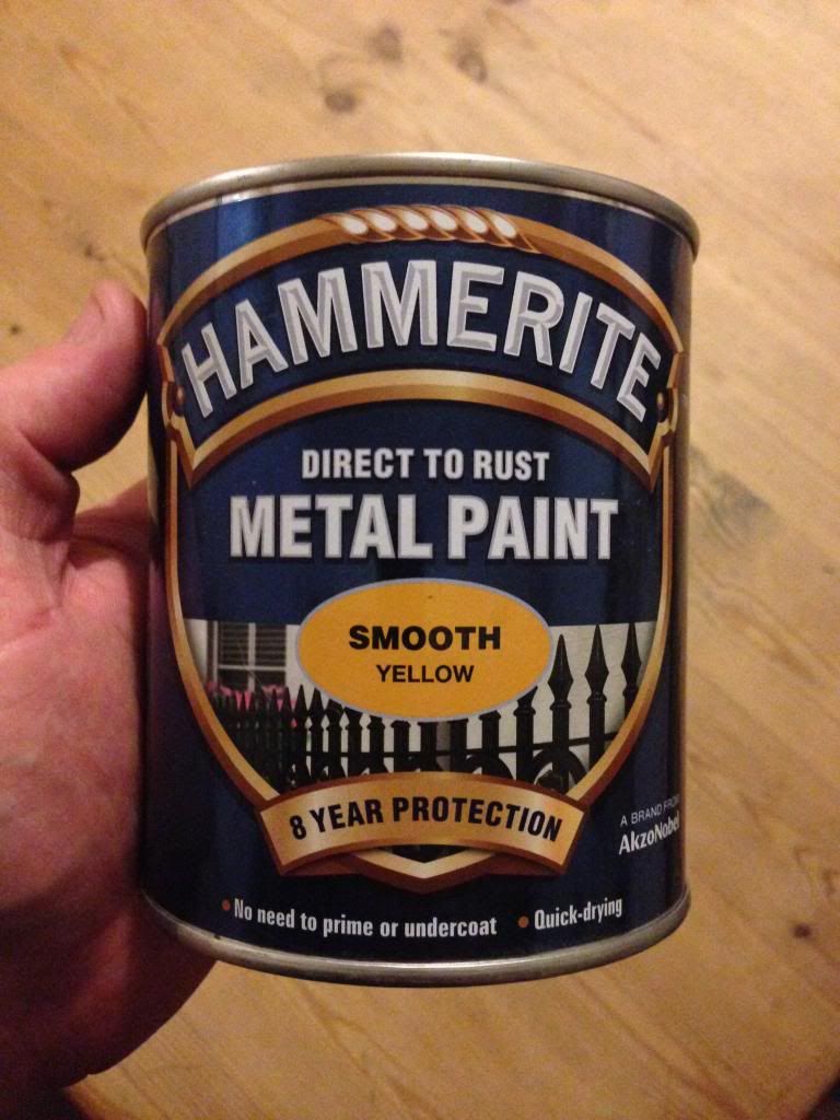

borachris 0 Posted May 29, 2014 Oh and I bought this today Quote Share this post Link to post Share on other sites
borachris 0 Posted May 29, 2014 :) You know what I'm doing don't ya mate, just in case I decide I like them lol Quote Share this post Link to post Share on other sites
