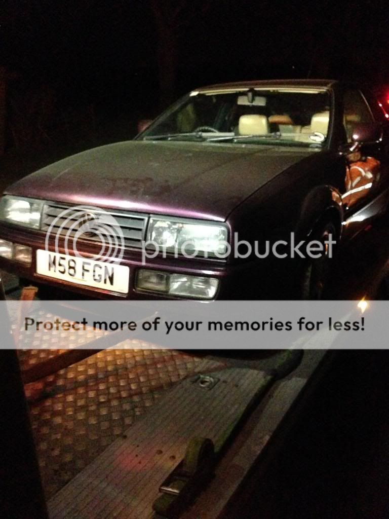

Bought this Corrado last week off a friendly Corrado forum member!

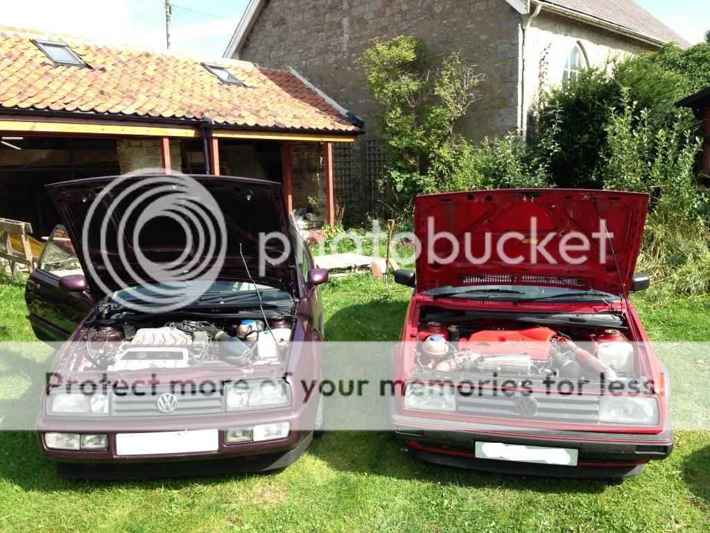

Parked next to my current Mk2 20vt that I recently finished converting. N/A vs FI!

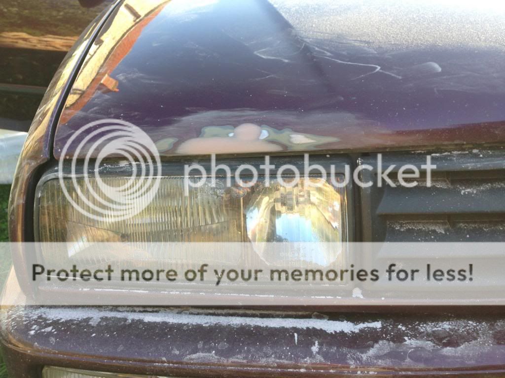

Rust broke through the paint and left the metal porous/ dimpled. So a few blobs of weld, and a good de-rust meant I could fill it properly. It's now in paint but I haven't polished it yet

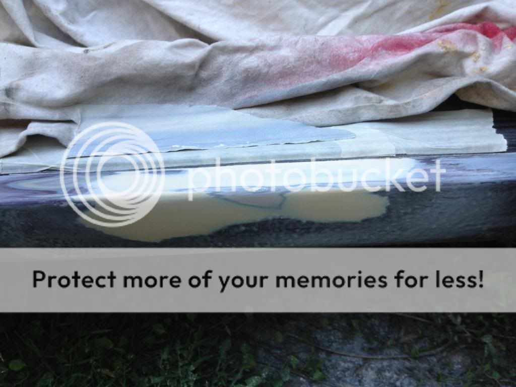

There was a large dent from some ice? on the bonnet, so I scoured out the paint, straightened the bonnet edge line and filled it properly. Has since had finer grade filler, along with paint! Again, just need to polish & blend it in (Fun! :thumbleft:)

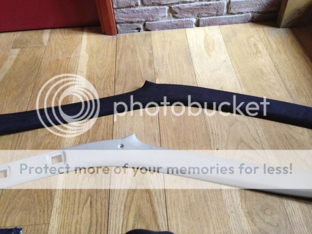

I had abit of time this evening so I did the A pillar plastic covers, and the map light surround in black faux suede. Trying to gradually reduce the amount of beige! :thumbleft:

Thanks Sean! It's actually quite hard to make it out properly, it looks alot nicer up close in person :) Here's a better pic, I agree though I'm really pleased with the outcome!
I take my words back Pat - that really does look good. How did you stick the faux suede to the plastics - did you use any base material?
Cheers! :thumbleft: I left the faux beige leather that was already on the plastics and roughed the surface up with 320 grit; it just helped the glue adhere better!

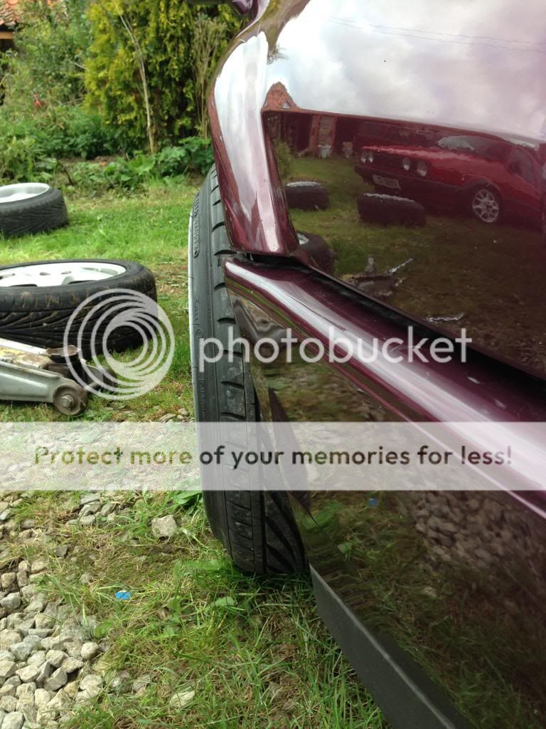

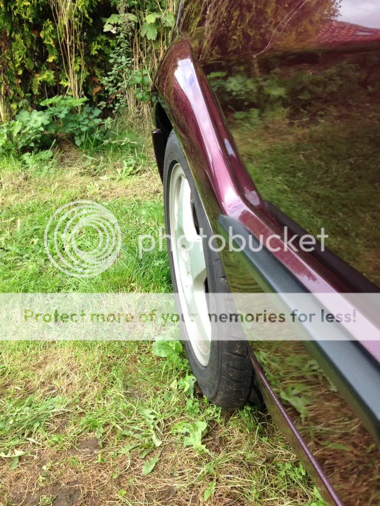

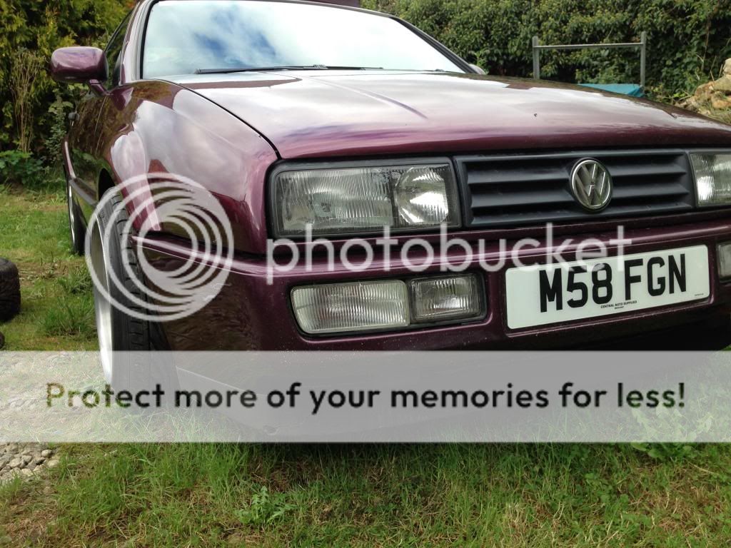

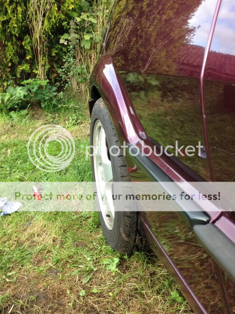

Tried on my 9J borbets, but way too much tyre poke and I don't want to mess with the arches! So I put the standard speedlines back on & fitted some 10mm hubcentric spacers on the front, and 20mm ones on the rear. Also finished polishing the bonnet where I got rid of the dent :) Going to refurbish them in gunmetal grey or similar colour as they've got corroded areas and paint defects.
poking out
Before..
After!

Looks good on the spacers mate!
I've got some 25's and 12's, can't put them on yet though because the rear beam needs moving over!
Thanks GlosterOx I'll check that when I'm next in yorkshire! :) Cheers Chris, hopefully gives it abit more stability. But yeah happy with how it fills the arches in!
Did you put a new rear beam on? I hated re-aligning it on my mk2 after a put mk3 rear beam on..
No I've not changed the rear beam, only had the car a year and I didn't even notice it was so far out until I went to fit the spacers!

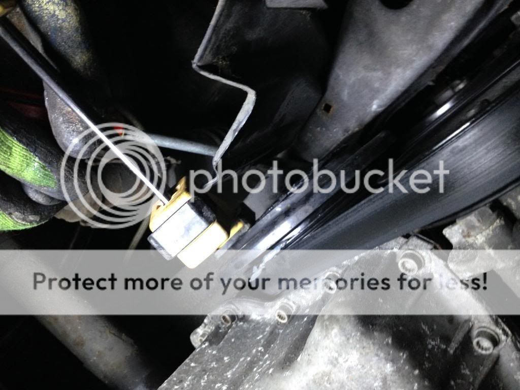

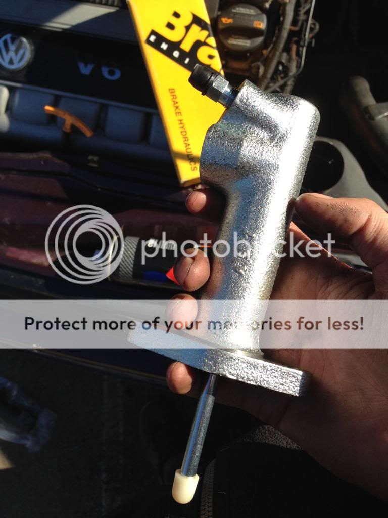

Clutch pedal wouldn't come back up and also the crank pulley weight came off so it was vibrating alot. Had to try glue it on to limp her back home after getting recovered.
Thought clutch slave or master had gone as it was displaying those symptoms, So I replaced both with new units.

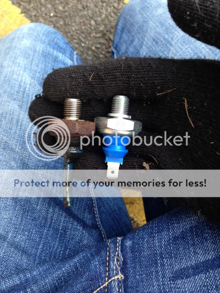

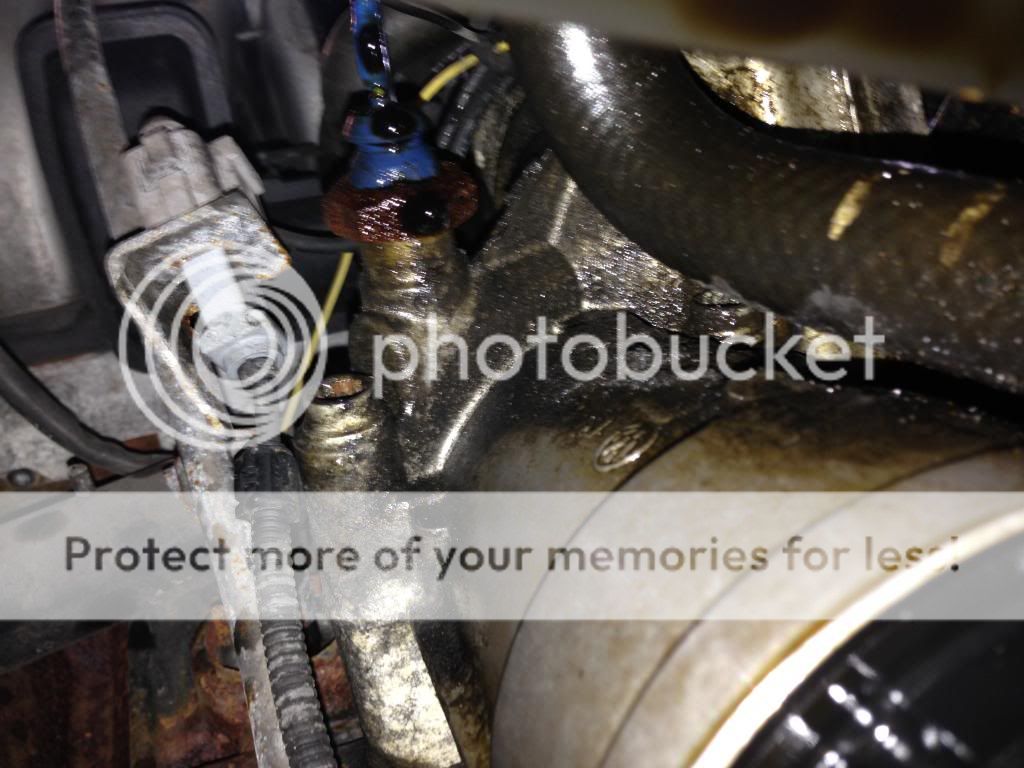

So after I replaced them and bled the system about a million times with no effect, I was abit ****ed off as it was a new clutch. So i drove it with a slipping clutch for a while, got an oil leak so sorted it. Was the pressure sensors.

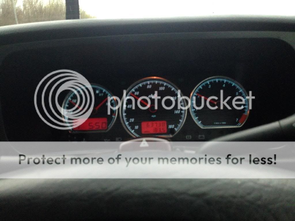

Got the DDI dials working properly again, bad connection,

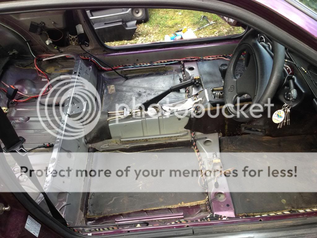

Got rid of the (not to my taste) 80's pornstar beige leather interior. Got a black cloth replacement, much better!
