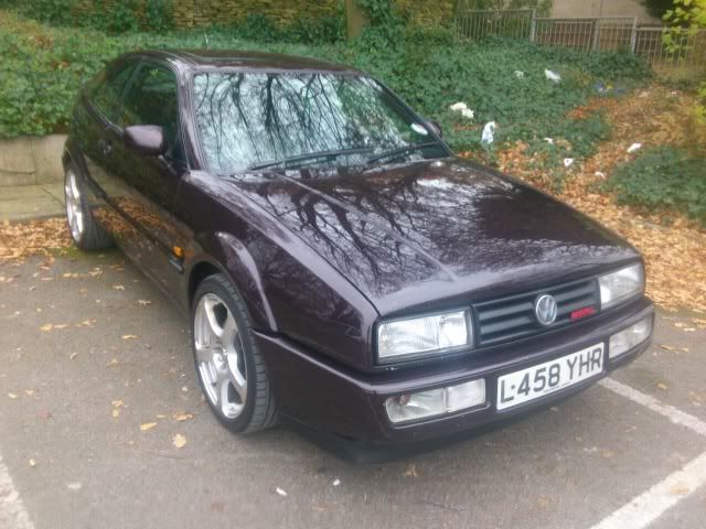

I found this:
First off the obligatory photo stop at the petrol station on the way home.
It's a 1994 VR6 is Dark Burgundy Pearl - although I must admit when I first bought it I wasn't 100% sure.
Previous owner had the car 12 years and commuted over 150miles a day so it's up to 182k now. Good news is though it had a brand new engine fitted by VW which along with all the other parts replaced at the same time cost of £8k !! It's also had a new clutch and flywheel and plenty of other service items in the recent past.
It's completely original with the exception of a custom stainless steel cat back exhaust, the owners justification was it was £100 less than what VW quoted ( yes the guy still had the car MOT'd etc at VW) Also and rather obvious are the wheels, the previous owner fitted those after cracking a Speedline and VW quoting £400+VAT for a new one!

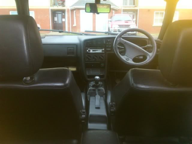

Overall condition is the bodywork needs some attention but the interior , all heated leather is wonderful, everything apart from the sunroof works.
Still, there are plenty of things to do to bring this Corrado back to it's former glory and to help ensure it is a reliable daily. First things to were give it a more serious going over and make a list of items to replace, which ended up being a side of A4 - but nothing major.

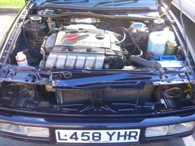

- Whilst the headlights were out I began giving a few bits a clean before the rain came back to stop play

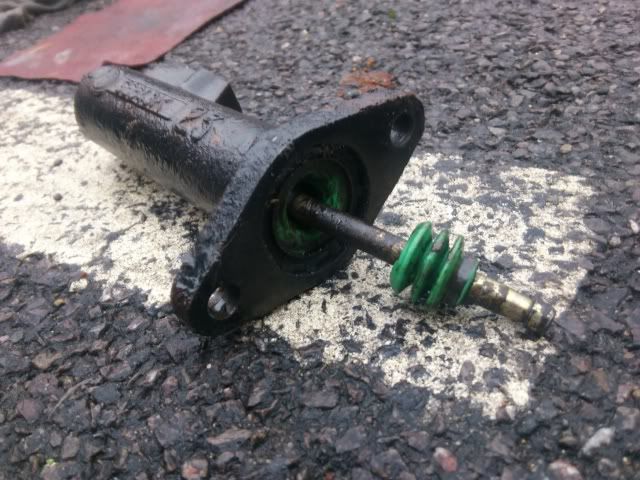

So as of Sunday, I replaced the clutch slave, the old one was well and truly knackered
Bled the clutch and checked the pedal - OOOOOOhhhh Yer it's beautiful, a nice weight and smooth action.

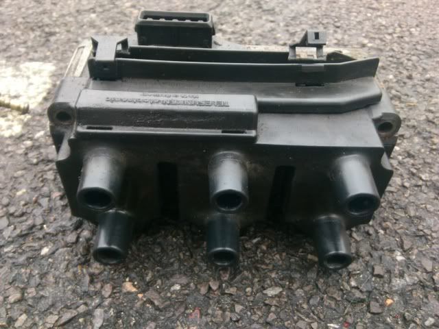

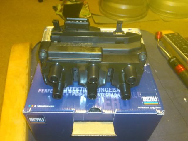

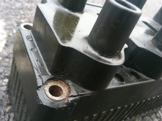

Next job was get the coil pack off to inspect, annoyingly one of the allen key bolts had been abused in the past but it was no match for my spline kit.
The offending article
And the cracked corner, my suspicion is the coil pack has been done up too tight .

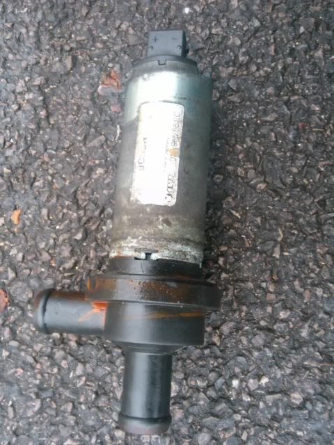

After removing the coil pack I set about tracking down the coolant leak from around the secondary water pump. Well, it turns out the pump is cracked - BIN
Not one to be disheartened I took the view that for £60 it's not the end of the world and it's another important component replaced prior to a complete failure.

The new coil pack turned up today, £130 of BERU OEM kit.

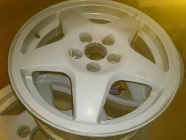

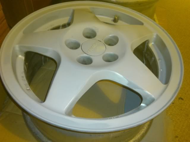

Other more positive news is I have made a start refurbishing some Speedline alloys, already spent a few hours on them to get them to first primer coat.
Still haven't decided on the colour yet...

Did plenty this weekend.
- fitted new ignition switch
- fitted new coil pack
- fitted new secondary water pump
- fitted new expansion bottle + fresh coolant
- repaired PCV filter box - the plastic box next to the ISV - mine had split and was leaking so bad the engine would barely run
- fitted new air filter
- cleaned ISV/Throttle body/intake pipe
- cleaned ten tonnes of leafs out of the other side of the scuttle from around the ECU, cleaned ECU cage
- cleaned every single earth, the battery terminals and repaired any damaged loom tape
- washed and clay barred the car - jeez the clay was black and brown - paint now feels glass like
Most importantly , I took it for it's first test drive since fitting the new slave cylinder, bleeding the brakes, topping the power steering fluid up - it was BRILLIANT.

The Speedlines are on hold now, one of mine is a bit buckled and a mate of mine has a set I can have in a few days so I'm going to wait until I have all 8 and pick 4 of the best. I'm also hunting for a set of Compomotive/Speedline motorsport inspired wheels that share a design with the OE speedline.

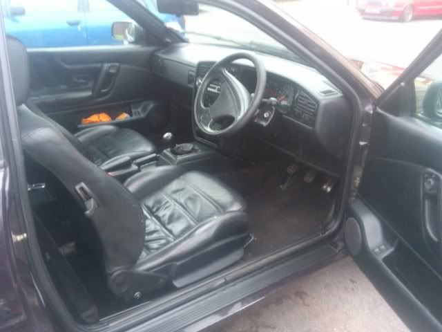

Did a bit of cleaning today as the previous owner was a smoker who used the entire interior as a ash tray. No need for before pictures as it easy to imagine 12 years of smoking means tobacco all over the floor and a ashtray bursting at the seams is rather manky.
All the seats were out, carpet shampoo'd and vacuum'd , dash was wiped down. I need to organise some more leather cleaner in order to finish the job buts it's million times better.

^thanks. I had enough leather cleaner to do the back seats, centre armrest and rear door cards but not enough for the front so that's still to do.
I still need to find a new leather gearknob , upgrade the stereo and decide if I'm going to put a Momo steering wheel in (none of this stupid 280mm lark mind) or see if I can get the original steering wheel retrimmed. Once that's done I'm pretty happy with the interior.

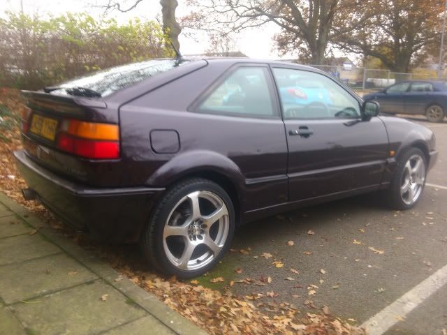

a few pictures of the outside now it has had a quick clean
As you can see the drivers door rubbing strip needs to be stuck back on, the indicators swapping (got those already), the drivers headlight surround isn't clipper on properly and something needs to be done about the wheels/ride height.
Oh and i must sort out the heaters which are practically non existent.

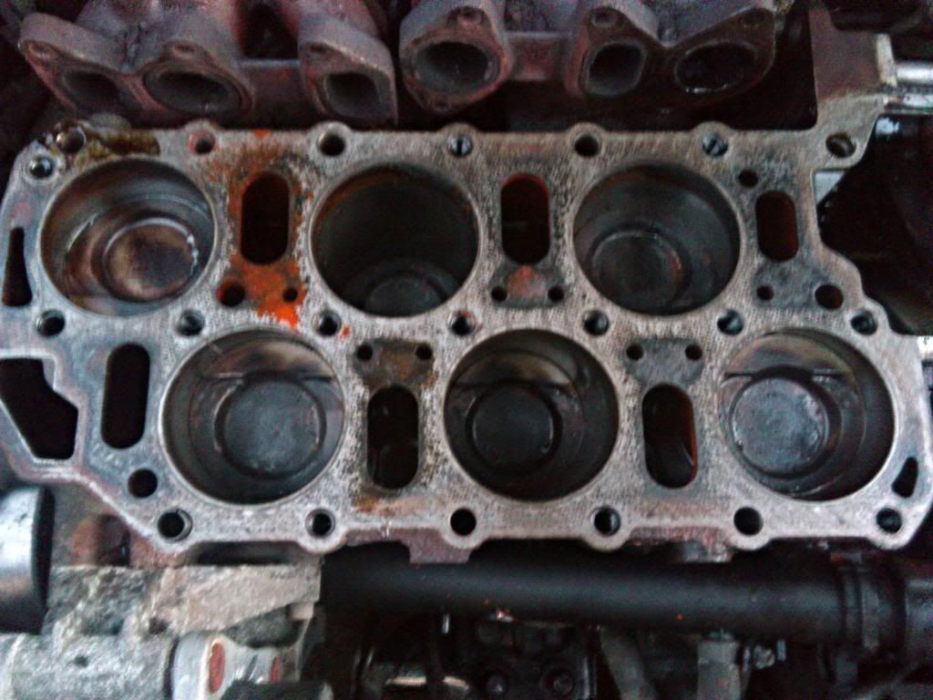

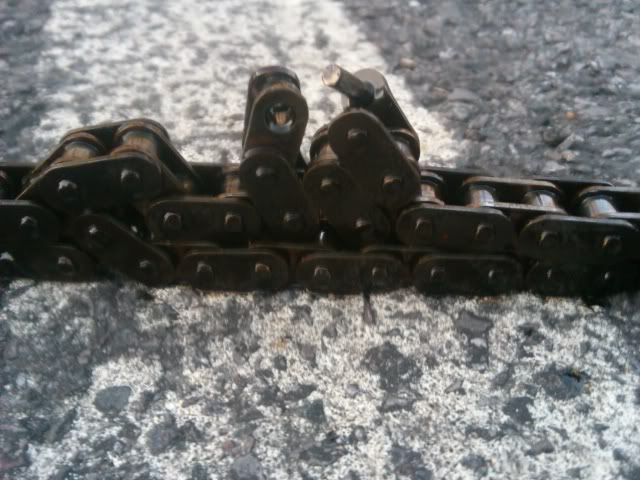

The lower timing chain snapped!!!!! Although when the engine first died it wasn't apparent that was what happened. There was a distinct lack of BANGS or knocking just 20mph>0 in a few yards after I switched the engine off. I tried to restart it once but the engine sounded a bit like Hammond's NOVA. The AA arrived (within 10minutes which is ASTONISHING) tried to turn it over again before dragging me home
Once at home I tried checking the compression on cylinder number 1 and got ZERO not even a bit of movement from the needle.
That confirmed that it was time to strip the engine and get to know a VR6 innards.

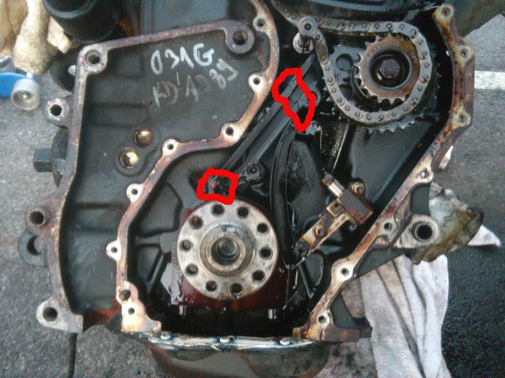

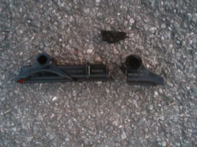

Inlet & rocker cover off revealed, this, a slack looking chain.

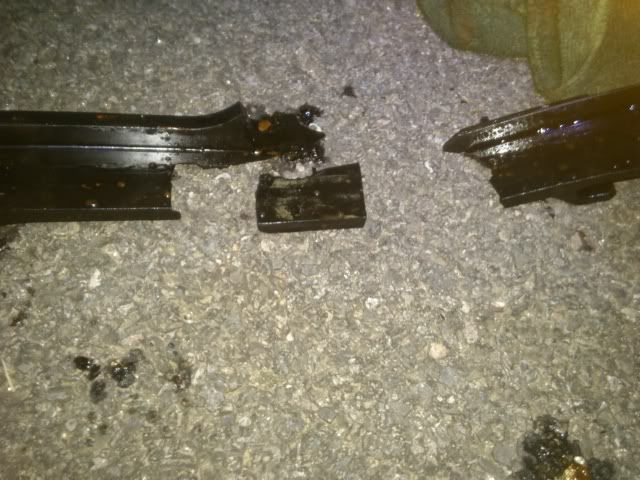

Then the next find... where has the lower timing chain gone...

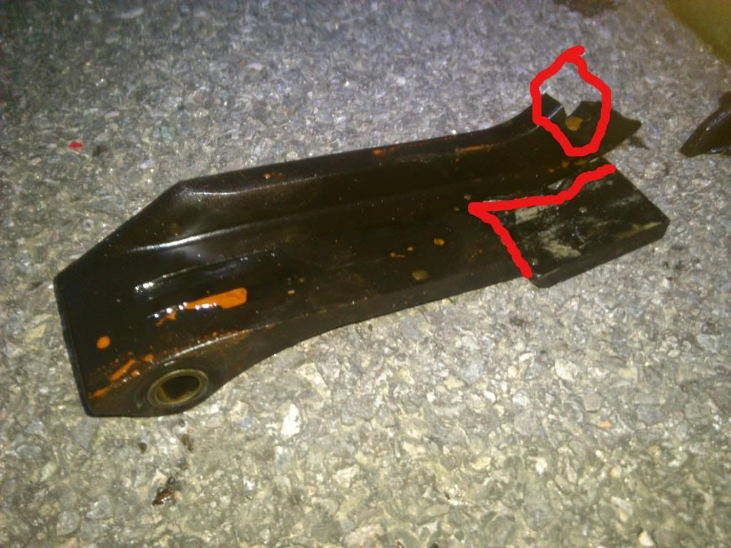

Umm this is meant to be in one piece upper guide.
The plastic that is within the red ring has disappeared and must be somewhere!
Off came it's head, that's 5 of the 12 valves wrecked
After that it was time to see how many (if any) pistons survived, ALL OF THEM WOOOOOO HOOOOOOO my biggest concern was that the bottom end would be wrecked.

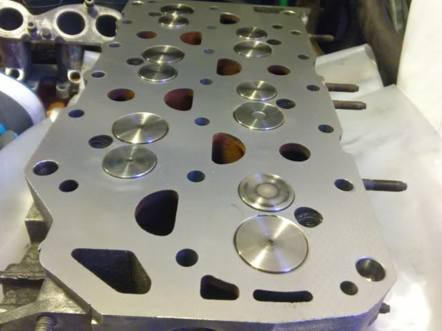

Got my head back from the machinist, 7 new valves , 4 new valve guides, 40thou skim and a proper clean.

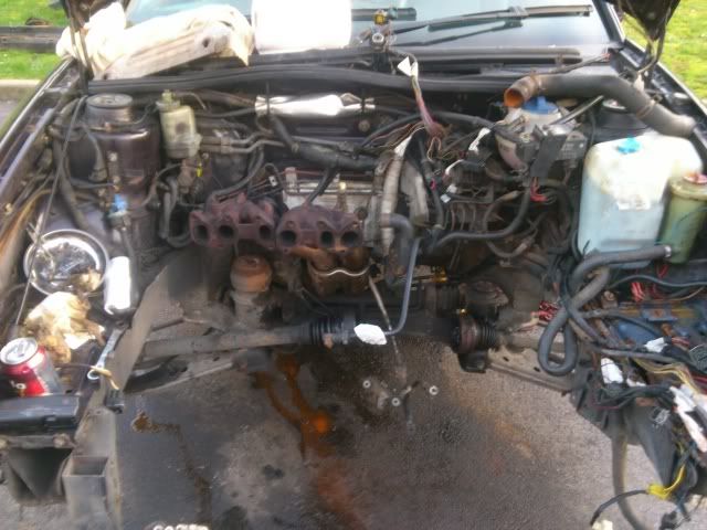

Cracked on and got the engine/box out and front end off after having few issues with a couple of the driveshaft bolts and continuing my bad luck with engine mounts - ANOTHER sheered bolt to deal with ..grrrrrrrrrrr
Confirmation that the bottom chain snapped first then the chain wiped out all the tensioners. red circles highlight cracks and missing sections

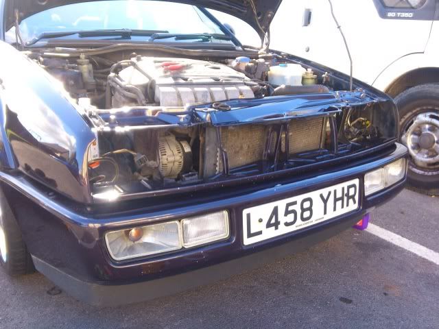

Also decided that whilst the front end is off I'm going to have a new battery tray welded in. Then the whole bay will be stripped/repainted where needed and covered in clear wax oil.
Fortunately the chassis leg is spot on

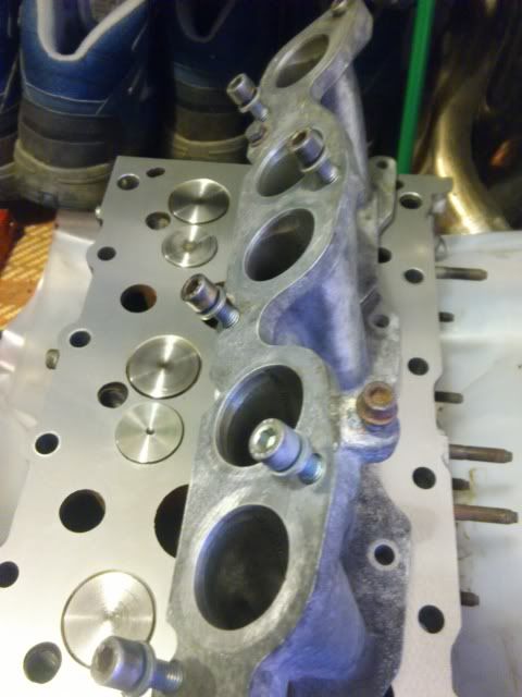

Also made a start at port matching the inlet manifold and giving it a clean.

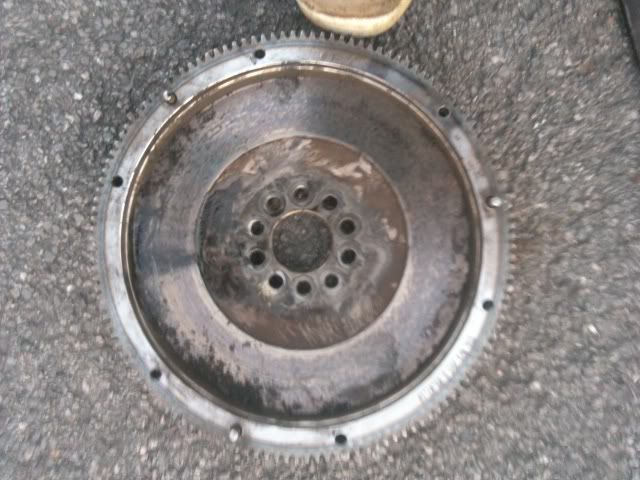

Finally my flywheel, off to be lightened a bit... it's stamped up Nov 2010 when the clutch was changed but the clutch is junk - very nearly on it's last legs.
