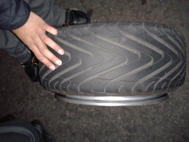

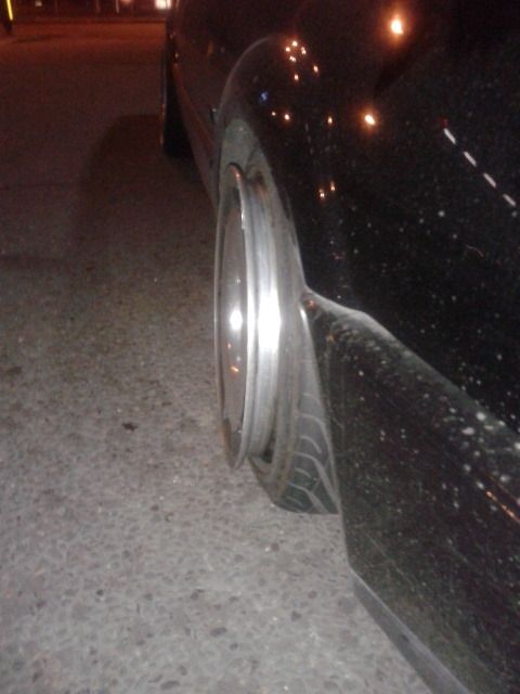

vw bobby 10 Posted December 2, 2013 Hi All Driving home from work and basically it was running low on air, went to the petrol station to put air in, but the valves are too small. Tried nursing it home and 50 yards from the petrol station this happened: Quote Share this post Link to post Share on other sites
kerrly 0 Posted December 2, 2013 Stretch tyres???? Or it could be the sidewall is damaged as a result of driving whilst flat? Quote Share this post Link to post Share on other sites

VW_OwneR_85 2 Posted December 2, 2013 air pressure is what holds the tyre in place, if you had a wider tyre then it probably wouldn't of popped off the bead the way it has there, unless im missing something here like the side wall has blown out? , Quote Share this post Link to post Share on other sites
vw bobby 10 Posted December 2, 2013 No that is exactly what happened, low air Quote Share this post Link to post Share on other sites

bristolbaron 11 Posted December 2, 2013 hmm.. is it too early to say i told you so? theres really no issue running a decent stretch providing you stay around 38-40psi. AND CHECK REGULARLY! You are the reason people say stretched tyres are dangerous! :lol: Quote Share this post Link to post Share on other sites
vw bobby 10 Posted December 2, 2013 hmm.. is it too early to say i told you so? theres really no issue running a decent stretch providing you stay around 38-40psi. AND CHECK REGULARLY! You are the reason people say stretched tyres are dangerous! :lol: Yes I agree if I want to run stretch tyres, I will be putting 38-40psi in and checking regularly Quote Share this post Link to post Share on other sites
