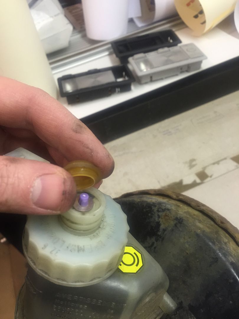

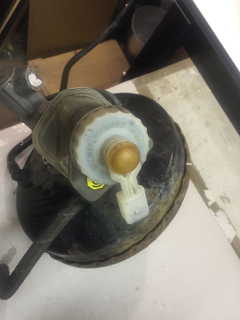

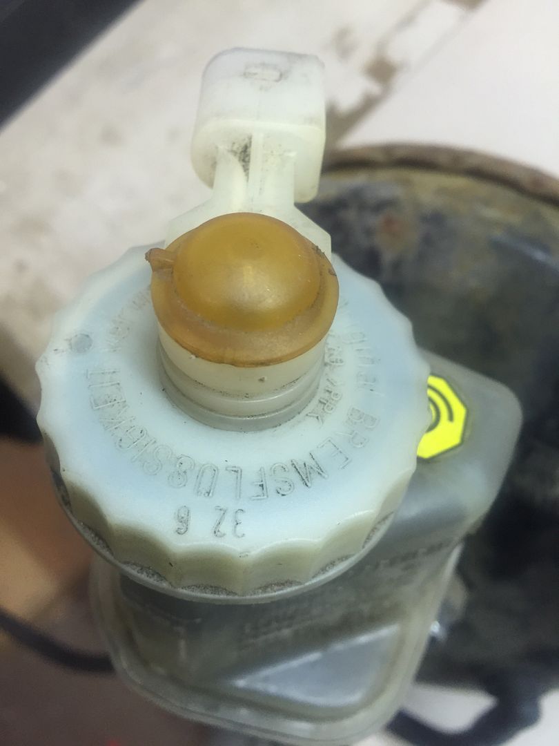

easypops 8 Posted July 28, 2015 Fairly sure(at least I hope) that I removed this when I robbed the teves20 stuff from the old (late)golf VR I had. I'll look tonight and get you a number/pic hopefully Quote Share this post Link to post Share on other sites
Jim Bowen 1 Posted July 28, 2015 Just looking at this pic iirc the corrado wire plugged into the cap before Quote Share this post Link to post Share on other sites
Jim Bowen 1 Posted August 11, 2015 anyone know or got a pic of there teves20? Don't think mine came with a lid, i did have the corrado lid but lost it for the moment, and previously with the wires plugged into the lid the handbrake light was always on unless i unplugged it Quote Share this post Link to post Share on other sites
easypops 8 Posted August 11, 2015 Ah, sorry mate, totally forgot about this, I'll get a pic etc later on Quote Share this post Link to post Share on other sites
easypops 8 Posted August 11, 2015 Here is the pictures mate, doesn't seem to be a part number on the cap though. Very similar to the Corrado one. Quote Share this post Link to post Share on other sites
Jim Bowen 1 Posted September 27, 2015 Cheers for pics. I bought another corrado lid and it worked fine. Found my original lid this weekend. Car is running now so got round to checking the abs install. All seems good apart from abs light stays on. Did a scan with vcds and it says both front wheel sensors. The ones i fitted were corrado ones from gsf. Not sure what to check apart from wiring. Is the a way to test the sensors? Quote Share this post Link to post Share on other sites
