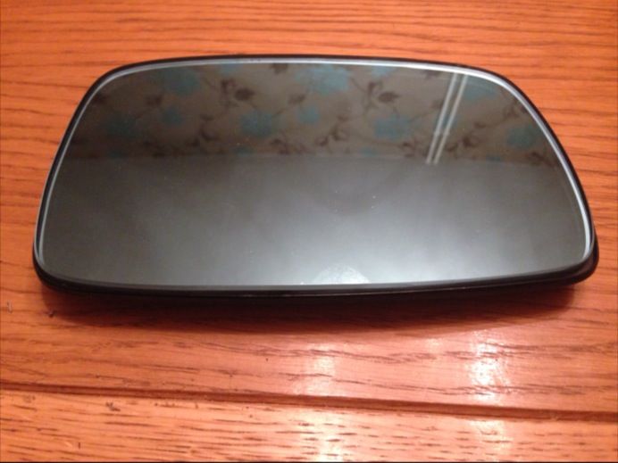

Jamie 1 Posted January 24, 2014 Mine arrived today and they do look decent enough quality. I did order the plastic backing but opted to use the original ones. Had to cut new slots for the heating element terminals and the glass is a very slightly different shape on one corner but you'd never notice unless it was pointed out and other than that the fit is excellent. One thing I did do was use a small piece of double sided tape on the second one I did, as the adhesive backing didn't quite reach the edge of the plastic mounting. All in all though I'm very happy especially for £8.50 a side delivered :) Quote Share this post Link to post Share on other sites
davidwort 0 Posted January 24, 2014 Mine were a bit flat along the top edge, genuine glass being more curved, only a mm out but initially noticeable, what's yours like? Quote Share this post Link to post Share on other sites
Jamie 1 Posted January 24, 2014 If you look at the bottom right hand corner David, the glass has a slightly different radius to the backing. Funnily enough it looks a lot worse in the picture and it's not actually that bad in reality. I can live with it anyway and it's a vast improvement on what was there before. Quote Share this post Link to post Share on other sites
davidwort 0 Posted January 25, 2014 Looks pretty good to me :-) Quote Share this post Link to post Share on other sites
