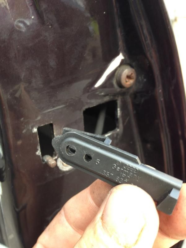

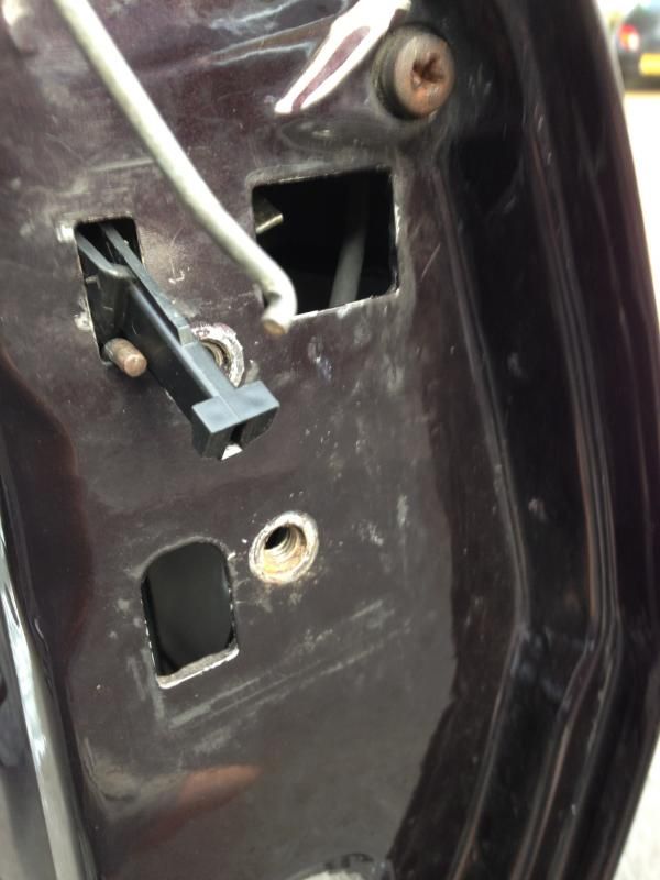

robrado974 1 Posted September 18, 2014 I got a couple of pics today , there must be someone on here that can help . Im starting to wonder if i will have to drill out the rivets on the doors so i can gain access to these parts . Quote Share this post Link to post Share on other sites
swiftkid 1 Posted September 18, 2014 Well that plastic bit is only to lock and unlock so it only pushes the lever up and down. That bits the easiest bit, doing the door release I found an absolute pain in the arse. What are you struggling with exactly? Looks like you have it right in the top pic though Quote Share this post Link to post Share on other sites

swiftkid 1 Posted September 18, 2014 I'm struggling to remember how I did it all. The door mech is massively fiddly, you have to prize out a catch from the mechanism and hook the rod from the interior door handle into it, the vertical rod will only need to sit in that plastic bit to move it up and down. You have to sort out the door catch first then push the lock mechanism into the plastic bit. If that all makes sense? Quote Share this post Link to post Share on other sites
robrado974 1 Posted September 18, 2014 It's a real struggle . What I'm trying to do is , push the plastic pivoting piece into the lock , insert the lock , then try and attach the two rods while trying to hold all the parts together at the same time . Quote Share this post Link to post Share on other sites
swiftkid 1 Posted September 18, 2014 Nah, the lock goes in last, the plastic bit should just sit in position so get the rods attached, then attach the interior handle rod, then lastly push the mech into the door and the plastic bit. Quote Share this post Link to post Share on other sites
Jim Bowen 1 Posted September 18, 2014 Am sure I attached the plastic bit to the rod that goes to door pin. The rod just sits in the hole and I think the plastic bit has a clip on it. I seem to remember fitting it then having to turn it to engage the clip. Then put the bottom rod that goes to interior handle onto the lock part. With it like that you can pull it outwards and slip the lever bit into the plastic bit. Dunno if that makes any sense but I have taken these bits off a few times and don't really remember it being too hard. I've got new bits to fit so will be doing both sides soon. Not sure how desperate you are to do it. But I can get pics and refresh my memory. Quote Share this post Link to post Share on other sites
robrado974 1 Posted September 18, 2014 Right , so when the plastic piece has the rods attached to it it's basically floating on the inside of the door skin . You then insert the door lock , so the metal prong slides into the plastic part . One rod goes up and the door pin screws onto it , the other goes down and into the central locking pump . So when you press the unlock or lock on the fob , both pins can pivot on the plastic part up and down .The long rod goes to the door pull , that's easy enough obviously . It's attaching both rods into the holes of the plastic part that is proving difficult . I guess perseverance is the key . Quote Share this post Link to post Share on other sites

swiftkid 1 Posted September 19, 2014 No, both go to that plastic bit, I know because when you push the door pin down it pushes against the vacuum of the pump. It's all coming back to me now Quote Share this post Link to post Share on other sites
Roger Chatfield 0 Posted September 19, 2014 (edited) Looking at this pic Rob i wonder if you are better off removing rod 8, attaching it to bit 7 and then poking it back up the hole rather than trying to connect it in the door aperture. Rog. Edited September 19, 2014 by Roger Chatfield Quote Share this post Link to post Share on other sites
robrado974 1 Posted September 20, 2014 swiftkid said: No, both go to that plastic bit, I know because when you push the door pin down it pushes against the vacuum of the pump. It's all coming back to me now If it's all coming back to you , get over to my house and fix mine , Hull isn't that far , I can't come to you as mine is sorn . Seriously though yes this is what I've been trying to explain . Both rods connect to it , that's what maks it so difficult . Thanks for the pic Rog, very kind of you mate . I'm going to try again on Sunday ! Quote Share this post Link to post Share on other sites

robrado974 1 Posted September 23, 2014 (edited) If anyone has a car that has the door cards off at present , could i ask you to spare a few minuets and have a look at how these parts fit together . Im at a total loss now . By the look of the diagram it shows the plastic part should go on to the prong on the latch and be inserted into the hole in the door ?. If i do this it wont go all the way in and the metal prong will not move easily. So ive tried the other way , but how an earth you are supposed to attach it i will never know . Also when i offer up the plastic part with the top rod in place it seems to be too tight against the door , i have two spare rods , when you put them together you can see that they are different , obviously left and right .Non of these seem to be right . Now i consider myself to be of average brightness , i certainly have alot of common sense ,i have removed a lot of parts on this car and replaced them on my own , but people on here are putting in engines in by themselves and im stuck on how to fit two pins and a door latch for gawd sake !!!,i do like problem solving and working out why something does not work weather its at work , home or whatever . You would not want to see a fellow enthusiast in a padded room rocking to and fro would you , im sure this poxy thing is going to send me there . Ok bit over the top ,but it is driving me round the bend . Any help would be much appreciated .edit , any more help I should say Rob Edited September 23, 2014 by robrado974 Quote Share this post Link to post Share on other sites
swiftkid 1 Posted September 23, 2014 You have removed the handle havnt you? Because that will stop the mechanism from going in as the slam lever rests on the door catch lever. Like I said though, you will not get the full lock mechanism in with the plastic catch connected because the interior door handle pull will be impossible to put on. What you need to do is connect the rods to the plastic catch, you won't be able to just move the catch up and down because of the vacuum pump. Quote Share this post Link to post Share on other sites
