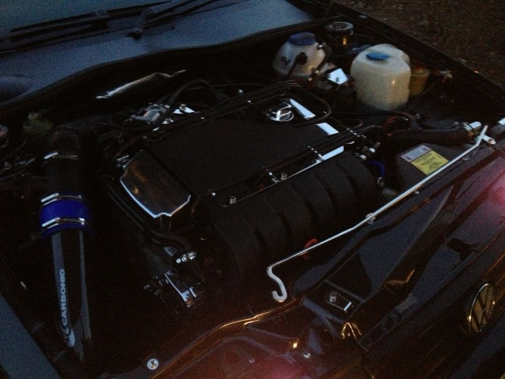

And Daves mint, MINT VR6!!!!
Look at the engine bay!!!
um thats nice,i wouldnt mind a chrome bonnet stay also how do you keep the rocker cover etc so clean

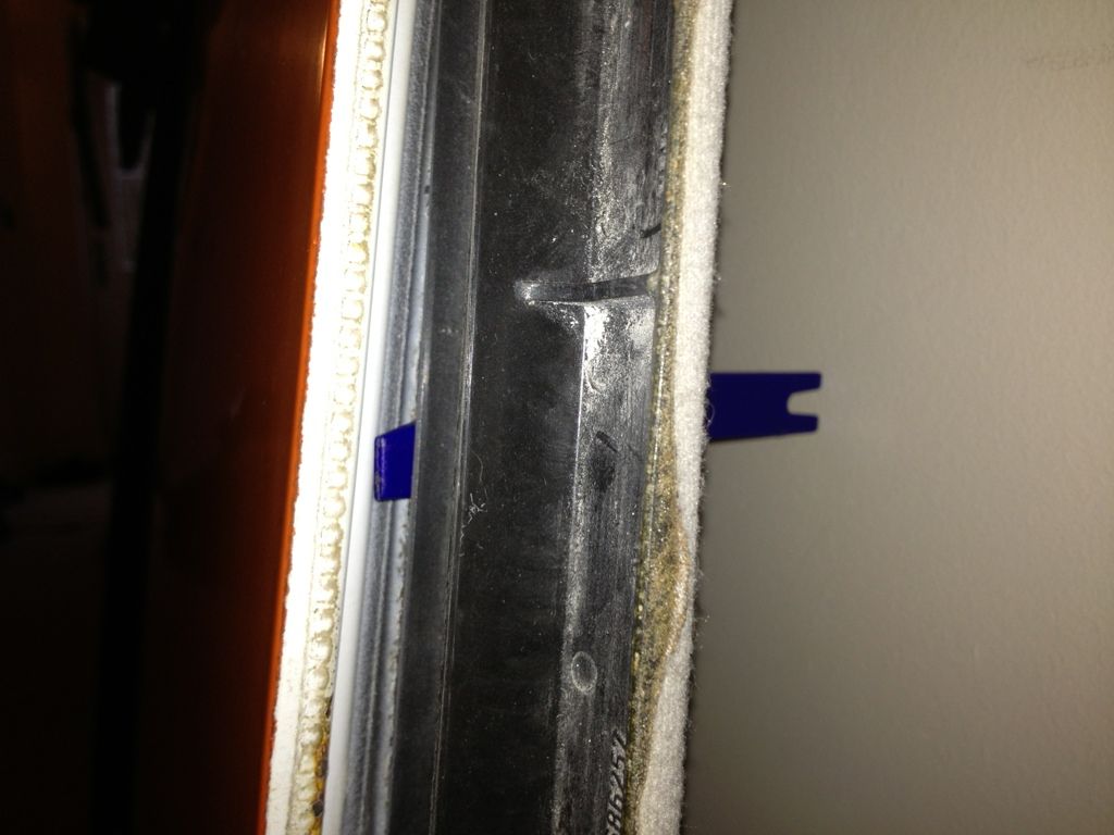

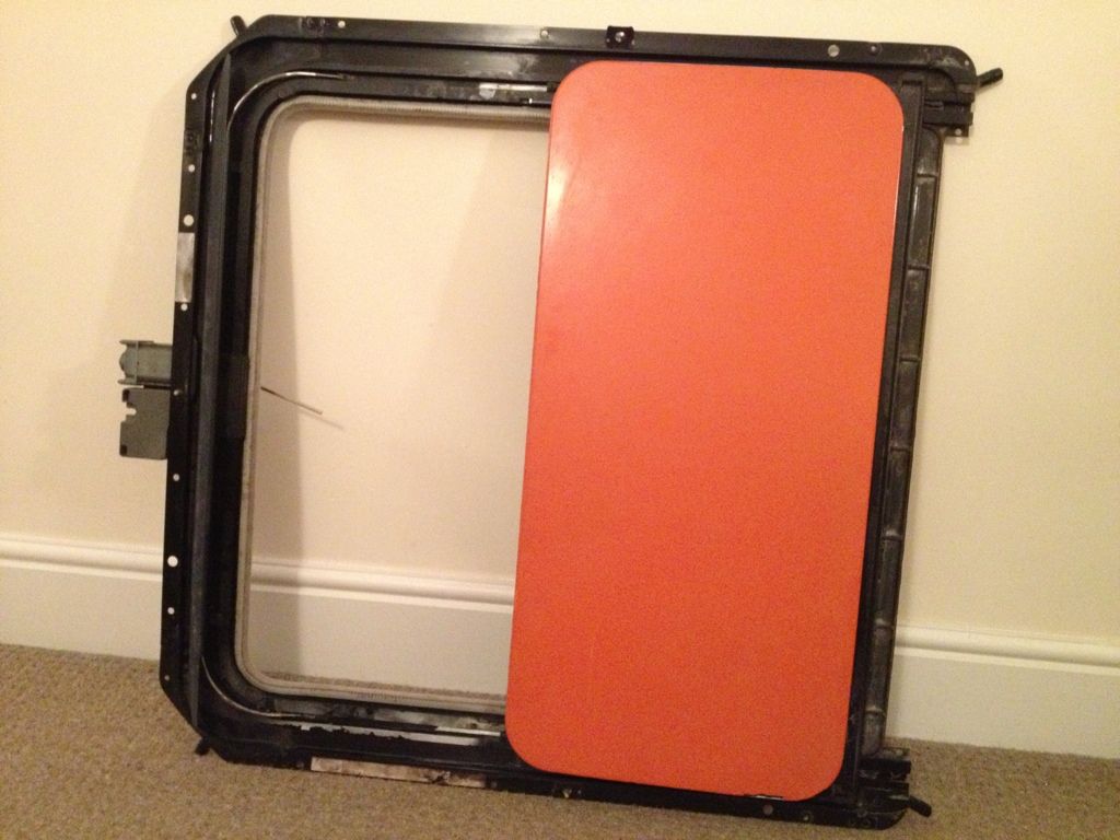

Well

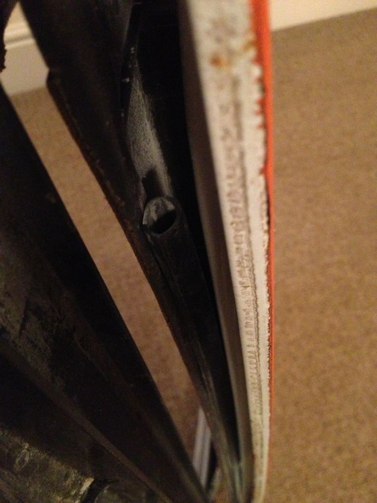

Remember my leaky sunroof (only from rear)?
Well
The car was parked at a slight UP incline
So the water should have drain backwards into the drain channels and out via the tubes.

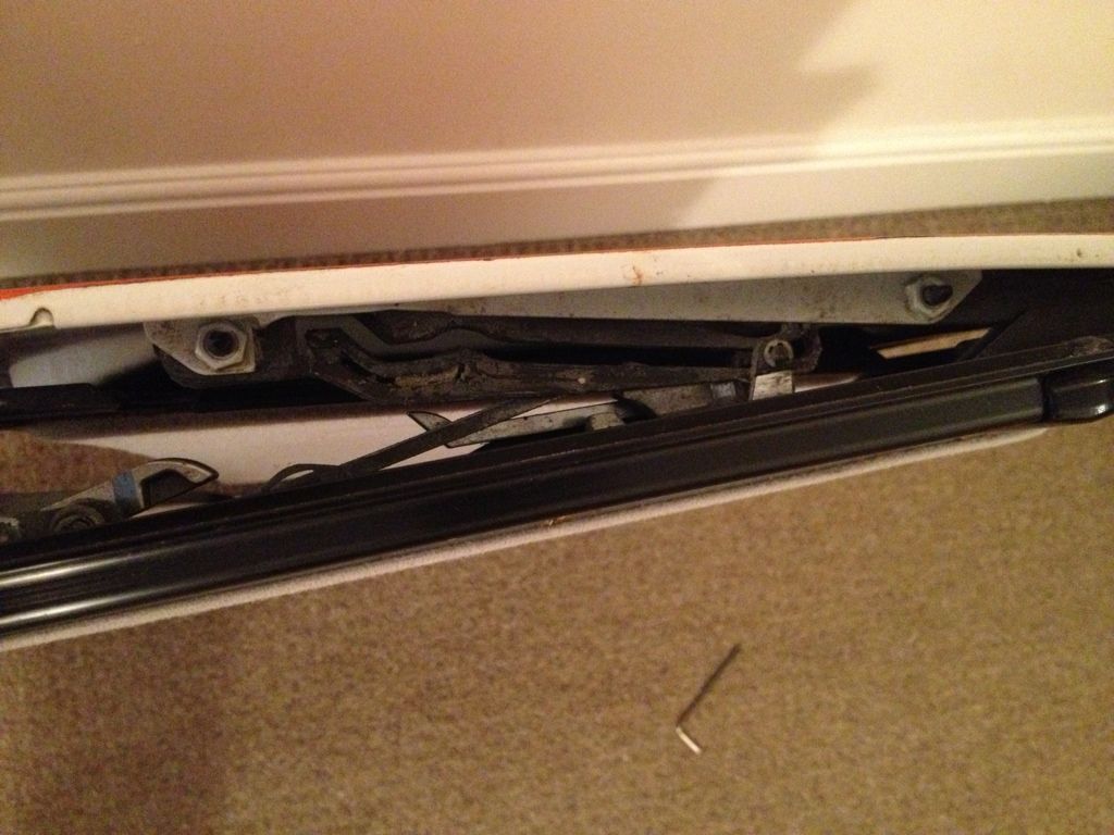

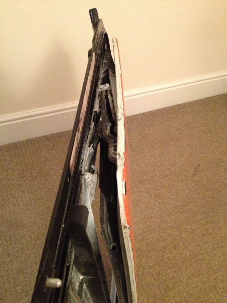

I got a spare sunroof and decided to tinker a little ...
The front drain tubes ok to clean
The rear ones will need to remove the headlining - eeek!
This must be where its leaking thru
1st line of defence is the black outside seals.
2nd line this black tube along the back?
The inner seal
I know Seanl82 shown me to remove the sunroof is maybe to undo those allen bolts (2 on each side from inside) - but its tight there, so maybe undo the bolts from outside (2x white bolts)?

The outer bolts are captive in the sunroof panel Wayne, so you won't be able to remove them. There are slots on the inside of the panel structure, so you will be able to get a star drive in there no bother with the sunroof in the tilt position mate.
Cheers Sean :)
U seem to know everything!
Just that it does look tight from the inside :(
Not got my car back yet - could be EVEN tighter in my car!
That spare sunroof doesn't slide proper (had to push on one side to close)
AND the Allen key turns with a LOUD SNAP from time to time - eeeek!
Hope mine doesn't do that...
Don't bother buyer the seals Wayne until you know all of your drain tubes are all clear, otherwise you could be wasting your money and find it still leaks! ;)
