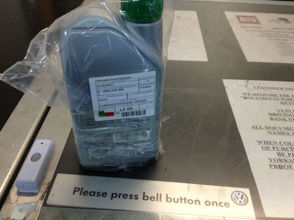

04. PAS Fluid
- AV Spares
- VW: [G 004 000 M2] Green fluid 1 Litre £10
