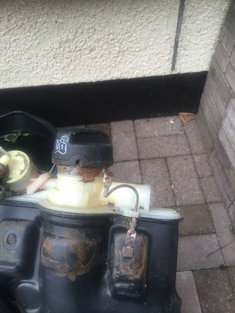

easypops 8 Posted August 9, 2015 Fairly sure they all rust off, I think I read somewhere it's not a big deal, in place in case a spark is created while filling up. Here is what it looks like on a removed tank And where it should be Quote Share this post Link to post Share on other sites

fendervg 33 Posted August 9, 2015 Yep, mine is rusted and just hanging there as well - happens with age and that area just collects dirt and water as it's exposed with no arch liner to protect it - just cross your fingers when you're filling up and you'll be grand. You could use some conductive glue to put it back on. Quote Share this post Link to post Share on other sites
Jim Bowen 1 Posted August 9, 2015 Mine was the same. I managed to make up a new wire and connections and soldered it back on. Turned out better than i thought but not sure how long it was disconnected so probably doesn't do much Quote Share this post Link to post Share on other sites
vw rule 19 Posted August 19, 2019 Same issue with mine. Soldered on the new earth wire but the solder wouldn't stay attached for long on the fuel filler neck metal end guard, so had the idea of rapping bare copper mains wire around the top of filler neck and twisting the two ends so as to tighten it so it would make contact with the metal end guard, then soldered that in 2 or 3 places, then Soldered on the new earth wire to the mains wire, and bingo it worked, even tested it with my multimeter and it works. Might rap some duct tape around it so no mud or damp will get to it. Much cheaper option than purchasing a new fuel tank £££ that's for sure. Si Quote Share this post Link to post Share on other sites
