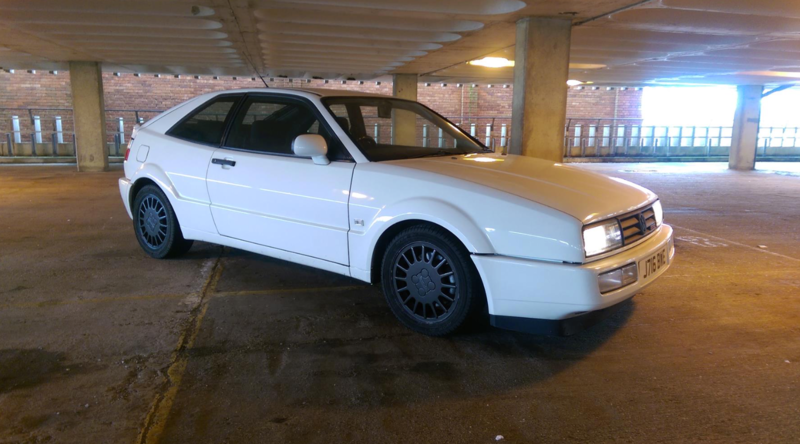

G60_Chris 11 Posted January 30, 2016 (edited) Thought I would make a post about my car, been a long time reader of these forums and have gained some valuable knowledge of the cars as a result, so thought it only right that I actually made a post... I finally bought myself a Corrado, a car I have promised myself for years since wanting one when they first came out! I found a fairly decent looking white G60 on eBay that was being sold as the owner never used the car. I originally wanted a VR6 to replace my mk3 golf VR6 that I had just sold, it was a fairly well known car on the internet and at shows with air ride, various engine mods and a full custom mulberry retrim etc, but after looking at a few locally and a few cars being more than I wanted to pay, I decided to widen my search for other Corrado models, the next best thing in my eyes was the G60 which was actually THE car I had always wanted back in the early 90's. It had a few mechanical issues (that I've spent the past week working my way through) and a few bits of bodywork (it's booked in for a full respray on Monday as I wanted it 100% perfect) but overall looked a decent car in the pictures on the listing, I had the seller send me a few better pictures and some more information and so last Saturday I bid, and won the car! I've never bought a car through an auction before, and never bought anything without seeing and driving the car first but circumstances meant I couldn't travel to view the car prior to bidding. It has only done 1226 miles in the past few years and was locked away in a garage, being used very rarely on dry weekends and for the annual trip to the MOT station. Upon arrival, the car was driven out of the garage, and after a good look round it I was happy that it was as advertised, everything worked as it should (including the sunroof and the spoiler) so I paid the money and left with the car. This is what it looked like as of last weekend... And after fixing the few niggles it had, here's how it sits less than a week later with some OZ Turbo replica wheels 9x16 all round with 195/45/16 tyres front camber adjustment, 10mm rear hubcentric spacers and rolled rear arches... Edited May 5, 2016 by G60_Chris Quote Share this post Link to post Share on other sites

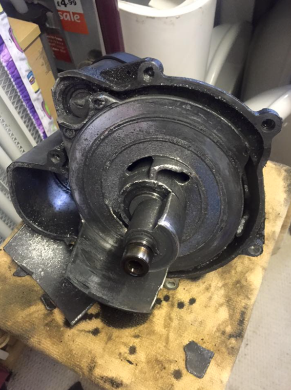

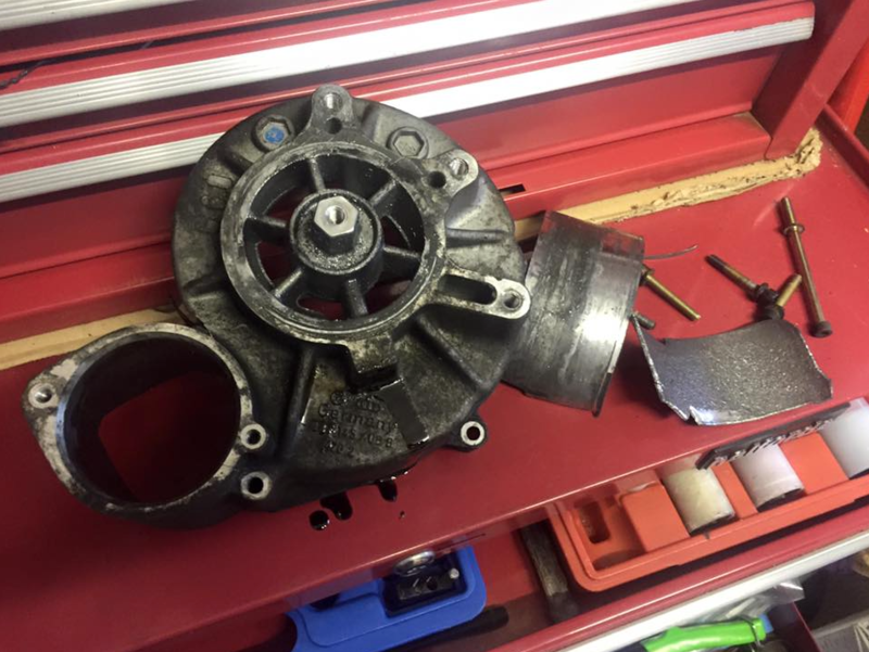

G60_Chris 11 Posted January 31, 2016 Well when they say things are sometimes to good to be true, today I ran out of good fortune... Popped to the local SW Dubs meet at Exeter Services along with around 200+ other cars, only for the supercharger to implode on the way up! Clearly the rebuild carried out by G-Werks 17k ago perhaps wasn't the best, but there's not much I can do now. So got the car back home, removed the charger and this is what was left of the unit: Not really what I need a day before it was booked in to the bodyshop for a full respray! So after scouring the internet, the only supercharger I could find was in Germany. It is (probably) one of, if not the last brand new supercharger unit for sale. Genuine VW item boxed and shipped to the UK for £940 and seeing as I didn't have the time to wait, find a second hand one, get it rebuilt so I know it was good etc I bought it. Should be arriving next week hopefully, then I'll just have to fit it. I managed to get the car drivable for now by removing the broken internal parts of the G-Lader so the pulley still worked without the rest of the charger attached (casing was smashed top and bottom and bits of charger were imbedded in the under bonnet sound deadening), so it can be driven to the bodyshop and back again without any horrible noises. Will be posting up an update once the car is back from paint, and the new charger arrives... What a weekend! :( Quote Share this post Link to post Share on other sites

seanl82 23 Posted January 31, 2016 Feel for you mate, thats devastating, especially so soon after getting the car. I'd heard G-Works workmanship went a little downhill just before they shut up shop, but you'd never be able to anticipate it happening like that. Well done on getting a replacement so quickly though, an added expense I'm sure you could have done without though. Onwards and upwards mate, it'll be a cracking car and at least you'll have the peace of mind its solid. John at JMR comes highly recommended for charger rebuilds/upgrades if you want to increase power in the future though! Quote Share this post Link to post Share on other sites

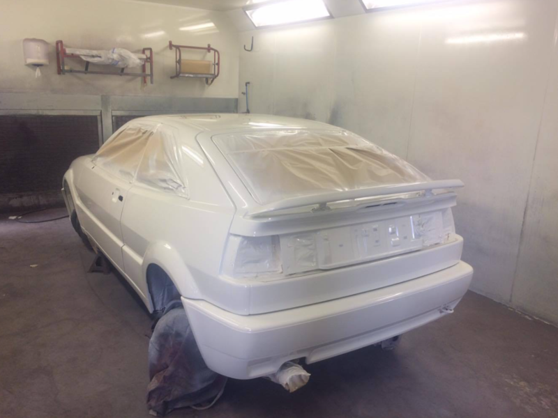

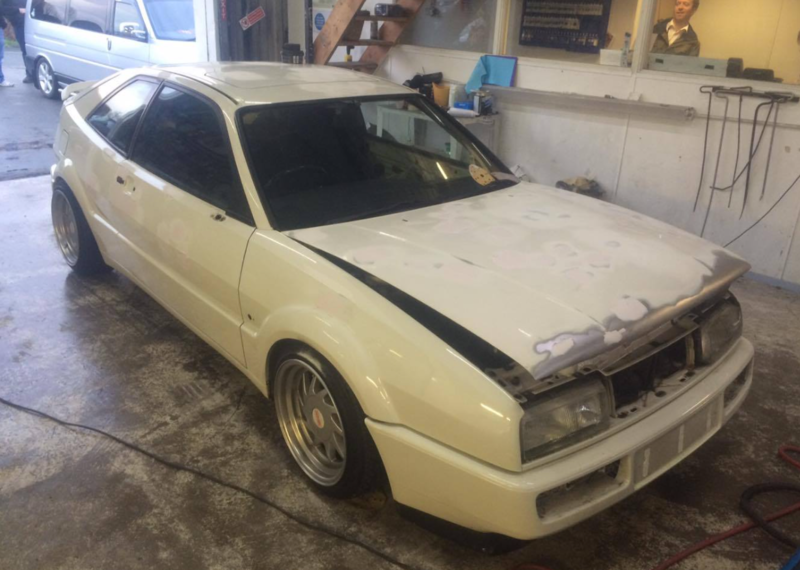

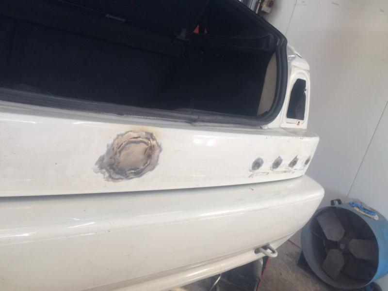

G60_Chris 11 Posted February 1, 2016 (edited) Some update photos from the bodyshop... Car is getting a full respray in it's original factory colour of Alpine white, a few car park dings removed, stone chips removed and ground down from the front of the bonnet, sills re-stone chip protected, rear badges removed and smoothed and some more tweaking to the rear arches. Edited February 1, 2016 by G60_Chris Quote Share this post Link to post Share on other sites

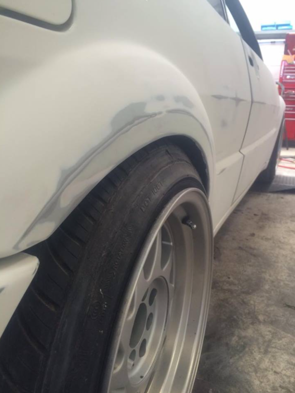

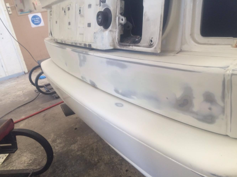

G60_Chris 11 Posted February 2, 2016 Further progress, bodywork prep is well underway prior to paint. Rear badges removed, plates welded in then ground down and smoothed off for a clean rear end... Rear arches pulled to eliminate any rubbing... Quote Share this post Link to post Share on other sites

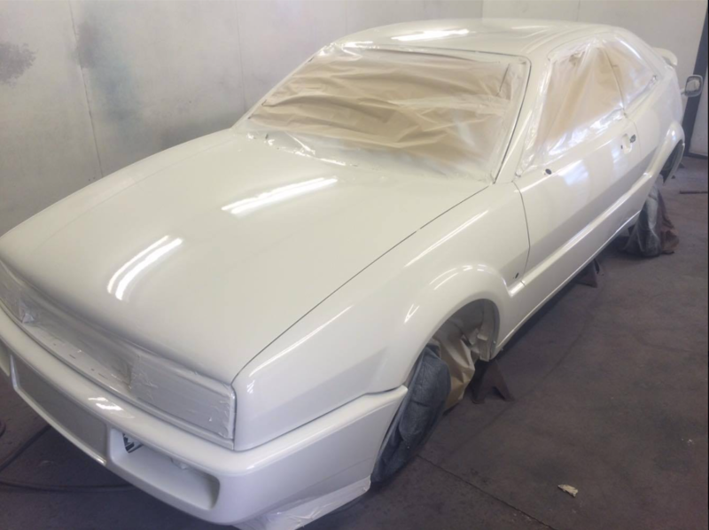

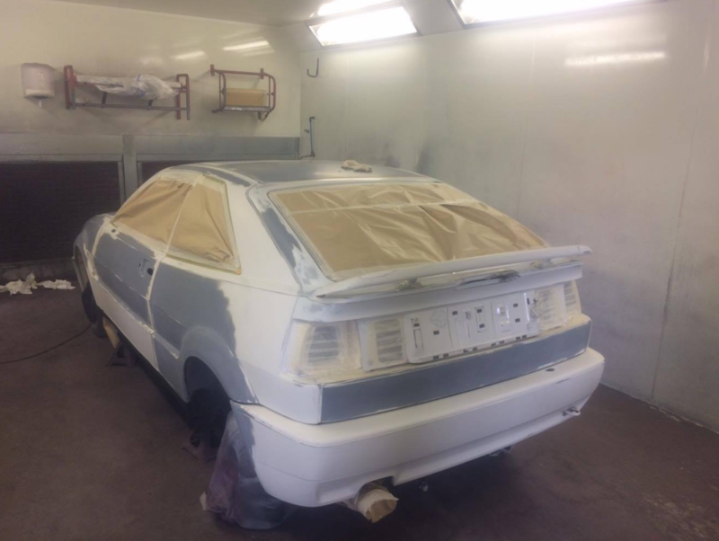

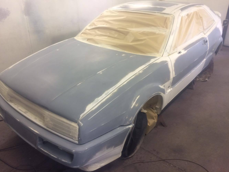

G60_Chris 11 Posted February 3, 2016 Primer on and sanded back for a smooth finish... And then some paint... :turn-l: Quote Share this post Link to post Share on other sites

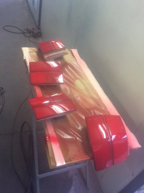

G60_Chris 11 Posted February 4, 2016 Well today the car has been polished and is in the process of being put back together. Also sprayed the standard rear lights all red... Quote Share this post Link to post Share on other sites
