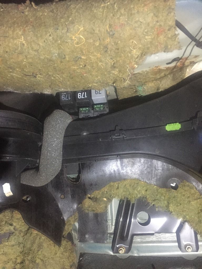

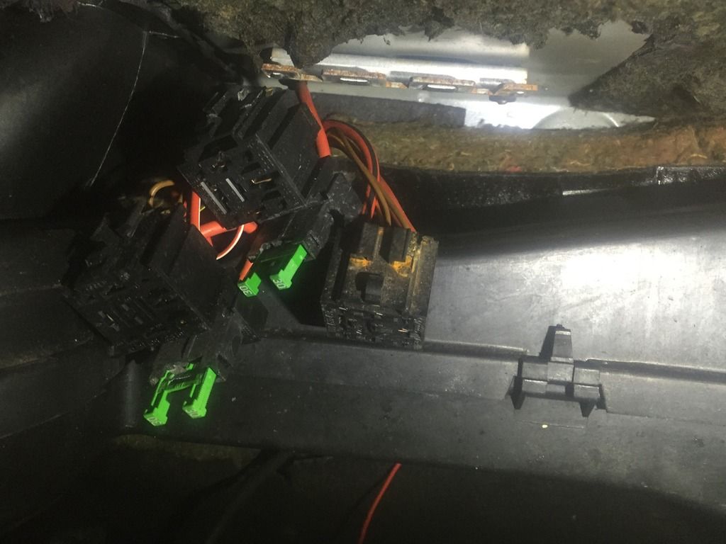

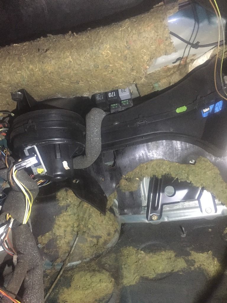

easypops 8 Posted February 23, 2016 (edited) I'll take a picture in a minute, still out in the garage anyway :lol: The relay holders sit in the extrusions you see above the plastic.....this is on the breaker and is why it's a mess.....if you need to see them in place I can sort a pic out tomorrow , it's a bit late for removing car covers etc at this time, not forgetting to mention its Baltic outside :lol: Edited February 23, 2016 by easypops Quote Share this post Link to post Share on other sites
KARMANN 0 Posted February 23, 2016 That would be great if you could send a picture of them in place easypops. The wiring for my relays come out underneath and come up the from of the heater. Am I right in saying that picture shows the wiring running up the bulkhead then over the top of the heater (between the heater and the dash) then down the front? Regards Fraser Quote Share this post Link to post Share on other sites

easypops 8 Posted February 24, 2016 Here you go, a couple of pictures of the relays in situ Looks like the wire does indeed travel over the air ducting, not behind it Quote Share this post Link to post Share on other sites
