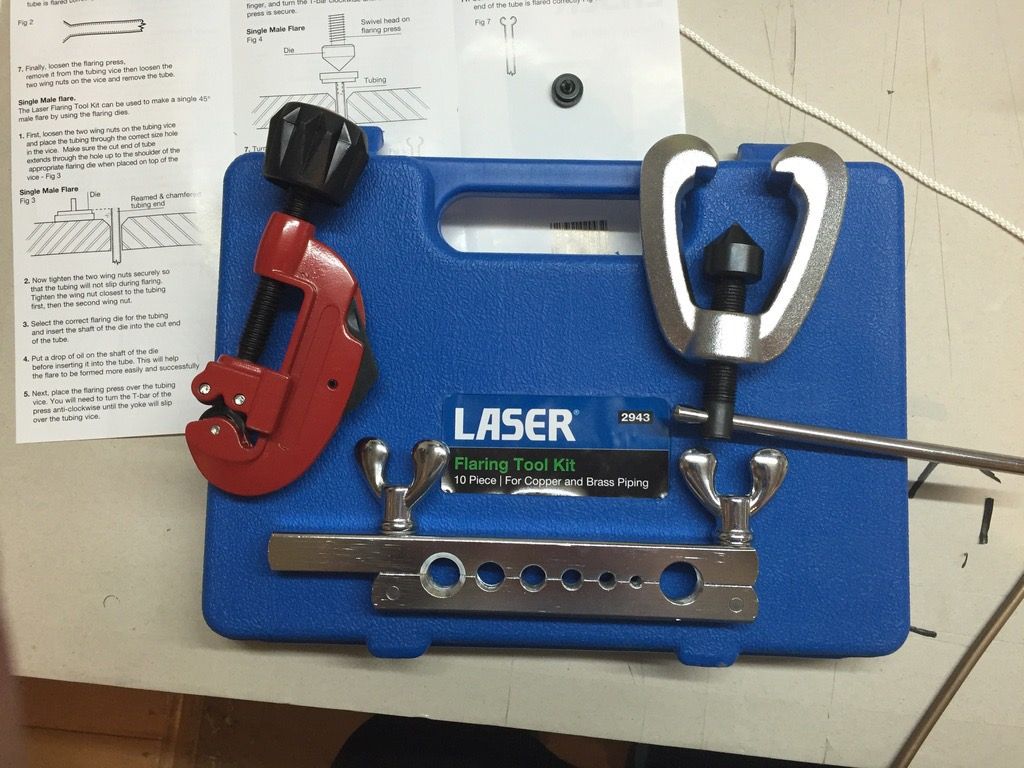

I bought this
a few months ago, can't remember where from , eBay or Amazon likely.
I gave it a go last night, just to see what the process was, but fell at the first hurdle.

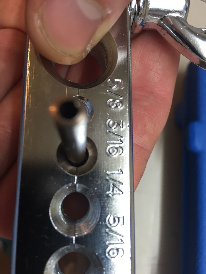

The 3/16 hole on the clamp doesn't grip the 3/16 pipe? It basically can slide straight through and I was wondering if it's just a rubbish tool? Or am I doing something wrong?
I can't see that I am in the wrong this time, but it's been known :lol:
Too loose

I have made brake pipes using a similar tool before, and whilst it's definitely more in the realm of amateur level and not workshop grade, it certainly does the job. Can't fathom what's happened with the sizing though - have you tried clamping it in the next smallest hole or is that miles off?
It does clamp in the smallest hole Jim but it's too small, makes a right mess of the pipe plus the tapered hole is the wrong size to get the correct flare . I can only guess that the clamping tool is faulty
I bought a flaremaster kit, can only seem to find links to a flaremaster2 online now. I was told them cheap ones aren't very good. Could you wrap some old inner tube around the pipe to help it grip and protect the pipe?

Have just bought a Clarke kit over the weekend from Machine Mart which is the same as yours. Made some 3/16 tubing up no problem but took a few practice attempts to get it right. It looks like you have your 3/16" pipe through the 1/4" hole which is why it wont clamp. When its clamped in the 3/16" hole it does leave markings on the tube but its the flared part of the tube that makes the seal .
Just remember that when winding down the flaring tool don,t over tighten as it can split the pipe and take out the collet for a double flared joint.

I've got a similar kit which I was bought, haven't used it yet but my dad did last week and found that the cast shaping tool bent (the pin in the middle) and was quite difficult to get a perfect shape. Think I might invest in a proper kit when I get round to making new brake lines. As VR6 Andy says, does look like you've got it 1 hole over (labels to the right of the hole)

Thank you, I thought that I had it in the right hole :lol:, but can now see where I've went wrong......I just assumed the sizes were in decreasing order :lol:
I'll try again tonight :)

I did my front pipes a while back using the same kit Martin. Had no problems but did a couple of trial runs on some small cut offs first. Just experiment with how far you pass the pipe through and compare it to the original pipes.

I ended up buying a second hand Sykes Pickavant double lap flaring tool, does exactly as you'd expect, perfect flares every time(so far)and very easy to use, well in a bench vice anyway :)
