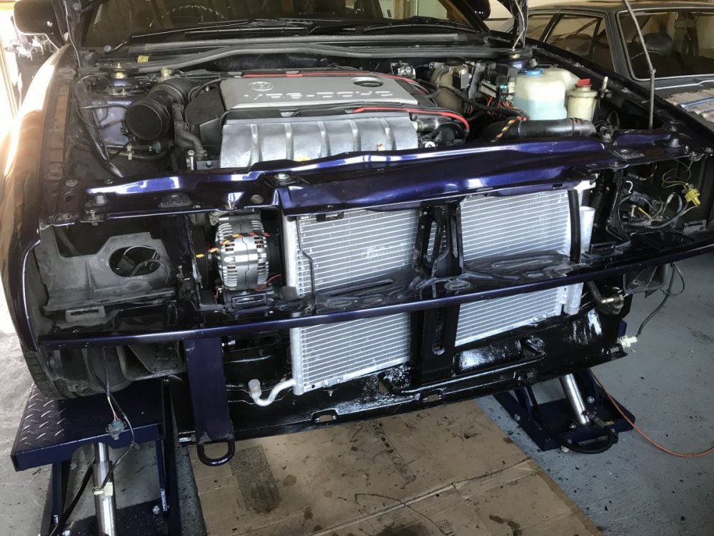

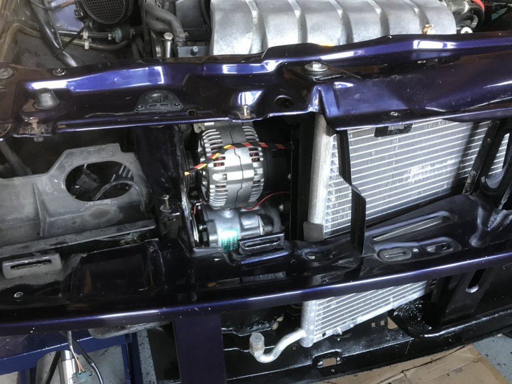

gazc 10 Posted July 28, 2020 This is the relay. I think it's a special. I've ordered a second hand one from Ebay (Lithuania) but I'm not sure if it will be any better than the one I've got so I'd like to get hold of a new one if poss. You seem to be able to get similar units but without the coil diodes which I guess is what the -X242 signifies. If all else fails I'll get a standard relay and add the diodes to it. I saw the post on the Trinary switch. I got one from www.airconcoltd.com part number 6204310S1A if anyone else is doing an aircon rebuild. (Bloody expensive!) I got the rest of the kit from Autodoc. Compressor NRF Part number 32805G Condenser NRF Part Number 35027 Dryer (from Ebay) Hella Part number 8FT 351 199-011 The condenser was a larger unit than the original but I managed to shoe horn it in. I've added a couple of photos of the front with most of the new parts fitted. Just the dryer missing which I had to make a bracket up for. The pipework needed to change a little as the Condenser inlet and outlet are on opposite sides but the original pipes were long enough. Hope this helps anyone doing the same work. Quote Share this post Link to post Share on other sites
Cressa 45 Posted July 28, 2020 Looking good. Your condensor certainly does look more substantial than the original, but that is still available as it is universal. Harrison brand. But I do like yours as it looks more OE Quote Share this post Link to post Share on other sites
gazc 10 Posted July 28, 2020 It’s all back together now. It started with needing to replace the oil cooler but once you get the front out one thing leads to another ......... Just trying to get the electrics on the aircon a little more reliable. I’ve got a circuit diagram for the system if anyone needs a copy. It’s just sourcing the parts that’s a little difficult. Quote Share this post Link to post Share on other sites
