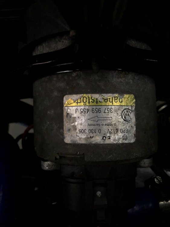

Keyo 47 Posted December 31, 2020 (edited) Looking at the rated power spec on Hella has 450/ 250/80 does that mine stage 3. Description below on photos and etka cant see a fan J on the end though just L - but has same ratings as the Hella. Edited December 31, 2020 by Keyo Quote Share this post Link to post Share on other sites
1xshaunx1 27 Posted December 31, 2020 13 minutes ago, Keyo said: Looking at the rated power spec on Hella has 450/ 250/80 does that mine stage 3. Description below on photos and etka cant see a fan J on the end though just L - but has same ratings as the Hella. I’ve been looking and it does list 3 different powers as you say and a few say it cross references your fan part number but I can’t he my head around the plug only having 3 pins on the drawing, unless it means 3 power pins and one earth. I looked into this as was worried running a 30 year old fan on a turbo set up as it comes on more often, I gave up in the end. From what I can read about it you should be good Keyo, you are correct in it is your fan plastic they have broken so I suppose you don’t have much choice but to roll the dice. good luck with it mate, it’s a good find if it works out 👍 Quote Share this post Link to post Share on other sites
Keyo 47 Posted December 31, 2020 (edited) Here is mine ending with J on another etka platform - Im noticing 7 zap etka has many parts missing off their platform so be carful using it. One observation is stage 3 power is 350 ending with J but on the Hella they give you the uprated power of the ABV with power 450 which is good I guess. You can still get the ABV ending with L from classics for ABV but is £360 nippers - maybe this one is for tow and aircom with but more top power - although as mentioned Hella are giving this on their unit. Edited December 31, 2020 by Keyo Quote Share this post Link to post Share on other sites

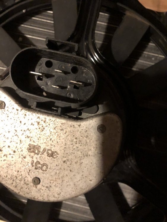

1xshaunx1 27 Posted December 31, 2020 My oe fan has the same part number as yours. plug on the back of the fan Quote Share this post Link to post Share on other sites
1xshaunx1 27 Posted December 31, 2020 My fan part number Quote Share this post Link to post Share on other sites
Keyo 47 Posted December 31, 2020 (edited) Im hoping the plug and pins are the same on the hella fan mate. Can see the lugs on your plug that should be on mine. The onlt difference I can see is setting 3 on the Hella has 450 and the stock motor ending with J is 350 . If it only has three pins could it just still work the same I wonder? Edited December 31, 2020 by Keyo Quote Share this post Link to post Share on other sites
