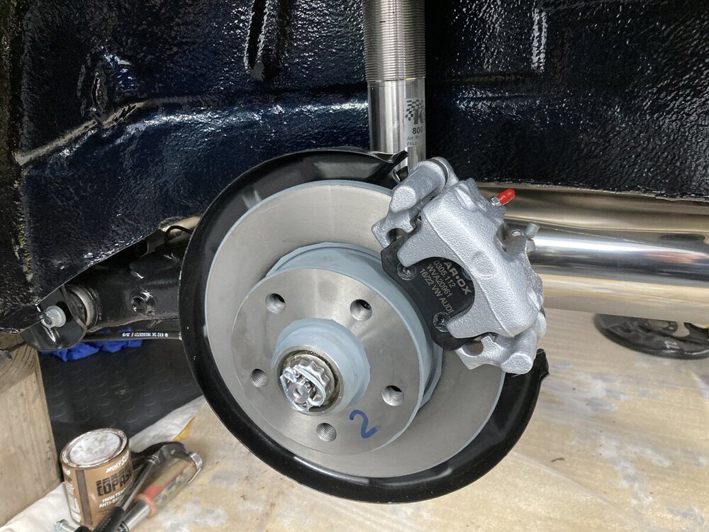

ChrisL 20 Posted October 15, 2022 3 hours ago, Corroda said: Amazing job Chris! I’m planning a similar job next spring, so really appreciate you sharing the pictures. I also have a Supersprint exhaust on order so would be interested in your thoughts on fit and tone, but it does look great quality. Thanks. The supersprint fits perfectly, have you got the full system? I had one on my old VR and has a nice sound to it. Quality is excellent 👍 I had all the welds cleaned at work for that extra bit of cleanliness 🤣 Quote Share this post Link to post Share on other sites
Corroda 11 Posted October 15, 2022 (edited) I have got the cat back system like yourself. How did you clean the welds, did you TIG brush, or use another method? Edited October 15, 2022 by Corroda Quote Share this post Link to post Share on other sites
seanl82 23 Posted October 15, 2022 Cracking job in the paint there Chris! Underside looks fantastic too. I assume you'll be replacing the long brake hard lines at another time? Quote Share this post Link to post Share on other sites
ChrisL 20 Posted October 15, 2022 3 hours ago, Corroda said: I have got the cat back system like yourself. How did you clean the welds, did you TIG brush, or use another method? Yes Tig brush 👍 Quote Share this post Link to post Share on other sites
ChrisL 20 Posted October 15, 2022 3 hours ago, seanl82 said: Cracking job in the paint there Chris! Underside looks fantastic too. I assume you'll be replacing the long brake hard lines at another time? Thanks Sean. yes Engine coming out next and will be doing the other brake pipes including the front to rear pipes 👍 Quote Share this post Link to post Share on other sites

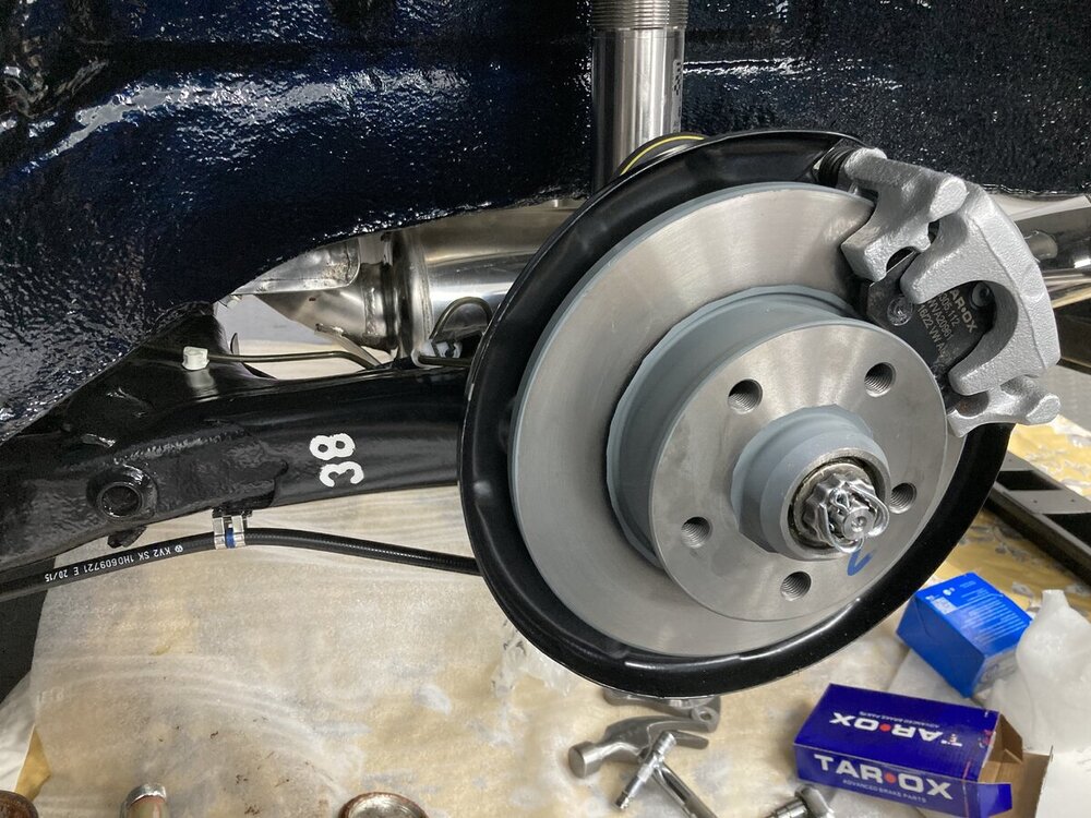

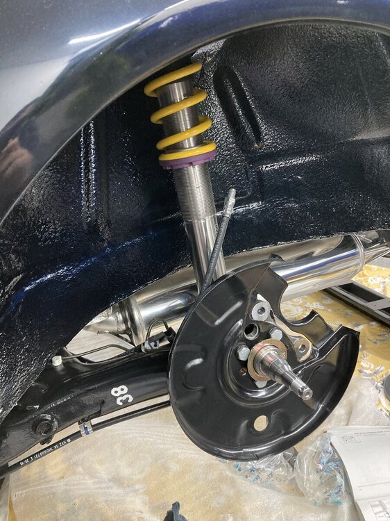

ChrisL 20 Posted October 20, 2022 More updates Quote Share this post Link to post Share on other sites
Cressa 44 Posted October 20, 2022 It does look soooo nice new and shiny 👍 Quote Share this post Link to post Share on other sites
fla 9 Posted October 20, 2022 There's the bar Chris, and you just go and raise it ! I bet VW didnt pay an much attention when our cars were first made. Brilliant pics to go with that incredible work. Quote Share this post Link to post Share on other sites

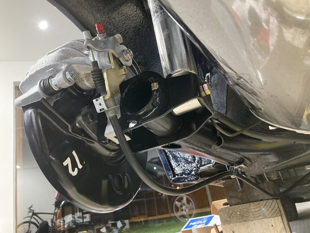

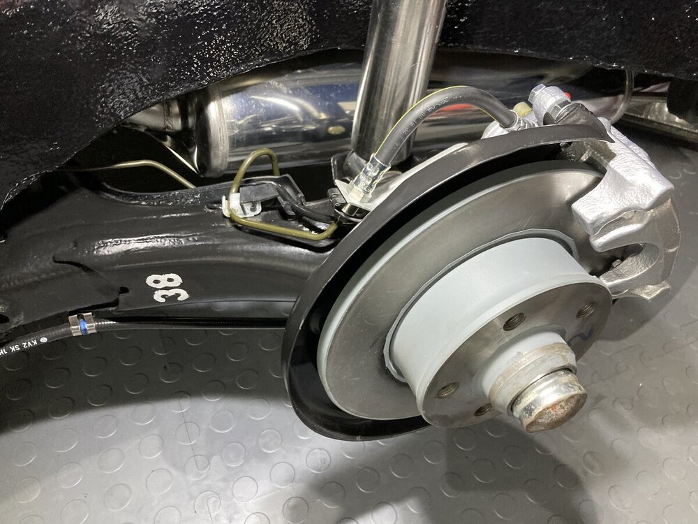

Corroda 11 Posted October 20, 2022 Excellent work as always Chris, thank for sharing progress 👍 I’m looking for originally looking olive green brake lines for my car. Do you make these up yourself, or did you buy them pre-made? I know there was a guy on here that used to make them, but I had difficultly getting him to make a full set. I’m showing my ignorance, but what are the numbers painted on the beam and splash guards. I know you take your cars to shows, were these numbers originally on the cars from factory? Quote Share this post Link to post Share on other sites
ChrisL 20 Posted October 20, 2022 5 hours ago, Cressa said: It does look soooo nice new and shiny 👍 Thanks 🙏 4 hours ago, fla said: There's the bar Chris, and you just go and raise it ! I bet VW didnt pay an much attention when our cars were first made. Brilliant pics to go with that incredible work. 🤣 thanks mate. Think there are a few out there as good, if not better then this. 4 hours ago, Corroda said: Excellent work as always Chris, thank for sharing progress 👍 I’m looking for originally looking olive green brake lines for my car. Do you make these up yourself, or did you buy them pre-made? I know there was a guy on here that used to make them, but I had difficultly getting him to make a full set. I’m showing my ignorance, but what are the numbers painted on the beam and splash guards. I know you take your cars to shows, were these numbers originally on the cars from factory? Green brake pipes where made by Alex who did them on here, I sourced the pipe and the genuine unions (£5 each 😮). Excellent quality and he’s also made me all the front ones. Just need the 2 long ones from front to back. The numbers where on my old storm which was just as it left the factory so got measurements and repainted them on here. They must be a factory marking. Quote Share this post Link to post Share on other sites

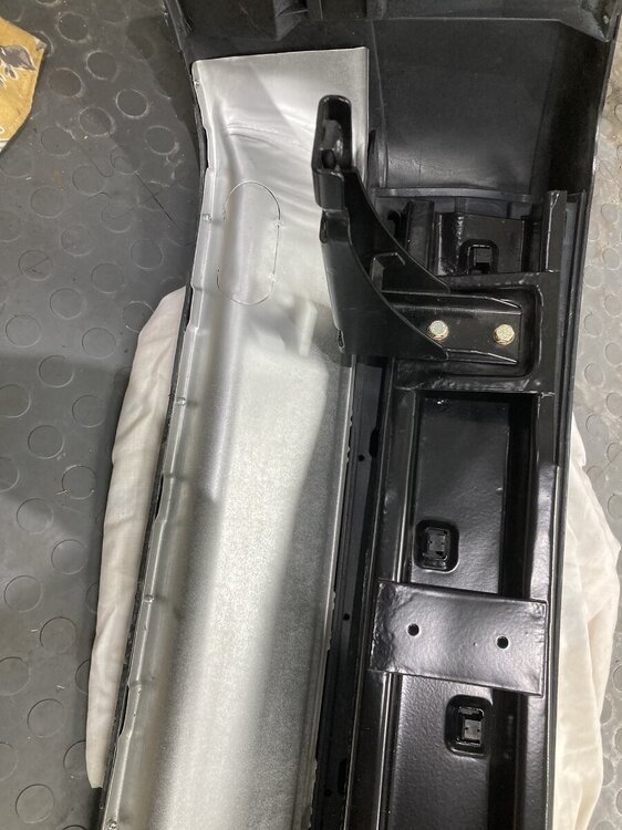

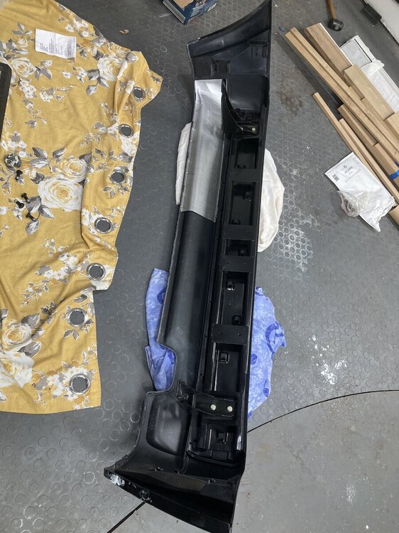

ChrisL 20 Posted October 26, 2022 Quick pointless update I guess, refurbished bumper iron back on and little OCD but because I’ve deleted the towing eye, I thought I best delete the hole in the heat shield. Quote Share this post Link to post Share on other sites
_Matt_ 32 Posted October 26, 2022 :) nice detail though What have you done about blocking the hole on the bumper? I'm tempted to do this myself as I think it spoils the lines. I have seen somewhere in the world that Corrados had purpose made caps but can't find the part number.Sent from my SM-G960F using Tapatalk Quote Share this post Link to post Share on other sites
ChrisL 20 Posted October 26, 2022 22 minutes ago, MJA said: 🙂 nice detail though What have you done about blocking the hole on the bumper? I'm tempted to do this myself as I think it spoils the lines. I have seen somewhere in the world that Corrados had purpose made caps but can't find the part number. Sent from my SM-G960F using Tapatalk Thanks, I got a cutting of a bumper and made a small patch to block the hole, i plastic welded it with a soldering iron from the back then filled the bumper. It was then re-sprayed. There are some pictures on page 3 👍 1 Quote Share this post Link to post Share on other sites

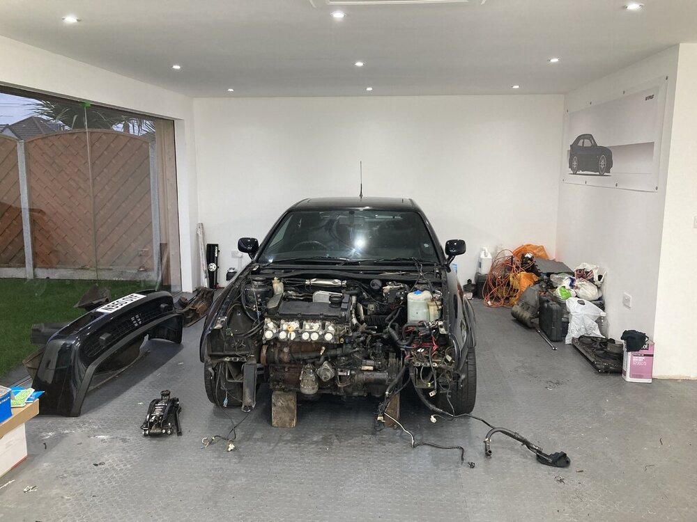

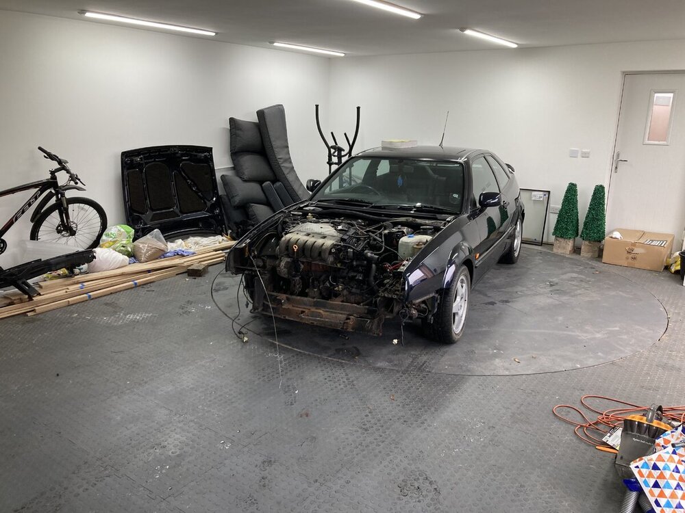

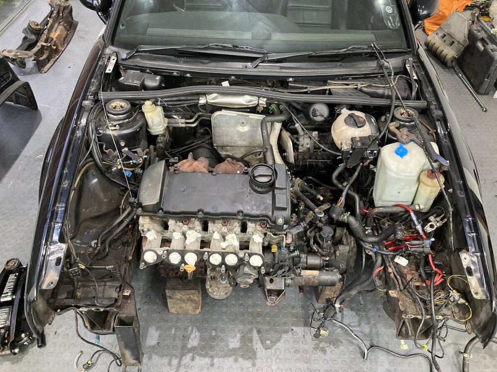

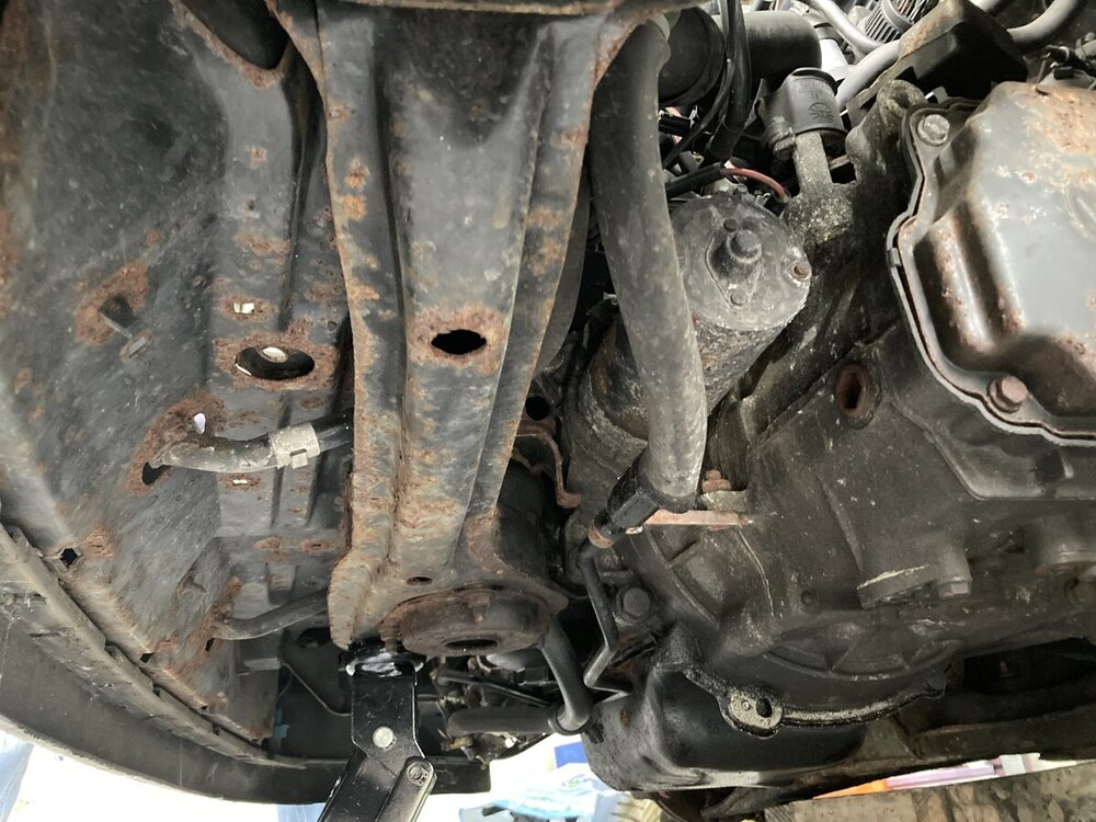

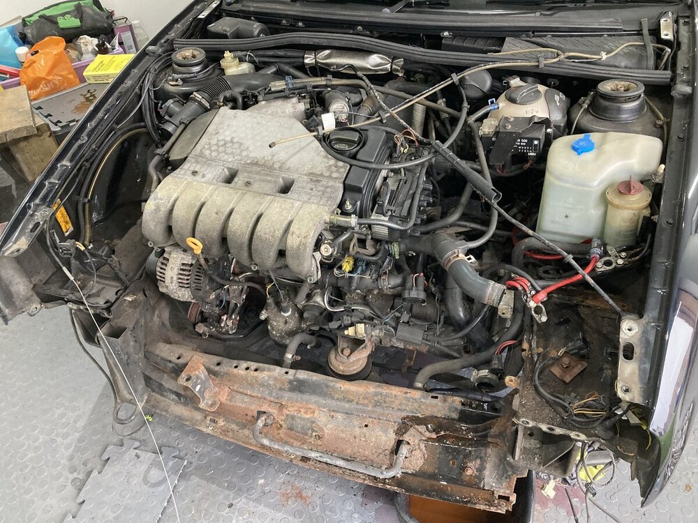

ChrisL 20 Posted November 5, 2022 Rear end finished so on to the front end 🤦♂️ Quote Share this post Link to post Share on other sites
_Matt_ 32 Posted November 6, 2022 Nice look forward to continued updates. Caught the rad support in time. What's plans for the engine - looks to be coming out. Sent from my SM-G960F using Tapatalk Quote Share this post Link to post Share on other sites
James. 9 Posted November 7, 2022 Good progress. Any bolts put up a fight ? Quote Share this post Link to post Share on other sites
ChrisL 20 Posted November 7, 2022 3 hours ago, James. said: Good progress. Any bolts put up a fight ? One of the rear engine mounts and reckon most of the subframe bolts will just snap 🤦♂️ Quote Share this post Link to post Share on other sites

ChrisL 20 Posted November 8, 2022 Another one of the beam and brake lines, just cos I like the picture Quote Share this post Link to post Share on other sites

fla 9 Posted November 12, 2022 On 11/5/2022 at 9:29 PM, ChrisL said: Rear end finished so on to the front end 🤦♂️ i love your garage - nice image on the wall too. Turntable is fantastic as is the floor covering. I'm not jealous....well maybe a little bit 🙂 Quote Share this post Link to post Share on other sites
James. 9 Posted November 12, 2022 13 hours ago, ChrisL said: Is it these at the back of the engine at the top near the oil filler cap Ah that’s the puppy. Always thought they sat on the front of the block. Maybe it’s a early vs late thing. Or maybe it’s a me vs a logical thing. The jury’s out. The images help a great deal. Thanks all the same. Quote Share this post Link to post Share on other sites
ChrisL 20 Posted November 13, 2022 On 11/12/2022 at 10:14 AM, fla said: i love your garage - nice image on the wall too. Turntable is fantastic as is the floor covering. I'm not jealous....well maybe a little bit 🙂 Cheers mate. Planned the garage quite early on when doing the house. can’t wait to get the car finished so I can clear the garage and get the skirting boards on. Might go for a carpeted area where the corrado parks. Quote Share this post Link to post Share on other sites
