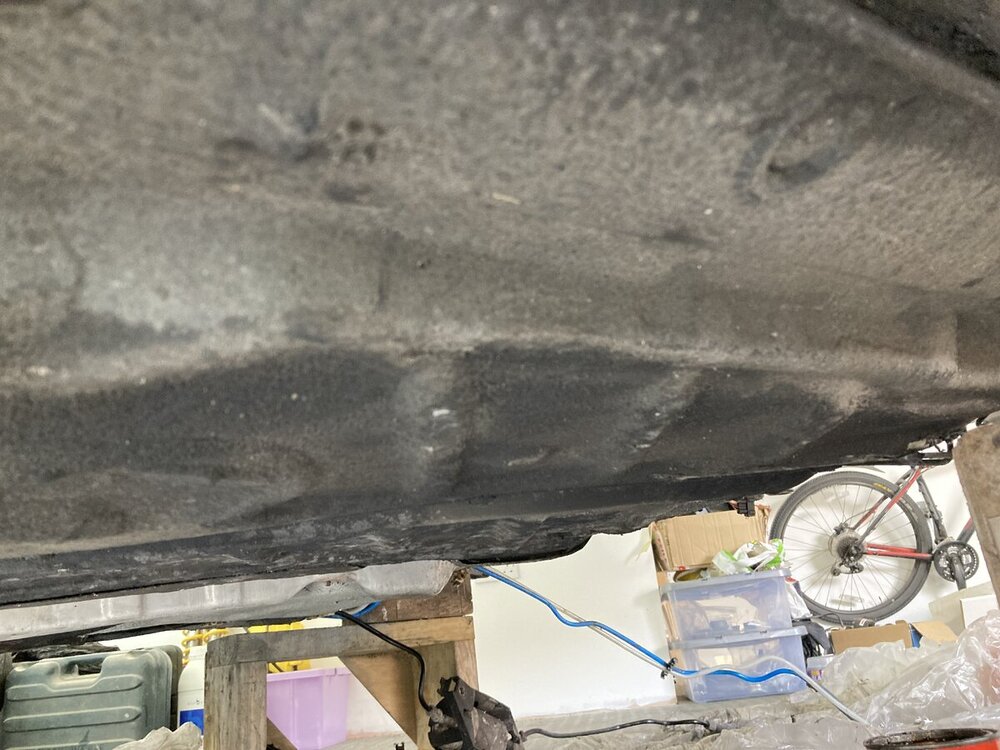

ChrisL 17 Posted June 30, 2022 Not done anything on the Corrado for a while but finally got one floor pan cleaned. Just the drivers side to finish now. Quote Share this post Link to post Share on other sites
fla 9 Posted July 1, 2022 what a transformation! How high does the car need to be to do this comfortably? I have some height adjustable ramps but i'd likely end up dropping all the road grime in my eyes and ears! Looks like the sort of thing that would need 4 poster? Quote Share this post Link to post Share on other sites
ChrisL 17 Posted July 1, 2022 26 minutes ago, fla said: what a transformation! How high does the car need to be to do this comfortably? I have some height adjustable ramps but i'd likely end up dropping all the road grime in my eyes and ears! Looks like the sort of thing that would need 4 poster? If you look in my earlier post you can see how high the car is. It’s not that high and I can just squeeze under. You have to work to the side of you so it doesn’t fall in your face 🤣 Quote Share this post Link to post Share on other sites
seanl82 23 Posted July 1, 2022 Looking good Chris. It's a very long and tedious job which you'll know, but the results speak for themselves. I had a standard set of axle stands one notch from the bottom (second highest) when I did mine - had to have at least one safety mechanism in place! Lol. Spent about 40 hours in total cleaning it all with a nail and toothbrush, though it was pretty grim to begin with! Quote Share this post Link to post Share on other sites
Wild-Animal 0 Posted July 2, 2022 That looks great, its a real pain of a job. I can see why it took 40 hours. I am in the progress of doing mine. So far i have had the most success with a citruis based cleaner liquid. What did you use to get thoses results? apart from plenty of elbow grease.... Quote Share this post Link to post Share on other sites
ChrisL 17 Posted July 2, 2022 5 hours ago, Wild-Animal said: That looks great, its a real pain of a job. I can see why it took 40 hours. I am in the progress of doing mine. So far i have had the most success with a citruis based cleaner liquid. What did you use to get thoses results? apart from plenty of elbow grease.... Thanks, I used a toothbrush with bilthamber Surfex HD and also white spirit. have plenty of rags on hand too. I did it once to get As much off as possible then went back over it with a clean toothbrush to finish. Quote Share this post Link to post Share on other sites

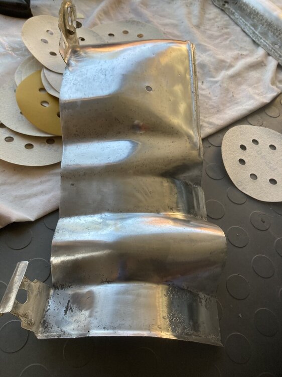

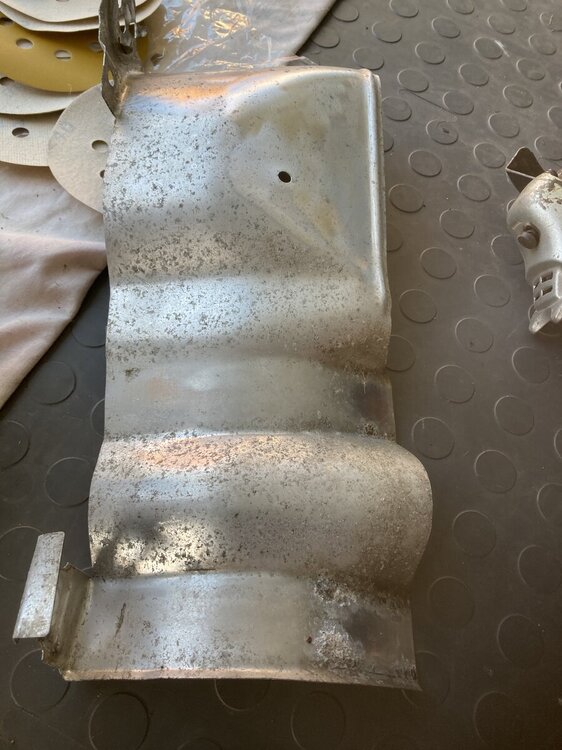

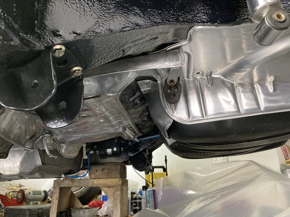

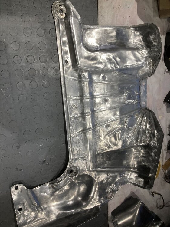

ChrisL 17 Posted July 2, 2022 Heat shields also getting some fettling. Still some work to do on them. Quote Share this post Link to post Share on other sites
Wild-Animal 0 Posted July 2, 2022 ah brilliant, I have been reading good things about Bilt Hammer products. Thanks those heat sheilds have come up real nice! Quote Share this post Link to post Share on other sites

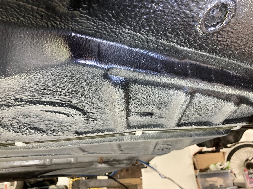

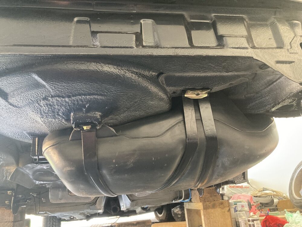

ChrisL 17 Posted September 22, 2022 More work on the underside done Quote Share this post Link to post Share on other sites
1xshaunx1 27 Posted September 22, 2022 It never gets old looking at these parts refreshed and renewed. It just looks so much better and you know after all the hard work you shouldn’t be going back to them very often, just light fettling and cleaning after all that. Quote Share this post Link to post Share on other sites
fla 9 Posted September 22, 2022 Wow that looks nice, but then again your reputation in revamping corrados is well established, Chris. Metallic shocks are a nice and unique touch too. Hasan Quote Share this post Link to post Share on other sites
ChrisL 17 Posted September 23, 2022 12 hours ago, fla said: Wow that looks nice, but then again your reputation in revamping corrados is well established, Chris. Metallic shocks are a nice and unique touch too. Hasan Cheers thanks. Shocks are KW coilovers which are stainless steel I believe 👍 Quote Share this post Link to post Share on other sites

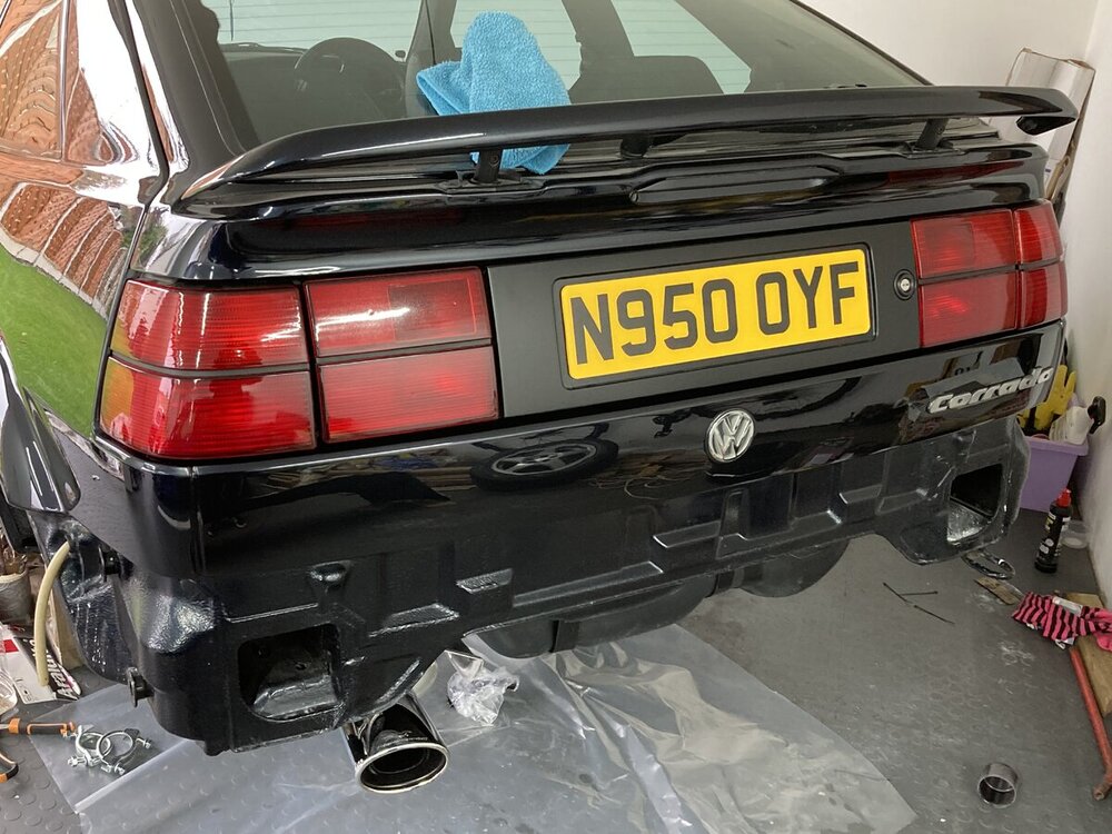

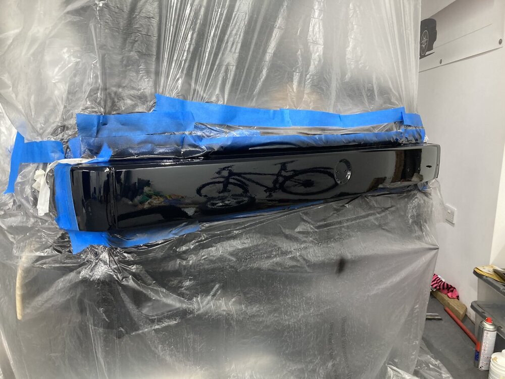

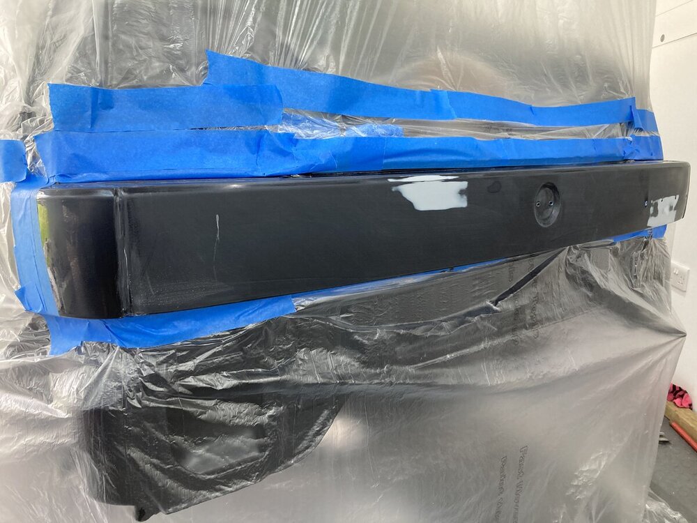

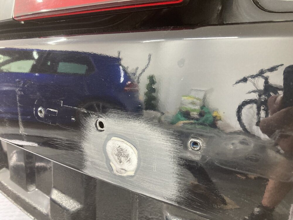

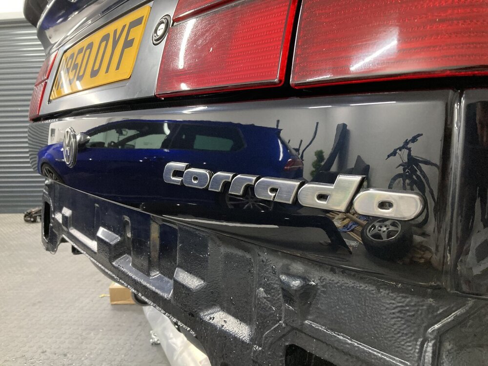

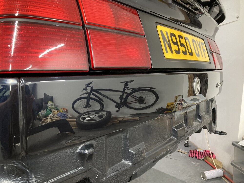

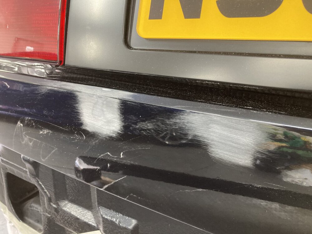

ChrisL 17 Posted October 7, 2022 Done a small repair on the rear panel, quite happy with it for my first attempt Quote Share this post Link to post Share on other sites
Cressa 44 Posted October 7, 2022 That is bloody impressive, well done 👍 Quote Share this post Link to post Share on other sites
fla 9 Posted October 7, 2022 Great result. How long did that take from start to finish? Btw, do your indicators flash orange? I used some high powered orange leds in mine and they're very borderline. Mine are also tinted red. Quote Share this post Link to post Share on other sites
ChrisL 17 Posted October 7, 2022 Cheers thanks. not really sure how long as I’ve done little bits over a period of time. Realistically, it didn’t take that long I guess. not sure on the indicators actually. Quote Share this post Link to post Share on other sites

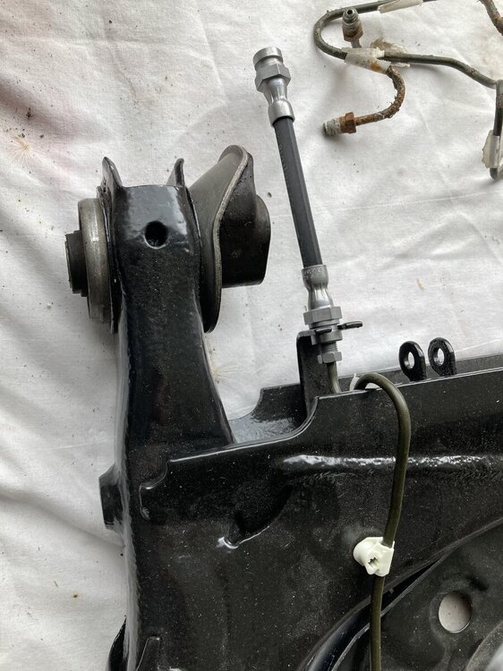

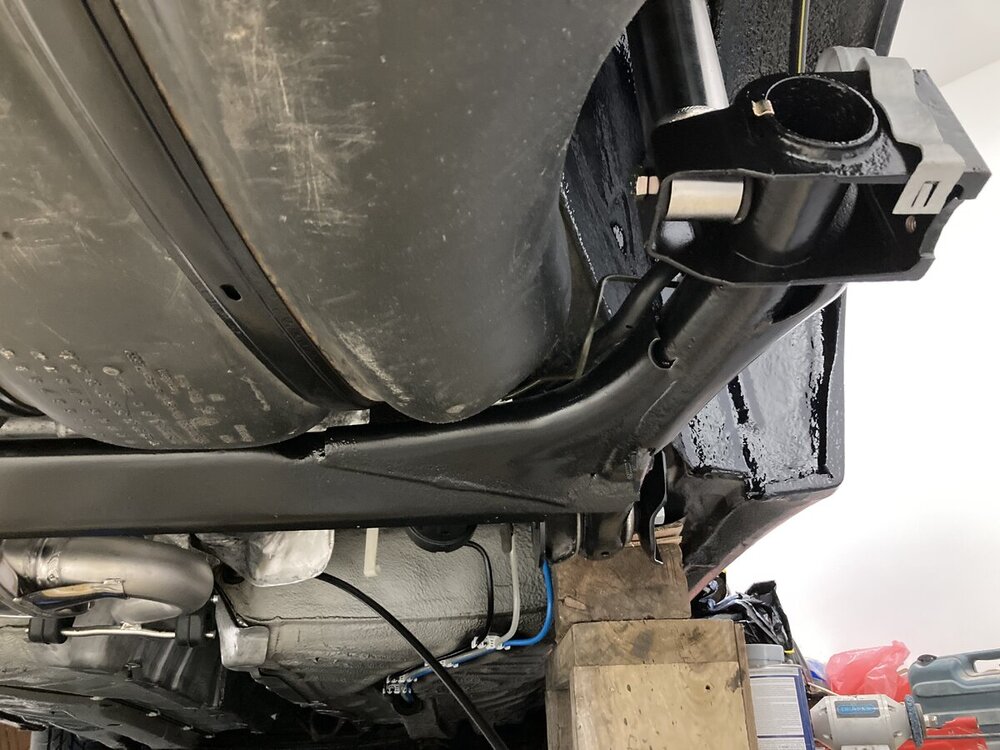

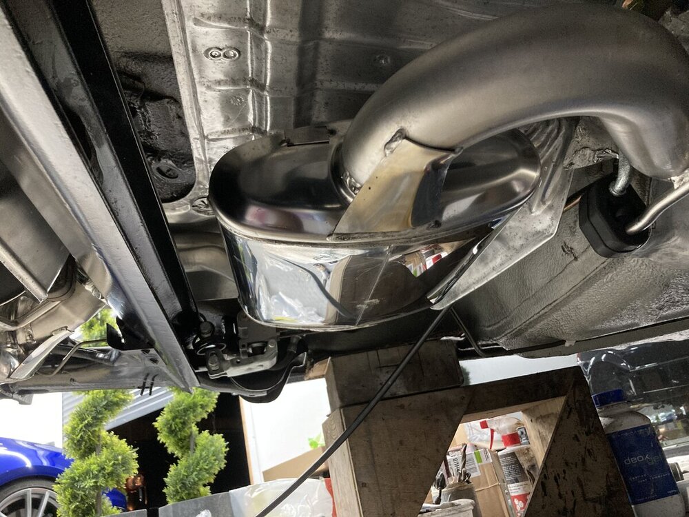

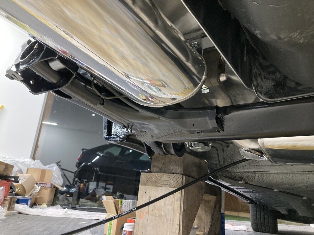

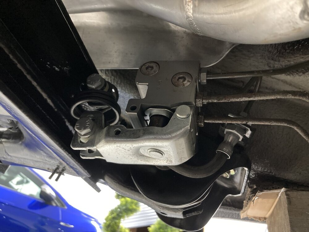

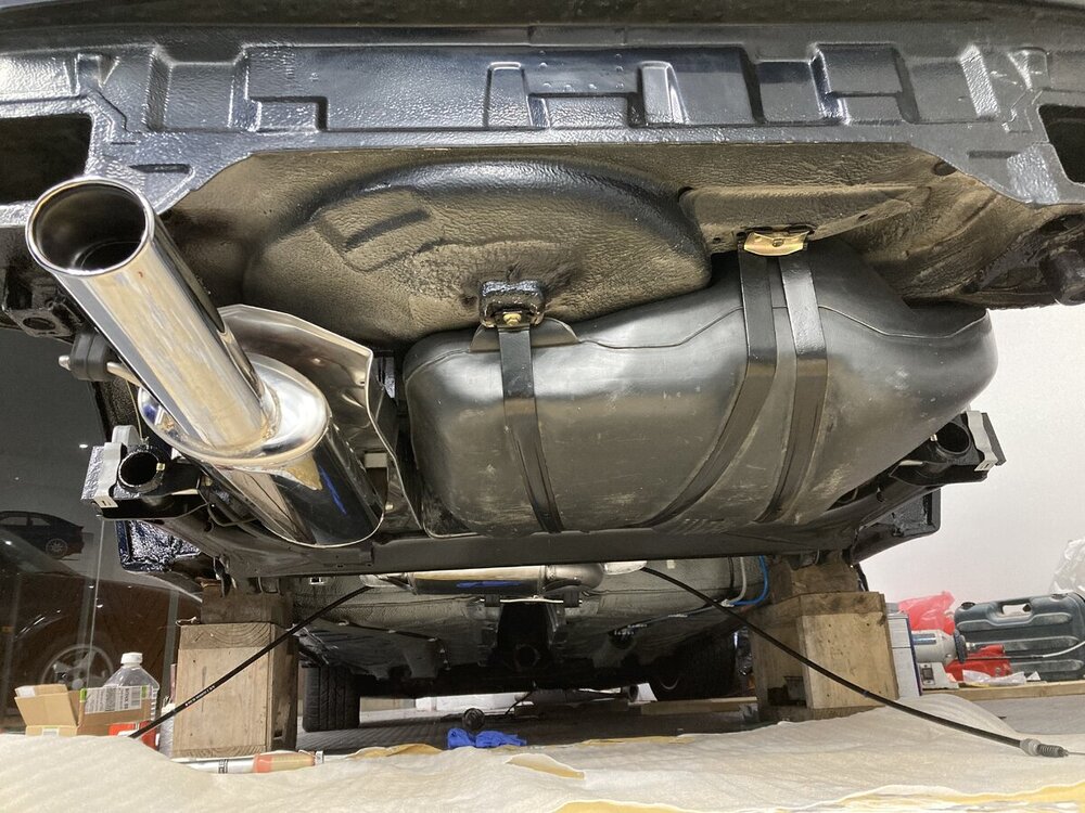

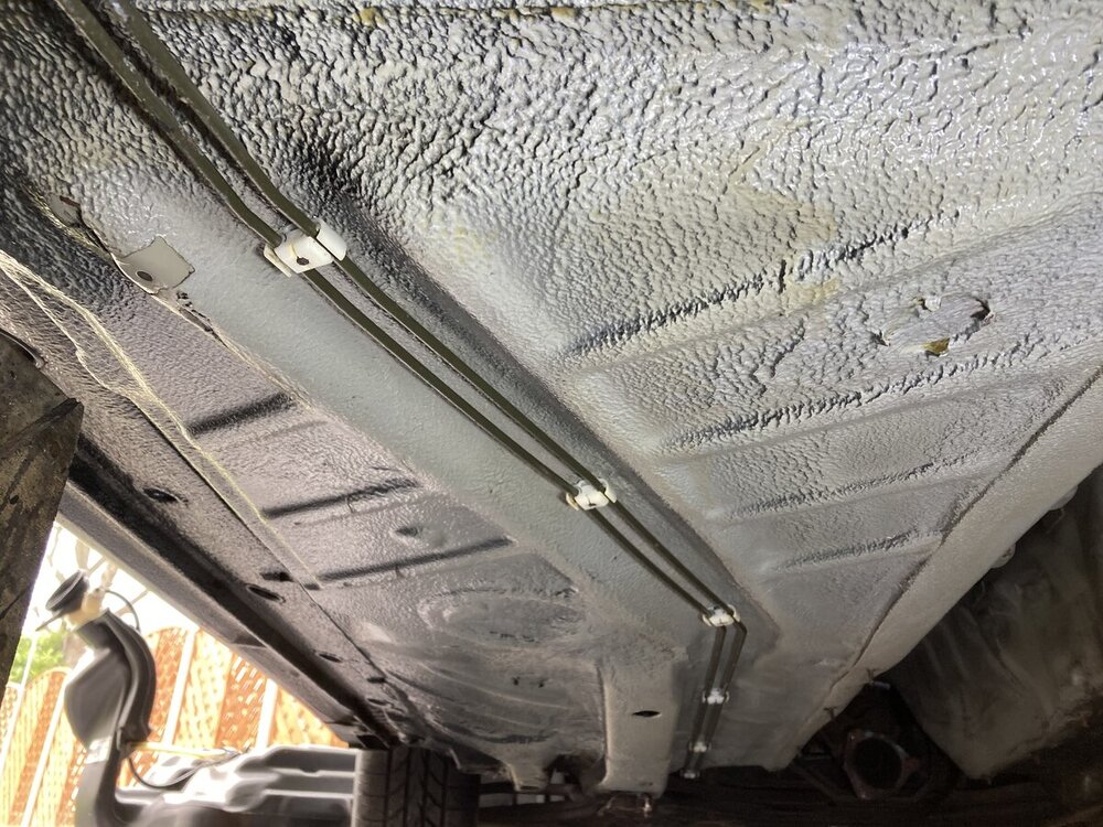

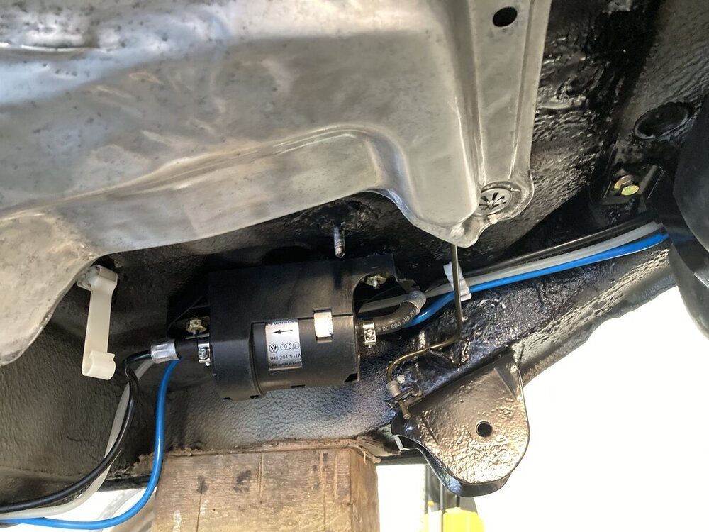

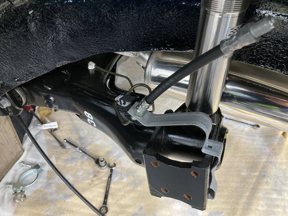

ChrisL 17 Posted October 14, 2022 Rear beam, brake lines and exhaust all fitted. Quote Share this post Link to post Share on other sites
1xshaunx1 27 Posted October 15, 2022 That looks great. You’ve inspired me, I’m off to fix my exhaust and change my oil. Quote Share this post Link to post Share on other sites
Corroda 11 Posted October 15, 2022 Amazing job Chris! I’m planning a similar job next spring, so really appreciate you sharing the pictures. I also have a Supersprint exhaust on order so would be interested in your thoughts on fit and tone, but it does look great quality. Quote Share this post Link to post Share on other sites
