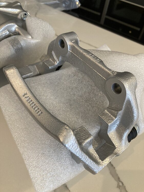

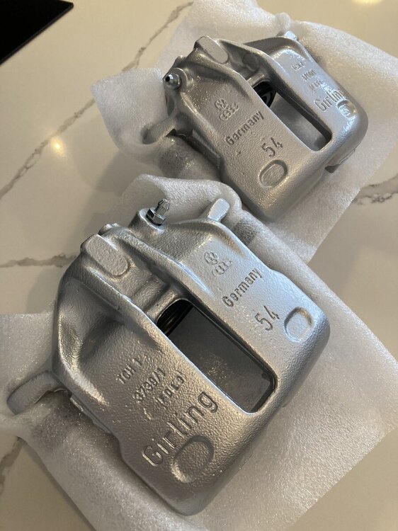

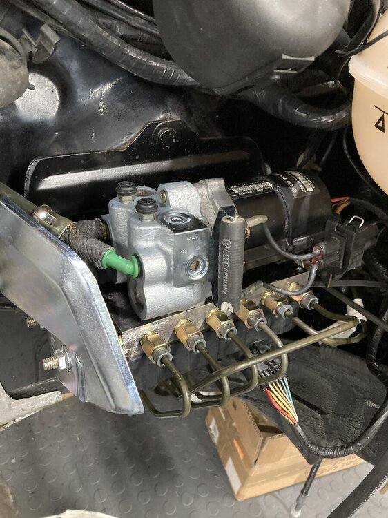

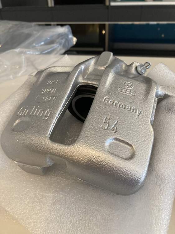

ChrisL 20 Posted May 14, 2023 Front brake calipers and carriers refurbished at BiggRed. Really pleased as they look new now Quote Share this post Link to post Share on other sites
Cressa 46 Posted May 14, 2023 That pump looks better than new, you must know a great player or sorting where to get those small parts from is amazing. All very impressive work. Calipers in an Oe look are definitely the way forward. Exceptional work as always 👍 Quote Share this post Link to post Share on other sites

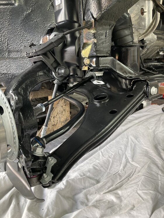

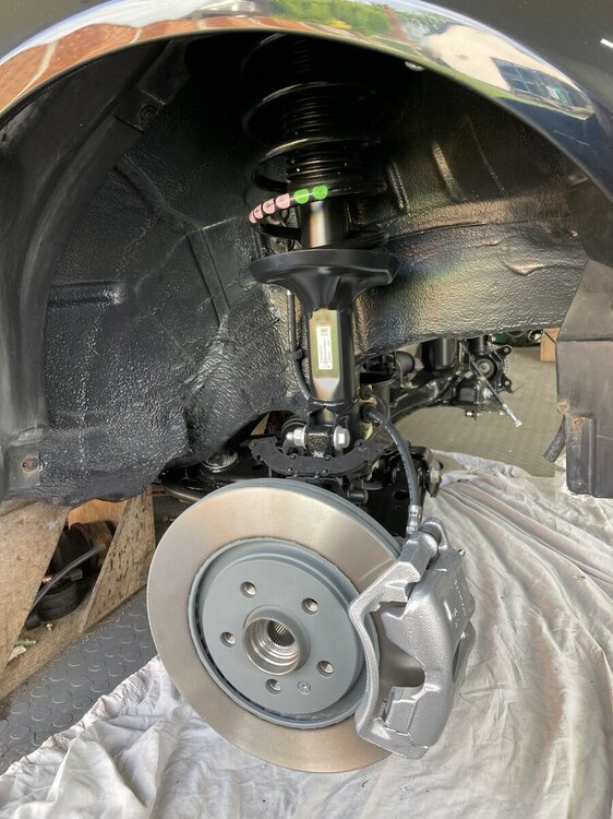

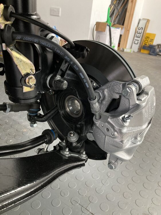

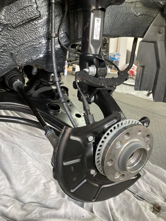

ChrisL 20 Posted May 29, 2023 Suspension, brakes and subframe all assembled and on the car. heater matrix next then engine Quote Share this post Link to post Share on other sites
Cressa 46 Posted May 29, 2023 That all looks amazing. Are you going to paint the bare nuts and bolts to stop them from rusting. That's the annoying part that you pay good money, make something amazing and the bloody thing goes rusty 🤬 May be not in your nice garage though 👍 Quote Share this post Link to post Share on other sites
ChrisL 20 Posted May 29, 2023 They come with whatever protection comes on the bolts and they are all genuine VW ones. To be fair, it won’t see any road salt so should stay ok. my imported R36 is like new underneath and that’s 14 years old. Quote Share this post Link to post Share on other sites

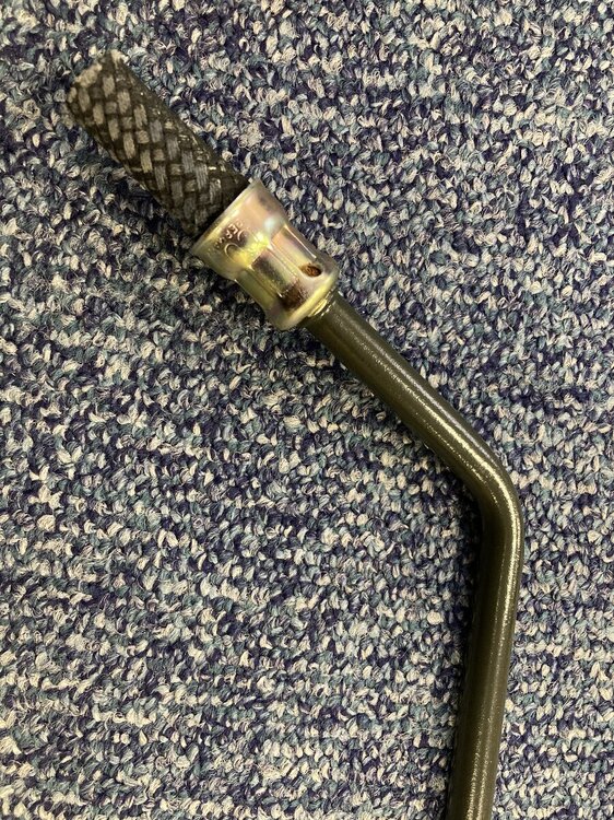

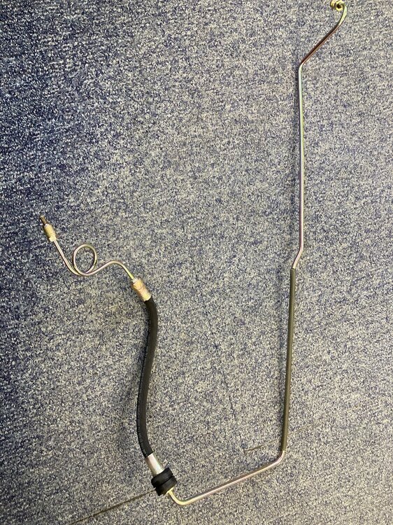

_Matt_ 33 Posted May 30, 2023 Lanoguard is pretty good as a clear covering or ACF 50 Import is good way to go too. Also saves on expensive road tax on say a mk5 r32 or I bet R36 if they were available in the UK - c£200 per year vs c£700 for UK registered cars. Corrado is looking lovely Chris. Just looking back at brakelines, did you make those or buy in? I've messaged a guy on here but not if still active. I can do it but I don't think i have the eye to make them as perfect as yours. Quote Share this post Link to post Share on other sites
ChrisL 20 Posted May 30, 2023 1 hour ago, _Matt_ said: Lanoguard is pretty good as a clear covering or ACF 50 Import is good way to go too. Also saves on expensive road tax on say a mk5 r32 or I bet R36 if they were available in the UK - c£200 per year vs c£700 for UK registered cars. Corrado is looking lovely Chris. Just looking back at brakelines, did you make those or buy in? I've messaged a guy on here but not if still active. I can do it but I don't think i have the eye to make them as perfect as yours. My R36 has Lanoguard on it. Don’t want anything that is sticky and attracts dirt to stick to it. the guy on here did some brake pipes but then was too busy to make anymore so found someone on eBay that did them for me. I sent him the genuine green pipe, genuine unions and the pipes I wanted making for a template. Didn’t charge much and the quality is as good as the guy on here. Quote Share this post Link to post Share on other sites

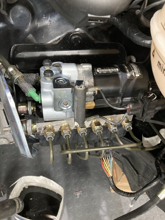

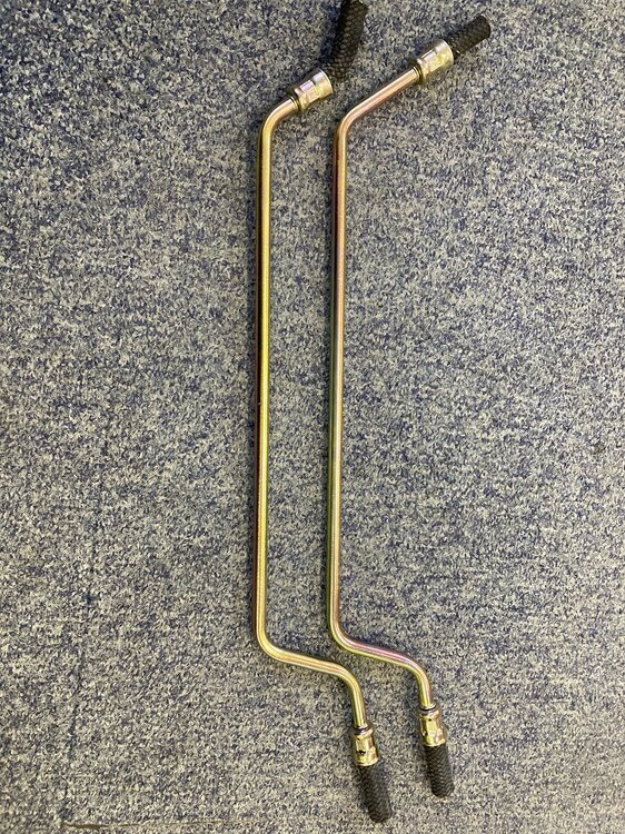

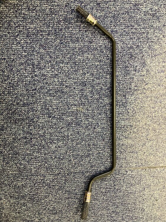

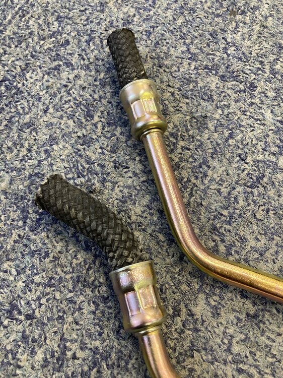

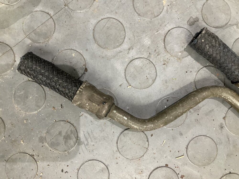

twinbeltg60 3 Posted June 1, 2023 On 5/14/2023 at 7:53 PM, ChrisL said: Refurbished the ABS pump. Hi, You are getting on well, will be very satisfying for you when you have it back on the road. I have a question, your ABS to Master Cylinder feed pipes look New are they, or were they in that good a condition to start ?. Quote Share this post Link to post Share on other sites
ChrisL 20 Posted June 1, 2023 Thanks, I actually just cleaned them, had them plated, I then matched the colour and sprayed them. one of the pipes is still available from classic parts. Quote Share this post Link to post Share on other sites

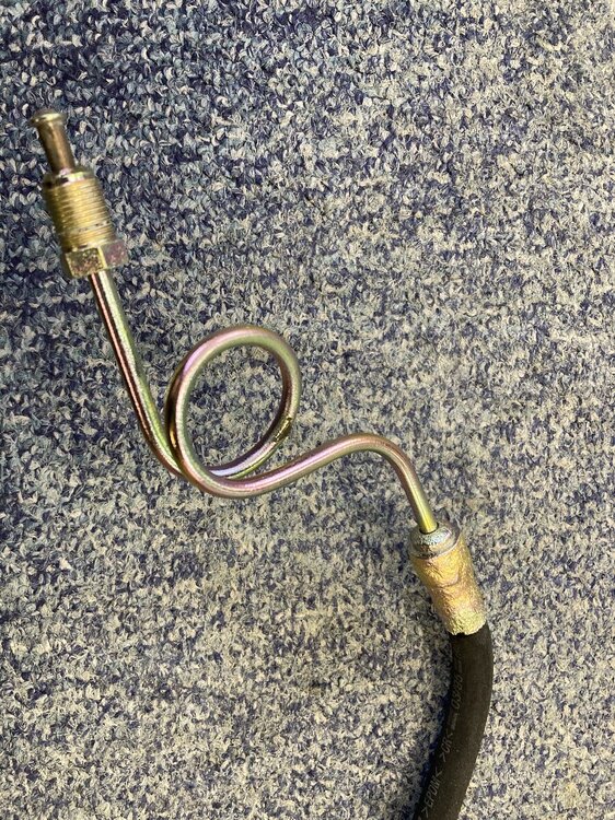

twinbeltg60 3 Posted June 2, 2023 10 hours ago, ChrisL said: Thanks, I actually just cleaned them, had them plated, I then matched the colour and sprayed them. one of the pipes is still available from classic parts. Ah, Many thanks for responding so quickly, so I home electroplated just the end fittings on mine , having taped up the main pipes and hose ends, all looked great at first but about 6 months later got corrosion spreading out from the small holes in the tube end fittings, some of the electrolyte must have been trapped and started leaching out. I started doing the plating myself (done majority of bolts , nuts, brackets etc) really only because I could not find any electroplaters within a 50 mile radius of Brackley that would bother to answer my voice mails, or online contact requests...perhaps I should have just knocked on their door, less easy to ignore me! Who does yours ? Many thanks, maybe I should try again , but plate the whole tubes with no taping so less chance of the problem. Quote Share this post Link to post Share on other sites
ChrisL 20 Posted June 2, 2023 (edited) I live in Hull and there is a place nearby that does it. This however was done by derby plating. They did my clutch line and fan case too Edited June 2, 2023 by ChrisL Quote Share this post Link to post Share on other sites
twinbeltg60 3 Posted June 2, 2023 35 minutes ago, ChrisL said: I live in Hull and there is a place nearby that does it. This however was done by derby plating. They did my clutch line and fan case too Chris, Many thanks for taking time out to post the pics and for the info, I have re-plated/ passivated the offending end fittings today, need to paint, the main pipes again, the olive green spray I used was rubbish, came off to easily, need to find the right colour and type of paint, but hopefully will get there, just another thousand things to do along the way with my G60. Have spent Far too much of my time, on this project, any sane person would have taken another direction a long time ago ! Hopefully will be on the road next year ? Cheers. Quote Share this post Link to post Share on other sites
ChrisL 20 Posted June 2, 2023 🤣🤣 I know what you mean. I etch primed the plated pipes then used some spray I had made at a local automotive paint supplies. I’ll try and find the colour for you. I matched the colour with my new brake pipes. Quote Share this post Link to post Share on other sites
oneohtwo 8 Posted June 4, 2023 ABS pump looks nice. Who did you get to refurbish it, or did you do it yourself? I had mine refurbished, but was a bit disappointed they didn't tidy up the outside! Quote Share this post Link to post Share on other sites
ChrisL 20 Posted June 4, 2023 48 minutes ago, oneohtwo said: ABS pump looks nice. Who did you get to refurbish it, or did you do it yourself? I had mine refurbished, but was a bit disappointed they didn't tidy up the outside! It was checked at BBA Remanufacturing and they say it’s working fine. I then stripped it and cleaned it etc. myself. Quote Share this post Link to post Share on other sites

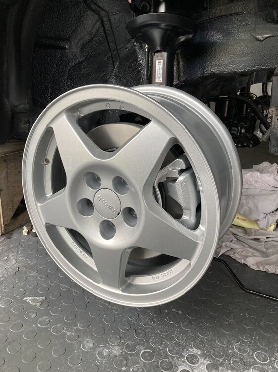

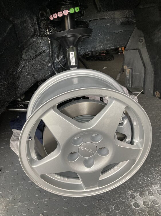

ChrisL 20 Posted June 6, 2023 Had to try a new speedline on the car. Quote Share this post Link to post Share on other sites
Cressa 46 Posted June 6, 2023 Definitely worth the money. Did you already have the centre caps hidden away? Quote Share this post Link to post Share on other sites
ChrisL 20 Posted June 6, 2023 Yes they are, happy to have gone the standard route now. no, bought the new centre caps from Kippy recently 👍 Quote Share this post Link to post Share on other sites
Cressa 46 Posted June 6, 2023 Great purchase. 👍 Quote Share this post Link to post Share on other sites

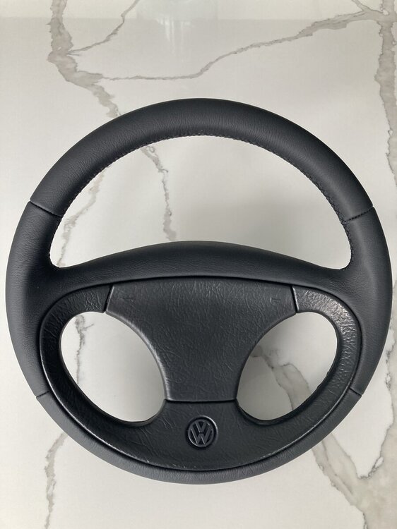

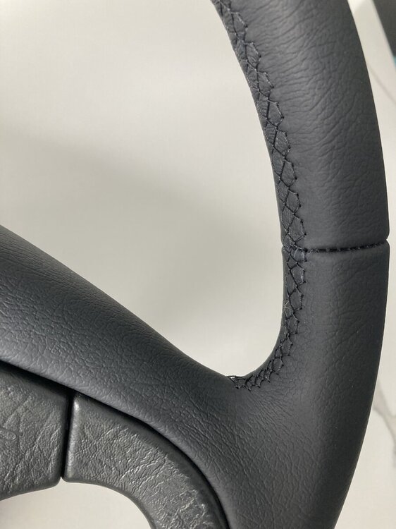

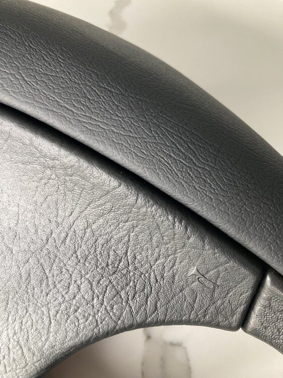

ChrisL 20 Posted July 26, 2023 Sent the steering wheel off for re-trimming but had to be OE finish so had to be specific on the leather Quote Share this post Link to post Share on other sites
Cressa 46 Posted July 28, 2023 Damn that does look nice. Did you know what leather to use or did they tell you? Quote Share this post Link to post Share on other sites
tonedef 10 Posted July 28, 2023 Was that Royal Steering Wheels by any chance, they did mine a few years ago and it was a brilliant job? Just need to find somebody to do the gear knob now. Quote Share this post Link to post Share on other sites
ChrisL 20 Posted July 28, 2023 11 hours ago, Cressa said: Damn that does look nice. Did you know what leather to use or did they tell you? Im really happy with it. It’s done in mercedez Benz grained leather 👍 8 hours ago, tonedef said: Was that Royal Steering Wheels by any chance, they did mine a few years ago and it was a brilliant job? Just need to find somebody to do the gear knob now. Yes Royal Steering Wheels. I’m waiting for them to tell me if they can do a gearknob, they didn’t want to do mine as they said it was too good to risk. I have a spare one with the leather removed to send them. Quote Share this post Link to post Share on other sites
