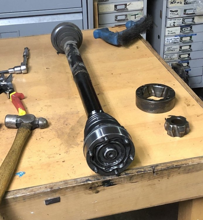

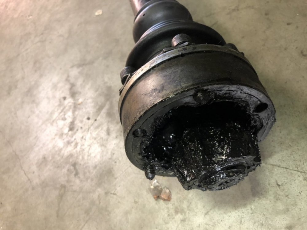

1xshaunx1 27 Posted April 18, 2020 Not touched the car for nearly 4 weeks since I got recovered after loosing drive on the way home, put it in the garage in disgust. Anyway after some calming and time doing housey stuff I’m missing the beast so yesterday pushed it out of the garage for a wash and back in and today I’ve jacked it up to diagnose the problem. As luck would have it, it isn’t total destruction of my 10 month refurbished Quaif lsd box. It is however total destruction of the drivers UJ on the drive shaft. So need to replace the drive shaft. Anybody had any experience of drive shaft madness from firms such as J and M or any other firm. Not sure about a 2nd hand eBay item, or maybe someone on here has a known good one they don’t want anymore. cheers guys Quote Share this post Link to post Share on other sites
Keyo 49 Posted April 18, 2020 35 minutes ago, 1xshaunx1 said: Not touched the car for nearly 4 weeks since I got recovered after loosing drive on the way home, put it in the garage in disgust. Anyway after some calming and time doing housey stuff I’m missing the beast so yesterday pushed it out of the garage for a wash and back in and today I’ve jacked it up to diagnose the problem. As luck would have it, it isn’t total destruction of my 10 month refurbished Quaif lsd box. It is however total destruction of the drivers UJ on the drive shaft. So need to replace the drive shaft. Anybody had any experience of drive shaft madness from firms such as J and M or any other firm. Not sure about a 2nd hand eBay item, or maybe someone on here has a known good one they don’t want anymore. cheers guys Mate if you click on the link it has upgraded drive axles up to a certain amount of power - has one up too 400 BHP. There is a six speed option one for a 2,9- will need to check if its for a 2.9 I guess as based in the States. Pricey though. https://www.ecstuning.com/Volkswagen-Corrado--VR6_12v/Drivetrain/Axles/ Quote Share this post Link to post Share on other sites

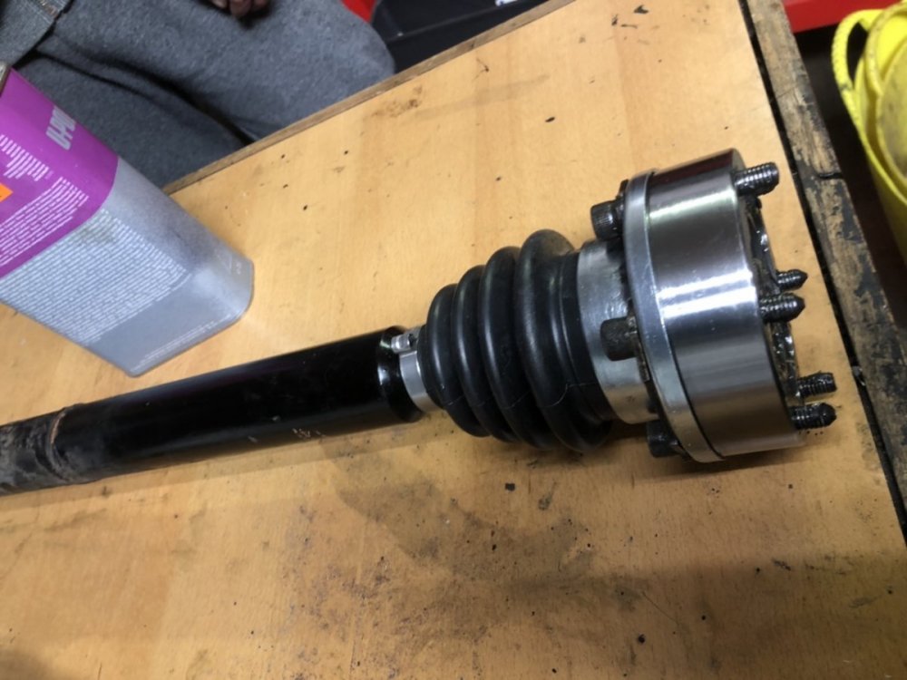

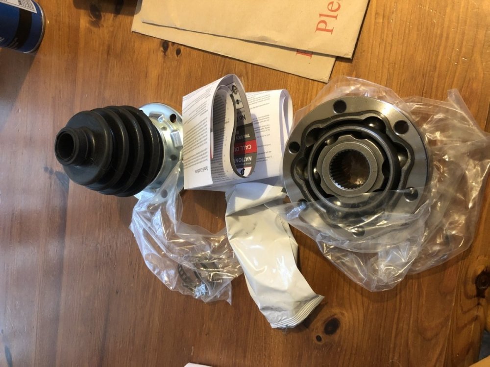

1xshaunx1 27 Posted April 30, 2020 After being messed about by a drive shaft seller I’ve decided to just change the cv joint for how much it cost, I figured it was worth a try after the shenanigans with carsparesdirect. I did think to upgrade as you said Keyo but I figured I’d rather the shaft than the box as that costs a lot more. Not that bad a job to be honest. Quote Share this post Link to post Share on other sites
Keyo 49 Posted April 30, 2020 2 hours ago, 1xshaunx1 said: After being messed about by a drive shaft seller I’ve decided to just change the cv joint for how much it cost, I figured it was worth a try after the shenanigans with carsparesdirect. I did think to upgrade as you said Keyo but I figured I’d rather the shaft than the box as that costs a lot more. Not that bad a job to be honest. Looks good quality that- where did you get it from mate. Quote Share this post Link to post Share on other sites
1xshaunx1 27 Posted April 30, 2020 It does look the part matey. We’ll see how good it is when it hits the road which shouldn’t be long now It’s a J&R one, came in at an eye watering £17 delivered. Wouldn’t normally buy one of the cheapest on the market but from what I can gather if it starts off good they are fairly trouble free. Hopefully given time I can give it a good review. If not I’ve got to come up with something else but at least I can move the car about under it’s own power now which I couldn’t do yesterday. Quote Share this post Link to post Share on other sites
Keyo 49 Posted April 30, 2020 (edited) 16 minutes ago, 1xshaunx1 said: It does look the part matey. We’ll see how good it is when it hits the road which shouldn’t be long now It’s a J&R one, came in at an eye watering £17 delivered. Wouldn’t normally buy one of the cheapest on the market but from what I can gather if it starts off good they are fairly trouble free. Hopefully given time I can give it a good review. If not I’ve got to come up with something else but at least I can move the car about under it’s own power now which I couldn’t do yesterday. Bloody hell god knows how they make a profit off that - and then there are classics selling a bit of plastic around the inner door handle for £70.00. Might be worth someone asking if they can make a 400 bhp version I would say they are a very accommodating firm- think they are based in my home city. When this crap is over I'm determined to get some Hella indicator lenses made for a reasonable cost. Edited April 30, 2020 by Keyo Quote Share this post Link to post Share on other sites
1xshaunx1 27 Posted April 30, 2020 I’ll see how this one goes for now, I’ll turn the boost down a bit 😉. I’ve just smoke tinted mine with the fogs while I’ve got the bumper off for a bit of flatting and buffing, which should happen tomorrow now I can get the car out of the garage. Also going to change my lip spoiler as I’m going to run standard speedlines for a bit which I’ve had refurbed with new tyres sitting around for 6 weeks. I’ve also got some brake duct vents and an early bumper grill to fit that I’ve had for ages. Quote Share this post Link to post Share on other sites
seanl82 23 Posted April 30, 2020 The JR ones are very good value and have good reviews. I've used them in the past and the only issue I had was with weeping of CV grease as I had to use a cable tie cos I cocked up the ear band! The only other thing is that the inner CVs don't come with the seal. I think it's a fibre outer one and a rubber inner (both inner CV). Quote Share this post Link to post Share on other sites
1xshaunx1 27 Posted April 30, 2020 29 minutes ago, seanl82 said: The JR ones are very good value and have good reviews. I've used them in the past and the only issue I had was with weeping of CV grease as I had to use a cable tie cos I cocked up the ear band! The only other thing is that the inner CVs don't come with the seal. I think it's a fibre outer one and a rubber inner (both inner CV). The joint I’ve put to on is the gear box joint and is all steel, it certainly seems to be good to go. I did manage to get the boot clip thing on but it took another pair of hands Quote Share this post Link to post Share on other sites
seanl82 23 Posted April 30, 2020 Yeah sorry for not making it clear, the side of the CV that mounts to the gearbox cup should have a rubber seal. The side that mounts to the boot/shaft should have a cork seal Quote Share this post Link to post Share on other sites

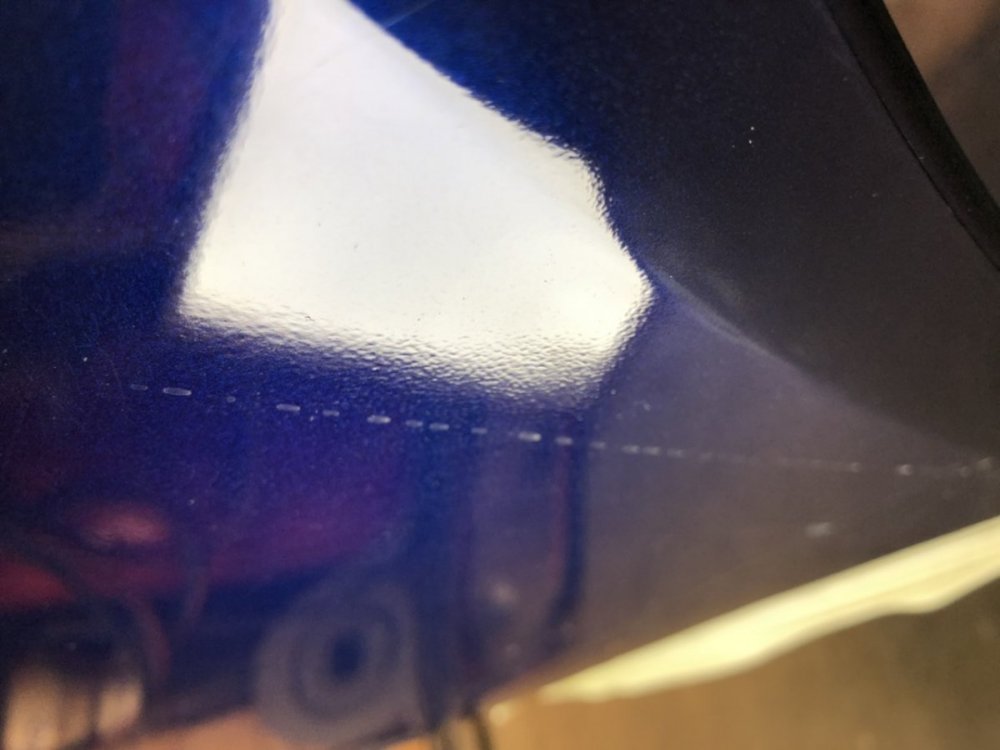

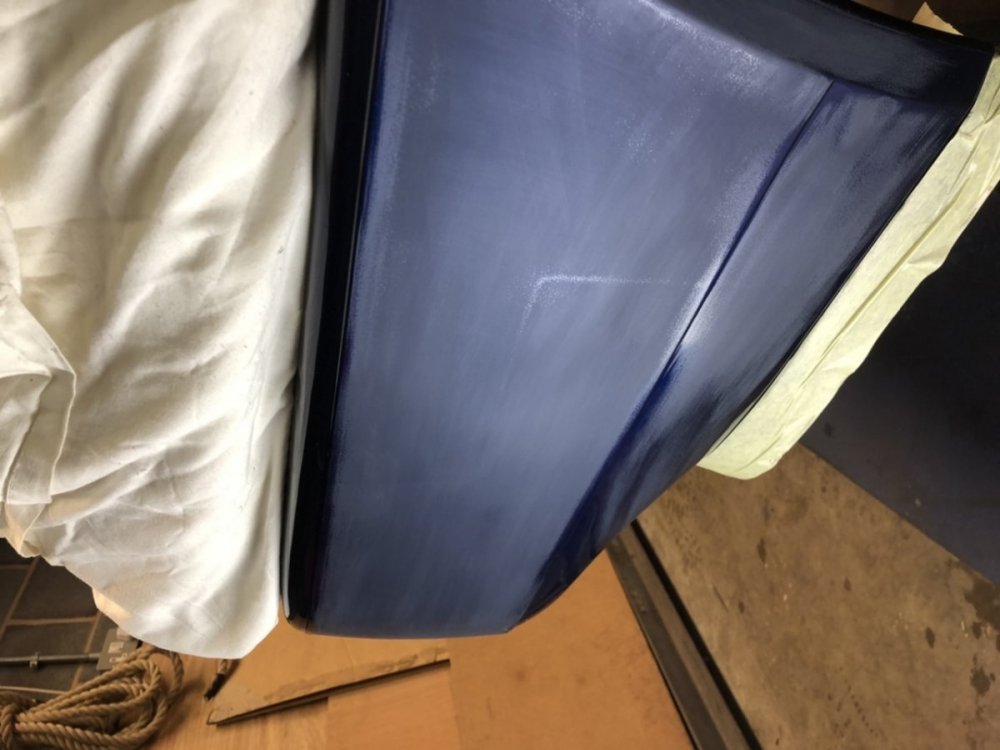

1xshaunx1 27 Posted May 2, 2020 Wet sanded the bumper top and sides. Looks much better. There was some heavy shrinkage of the new paint I had done on the new bumper and Passenger wing the wing had a dent in and the start of rust on the bottom of it. The work was about 12 months ago so hoping it’s fully cured now but just goes to show what can be done with poorly looking paint. I will say though, I find it very tedious, I don’t think I could do it for a living. Going to put it all back together tomorrow and test drive. Quote Share this post Link to post Share on other sites
Cressa 46 Posted May 2, 2020 I agree with finding it tedious. I'm not skilled or patient enough to make a good job. Good luck in putting it back together and taking it for a blast 💥 Quote Share this post Link to post Share on other sites
ChrisL 20 Posted May 2, 2020 Wow! That paint finish is excellent. Did you spray it with cans or from a gun? Quote Share this post Link to post Share on other sites

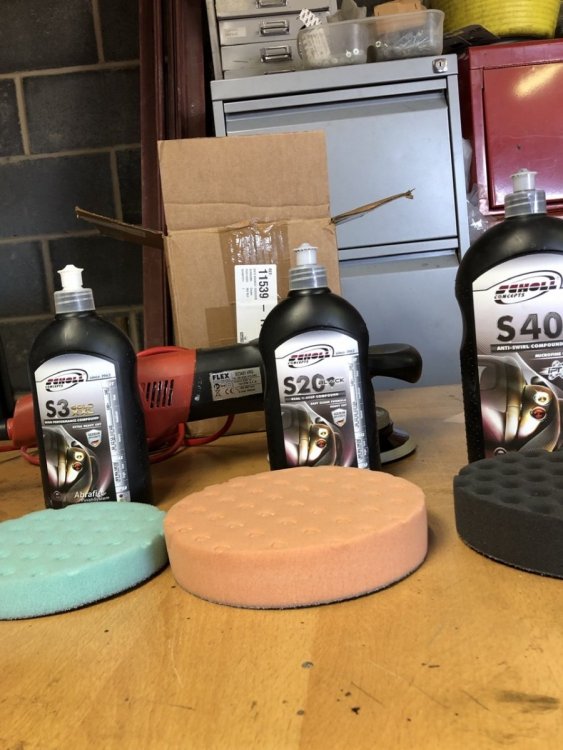

1xshaunx1 27 Posted May 3, 2020 11 hours ago, ChrisL said: Wow! That paint finish is excellent. Did you spray it with cans or from a gun? It was painted by a guy who runs a shop near me with a gun. He puts plenty of clear on so it can be made to look nice given time. I don’t think he’s had them in an oven after so the paint shrinks over time. Everything I’ve had done by him over the last couple of years has done it and ended with a finish similar to the first photo. The finish was achieved with 1500 grit wet and dry 2nd photo and 3 stage polish to achieve the mirror finish 3rd photo. I’ll take a photo of the stuff I used for polishing later. Quote Share this post Link to post Share on other sites

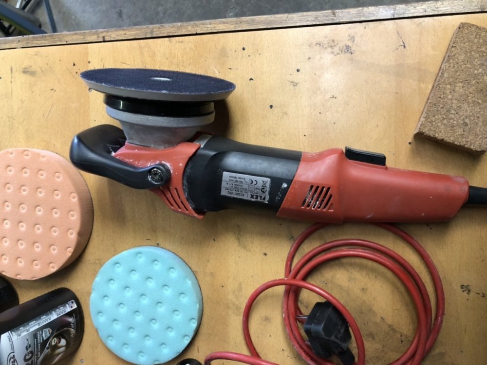

1xshaunx1 27 Posted May 3, 2020 If somebody is a bit new to paint correction, I’d advise getting an old bonnet or door and practice a bit before going too mad, watch a few You tube videos and when you set off rubbing with wet and dry don’t push on to hard, keep away from the edges The Flex polisher I used bellow. The pads are CCS Lake County green, orange then black with Scholl S3- green about 4 passes then S20 on the orange pad for a couple of passes and finally S40 With the black pad which really does take any remaining swirl marks out. Quote Share this post Link to post Share on other sites

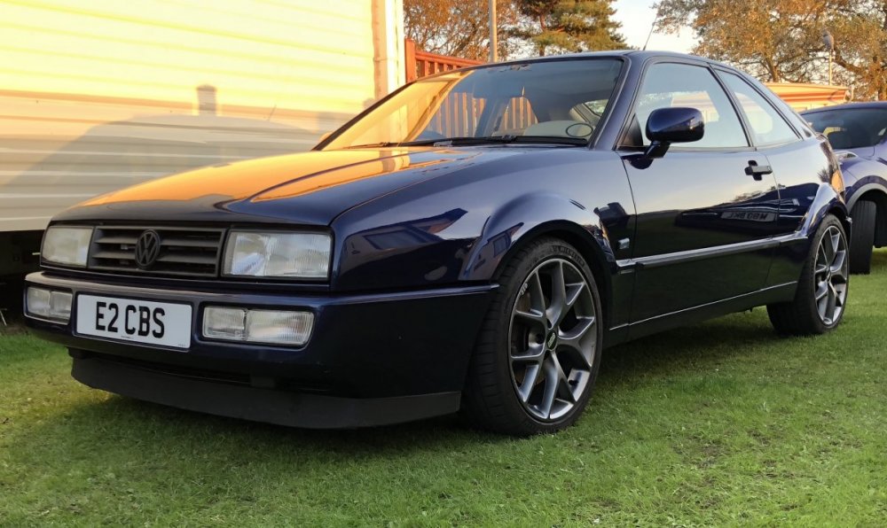

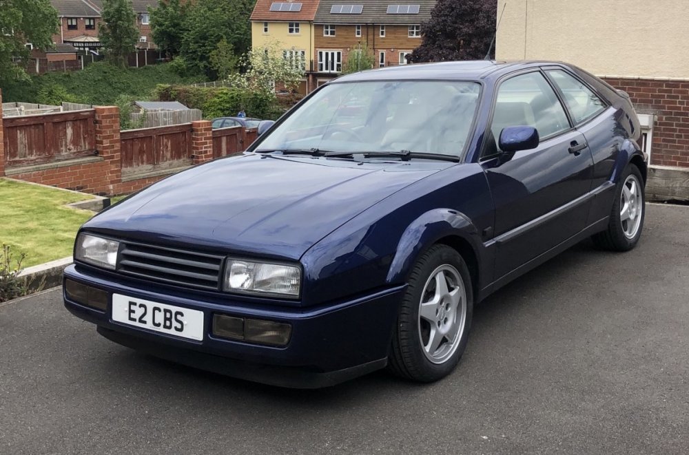

1xshaunx1 27 Posted May 6, 2020 15 hours ago, Tigerfish said: Looks great. I agree with you about a tint on the figs and indicators. I’ve done the same on mine, along with tinted head light covers, I really like the look. Sent from my iPhone using Tapatalk Pro Cheers matey this photo shows it a bit better. I think the speedlines don’t look as good as the 17” BBS though I am a lot faster over the speed bumps now with these on Quote Share this post Link to post Share on other sites
Tigerfish 10 Posted May 6, 2020 Yeah, the BBS do look wicked, and much better than the 15” speedlines. I know when I had 17’s on mine, it was very crashy over bad roads. The 16’s I’ve got now are much better, 15’s must be proper smooth.Sent from my iPhone using Tapatalk Pro Quote Share this post Link to post Share on other sites
