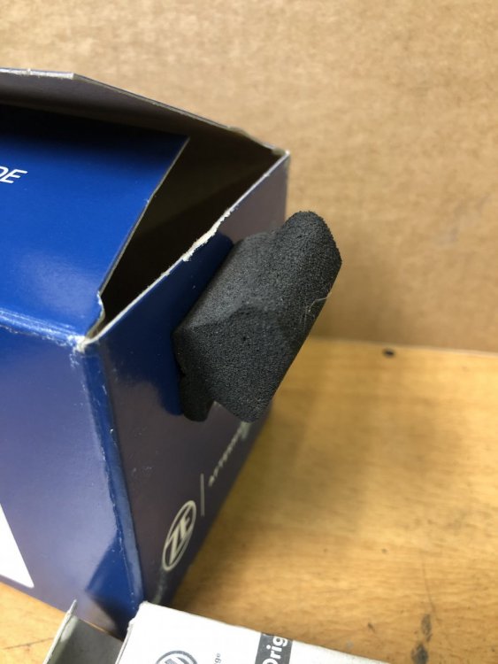

Bottom of door seal.
How do you get these off- do you just pull the clips off the bottom - can you do it with the doorcard still on ?

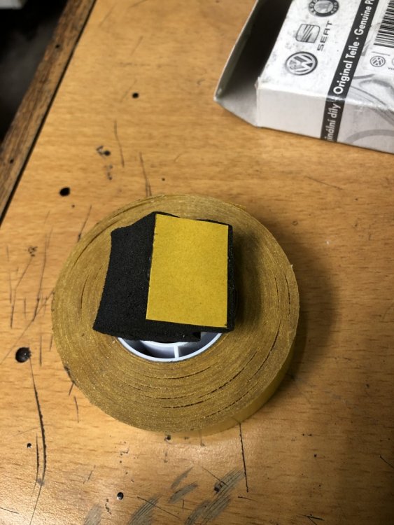

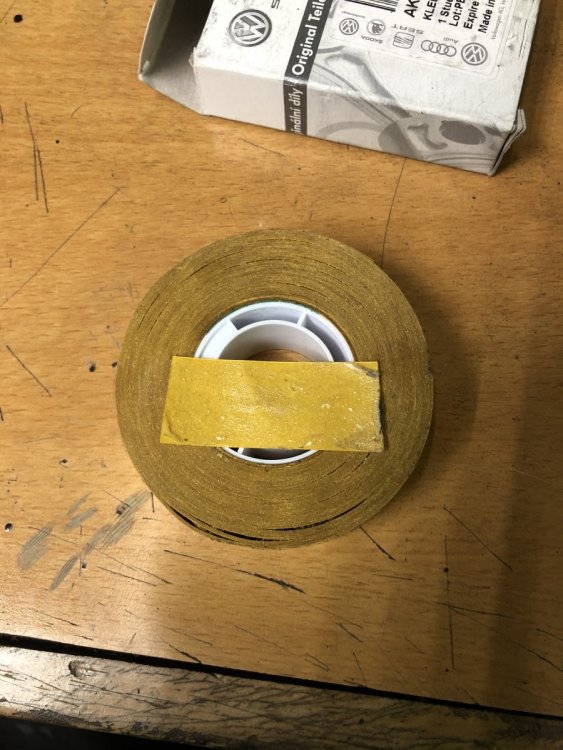

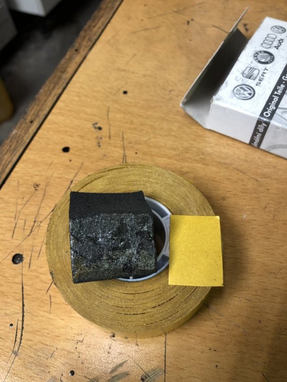

Double sided sticky membrane.
Got this in 2012 by the looks of it. It’s like a super sticky membrane that is really useful for things like rubber bits as in the door jar and hatch 3C5FD9AD-301C-4E96-A539-2BBECD11F077.thumb.jpeg.954a5e997883d5c81131d500d3a7732e.jpegA59974EB-552E-4B47-9AE6-727EAEF6D262.thumb.jpeg.41ed0ff2f40950a0ae2e4be43aa149f3.jpegAAC224C9-0F26-4BF2-82C8-ED3060B66F85.thumb.jpeg.42003ff8561bcd89ed79b9c14bbe42f3.jpeg79F89F02-2631-4A00-9AA0-4BBDA49CA091.thumb.jpeg.1093c5639e73a655f858b261068a2a95.jpeg6C9D1B7F-66CA-40CC-9ADE-F4E91EA433BE.thumb.jpeg.26e4f091d5fb9b88920313391a215100.jpegBF91B8F1-C17C-4AEF-A022-942084C056F2.thumb.jpeg.7661b250430ec5218456811cd605af51.jpeg
You can still buy those door hinge seals new - same as a MK2 golf and can buy from VAG. Also came on some Audi, they come flat but when you shut the door it presses them.
https://www.ebay.co.uk/itm/Audi-ur-quattro-coupe-door-check-strap-gasket-867837267/223908062506?epid=1709535915&hash=item3421f5e52a:g:JR4AAOSwdUtdhJqT

You dont need to remove the door cards they are at the very bottom of the door. Remove the clips, but they also have an adhesive tape on the back. 👍 which I'm guessing Shaun has used his posh tape on
There are 5 clip things and double sided adhesive as Cressa says. Beware the clips are fragile as is everything. They pop over a mushroom thing to secure.
Used normal black foamed double sided tape to refit, about the same thickness as I took off the seals

Sure if you look at the yellow tape on the back looks same a Shaun. I actually have a nos bottom door seal one to put on - can still buy the press studs = its odd on etka the seal ending with 13 is for left but the right one is just blank with no part number- are they the same seal for both sides.
Update left ends with 13 and right 14 - both obsolete as a dodo.

Definitely not the same seal, they are handed. There are two mushrooms for clips close together at the front of the  door. I saved money and cleaned mine up with Gumi Pflege, after all they are under the door.

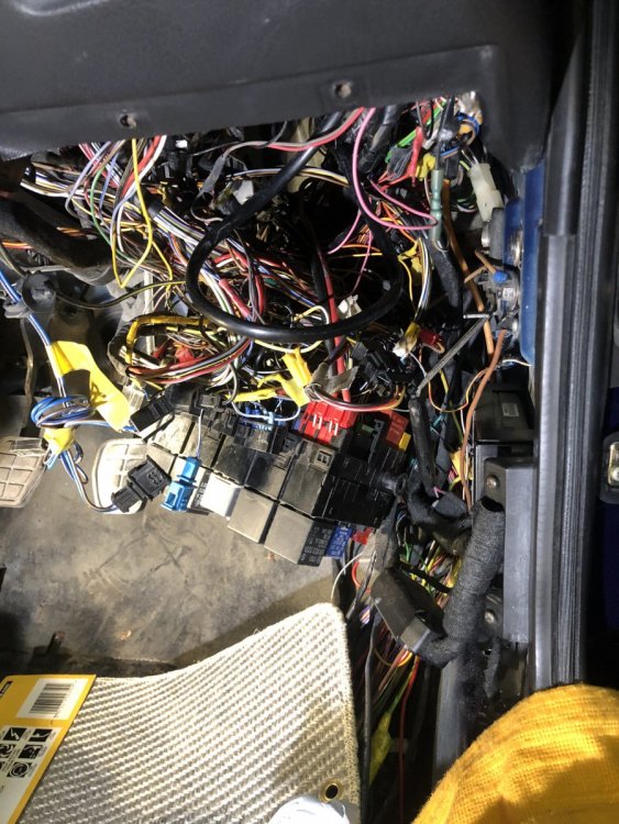

Finally got some mojo and put my front end together and I had a look at my wiring issues which involved messing with the rats nest,  the ABS plugs and A5C3C4A4-AFB4-4958-A0D9-C8D20F16BBCD.thumb.jpeg.683695cbc2df63214c87e1dc0c00dce4.jpeg
Unexpectedly total success. First time the ABS light is working properly in my ownership and it’s the first time I’ve seen the fuse box back in position since I bought the car31D7DCAD-9CB0-4454-AA49-328A5A851634.thumb.jpeg.6011225d6a4cdcbf4ee76dc2771a1810.jpeg

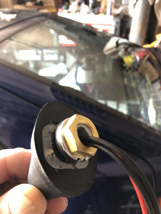

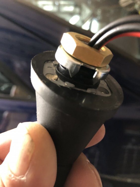

Tried fitting the dab arial I got off eBay it doesn’t. It wants to sit too high, I may have to dremel something. I did get my rain tray in and washer jets mounted in it so they spray from under the bonnet. More time also went on some unhealthy looking wiring attached to the headlight switch loom which plugs in the fuse box next to the wiper motor loom, guess how I know that.

Has anybody else tried one of these. It seems to have sticky out bits that stop it sitting flush with the roof. 49F8BF2F-5888-4B23-B4E6-75F5F686AD01.thumb.jpeg.77d35f646a5cb992d62df5db6abb271a.jpeg6EC07B59-9570-4D62-8CD2-D864593DC30E.thumb.jpeg.2fa3c071f652c9feb9d67aa40d862c9b.jpeg
Found this picture of my Hirschmann aerial. Doesnt seem to have them when zoomed in !!
