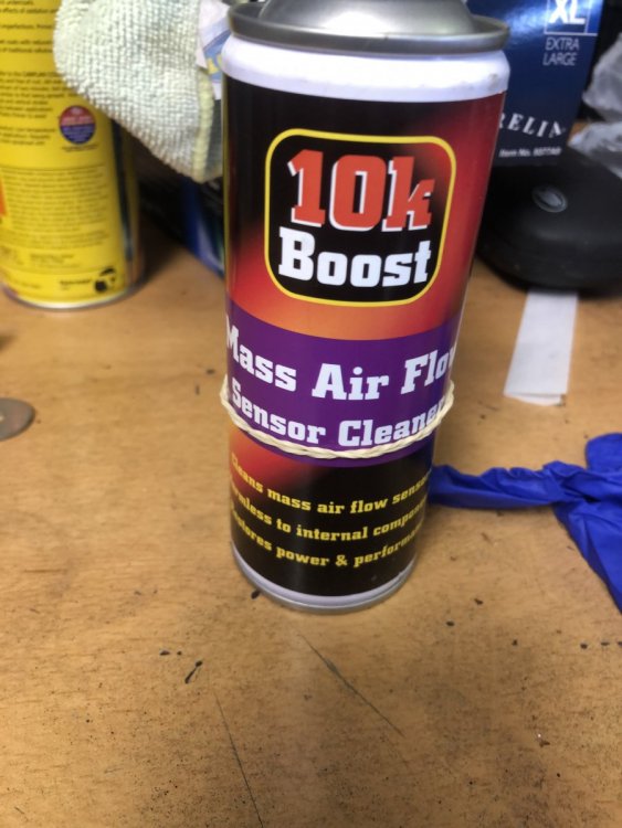

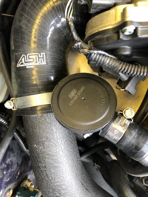

Found time at the weekend to look at some intermittent running issues. Although it’s a lot smoother with new coil pack it still wasn’t always what it should be. So bought a new air filter and took everything to bits from the filter to the turbo. It seem a fair bit of oil residue etc coming into the intake from the crankcase breather. Cleaned all the air pipes out with break cleaner and sprayed the MAF with 10k Boost MAF cleaner. Also put  a pcv vale off a 1.8T Audi on the breather
Jackpot
Running like it is brand new. Cold start, hot start, partial throttle, idling and boost, all as you would expect.
 The best thing I got out of this is that you don’t need to search for months for a new MAF if yours is a genuine Bosch try spraying the MAF cleaner on it first, it may bring it back to full life.

4 hours ago, fla said:
yes the 1.8t pcv sounds interesting..any details Shaun?
The oe one is obsolete PCV valve so very interesting to hear this myself.
Been for 100 mile test yesterday driving on mostly B roads and no issues, The cars is really behaving nicely.
Keyo
With a bit of research the Bosch coil pack I’ve fitted is also for the Ferrari F50 amongst other motors, say no more on that one.
Not really tested the PCV too much yet but all seems well at the moment with it.

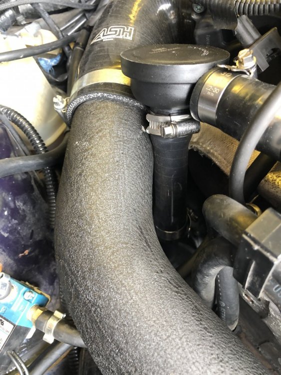

This is a copy part for £8.55 off of EBay of 06A129101D. I don’t think it’s of much use to you standard set up guys though as it’s a 90 degree set up and you want 180 degree.
You’ll also may notice I have a disconnected plug hanging there, this should be plugged into the bit that goes just before the pcv valve. It’s a dummy plug it does nothing, if you unplug yours, you will notice there are no pins in the bit it plugs into. Mine was removed as it does nothing and there is no room for it. I’ve moved that jubilee clamp a bit too since the photo.
Ah yes the famous hockey puck pcv! I used to have an A4 B6 which had the same one. I guess a few elbows could be used to connect it? Although like you say, with a NA engine is there sufficient pressure to allow it to operate?

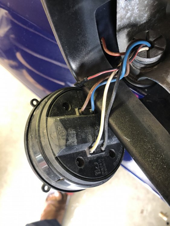

The electric windows started playing up at the weekend, plenty of clicking but intermittent up and downy issues. So had the back panel/card off and fitted another control unit, that solved that, fitted the new drivers seatbelt while the rear quarter was in bits too. Put all that back together.
Then turned my attention to the drivers door mirror, again plenty of clicking but this time absolutely no motions. This was solved by swapping the motor out for a used spare I had, problems solved, the motor must have been seized on the old one. All clicking for power getting there but no motion.
FYI motors for the passenger and driver door mirrors are exactly the same and the back of the motor tells you what colour wire pin goes in which hole  Very easy to swap, 4 wires, 4 screws and the mirror, simple fix.
About 3 hours of messing so not long to diagnose and fix, spent more time psyching myself up for the jobs 🤣😂🤣😂, so pleasantly surprised that it went so well and only cost only time today as I had the motors and window controller already.

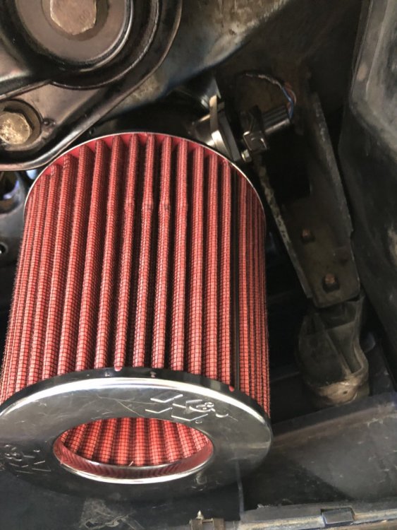

Think it’s a 5” aluminium maf housing with definitely a K & N filter attached
Got that wrong it’s 4”,  100mm and the filter of choice at the moment is a K&N RG-1001RD. This filter is a £28 bargain at the moment on eBay and comes with rubber inserts to reduce the diameter if needed.
