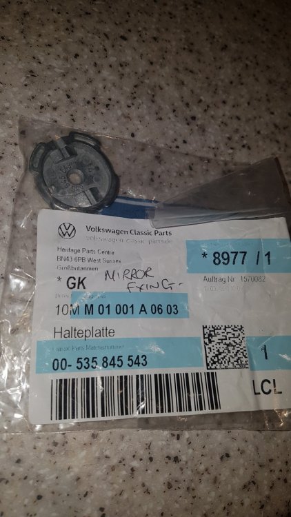

Keyo 49 Posted November 12, 2020 (edited) On 11/12/2020 at 6:00 PM, KarlosG60 said: My Corrado never wear a rear view mirror because I was always at first place in the road, so far from the others, so I never need it Ok, joking. I bought years ago a mirror, but I didn't know how to mounted, so now I will like to do it, but I don't know if it use some kind glue and works or I need a support or something. Thanks and regards The windscreen should have a circular bracket part number 535845543 that it clicks onto. Comes on new windscreen. Look on photos of ebay link. https://www.ebay.de/itm/VW-Corrado-53I-Frontscheibe-Windschutzscheibe-grun-Blaukeil-Sh-Autoglas-Glas-neu/153836343153?hash=item23d15c4f71:g:wKUAAOSwFZNeSvSK Edited November 12, 2020 by Keyo Quote Share this post Link to post Share on other sites
KarlosG60 2 Posted November 13, 2020 (edited) On 11/12/2020 at 6:48 PM, Keyo said: The windscreen should have a circular bracket part number 535845543 that it clicks onto. Comes on new windscreen. Look on photos of ebay link. https://www.ebay.de/itm/VW-Corrado-53I-Frontscheibe-Windschutzscheibe-grun-Blaukeil-Sh-Autoglas-Glas-neu/153836343153?hash=item23d15c4f71:g:wKUAAOSwFZNeSvSK Thanks. I didn't search correctly at ETKA... And how is it mounted on windscreen? Some kind of glue? Or the bracket cames with a sticker or something? Edited November 13, 2020 by KarlosG60 Quote Share this post Link to post Share on other sites
Keyo 49 Posted November 13, 2020 (edited) On 11/13/2020 at 6:32 AM, KarlosG60 said: Thanks. I didn't search correctly at ETKA... And how is it mounted on windscreen? Some kind of glue? Or the bracket cames with a sticker or something? It must be glued on and the sticker is to hide it from outside of car I imagine- how bad is your windscreen - the clip is very expensive Between £40-£50 only last couple left was £11.00 earlier this year. . - if your windscreen is old with faults it might be better to use insurance and get new screen with clip (make sure screen comes with clip). Maybe VW dealer sells for cheaper the clip. Edited November 13, 2020 by Keyo Quote Share this post Link to post Share on other sites
KarlosG60 2 Posted November 13, 2020 (edited) On 11/13/2020 at 6:54 AM, Keyo said: It must be glued on and the sticker is to hide it from outside of car I imagine- how bad is your windscreen - the clip is very expensive Between £40-£50 only last couple left was £11.00 earlier this year. . - if your windscreen is old with faults it might be better to use insurance and get new screen with clip (make sure screen comes with clip). Maybe VW dealer sells for cheaper the clip. Well, the car haven't insurance right now and I think my windscreen is in good conditions (maybe it's the original, I don't know). Do you know if any other VW shares the bracket, or maybe I can use another from Golf MKIII ? I search in ETKA and in VWClassic, but I think they are very different 🙁 I will call to my dealer later today... Who knows... Thanks Keyo. Regards Edited November 13, 2020 by KarlosG60 Quote Share this post Link to post Share on other sites
fendervg 33 Posted November 13, 2020 Unfortunately the 535 at the beginning means it is a Corrado specific part - the first three digits indicate the Medellin number. Maybe it would be possible to remove the mount from a car that is being broken for parts if the bonding is not too strong? 1 Quote Share this post Link to post Share on other sites

fendervg 33 Posted November 13, 2020 Golf 3 is different, the part number indicates that it is a Corrado specific item - but if you ask on the Facebook Corrado groups or put a post in the "Wanted" section on here, there are always a few cars being broken for parts. I wouldn't be too confident that the bracket would come off without damage, so if it was me I would probably just buy the part - do a careful search and it might turn up cheaper elsewhere. Quote Share this post Link to post Share on other sites
joebloggsVR69 0 Posted November 13, 2020 You might be able to remove the bracket from an old windscreen using something like dental floss. Years ago, my one just fell off, so I re-attached it using special loctite glue: https://www.amazon.co.uk/Loctite-81706001-Rear-Mirror-Bonder/dp/B0001P0DLU You cut a circular patch, from this mesh stuff that's in the kit, and apply the glue. Hold it all to the screen for a few minutes and it's done. Quote Share this post Link to post Share on other sites

KarlosG60 2 Posted November 13, 2020 (edited) On 11/13/2020 at 1:12 PM, 1xshaunx1 said: (maybe it's the original, I don't know). Wouldn’t think so as all Corrados came with a rear view mirror fitted from the factory in Germany as standard equipment. The preivous owner said to me it felt down by hand stroke. I never check if appears VW logo at windscreen. In any case if my only chance is to buy the "holder" for 50e... 🤷♂️ On 11/13/2020 at 12:56 PM, joebloggsVR69 said: You might be able to remove the bracket from an old windscreen using something like dental floss. Years ago, my one just fell off, so I re-attached it using special loctite glue: https://www.amazon.co.uk/Loctite-81706001-Rear-Mirror-Bonder/dp/B0001P0DLU You cut a circular patch, from this mesh stuff that's in the kit, and apply the glue. Hold it all to the screen for a few minutes and it's done. That's a good idea, because the difference of buying the holder/bracket and a used windscreen is not too big to discard the option of buying one, extract it from it (if it's easy to do, I don't know) and install to my windscreen and save the other windscreen for whatever. On 11/13/2020 at 10:14 AM, fendervg said: Golf 3 is different, the part number indicates that it is a Corrado specific item - but if you ask on the Facebook Corrado groups or put a post in the "Wanted" section on here, there are always a few cars being broken for parts. I wouldn't be too confident that the bracket would come off without damage, so if it was me I would probably just buy the part - do a careful search and it might turn up cheaper elsewhere. Where is that FB group? I cannot write posts in others section yet. Thank you guys. Edited November 13, 2020 by KarlosG60 Quote Share this post Link to post Share on other sites
Cressa 46 Posted November 14, 2020 I got mine from classic parts not too long ago. Didnt think it was a crazy price tho !! Quote Share this post Link to post Share on other sites
KarlosG60 2 Posted November 15, 2020 On 11/14/2020 at 8:15 PM, Cressa said: I got mine from classic parts not too long ago. Didnt think it was a crazy price tho !! VWClassic had it? F*ck... Do you sell it? Quote Share this post Link to post Share on other sites
Keyo 49 Posted November 15, 2020 (edited) On 11/15/2020 at 5:44 PM, KarlosG60 said: VWClassic had it? F*ck... Do you sell it? Here is the website search part number- I think they have sold out and now obsolete and last few are now with aftermarket sellers asking four times the cost. Ironically I scrapped what was left of a Corrado a week back - the only thing left was a windscreen and that clip and inner panels- little did I know it could of topped up my pension account with that clip 😀 Cressa did your new windscreen come with the clip mounted on the screen from Sekurit ? https://www.volkswagen-classic-parts.de/en/ Edited November 15, 2020 by Keyo Quote Share this post Link to post Share on other sites
Cressa 46 Posted November 15, 2020 New windscreen came with the clip mate, yes 👍 Quote Share this post Link to post Share on other sites
Keyo 49 Posted November 15, 2020 On 11/15/2020 at 7:37 PM, Cressa said: New windscreen came with the clip mate, yes 👍 Thank god for that chap= I wonder if the clip on the screen is a vag one otherwise St Gobain might stop making them. Quote Share this post Link to post Share on other sites

Cressa 46 Posted November 17, 2020 https://www.ebay.co.uk/itm/302343709635 One for sale 👍 or make me an offer for mine, without me feeling guilty Quote Share this post Link to post Share on other sites
Keyo 49 Posted November 17, 2020 On 11/17/2020 at 8:13 PM, Cressa said: https://www.ebay.co.uk/itm/302343709635 One for sale 👍 or make me an offer for mine, without me feeling guilty The one on ebay is the last one in the world and sold by Nick the Greek so I would value Cressa's gold nugget at 1 million dollars and rising daily. . Quote Share this post Link to post Share on other sites
fendervg 33 Posted November 17, 2020 A bargain at double the price! Still cheaper than a replacement screen and all the attendant hassle, unless you can get it done on insurance. Quote Share this post Link to post Share on other sites
