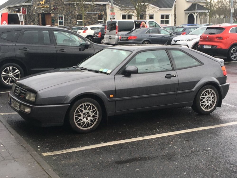

Keyo 47 Posted December 2, 2020 (edited) Members does my car look like its sitting the way it should- on B4 and eibach 20 -25mm with the rear springs that are sent afterwards like other posters on here. Second picture is perfectly flat ground. Thank you Edited December 2, 2020 by Keyo Quote Share this post Link to post Share on other sites
_Matt_ 32 Posted December 2, 2020 My car sits the same as yours Keyo. I prefer it that way as the original setup was slightly nose down and arse up. When you're moving on the road the arse squats down a bit too. Here's mine BUT - no interior and not much fuel in the tank Quote Share this post Link to post Share on other sites
Keyo 47 Posted December 2, 2020 2 minutes ago, MJA said: My car sits the same as yours Keyo. I prefer it that way as the original setup was slightly nose down and arse up. When you're moving on the road the arse squats down a bit too. Here's mine BUT - no interior and not much fuel in the tank Nice one mate I will put it to rest ha. Quote Share this post Link to post Share on other sites

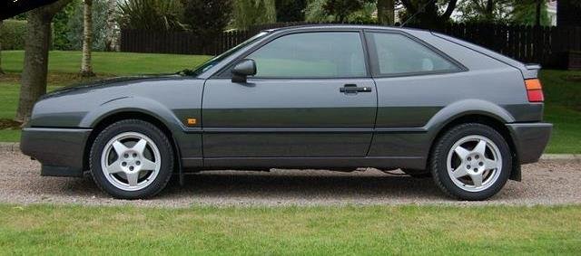

_Matt_ 32 Posted December 2, 2020 Here it is STOCK - the rear always kicked up a little higher I do think pre 93 cars sat lower and if i could find those springs I would change for them if running stock speedlines. Don't think it would look right on 16s though. Quote Share this post Link to post Share on other sites
fendervg 33 Posted December 2, 2020 I think it looks just about right for a 20-25mm drop, Keyo. MJA - they were my thoughts on the earlier cars, mine definitely sat lower than the later ones on stock springs. Here's mine on 15" wheels with the B6/H&R green combo: 1 Quote Share this post Link to post Share on other sites

_Matt_ 32 Posted December 2, 2020 I don't think I've seen your car before fen - nice! Yeah those stock springs are definitely lower than mine. Maybe only by 1cm but yours looks far less awkward than mine on stock springs. Quote Share this post Link to post Share on other sites

Keyo 47 Posted December 2, 2020 Nice motor fen . Early cars sit a lot better - I think late models when you look at the rear of the cars the wheels look odd and almost like the car body / bumper needs to be lower and rap a bit more to the lower wheel . Quote Share this post Link to post Share on other sites
