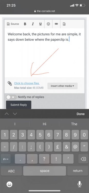

Thanks for the warm welcome guys, would love to post some pictures but can’t seem to do it! Just says insert image from URL, anyone know how to do this when pictures are on an i phone?
Welcome back, the pictures for me are simple, it says down below where the paperclip is. Have you paid the joining fee? Might be that?

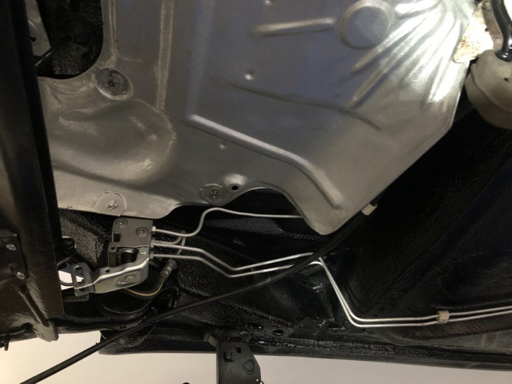

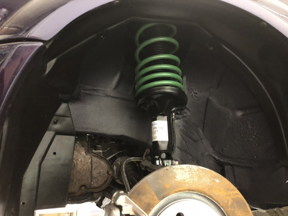

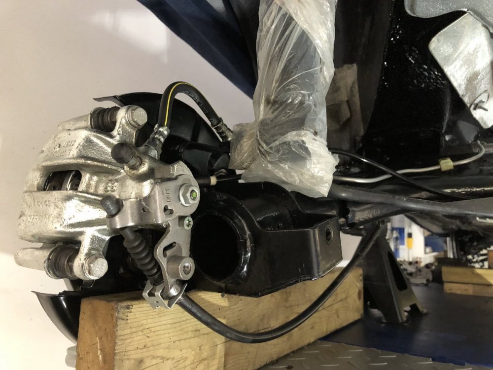

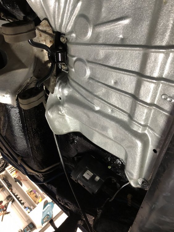

Yes many a weekend! cleaned the original of first which was peeling and generally unsightly and covered everything in site! then used Dinitrol, they recommended a fine spray of there cavity wax first all (along with using it for the cavities) then there black underbody seal via a compressor and spray gun, the arches were stripped back, rust convertor on any small bits rust which were just around the top were the suspension goes through, then zinc primed, stone cheap protection, paint in body colour and clear underseal to finish, think that was by Bilt Hamber
