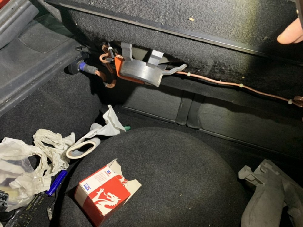

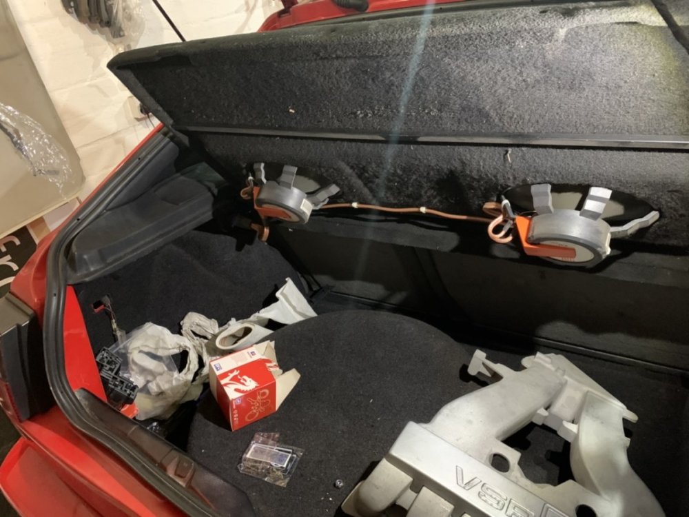

So I'm probably not going to put the oval speakers there and I would like to cover the holes. Has someone done it- put on a new clothing or smth? For the life of me I can't seem to figure out how the metal support things come off so I could rip the cover off.. there's no screws and doesn't seem to be clued on too..ðŸĪ”

So took the courage and ripped a little of the cover off to see with what the support thing is attached. It seems to be a rivet. The cover is clued yes, it comes off quite easy. Have an experience with ceiling upholstery change so maybe it's an easy fix. Have to find a proper cloth and spray clue, cut some plywood into the holes, clue them in and if needed sanding it even.

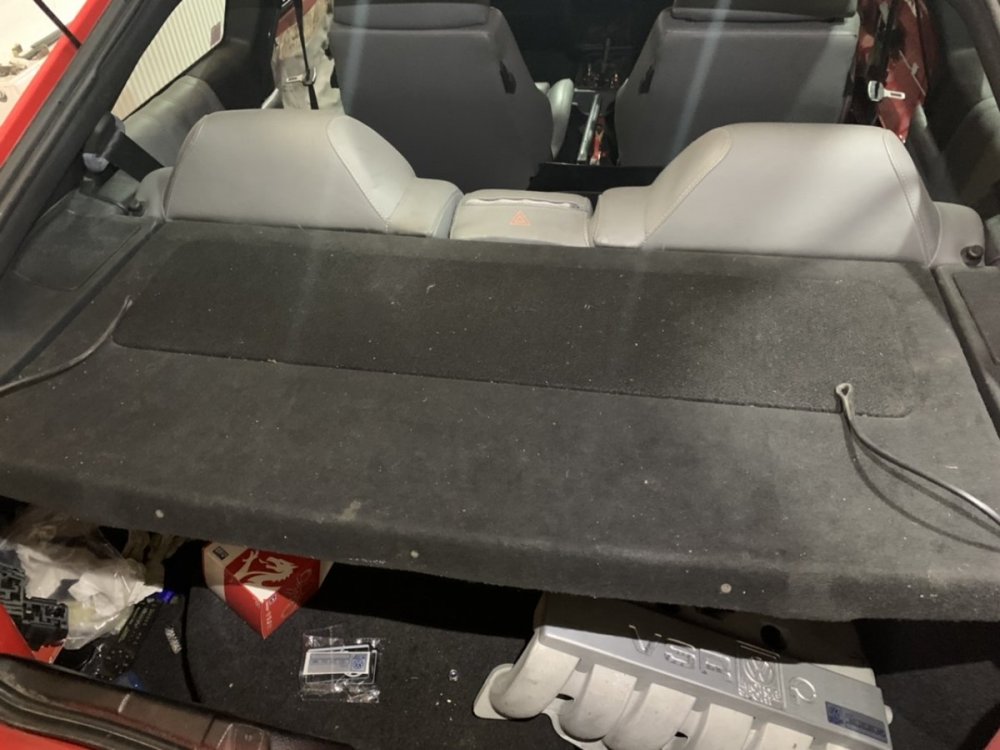

I’ve got a similar shelf in mine, but the top has been made to look sort of factory, hold on and I’ll get a picture or 3. It’s been solved from above, although I do still have speakers in it
Thank you for the idea! I took the job and ripped it apart. Wasn't hard, cover fabric came off quite easily, drilled the rivets off of the support thingy.. 😄  Measured and cut right parts for the holes and glued them in with epoxy clue. ðŸ˜„ Now I need to buy some cover fabric when the shops are opened again.
