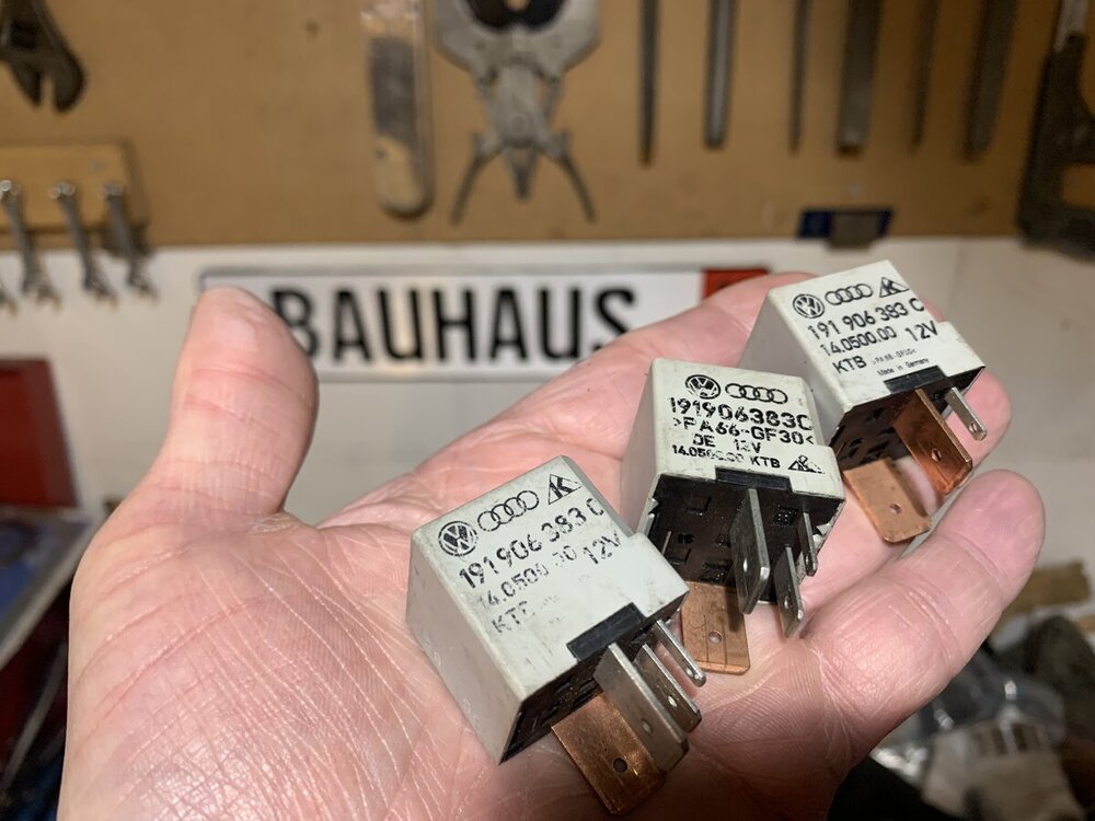

Bauhaus 3 Posted December 6, 2021 Not sure what that relay is that your using, The best fuel pump relay to use is 191 906 383 C Pin3 on connecter G1 behind the fuse box is the trigger signal wire from the ECU which goes to pin85 on the fuel pump relay, pin86 on the same relay goes to a switched live (when key is turned) I’ve seen you been messing about with your fuel pump so unplug it first then check all fuel pump relay connections. 1 Quote Share this post Link to post Share on other sites

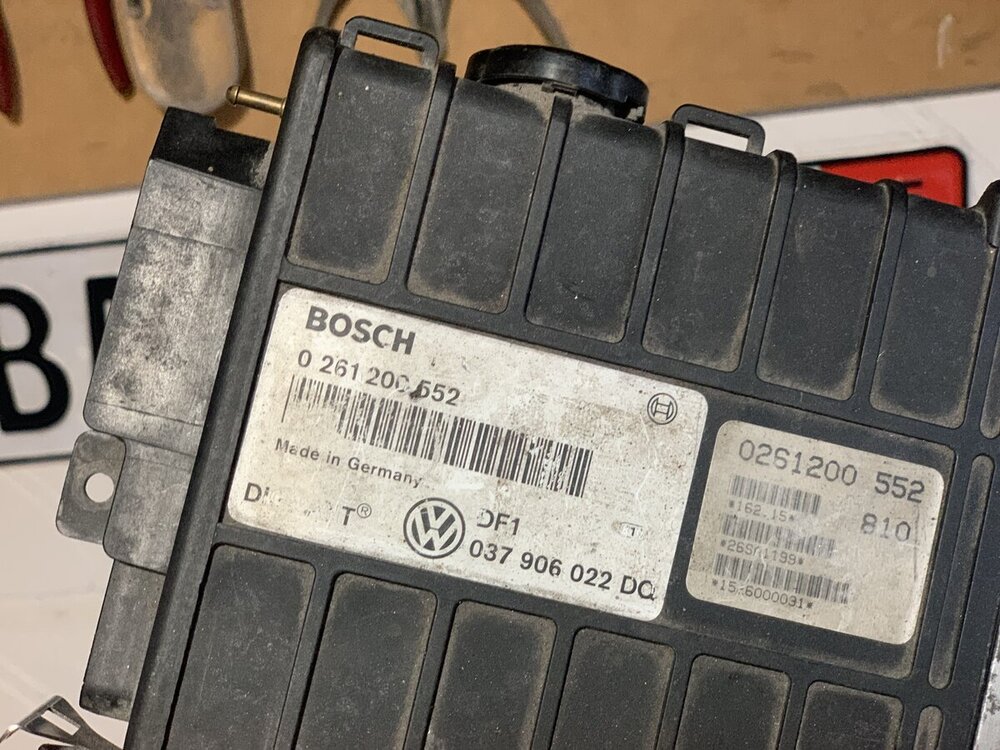

KarlosG60 2 Posted December 9, 2021 (edited) Thanks, I will check both. Now I am start to looking for a used ECU. I don't know if mine is bad, but... My ECU number is 037 906 022 DP, will any other reference, like 037 906 022 CP, works or it needs recalibration? Edited December 9, 2021 by KarlosG60 Quote Share this post Link to post Share on other sites
Bauhaus 3 Posted December 9, 2021 It will work, I’ve never had a problem with this and have used a few ecu’s with different part numbers, the different part numbers relate to the slightly different fuel and ignition maps depending on what fuel is available in the country at the time when the car was originally exported to as well as various internal circuit revisions. Quote Share this post Link to post Share on other sites
KarlosG60 2 Posted December 9, 2021 Thank you. Purchase used ECU it's an option if repair mine it's too expensive. Will check few more things to find my problem and I will decide what to do (burn it all, I supose). Quote Share this post Link to post Share on other sites
KarlosG60 2 Posted December 11, 2021 (edited) Hi, I just purchased an used ECU + Complete CE2 wiring. Next week will arrive and I will check. It's reference is 037 906 022 CP BTW, I did few more checkings today. Let's lists them: 11/12/2021 • Check Hall Sender Unit, Voltage supply. (Bentley 28.9) ✅ • Check Hall Sender function. (Bentley 28.10) ✅ • Check connectivity from M/02 (R/Y) to R/Y from fuel pump connector ✅ • RPM needle moves when crancking? NO. But the checkings to the Hall sensor was good. I said previously the needle moves, but it don't. I don't think this is a good checking, but... • Check if ECU got voltage directly from battery. ECU pin 14 to positive ( + ). Pin 13 to ground ( - ). Pin 3 to LED Tester and LED tester to positive ( + ). LED light should be shrink. If not, ECU is not receiving voltage. ❌ Edited December 11, 2021 by KarlosG60 Quote Share this post Link to post Share on other sites

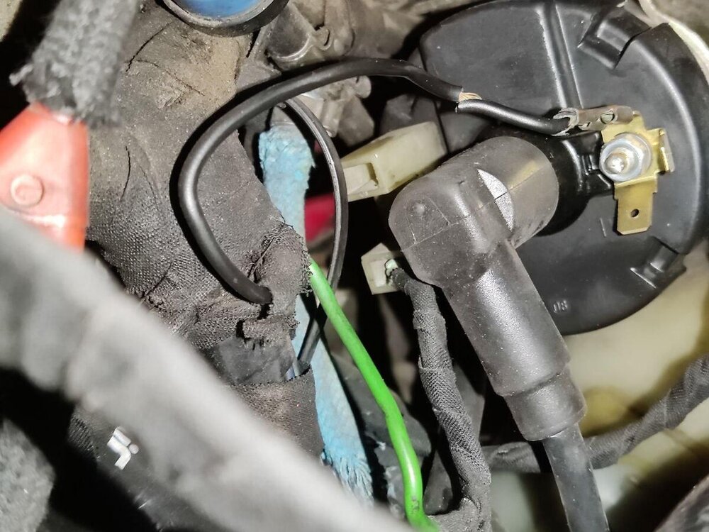

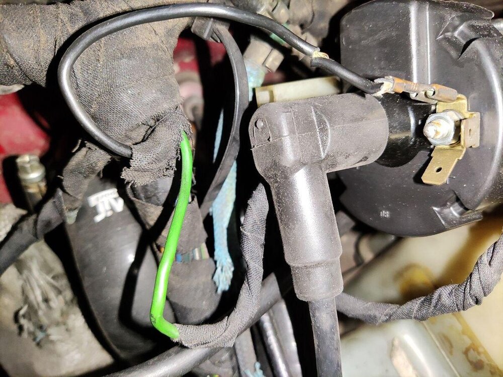

KarlosG60 2 Posted December 11, 2021 (edited) Checking wires in engine bay, I saw the ignition coil maybe missing some wires: Ignition coil, spark plugs and spark plug wires are new (well, they got a lot of years -10 maybe-, but less than 1000 kms 😅) Edited December 11, 2021 by KarlosG60 Quote Share this post Link to post Share on other sites

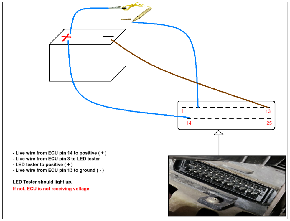

Cressa 46 Posted December 12, 2021 On 12/11/2021 at 5:06 PM, KarlosG60 said: Hi, I just purchased an used ECU + Complete CE2 wiring. Next week will arrive and I will check. It's reference is 037 906 022 CP BTW, I did few more checkings today. Let's lists them: 11/12/2021 • Check Hall Sender Unit, Voltage supply. (Bentley 28.9) ✅ • Check Hall Sender function. (Bentley 28.10) ✅ • Check connectivity from M/02 (R/Y) to R/Y from fuel pump connector ✅ • RPM needle moves when crancking? NO. But the checkings to the Hall sensor was good. I said previously the needle moves, but it don't. I don't think this is a good checking, but... • Check if ECU got voltage directly from battery. ECU pin 14 to positive ( + ). Pin 13 to ground ( - ). Pin 3 to LED Tester and LED tester to positive ( + ). LED light should be shrink. If not, ECU is not receiving voltage. ❌ Do you get 12v if you go from pin 14 + and then straight to the battery negative. If this should be a permanent voltage and isn't, check your fuses Quote Share this post Link to post Share on other sites
Cressa 46 Posted December 12, 2021 And when I say check your fuses, pull each one out and use a multimeter set to ohms and check that the resistance across each one is very low Quote Share this post Link to post Share on other sites
KarlosG60 2 Posted December 12, 2021 On 12/12/2021 at 11:25 AM, Cressa said: Do you get 12v if you go from pin 14 + and then straight to the battery negative. If this should be a permanent voltage and isn't, check your fuses I will check that, thanks. On 12/12/2021 at 11:31 AM, Cressa said: And when I say check your fuses, pull each one out and use a multimeter set to ohms and check that the resistance across each one is very low The engine starts fine without any trouble when I bypass the fuel pump. I don't think there will be any bad fuse, but I will check that too, who knows. Thanks Quote Share this post Link to post Share on other sites
