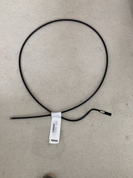

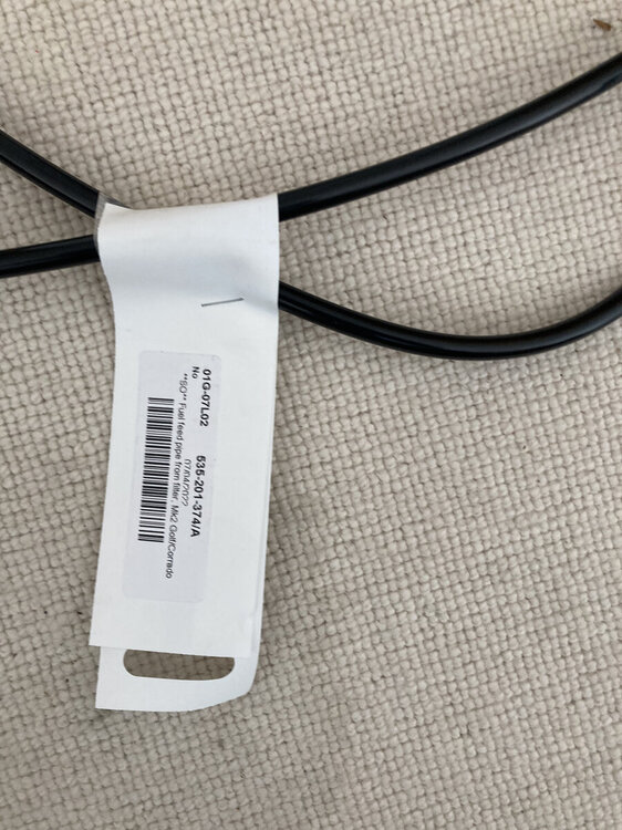

Keyo 49 Posted May 3, 2022 (edited) Anyone know the best way to change the black feedline that goes through this tunnel- would it be best to tie it to the old one coming out- is it a hell of a job best done on a ramp, ? Thanks I have this to fit from filter to engine bay. Picture of hose which is the same for a late g60 or vr - its about the only hose you can buy now so not doing the soft hose hack- if you can buy new you by new. I believe Sean has done this job ? Edited May 3, 2022 by Keyo Quote Share this post Link to post Share on other sites
seanl82 23 Posted May 3, 2022 (edited) It's not bad threading it through. I pushed the heat sleeve in the bay down a bit and did everything else from the filter end. I taped a bit of string to the old one and pulled it out, then attached it to the new one and pulled it back through, but I didn't encounter much resistance to be honest. Probably better safe than sorry though! Edited May 3, 2022 by seanl82 Quote Share this post Link to post Share on other sites
Keyo 49 Posted May 3, 2022 On 5/3/2022 at 6:05 PM, seanl82 said: It's not bad threading it through. I pushed the heat sleeve in the bay down a bit and did everything else from the filter end. I taped a bit of string to the old one and pulled it out, then attached it to the new one and pulled it back through, but I didn't encounter much resistance to be honest. Probably better safe than sorry though! Lol i will give it a go this weekend need to do the vr and g60 - hope I dont shag it up if it gets stuck will be in all sorts of trouble ha. Thanks Quote Share this post Link to post Share on other sites
