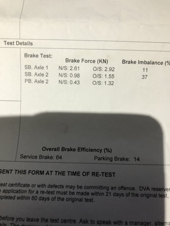

ger040 4 Posted July 24, 2021 my car has had an ongoing issue since i put it back on the road its initial mot it just about passed - just The second mot it failed on rear brakes - i could not see anything wrong - but i changed the rear calipers and again fully bled the system using a pumped pressure bleeder - i actually went through twice the amount of fluid it should have taken i applied for mot again and the fault was still there but the inspector let it pass as he could see new discs, calipers and brake bias valve and said it must have a bit of air in the system, (he said on my car the front brakes do all the work anyway) As we know there were no mots last year Its coming around to new mot time again so its going to be an issue again To me the brakes feel good all discs are all nice and shiny and pedal good To me the only thing left is the brake master cylinder - its still the original i have attached images its last mot fail sheet Quote Share this post Link to post Share on other sites
Dox 31 Posted July 24, 2021 Handbrake is not affected by the master cylinder and you have low effort on foot and hand braking. brakes are diagonally split from the M/C, front right and rear left off one M/C circuit, front left rear right on the other. Again suggesting M/C is operating as it should. what make we’re the rear disks and pads? Do the handbrake levers on the callipers return to there stops? Quote Share this post Link to post Share on other sites

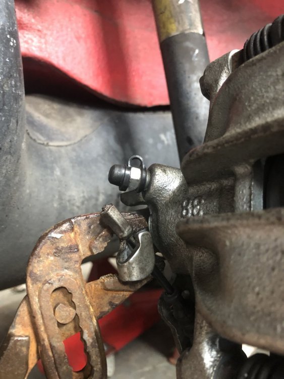

ger040 4 Posted August 7, 2021 I have had a look at this again to day - completely stripped the rear calipers, carriers discs etc and reassembled same and the problem is still there adjusted the calipers so there was a bit of resistance of the brake pads on the discs rotating by hand as soon as i apply the hand brake the drivers side has more play hence the difference. using a spanner and pulling down on the handbrake lever on the calipers the passenger side moves about 5mm before pads engage - the drivers side has to be double this i have bled and bled these brakes using a pressure bleeder Quote Share this post Link to post Share on other sites
dragon green 6 Posted August 7, 2021 The handbrake mechanism has nothing to do with the hydraulic system !Try adjusting the “loose” handbrake cable at the handbrake end to make the movement equal Quote Share this post Link to post Share on other sites
ger040 4 Posted August 7, 2021 22 minutes ago, dragon green said: The handbrake mechanism has nothing to do with the hydraulic system ! Try adjusting the “loose” handbrake cable at the handbrake end to make the movement equal Thanks for the reply Dragon Green Maybe i am being stupid here but with the handbrake not being equal (not pulling up square on both sides) surely this in turn puts the foot brake operation out too. i.e one side will be better than the other Jesus my mk2 16v was simple compared to this Quote Share this post Link to post Share on other sites
1xshaunx1 27 Posted August 7, 2021 The handbrake works mechanically via the leavers and such, if you’ve checked by hand on the levers and they operate differently the fault with the handbrake is in the callipers. This is why I needed new/ refurbed callipers and went for new Mk 4, a link in my thread. The drivers one did next to nothing as much as I try. With the new ones all was well I also put new cables on while I was at it. Quote Share this post Link to post Share on other sites
