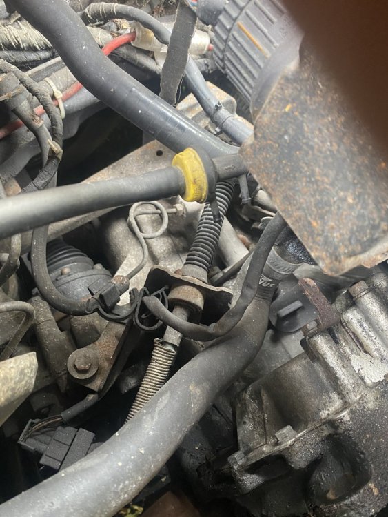

Rpmayne 0 Posted July 24, 2021 Hi, any idea what this is? Idle is rough especially cold, found the yellow bit in the middle of the picture sucking in air. If I block the holes up it improves the idle. Can’t see any other pipes disconnected. The open ends look clean as if something has fallen off. Cheers. Quote Share this post Link to post Share on other sites
Dox 31 Posted July 24, 2021 It’s the non return valve for the brake servo. If leaking it will affect fuel mixture and running / idling as well as servo brake performance Quote Share this post Link to post Share on other sites
Cressa 46 Posted July 24, 2021 Definitely needs both ports blanking off. Its vacuum. Normally has a small plastic cap on each one Quote Share this post Link to post Share on other sites
Rpmayne 0 Posted July 24, 2021 Thanks for that, I’ll blank them off. Had it down the garage to bleed the brakes, may be they were left off. Cheers. Quote Share this post Link to post Share on other sites
Dox 31 Posted July 24, 2021 There’s no need to touch that vac pipe to bleed the brakes, that’s dry, takes vacuum from the running engine with the throttle closed to the servo. When the throttle opens the non return valve closes to maintain vacuum in the servo to assist brake pedal pressure, reducing effort on your leg / foot Quote Share this post Link to post Share on other sites
Rpmayne 0 Posted July 24, 2021 Ok may be they both just fell off then, blanked them both off a now it idles, happy days. Cheers. Quote Share this post Link to post Share on other sites
Cressa 46 Posted July 24, 2021 1 hour ago, Rpmayne said: Ok may be they both just fell off then, blanked them both off a now it idles, happy days. Cheers. An easy fix is always nice 😊 Quote Share this post Link to post Share on other sites
