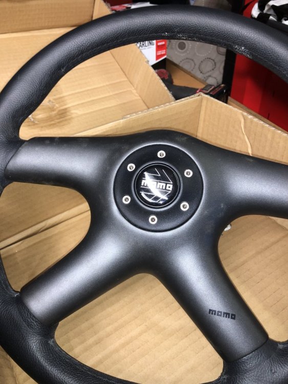

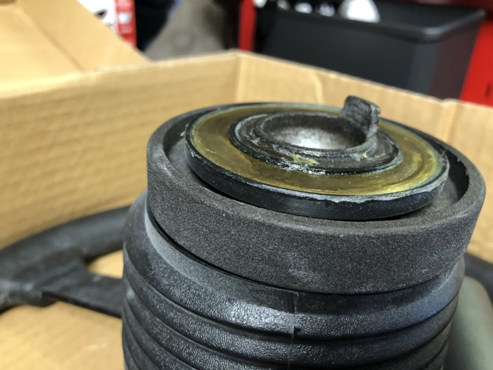

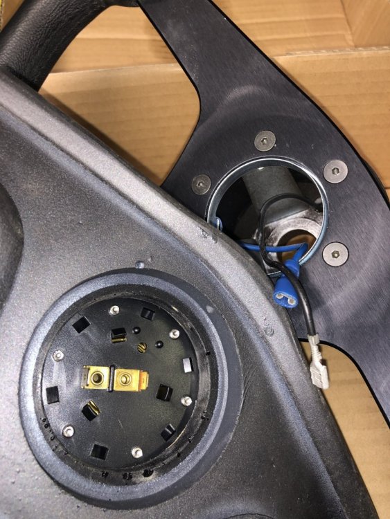

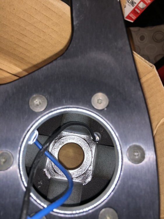

Your boss looks the same as my momo  one.  The black wire with the female came with the boss and I made the blue wire to plug into the connections on my horn and boss metal disc as you have. As you can see the steering wheel it is for is also a momo. If you only have one terminal/wire coming out of each horn button they must be earthed through the horn buttons already to the steering wheel and you just need to plug those wires into your female black wire to give it it’s positive feed.
test it with a battery and a couple of wires the wires coming from the steering wheel to positive through a test bulb/light and a negative wiring touching the steering wheel itself. Push the button and the test light should light up. My brass disk is also pushed in similar to yoursC0995494-70AD-402D-9795-91F81D627690.thumb.jpeg.7a6cadb95e16644ef71c25d2bb8655d0.jpegBB74E635-EC6A-491E-9034-BD220845B880.thumb.jpeg.0295155646a9e6e50c45621512c413e9.jpeg09D0712A-28D6-4792-B9D6-E20348301F71.thumb.jpeg.326c8c0f62dc5c5d68841effc9abfaf6.jpeg642A4F96-FC70-46BD-A004-B597AFEF429E.thumb.jpeg.1d844c1713fef22ac555dc6c10e7410e.jpeg

Thanks so much mate for all that explanation and pictures, super appreciated! It seems like all newer horns have both wires just like yours and mine being an old Italvolanti Corsa has just the one. I won't install the silver ring and plug the black wire from the boss directly to the horns one. And yes, you must be right, it's got to be self grounded. Thank you for showing me the brass disc, now I'm sure that it was the right thing to do by forcing it down to be flush.
