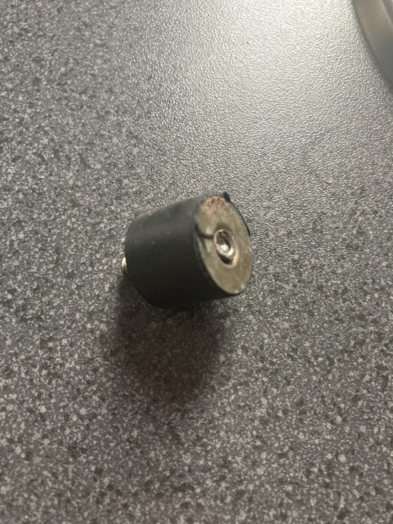

The regulator is riveted in place and the instructions for removal are in the Robert Bentley manual. The motor itself has 3 rubber mounts which screw onto the motor on one end, but are riveted to the door frame on the other end. I think it’s a case of drilling out the rivets and then installing new rivets, but I may be wrong. It’s worth double checking that this is correct just in case you have to order the rubber mounts separately.
Edited by Corroda
I’ve just looked at the part drawing and it looks like the new regulator is supplied with the rubber mounts.
Don't necessarily trust the drawing - the rubber mount (2A in the drawing I think) might be available separately if it is listed with it's own part#. I wasn't aware that RHD window mechs were available again, last I heard they were long NLA, and only the passenger side was available at around €200.
I tried drilling out one of the rivets last night, and it just slipped inside the rubber mount. I will persevere with trying to remove it, but even if I can’t get it out there is plenty of clearance to leave it in place and fit a new rivet. So I wouldn’t worry if the rubber mounts don’t come with the new regulator as you should be able to reuse the old ones.

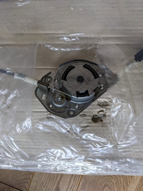

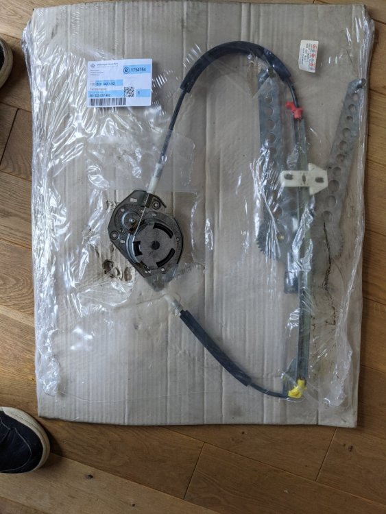

So it arrived today via UPS - box pretty damaged but part seems fine...

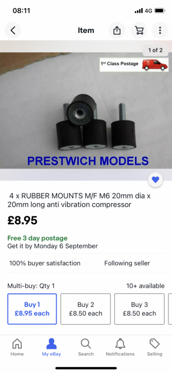

And per fendervg, *no* rubber mounts - so will be using shaun's link to order some new ones to mount it, once and for all, I hope!
certainly doesn't look like the electric one, unless there's a housing and some fitment bracket for the motor..
