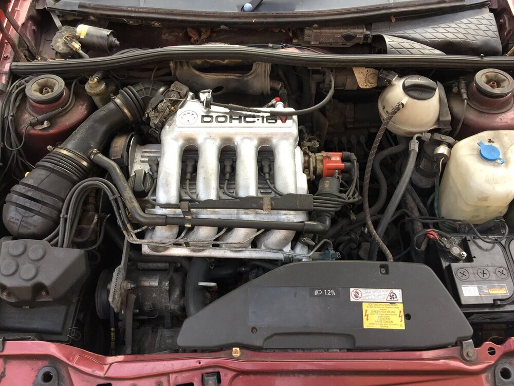

FrankyEight 10 Posted March 23, 2022 Hi guys Looking to sell my 2.0 16v Corrado due to losing patience trying to find the reason as to why it won't start. I'm not mechanically minded so am hoping it can go to someone that is, an enthusiast, who can get it running again. I've owned the car since April 2016 and, up until it's current issue, has been fantastic to own and run. It has been my only car in this period, used daily for a couple of years and, more recently, used only weekly as I work permanently from home. Also taken multiple trips in it away to Portsmouth, Brighton, Wales etc. A joy to drive. RUNNING PROBLEM Fuel is not getting from the metering head unit to the injectors. After changing the pump and realising then it wasn't the problem, I decided to pick up and fit a second-hand metering unit replacement, this has had no effect. I then decided to replace the ECU, again found second-hand, still no luck. The engine will run on easy-start fine, if fuel is fed in to the engine, it runs as normal but, for whatever reason, fuel is not getting in otherwise. CAR DETAILS VW Corrado 2.0 16v (9A) 1995 M reg 123,000 miles MOT November '22 FSH Sherry Pearl STUFF THAT WORKS Both fog lamps Sunroof (most of the time) Electric spoiler (at speed and via dash switch) Electric mirrors Electric windows STUFF THAT DOESN'T See 'running problem' above Heater only works on two settings (2 & 4) Handbrake works fine but could do with having two new bolts installed, as one sheared off a year or so ago and I've done a temporary job so that it works. The car is situated in Woking, Surrey and is at the garage there where it's been since January. Until I get down there to take new pics I've attached some here that are a couple of years old but serves the purpose of showcasing it. Thanks for reading, willing to listen to offers. Quote Share this post Link to post Share on other sites

_Matt_ 28 Posted April 2, 2022 Its likely to be blocked fuel injectors but most general garages don't understand the cars. If you have fuel to the metering head it's not going to anything further back in the system. Ideally fuel system needs pressure testing but I would ask for the injectors to be changed- 80 quid for 4. Sent from my SM-G960F using Tapatalk Quote Share this post Link to post Share on other sites
FrankyEight 10 Posted April 2, 2022 16 minutes ago, MJA said: Its likely to be blocked fuel injectors but most general garages don't understand the cars. If you have fuel to the metering head it's not going to anything further back in the system. Ideally fuel system needs pressure testing but I would ask for the injectors to be changed- 80 quid for 4. Sent from my SM-G960F using Tapatalk Thanks for this, do you know the best place to buy the injectors? A quick look on VW Heritage I see some for £88 each. Thanks again. Quote Share this post Link to post Share on other sites
_Matt_ 28 Posted April 2, 2022 Hi, the part no for your injectors in the 9a 2.0 16v is 035133551F. A set of 4 has gone up to £150 since I last looked: https://www.ebay.co.uk/itm/AUDI-FOR-VW-4X-BOSCH-FUEL-INJECTOR-0437502043-/373946944932?mkcid=16&mkevt=1&_trksid=p2349624.m46890.l49286&mkrid=710-127635-2958-0 Not many people realise but when testing the kjet in these cars you have to lift the flap/disc ontop of the airbox, under the intake boot to simulate vacuum pressure to allow fuel to flow from the metering head (also above airbox). If this isn't done it looks like fuel isn't making it to the injectors. Also E10 fuel is very bad for these cars if you leave them sitting. I had a 9a I put e10 in, left it a few months and had similar problems to you. There were little crystal like deposits on the injectors which blocked 3 of them. An alternative rather than buying new injectors would be to get them cleaned and flow tested but I would guess the labour is about the same as buying new. Assuming the garage you're using may not know the way kjet operates it might be worth you requesting they flow test each injector - it is possible to do this on car with each injector put into little jars. The disc in the metering head (under air intake boot on top of airbox) must be lifted by hand. This is what happens when the car runs under vacuum - the disc/flap lifts slightly to allow fuel to flow from metering headto injectors. This is also why vac leaks on kjet cars can cause you havoc. It is worth finding a garage that specialises in kjet to save you grief. The general garage on the street just doesn't have the knowledge to deal with it. Kjet is simple and relatively cheap to fix but if you're a mechanic from the "computer says replace sensor era" you will struggle and feel like your car has a major issue when it does not. Sent from my SM-G960F using Tapatalk Quote Share this post Link to post Share on other sites

FrankyEight 10 Posted April 22, 2022 Hello all, just to draw this feed to a conclusion... the Corrado is now fixed and therefore no longer for sale at £2,000. I may still be selling the car in due course, however I can't easily see how to delete or edit my post here. Thanks for all your comments and interest. Quote Share this post Link to post Share on other sites
seanl82 23 Posted April 22, 2022 9 minutes ago, FrankyEight said: Hello all, just to draw this feed to a conclusion... the Corrado is now fixed and therefore no longer for sale at £2,000. I may still be selling the car in due course, however I can't easily see how to delete or edit my post here. Thanks for all your comments and interest. Glad to hear it. What was the issue in the end? Quote Share this post Link to post Share on other sites
FrankyEight 10 Posted April 22, 2022 2 minutes ago, seanl82 said: Glad to hear it. What was the issue in the end? Metering head. The first replacement I'd sourced must have also been bad. Another one appeared on eBay in Lithuania... and did the trick! Quote Share this post Link to post Share on other sites
