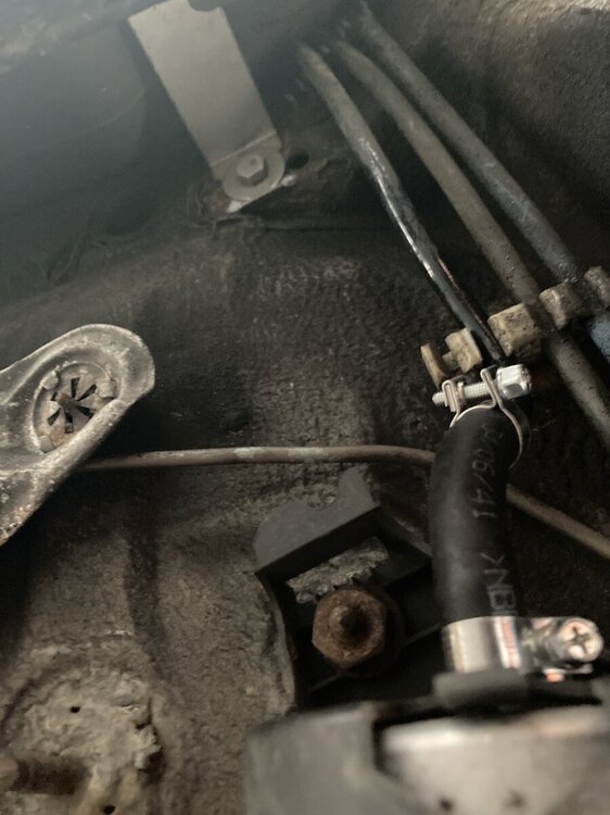

KarlosG60 2 Posted May 1, 2022 Hi, I'm working on fuel hoses replacement. Those ones: I have the replacement (need to cut to 150mm and 160mm): But I don't know how to remove this and after how to mount again: Could you please help me? Is necessary to broke those climps? And how about mount the new ones? I though today was going to be a profitable day but, no, as always. Thanks Quote Share this post Link to post Share on other sites
_Matt_ 33 Posted May 1, 2022 Hi, lots or people doing this job, inc me and am about to approach it this afternoon. Good preventative maintenance.To remove those clips you cut down from front to back with a dremmel or some metal pliers.@Keyo on here has done it a few times on car in recent weeks and will be able to give some tips Sent from my SM-G960F using Tapatalk Quote Share this post Link to post Share on other sites

Keyo 49 Posted May 1, 2022 (edited) You have to slice off the metal mushrooms without cutting the pipe under mushroom ( go vertically from underneath ). If they are nice and rusty its easy just fall off- if they are solid its a pain - start working a metal flathead in between the mushroom and pipe- use some pliers squash the mushroom a little - you just got to weaken it and it will eventually drop off the hose. where the 2 pipes meet they are joined by a copper sleeve- you must not damage or collapse this. Do not over tighten clamps- fuel clamps are only torqued very low any way. use a screw driver to tighten not a ratchet, Edited May 1, 2022 by Keyo Quote Share this post Link to post Share on other sites

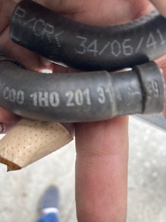

Keyo 49 Posted May 1, 2022 7 minutes ago, KarlosG60 said: Ok, next week I will work again on that. But if you are saying that could be very hard to cut and it's relatively easy to broke interior hose, I'm thinking about to find another solution that not involves cutting the clip/collar metal. Something like that: Do you think it can obstruct the fuel flow or make the pressure go high? Yes, of course. It's from Heritage Reading Personally I would not use that topran hose - this is the proper stuff for fuel hose external off a bonified seller. . https://www.ebay.co.uk/itm/382558389619 Quote Share this post Link to post Share on other sites
KarlosG60 2 Posted May 2, 2022 14 hours ago, Keyo said: Personally I would not use that topran hose - this is the proper stuff for fuel hose external off a bonified seller. . https://www.ebay.co.uk/itm/382558389619 Ok, thank you. I will look around here for a local store where can I buy 1 meter like this (one of the link is too expensive shipping to Spain). Quote Share this post Link to post Share on other sites
Keyo 49 Posted May 2, 2022 (edited) 1 hour ago, KarlosG60 said: Ok, thank you. I will look around here for a local store where can I buy 1 meter like this (one of the link is too expensive shipping to Spain). It’s the brand you want to find codan SAE J 30 R9 1A on hose which is fuel tested compliant . Fuel line inside tank which sits in fuel is R10 from memory . Edited May 2, 2022 by Keyo Quote Share this post Link to post Share on other sites

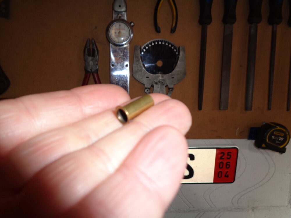

Bauhaus 3 Posted May 2, 2022 What I normally do is cut off the original metal crimp and remove old rubber hose, then slip a brass fuel ferrule inside the rigid nylon hose which will prevent it crushing when you place your new rubber hose over the rigid hose then crimped with a stainless crimp or similar, this way ensures maximum fuel flow through the joint. 1 Quote Share this post Link to post Share on other sites
KarlosG60 2 Posted May 2, 2022 (edited) Nice @Bauhaus Is just the solution I've been thinking today. Edited May 2, 2022 by KarlosG60 Quote Share this post Link to post Share on other sites

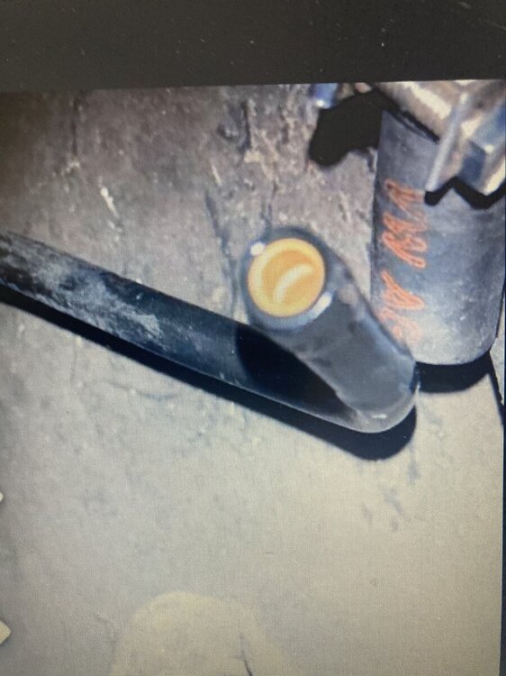

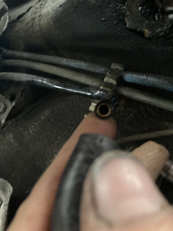

Keyo 49 Posted May 2, 2022 (edited) 29 minutes ago, Bauhaus said: What I normally do is cut off the original metal crimp and remove old rubber hose, then slip a brass fuel ferrule inside the rigid nylon hose which will prevent it crushing when you place your new rubber hose over the rigid hose then crimped with a stainless crimp or similar, this way ensures maximum fuel flow through the joint. These copper sleeves are all ready inside the hard line hose so no need to put one in- just pop the new hose over it. Just need to slice the mushroom off and soft hose pulls off . if you slice the mushroom off this is what you will see . Just need to get between mushroom and pipe start from bottom and go vertical . Edited May 2, 2022 by Keyo Quote Share this post Link to post Share on other sites

Bauhaus 3 Posted May 2, 2022 3 hours ago, Keyo said: These copper sleeves are all ready inside the hard line hose so no need to put one in- just pop the new hose over it. Just need to slice the mushroom off and soft hose pulls off . if you slice the mushroom off this is what you will see . Just need to get between mushroom and pipe start from bottom and go vertical . Yes, but I just cut the hard line just past the "Mushroom" with a junior hacksaw and remake the joint, you only lose just over an inch of hard line and saves faffing about cutting the mushroom with a Dremel. As they say there's more than one way to skin a rabbit. Quote Share this post Link to post Share on other sites

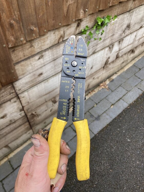

Keyo 49 Posted May 2, 2022 2 hours ago, Bauhaus said: Yes, but I just cut the hard line just past the "Mushroom" with a junior hacksaw and remake the joint, you only lose just over an inch of hard line and saves faffing about cutting the mushroom with a Dremel. As they say there's more than one way to skin a rabbit. I just used some wire cutters sliced off the mushroom - looks a bastard to get a sleeve in that hard line as it looks moulded from factory so Im glad I did it my way. Quote Share this post Link to post Share on other sites

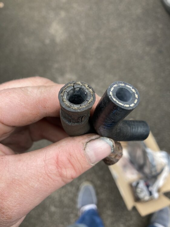

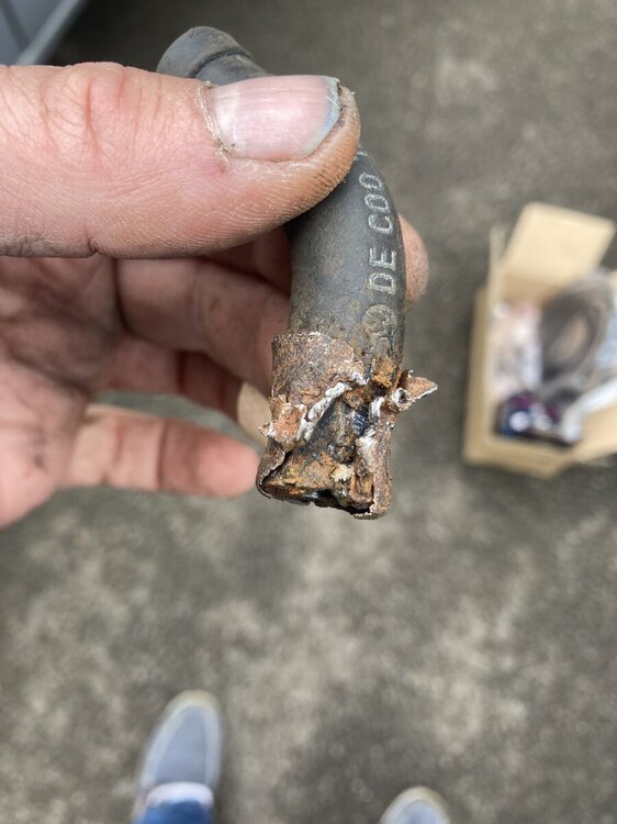

Keyo 49 Posted May 3, 2022 My vr turn today - all the same eroded pipes . Quote Share this post Link to post Share on other sites
_Matt_ 33 Posted May 3, 2022 Did mine yesterday. Thanks Keyo I hadn't realised the brass was inside the hard plastic pipes. I did use the dremmel in my situation as pipes were done on the work bench. Took 5mins max and way easier than I had imagined. Quote Share this post Link to post Share on other sites
