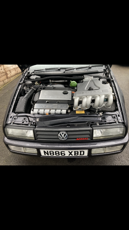

Keyo 49 Posted July 28, 2022 (edited) VSR on the left and shrick on the right - I sold a shrick last year and it fetched 1500 and sold behind closed doors - vsr can expect to pay over double then a schrick but rarely come up for sale . Schrick come up at least a few times a year - vsr probs looking at 1 every few years . Last shrick I saw sell was a breaker found one on a sharan vr6 . As mentioned above fb is your best bet - most important thing is to make sure the butterfly flap screws are secure or they could drop off and chew your engine . Edited July 28, 2022 by Keyo 1 Quote Share this post Link to post Share on other sites
Cressa 45 Posted July 28, 2022 Mate, that VSR is still super gorgeous. I think I paid 1300 for my Schrick 3 years ago which still needed a full refurb and parts on top of that cost. They aren't cheap, but are quite an easy bolt on modification 1 Quote Share this post Link to post Share on other sites
Keyo 49 Posted July 28, 2022 On 7/28/2022 at 7:27 PM, Cressa said: Mate, that VSR is still super gorgeous. I think I paid 1300 for my Schrick 3 years ago which still needed a full refurb and parts on top of that cost. They aren't cheap, but are quite an easy bolt on modification I love them, puts the VR on its toes- what the engineers wanted for the cars. Quote Share this post Link to post Share on other sites

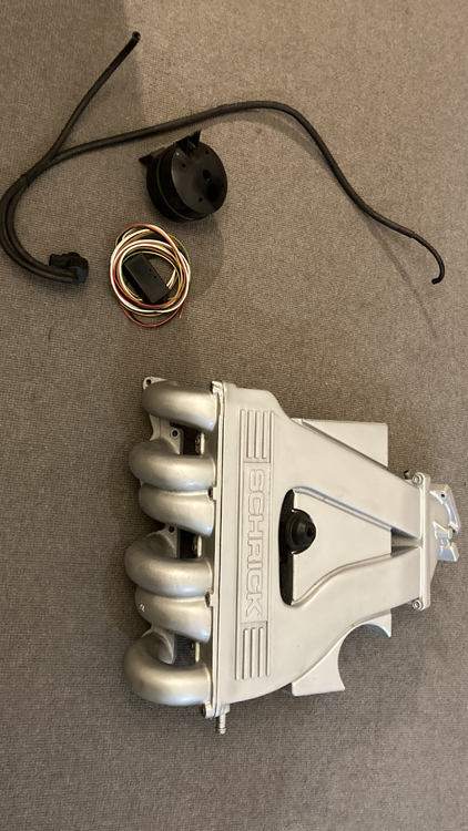

flyingmatt555 0 Posted September 2, 2022 Gents I've managed to find one in Ireland! 👍👍 Quote Share this post Link to post Share on other sites
