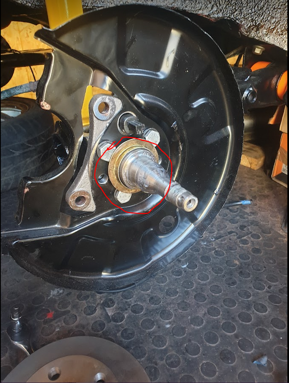

_Matt_ 32 Posted August 26, 2022 Well spotted ;) I wasn't sure as had an awful time with some topran stubs axles where the abs sensor would not clear the abs ring. Swapped out for meyle and found the hole for the abs sensor had been machined in the wrong place. I tired swapping the gold ring around and and loads of other things to conclude the issue.Never buy topran. I knew this but they were on offer so I took a punt.Sent from my SM-G960F using Tapatalk Quote Share this post Link to post Share on other sites

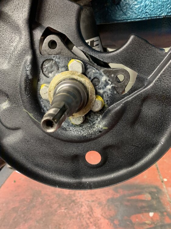

Crasher 3 Posted August 27, 2022 (edited) 15 hours ago, MJA said: Well spotted 😉 I wasn't sure as had an awful time with some topran stubs axles where the abs sensor would not clear the abs ring. Swapped out for meyle and found the hole for the abs sensor had been machined in the wrong place. I tired swapping the gold ring around and and loads of other things to conclude the issue. Never buy topran. I knew this but they were on offer so I took a punt. Sent from my SM-G960F using Tapatalk Febi make a really good copy of that spindle, yes Topran parts can be pretty awful; we fitted a Golf 2 shift lever along with the ball, it melted like candle wax! Edited August 27, 2022 by Crasher Quote Share this post Link to post Share on other sites
