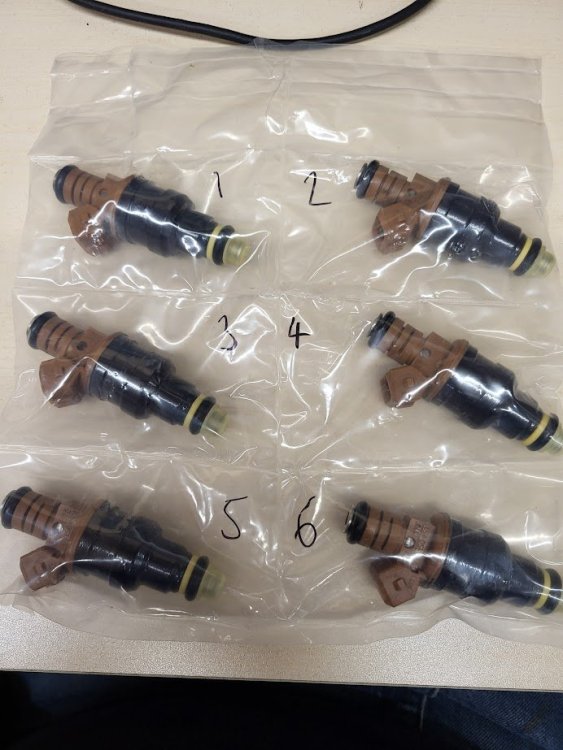

_Matt_ 33 Posted October 27, 2023 Injector report received, yet to pick them up and refit. Looking at the report I don't think they were the problem and they did pass the leak test. Will report back once back in car and tested but at least they have been refreshed for not too much money (£130 all in). FPR next and will probably install when i do the injectors, which is a bit annoying as I wanted to do each step at a time though did the FPR separately on my last one and it did nothing (it was between the injectors and pump on the last one, both done at the same time sadly). Quote Share this post Link to post Share on other sites

_Matt_ 33 Posted November 3, 2023 Got the injectors back, this is how they come back to you for anyone thinking of doing the same. Rainy day tomorrow so hopefully will get some garage time to reinstall: Quote Share this post Link to post Share on other sites
_Matt_ 33 Posted November 12, 2023 Early days but issue is solved on the warm start, now fires up after 5 to 10 mins left after driving as it does from cold. All I have done is had the injectors refurbished. Quote Share this post Link to post Share on other sites

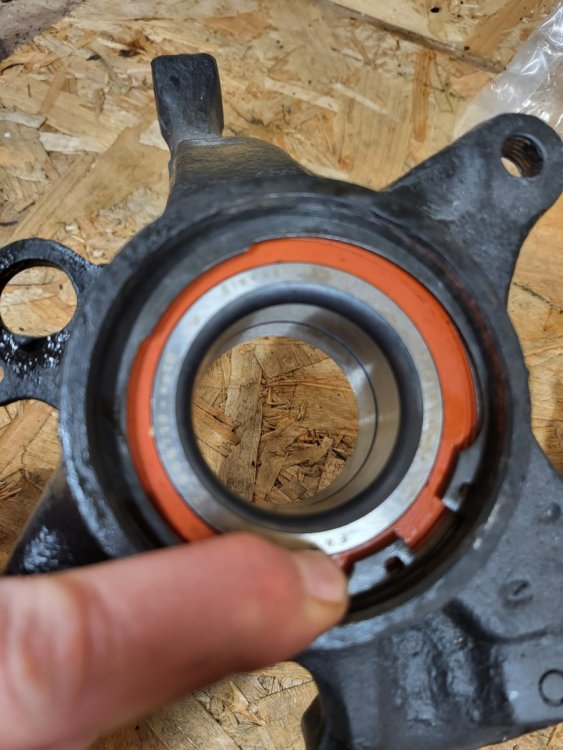

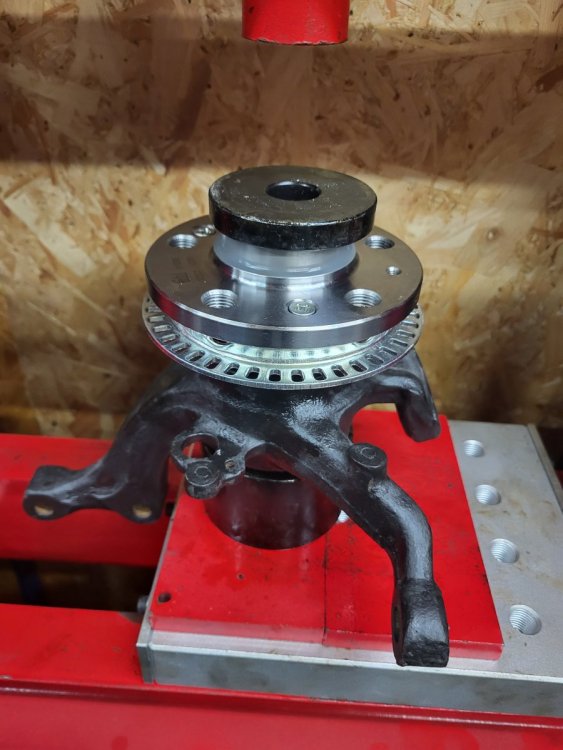

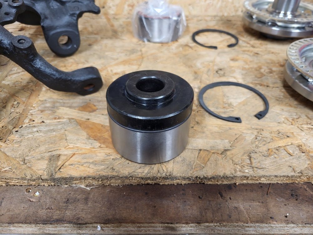

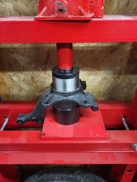

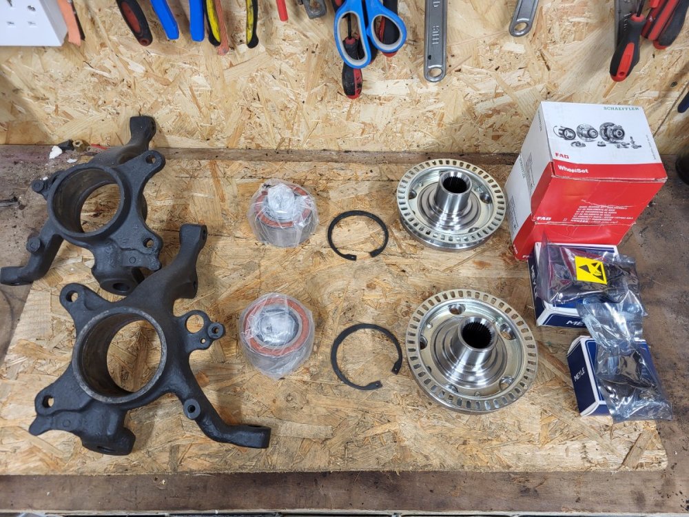

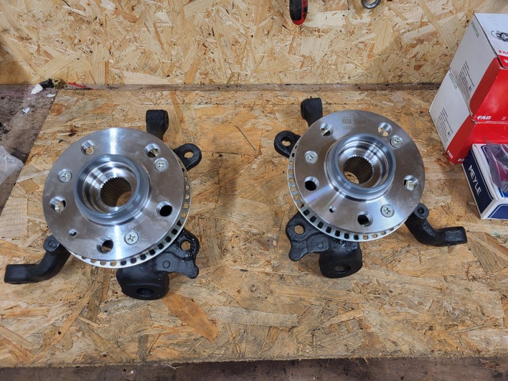

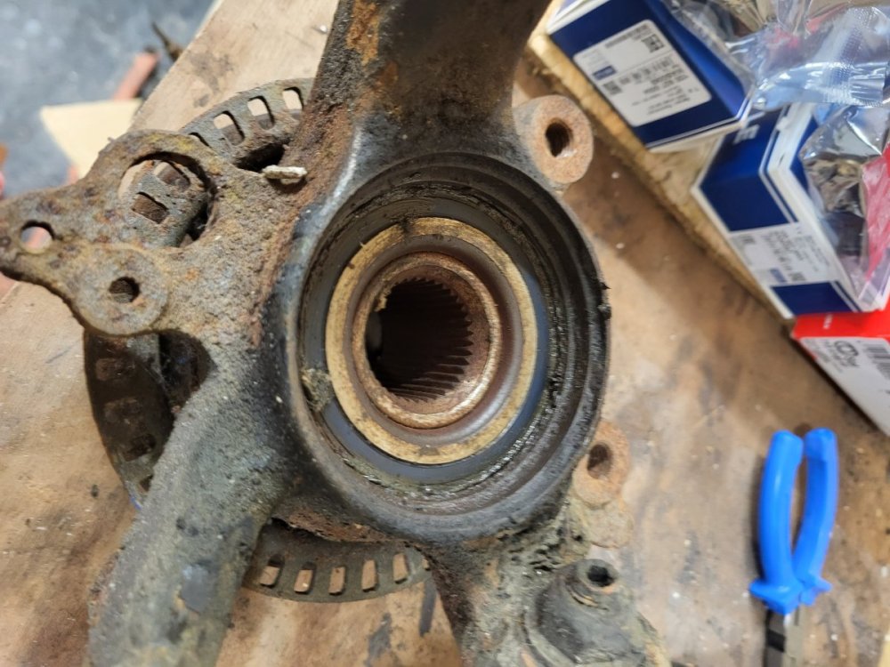

_Matt_ 33 Posted April 9, 2024 Just some updates, I've been working on the rear beam recently and also refurbished the front hubs. These are pics from the ones I did for a friend but I did mine with the same idea except I made sure the bolts for the disc guard were useable on mine, my friend was planning on running big brakes so didn't need the guards. Quote Share this post Link to post Share on other sites

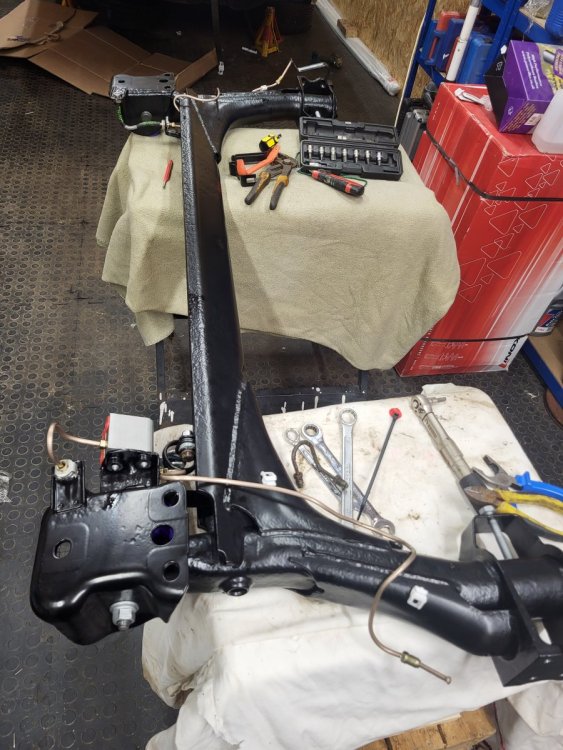

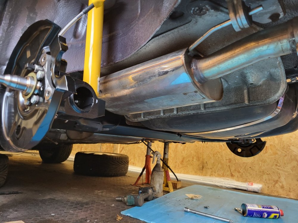

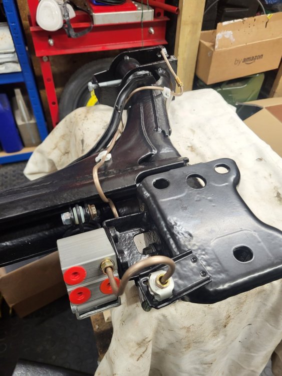

_Matt_ 33 Posted April 9, 2024 Removed the rear beam and had it powdercoated. Fitting new parts and lines, went for Powerflex rear bushes on Vince's recommendation Also Replaced the fuel filter and the rubber lines going to/from it. Perhaps this might help with the "longer crank than expected" on warm restarts, old filter was old. No pics of that bit yet. I kept hold the fuel pump from earlier on in this thread, will strip the pump out of the body and put it in my pump eventually if issue unresolved. I also cleaned the floor plan at the rear end. Nothing concourse, just aimed to the get the grime off and probably could have done a better job if I spent hours at it. Fitted stainless tank straps whilst I was at it. Pics Quote Share this post Link to post Share on other sites
