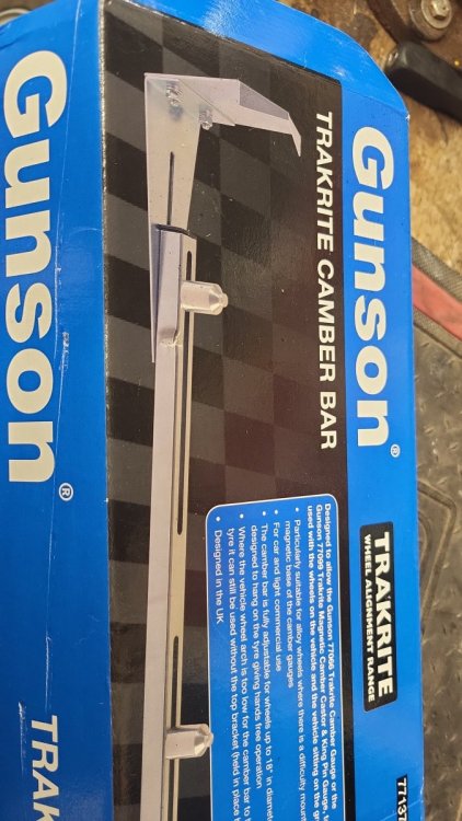

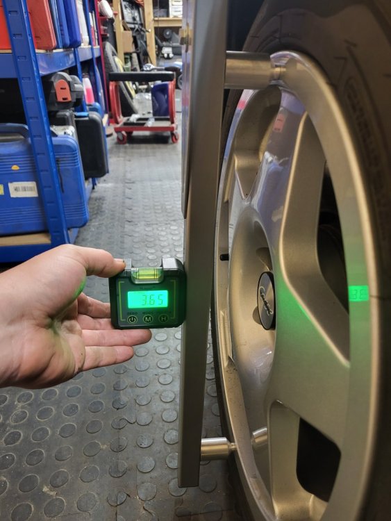

_Matt_ 32 Posted May 11, 2024 Another great piece of kit is one of these camber tools. I have set the fronts to 1.2 degrees so should get away with a tracking job at the mot garage to straighten the wheel. Way off in the picture. I picked it up second hand for £40, already had the spirit level. I have bought some kit to do a string alignment but can't be bothered this time around. Quote Share this post Link to post Share on other sites
