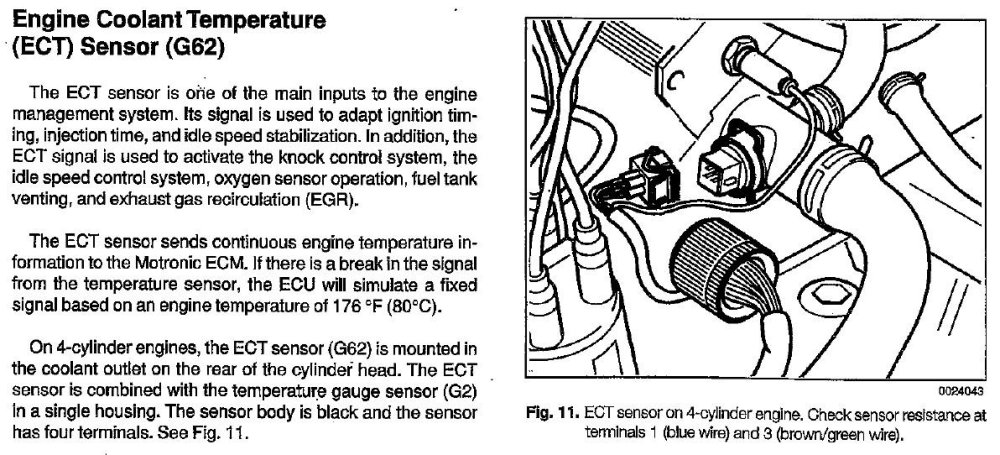

corrado wannabe 13 Posted February 1, 2025 Apologies again for.cluttering up this thread, but I can't seem to post a new topic in engine. I'm looking for a sense check from someone as it's been driving me mad. Blue temp sensor. Firstly, am I correct in saying that my 2.0 16v 9a engine has a k-motronic fuel injection system.? Secondly, is the blue temp sensor located on the rear of the cylinder head and will require the inlet manifold to be removed to replace it? Thirdly, can anyone confirm that it is the blue temp sensor that sends the signal to the ecu for adjusting the mixture, and not the temp sensor on the side of the block (which on my car appears to be a white two pin connector with brown and white and lilac and white wires) Any help would be appreciated. Dougie Quote Share this post Link to post Share on other sites
Cressa 46 Posted February 1, 2025 Apologies that I can't really help with having the 16v, but. Have you looked in the WIKI at cooling, as i recall that mentions the sensors. I think the best investment with any corrado is the Bentley manual. Some people have a pdf version floating around 1 Quote Share this post Link to post Share on other sites
Cressa 46 Posted February 1, 2025 On 1/29/2025 at 4:59 PM, Geeba said: Yeah it is a ball ache! - I was thinking of joining up, but if the sites been put out to pasture I'm not so sure.... tis a shame. True, gut it isn't much money and we get to see nice updates on your car 👌 Quote Share this post Link to post Share on other sites
Philly-R6 2 Posted February 1, 2025 This is what Cressa is referring to: The definitive VR6 cooling guide - Engine Bay - The Corrado Forum. Most of it carries over to the 4-pot cars (radiator switch, fan controller and sensors) - just ignore the auxiliary electric pump. The blue sensor tells the ECU the temperature. If you can get to it, disconnect the housing and measure the resistance of the sensor with a meter. Cold values are larger resistances (250 Ohms) and warmer values approach zero Ohms. (If I remember it correctly!) Or if you have VCDS or such like - see what temperature the ECU believes it is. Looking further the 16v seems to have both sensors in one 4-pin sensor.. 1 Quote Share this post Link to post Share on other sites
corrado wannabe 13 Posted February 1, 2025 3 hours ago, Philly-R6 said: This is what Cressa is referring to: The definitive VR6 cooling guide - Engine Bay - The Corrado Forum. Most of it carries over to the 4-pot cars (radiator switch, fan controller and sensors) - just ignore the auxiliary electric pump. The blue sensor tells the ECU the temperature. If you can get to it, disconnect the housing and measure the resistance of the sensor with a meter. Cold values are larger resistances (250 Ohms) and warmer values approach zero Ohms. (If I remember it correctly!) Or if you have VCDS or such like - see what temperature the ECU believes it is. Looking further the 16v seems to have both sensors in one 4-pin sensor.. Thanks guys, much appreciated. I have the Bentley manual and I also have a Haynes manual for the Passat which covers the 9A engine. If I could figure out how to navigate the version of ETKA I have, the exploded diagrams may have been of some use. Interesting that the diagram above says the sensor body on the 4 cylinders is black and has 4 terminals, when the sensor I have purchased is blue and only has 2 terminals. Going to keep digging , but thanks for the information so far. Dougie Quote Share this post Link to post Share on other sites
