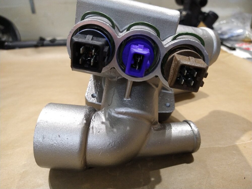

fendervg 33 Posted October 4, 2023 The AC cars would have had a different fan control module installed, with an extra stage, and there would be additional wiring. There is also a different third temperature sensor in the thermostat housing for AC cars - I forget the colour, but it would be 4 pin. Quote Share this post Link to post Share on other sites

tonedef 10 Posted October 4, 2023 On 10/4/2023 at 7:04 AM, fendervg said: The AC cars would have had a different fan control module installed, with an extra stage, and there would be additional wiring. There is also a different third temperature sensor in the thermostat housing for AC cars - I forget the colour, but it would be 4 pin. I agree there’s a different 4 pin sensor in the stat housing as I remember having to source one, although I don’t remember the colour either. The FCM didn’t need changing when I installed the Climatronic, although I did have to add a few wires and pins to the ten pin plug that weren’t on the Corrado loom. Since then I’ve installed another loom when I converted to OBD2 from a Golf but it went straight on the same FCM. I’m sure I remember that the later cars had a different controller installed which is how I expect mine came with this one, it definitely worked fine without the additional a/c hardware and the car was less than five years old when I bought it so I doubt anything had been messed with by then. Quote Share this post Link to post Share on other sites

ABV-VR6 12 Posted October 5, 2023 On 10/4/2023 at 12:07 PM, tonedef said: I agree there’s a different 4 pin sensor in the stat housing as I remember having to source one, although I don’t remember the colour either. The FCM didn’t need changing when I installed the Climatronic, although I did have to add a few wires and pins to the ten pin plug that weren’t on the Corrado loom. Since then I’ve installed another loom when I converted to OBD2 from a Golf but it went straight on the same FCM. I’m sure I remember that the later cars had a different controller installed which is how I expect mine came with this one, it definitely worked fine without the additional a/c hardware and the car was less than five years old when I bought it so I doubt anything had been messed with by then. My car is one of the last as well, SK001010. So technically the 506 is definitely what I need and that's what is installed. Quote Share this post Link to post Share on other sites
ABV-VR6 12 Posted October 5, 2023 On 10/5/2023 at 5:19 PM, ABV-VR6 said: That's correct, it's brown or black. When I deleted the AC system I left that one unplugged. After checking my wiring again following Cressa's advice and found my third speed wire not connected to the fan, I plugged this sensor after the work. Maybe that's something else I could check, unplug the sensor and see if it changes anything... It's actually the brown one on the right formerly yellow colored. Quote Share this post Link to post Share on other sites
