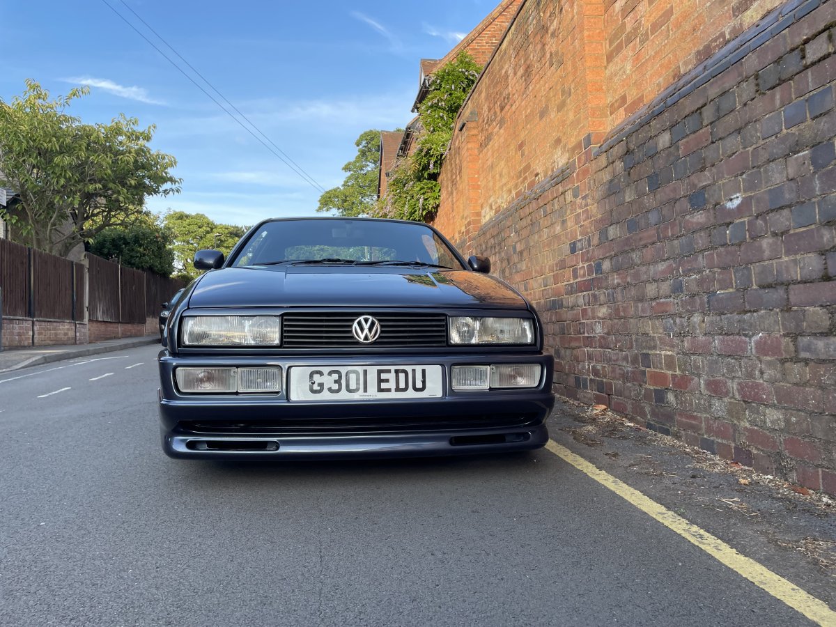

My early G reg valver came with no abs and no cats from factory and also has manual windows - if you just look at the early KR16v part numbers on etka for a 16v or early g60 there is your part list.
