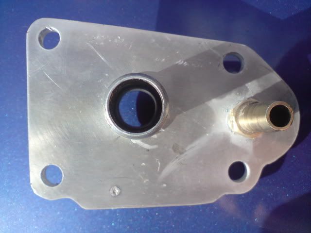

flusted 0 Posted August 11, 2008 My breather blank with oil return Another vid, this time with boost hoses on Quote Share this post Link to post Share on other sites

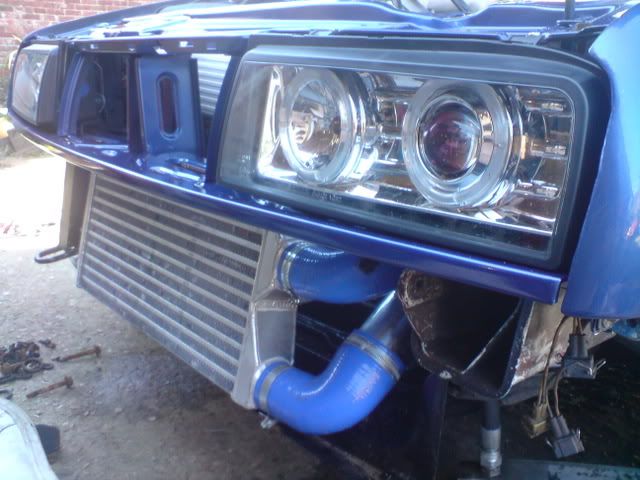

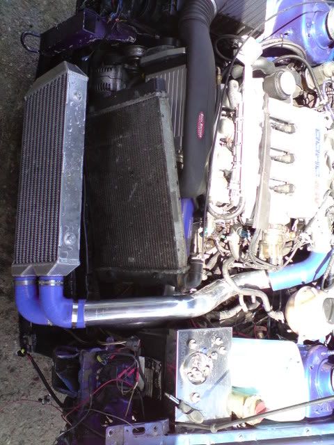

flusted 0 Posted August 15, 2008 Want a proper remap before i dyno it. Painted and fitted standard front panel yesturday along with the new corrado headlights. Ive had to chop out the extension that was welded to the wing that matched the beemer lights. heres a few pics of intercooler and plumbing Quote Share this post Link to post Share on other sites

waynos 0 Posted August 18, 2008 that looks miles better! where did you get the intercooler? been looking for one like that for ages, id it require any cutting to fit? Quote Share this post Link to post Share on other sites

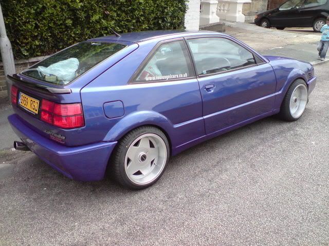

BigTartanJudge 0 Posted August 18, 2008 Hi mate, Loving the changes, looks so much better tbh. Also, how did you go about doing the all red rear lenses ? Are they sprayed using tinting spray or is it plastic film ? Cheers Quote Share this post Link to post Share on other sites
flusted 0 Posted August 19, 2008 foliatec tinting spray over crystal m3s Quote Share this post Link to post Share on other sites
BigTartanJudge 0 Posted August 19, 2008 Cool, have a spare set of crystal M3 rear lights so will give that a go, how have you got the indicators to flash orange, by using green bulbs or have you not bothered with this / used some other method ? Quote Share this post Link to post Share on other sites

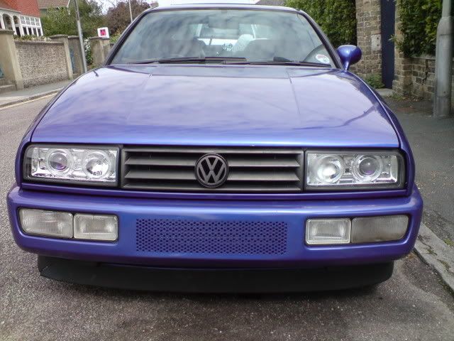

flusted 0 Posted September 27, 2008 Havent updated this for a while. Done loads, new 50mm inlet manifold, 53mm pulley, carbon grill finished, driver mirror fitted etc and mot retest on wednesday and it should be on the road. Quote Share this post Link to post Share on other sites

BigTartanJudge 0 Posted September 27, 2008 Looks good mate, it's almost identical to mine ! Although mine has been off the road for 9 months. How did you fix on the number plate ? Quote Share this post Link to post Share on other sites
pete_griff 0 Posted September 27, 2008 looking good my friend - think i preferred the original grille with the VW badge and without the eyebrow spoiler, but still looking 1000% better than before :) roughly how many ponies do you recon you are running now? Quote Share this post Link to post Share on other sites
flusted 0 Posted September 27, 2008 Made some right angle brackets for front number plate. I reckon its about 240ish bhp but ive just fitted a smaller pulley and yet to drive it. Got a mate making me a carbon boot spoiler and possibly making a blue kevlar 1 aswell then hes guna start knocking em out cheap. He will be able to do em in this Quote Share this post Link to post Share on other sites
