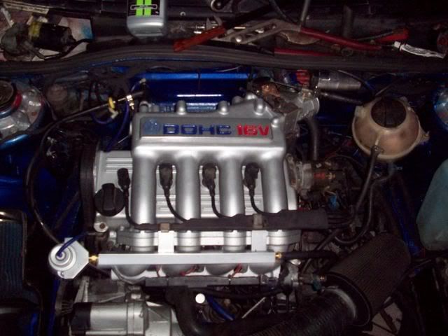

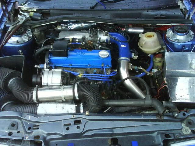

yeah flowed big valve head and 4 branch although ive suddenly lost loads of boost, hopin leak, but possible dead charger
hope its not the charger mate :cry:
hehe i knew that was just testing you lol! where did u get it from, i havent seen a bumper like that before

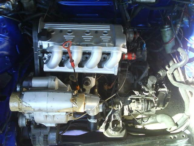

heres some progress pics of my 16v g60 conversion
Ive decided to pull my 8v lump out and replace with a 16v.
Progress so far
Todays summary
After id just ripped the bumper off
The 8v lumps last few moments before being taken out
Charger off and slam panel etc
And its out!
Took about 2 hours, just need to paint in under the bay and sort the wiring out which is tommorrows mission.

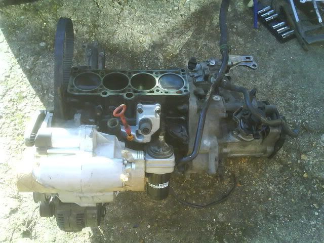

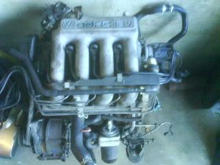

Heres the engine straight out of a 16v corrado 1.8 139bhp

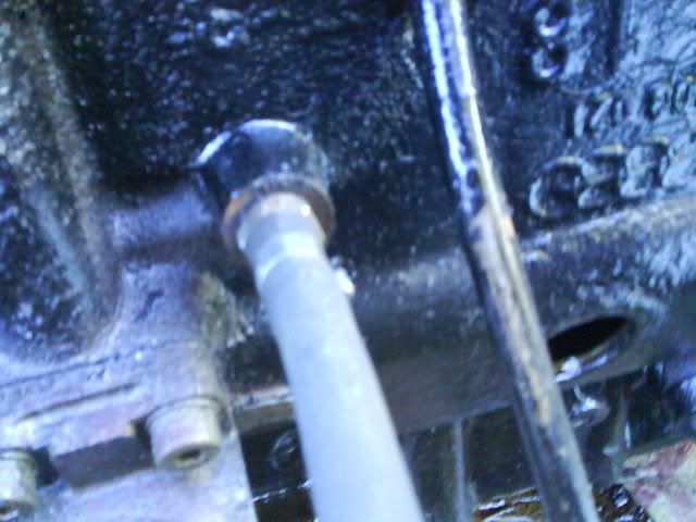

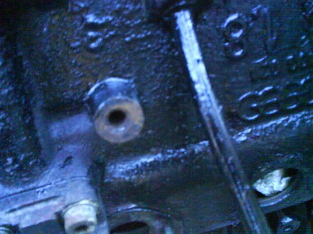

This is where i need to drill the block for oil return from the charger
oil return fitted

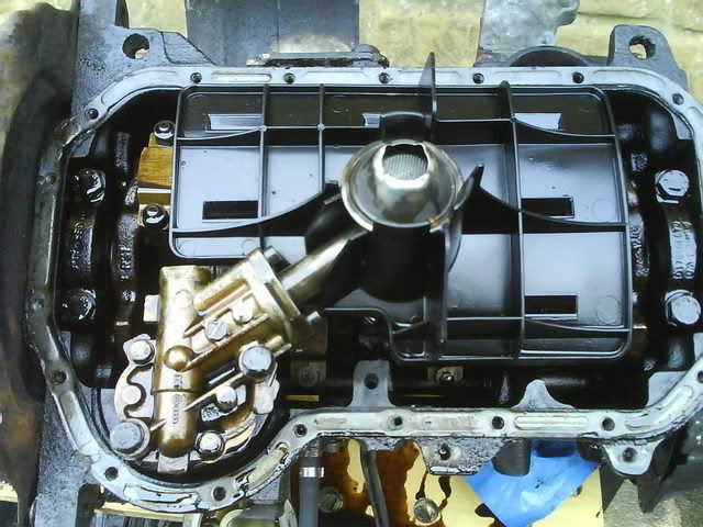

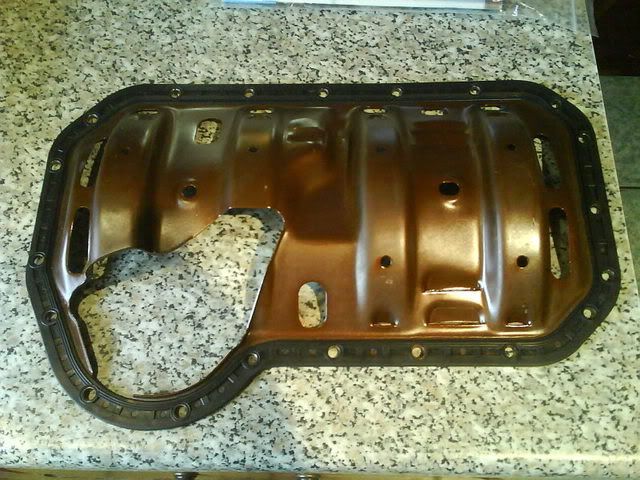

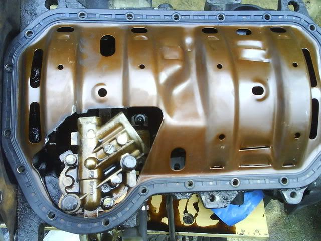

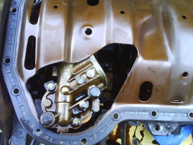

sump off
New windage tray
Bummer, it fouls the oil pump, out with the grinder
It fits!

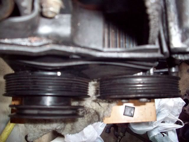

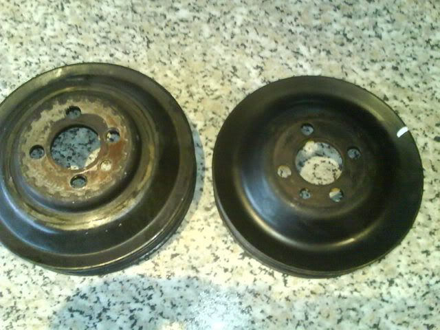

just removed a bottom pulley from a 1.4 mk3 golf and its pretty much perfect alignment with the other pulleys!
No need to shave 6mm off!!! :smartass:
g60 on left, mk3 1.4 on right
pic of the mk3 1.4 bottom pulley, i think i might actually sit in too far?

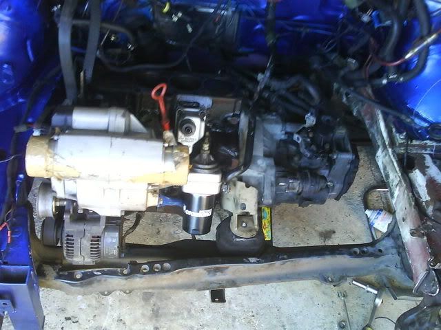

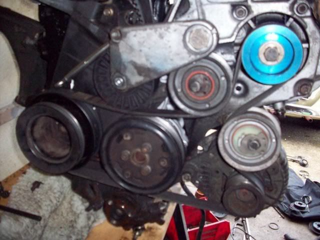

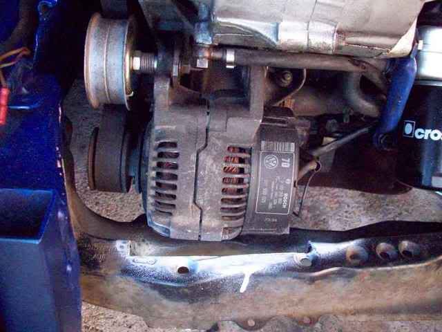

My belt arrangement using a vr6 alternator mounted under the charger then a few cam belt tensioners here and there
when the original tensioner is pushing down on the belt, it does actually spin the water pump pulley, although it doesnt look like it in pic.

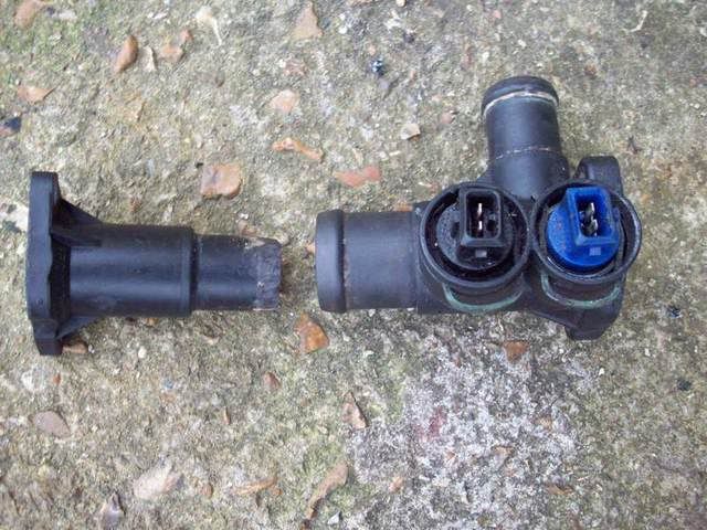

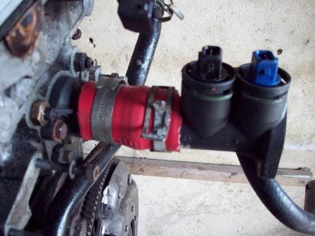

My alternative way of re-using the original water flange thaat houses the sensors for ecu and dash, just need to make a blank for the open end.

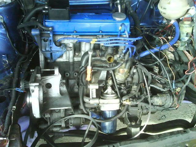

heres the block with gearbox fitted
got it sat in the bay
had to cut the rad support for clearance for alternator

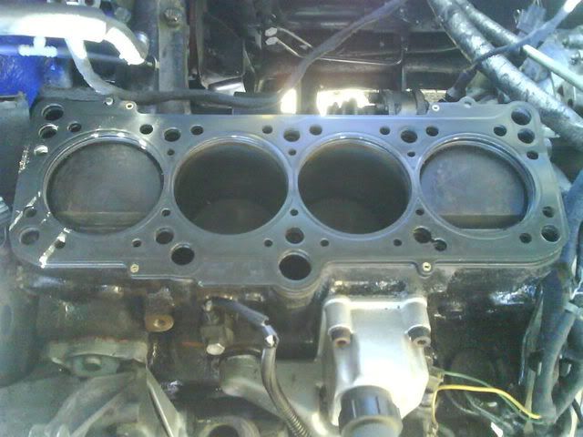

Stacked head gaskets
Head on

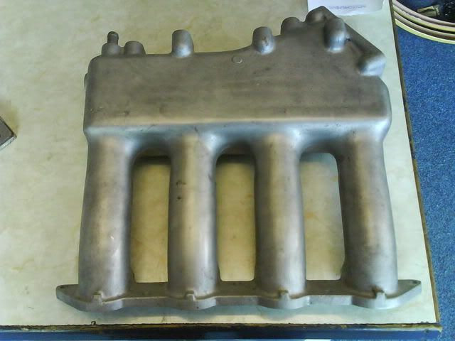

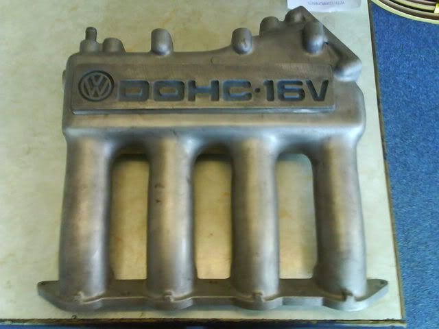

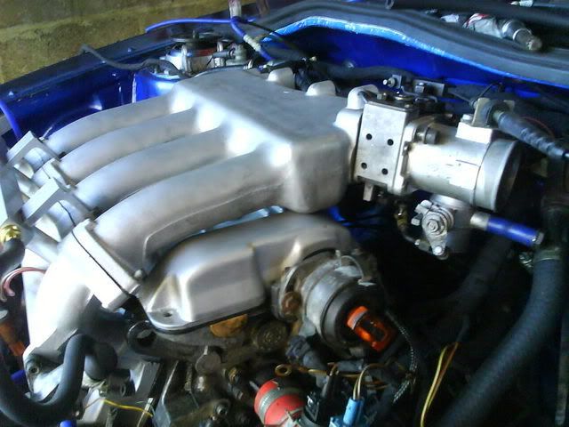

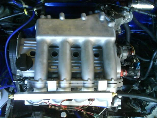

Got my flipped inlet, here it is
I decided to cut up an old manifold i had, and cut the logo off to then glue on the new manifold so it looks more oem

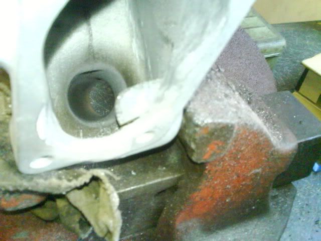

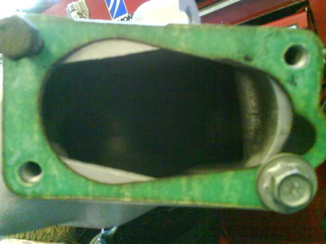

Where the top part of the manifold has been flipped over and welded, the throttlebody flange needs re-shaping as the small and big butterflys are now different sides. heres what material needs taking off
I also took out this large lump that looks very restrictive for number 1 runner, and then match ported the throttlebody to the manifold

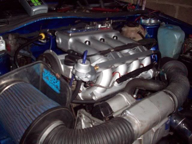

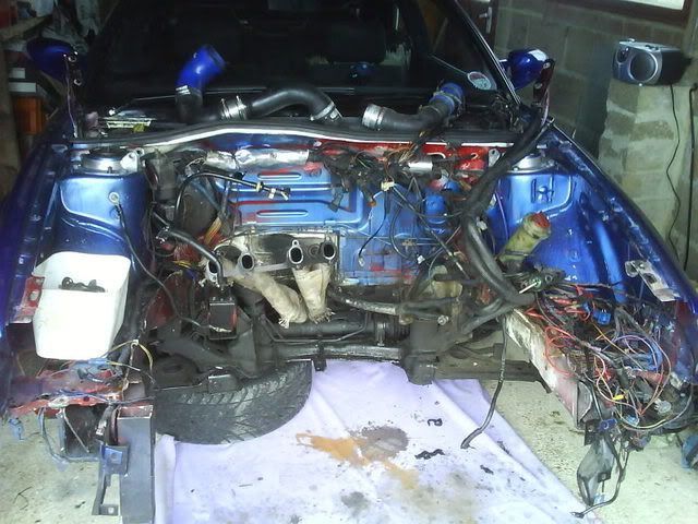

Here it is fitted
need to move the coil down slightly to add more clearance for the throttlebody pipe.

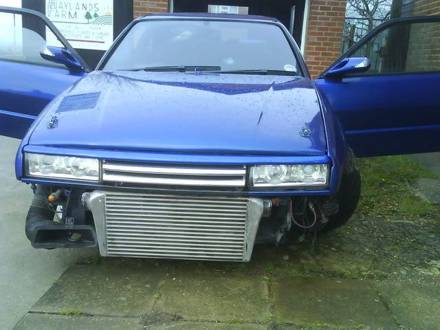

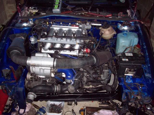

Just got to route the boost hoses then put the front back on
Awesome!!! You're making bloody good progress again. When do you expect to have it running?
need to make an exhaust up for it but i want it running by end of the week, maybe start it tommorrow without the exhaust on it
