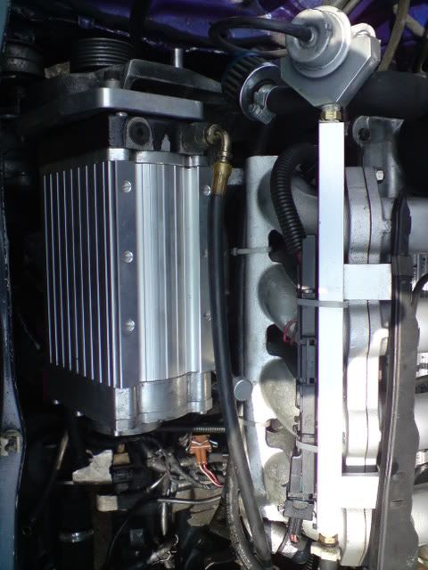

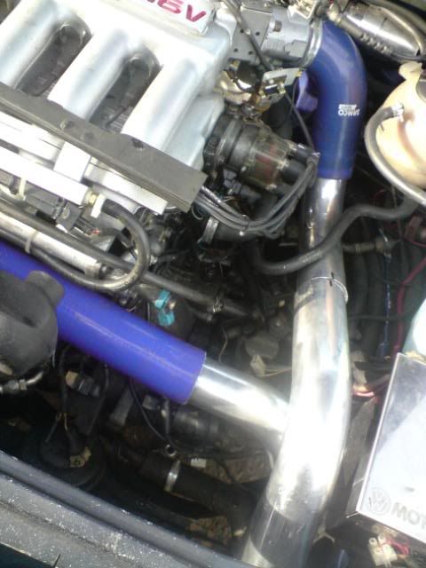

trial fit of charger
with intake on

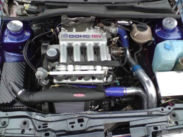

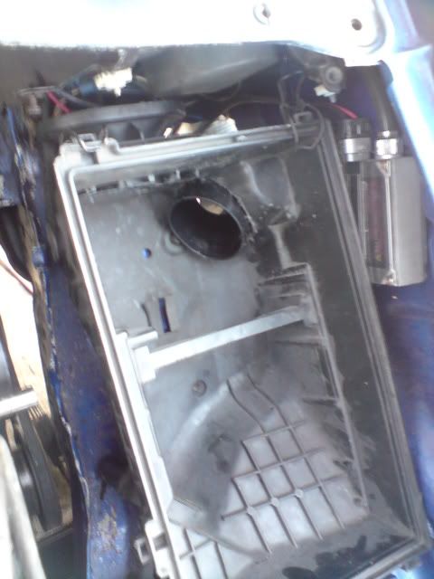

Then my DIY cold feed for standard airbox
Guna connect the cold feed to where the brake cooling duct is

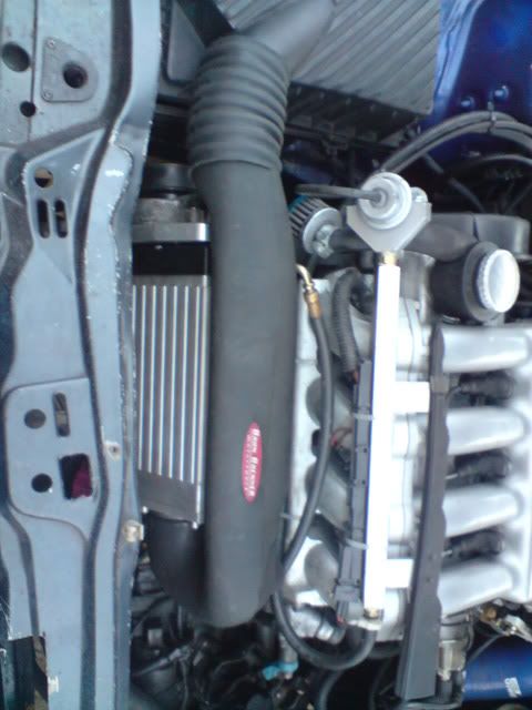

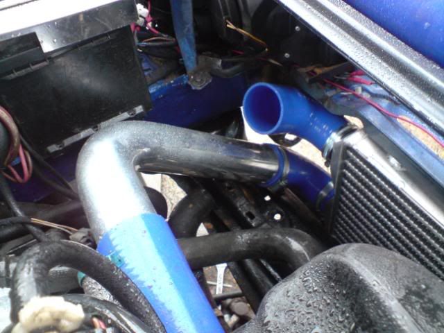

Hi mate, what sort of pipe work are you using for your inetrcooler? I used humped hoses on mine that lets the pipe work move, apperantly if the pipework is rigid it can cause the charger to twist and sieze!
Yeah heard the horror storys. Ive bought an ic fitting kit of ebay which uses alloy pipe and silicone joiners, and il prob put a support off the outlet pipe to take any weight off it.

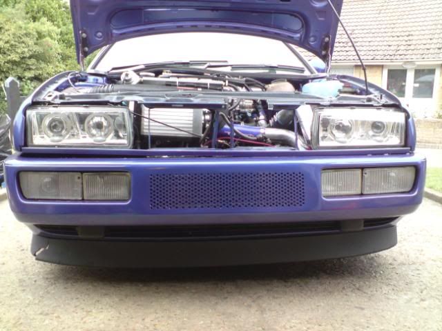

And heres a pic of my front grill although not finished

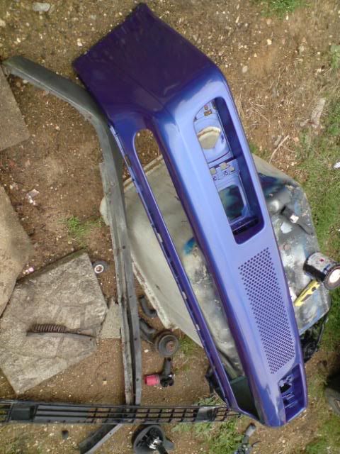

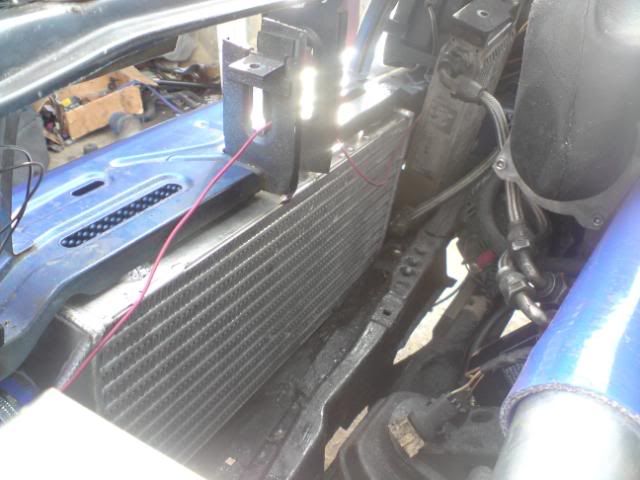

Finally got the IC and oil cooler plumbed up and the bumper back.
Bumper painted

looking good there buddy. i'll second that "unpimping" the car is by far the best thing you have done yet - it looked... well... very chav! - glad you have seen sense, it looks much better now.
unsure about the grille - but can't pass judgement until it's fitted i guess.

Awesome skills! That engine bay is looking very nice and clean too :)

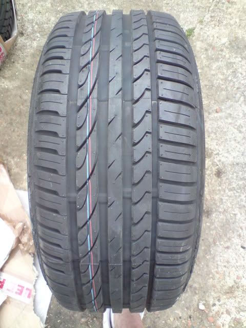

Borbets arrived today, guna fit them after work and post pics later 8)

Heres the cold feed taped into the brake duct for trial fit
