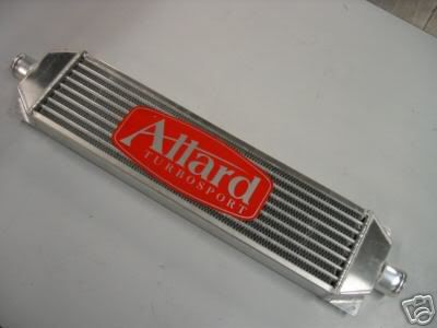

A20 LEE 0 Posted April 1, 2006 quite like this IC, overall dimensions are 810x165x65mm. Possibly a little too wide? I'm starting to think i should be looking at fitting an aftermarket Rallye item if it uses the factory mounting points and just welding on the brackets from a Rallye cross member. Anyone got experience of fitting a rallye IC to a corrado? Quote Share this post Link to post Share on other sites

Henny 0 Posted April 6, 2006 woody, you called? :lol: Either the Rallye or G60 intercooler are THE best fitting for a Corrado front end, as essentially, VW designed 'em for the job! :lol: However, if they're suitable or not depends on what it is you're using them for and with... If I were in your place Lee (which I'll never be 'cos I can't be arsed with polishing things unless they're to make the car faster! :lol: ) I'd get hold of a dead radiator from a MKII golf (or similar) and cut the lugs off the bottom which do the locating onto the lower rad support panel - don't lose the rubber ring, they're important to stop rattles!. You can then attach them to pretty much any intercooler you want to fit into the space up front meaning that the cooler will just sit into the mounting holes already on the car and with a pair of simple brackets, (which'd be easy to chrome! ;) ) can be mounted to the leading face of the radiator in the same way that the fan shroud fits to the trailing face... I've attached an edited photo of your new panel... the red circled holes are where the rallye/golf G60 intercooler mounts and the blue one is where the outlet on the intercooler hooks into to keep it stood upright... 8) Quote Share this post Link to post Share on other sites

g60bv 0 Posted April 6, 2006 is that little intercooler going to flow enough for a blown vr6.? looks a bit ... well ... weedy. Quote Share this post Link to post Share on other sites
GazzaG60 0 Posted April 6, 2006 i agree. for a proper blown engine get the biggest you can fit. for a G60 the rallye or golf that henny and others use is good. i got 600*450*80mm and hope itll fit without too much cutting. Quote Share this post Link to post Share on other sites
Henny 0 Posted April 6, 2006 Size isn't everything though.... you need to make sure that it's not going to screw up the air flow by making the air have to go through too many restrictions or turns to get from the blower to the inlet manifold... having tight turns just to add 2 or 3 cms to the length of the intercooler could well cause you a loss in power due simply to the extra restriction of the turns... Also make sure that the inlet and outlet sizes of the intercooler aren't smaller than either your inlet (throttlebody or manifold depending on if your throttle is pre or post intercooler) or the outlet from the charger... Quote Share this post Link to post Share on other sites
