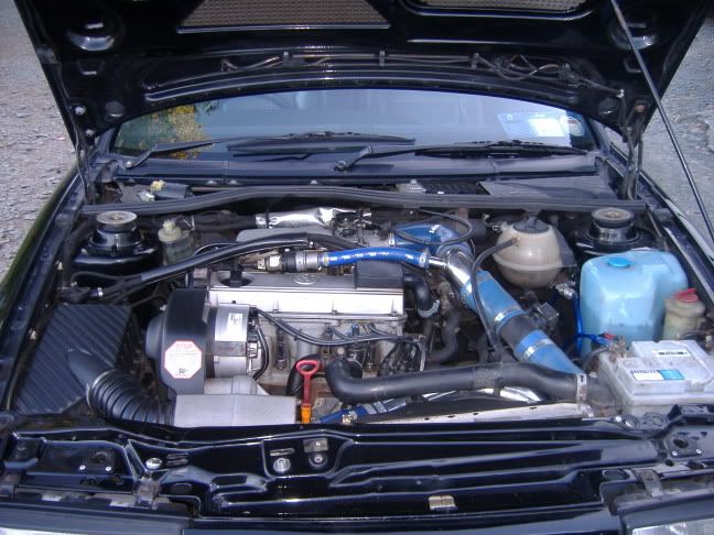

Bohall 0 Posted July 19, 2006 This is the way my intake/ISV is done, i bought the car like this with the front mount intercooler fitted and thought this was normal until i looked on here!!! I never have any idle, boost leak or any other problems with it, seems to work spot on! Quote Share this post Link to post Share on other sites
