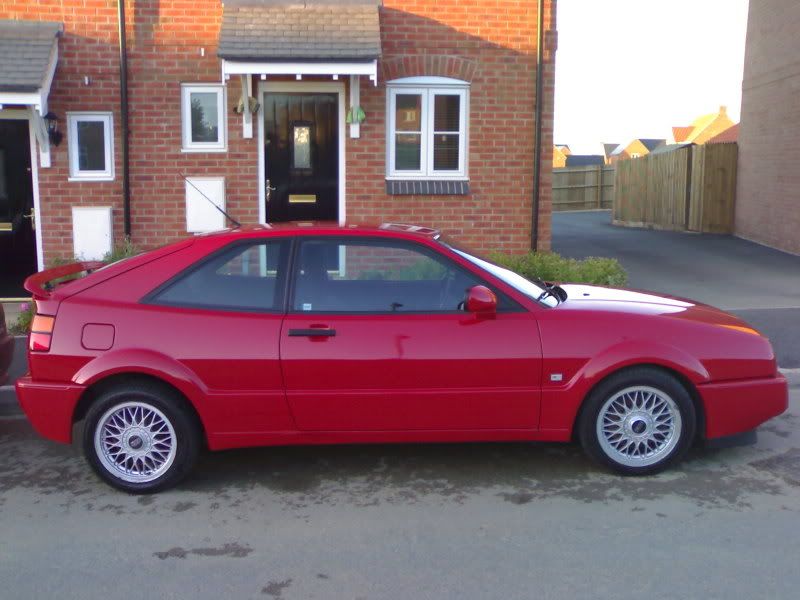

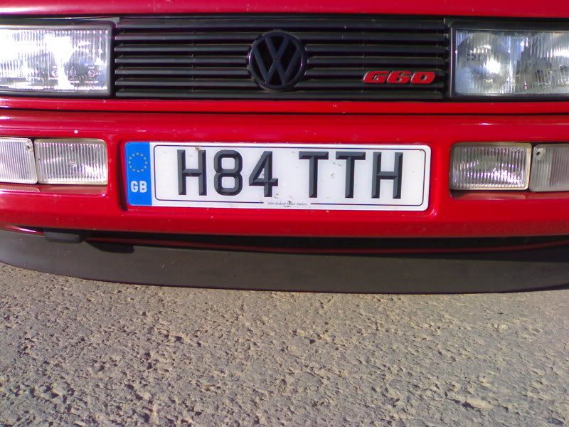

Spykee 0 Posted July 15, 2006 ive had my new uprated shock and lowering spring setup fitted to my car today and am really pleased with the front end but im not sure about the back........ to me it doesnt really look any lower than standard and its got a kind of dragster stance with the back end higher than the front. i know the back is normally higher than the front but i dont know whether its supposed to be this high.... its lowered by 40mm btw also check out how close to the road my chin spoiler is coming off my driveway!! :shock: take a look and see what you think, opinions much appreciated :) Quote Share this post Link to post Share on other sites
g60greeny 0 Posted July 15, 2006 nice lookin motor btw mate 8) yeah the rear still looks a bit high to me Quote Share this post Link to post Share on other sites
CazzaVR 0 Posted July 15, 2006 Front looks perfect, back does seem a little high :? I had a Koni kit fitted a few weeks ago and was also concerned with the drop- it didn't really look any different to standard. However, since then it does seem to have 'settled' a bit more, and I've been assured that it will still take a little while to reach it's proper height. The front and rear look similar though, unlike yours... Did you have new rear bump stops? Think you're meant to hack a few mm's off. Not sure if this would affect the height like this though. Quote Share this post Link to post Share on other sites
Bally 0 Posted July 15, 2006 Alex, yr rado is mint.. I had the same problem when I first lowered my rado... ended up taking coils of the rear springs :lol: Quote Share this post Link to post Share on other sites
Spykee 0 Posted July 15, 2006 cheers for the nice comments guys! :D i was wondering whether they will be lower when they settle as well but i doublt they would settle enough looking at it :? i used the original bump stops and was wondering about this but my mate who installed them rekons there is about an inch or two of travel above these in the rear arches...... Bally, do you mean you actully cut the rear springs down so they were shorter? cheers, Quote Share this post Link to post Share on other sites

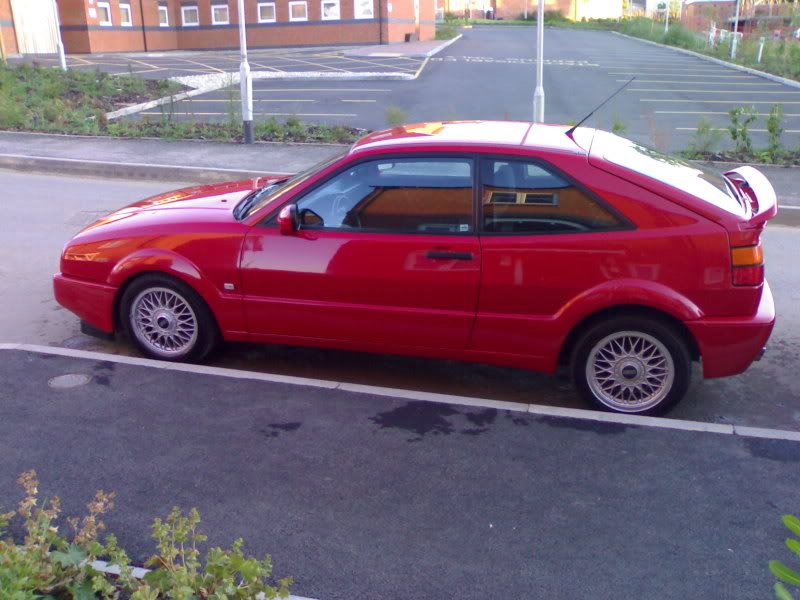

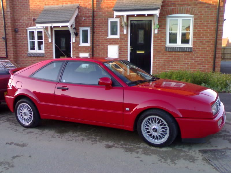

Spykee 0 Posted July 16, 2006 i have to say that firstly i am extremely pleased with the service Darren has provided as well as his help since getting them in terms of answering any questions that i have had. :D :D i ordered the kit on wednesday and they arrived by lunch time on thursday, couldnt get any better if you ask me! :D the only reason i posted this thread up last night was to see if i could get other people's opinions whether it looked too high or not. anyway, i have had the back end apart today to make adjustments and ended up removing the rear struts again completely as it was easier. i have used my spring compressors and moved the circlip to the lowest rung on the damper and i think its done the job nicely! it now looks spot on front and back. take a look to see what you think now 8) cheers, Quote Share this post Link to post Share on other sites
